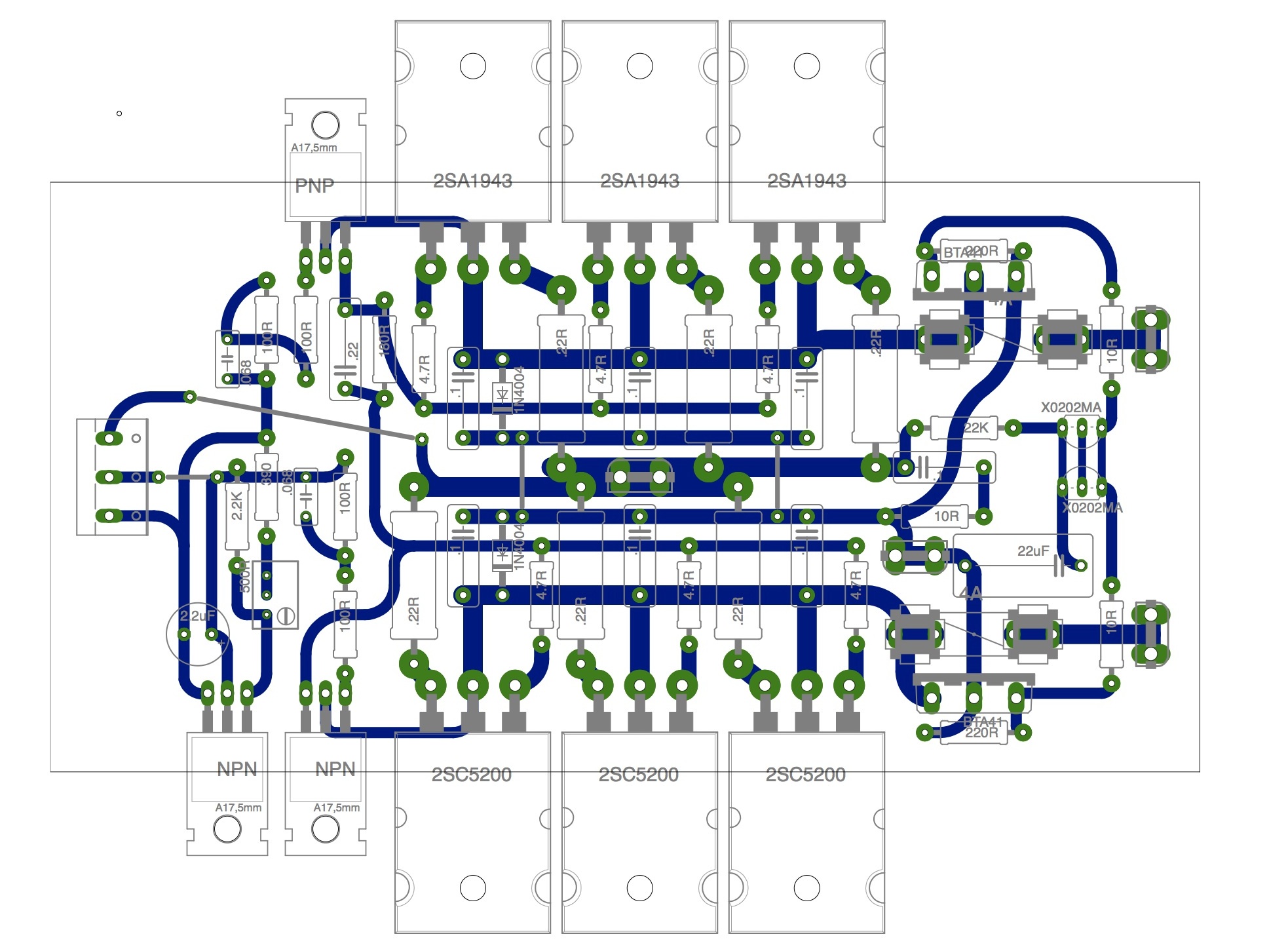

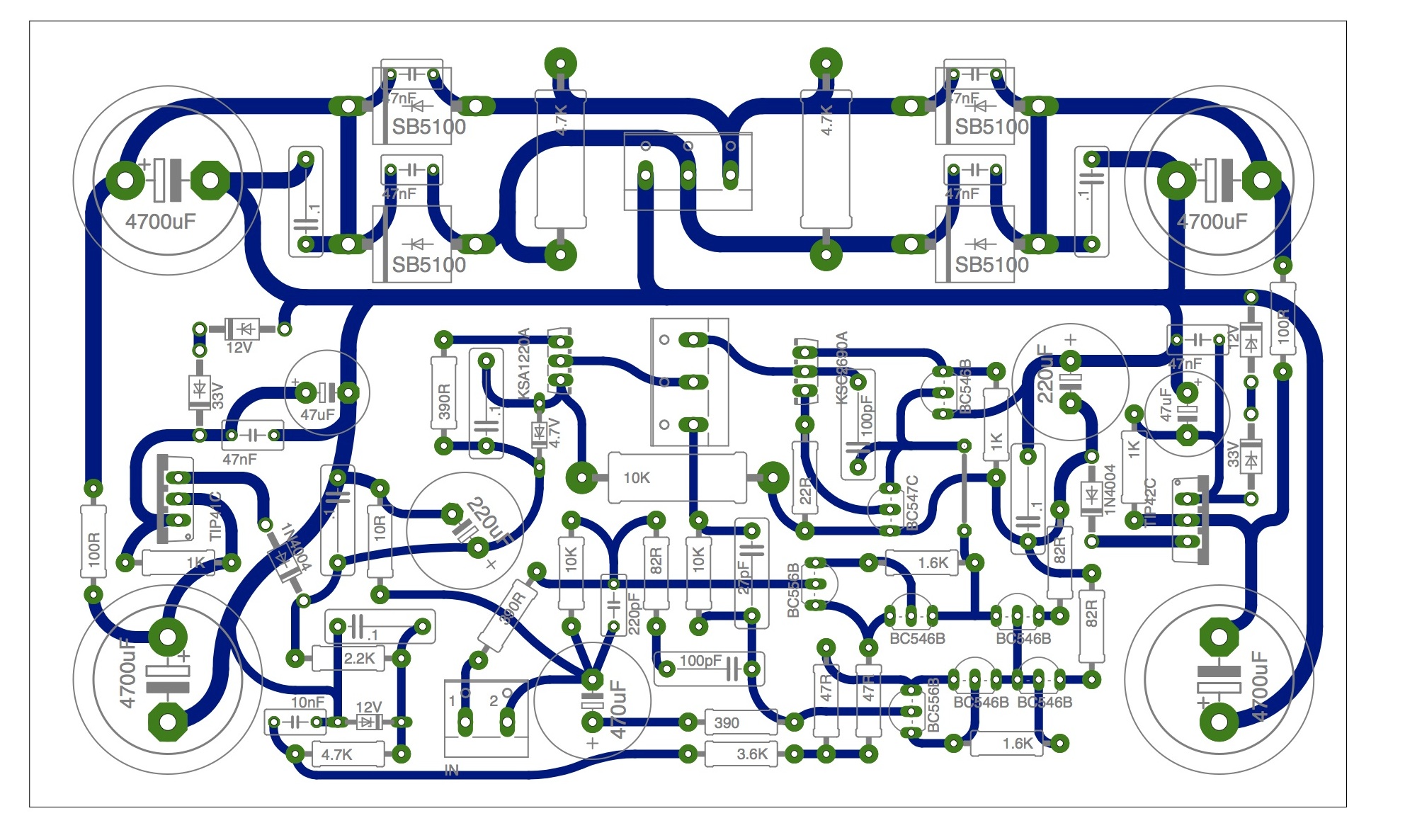

I Have created new PCB's for the DX Precision I so that they will fit in my enclosure. Can you tell me what you think of them. They have built-in speaker protection and a separate power supply for the driver stage.
  • PDF + EAGLE.zip
    PDF + EAGLE.zip
