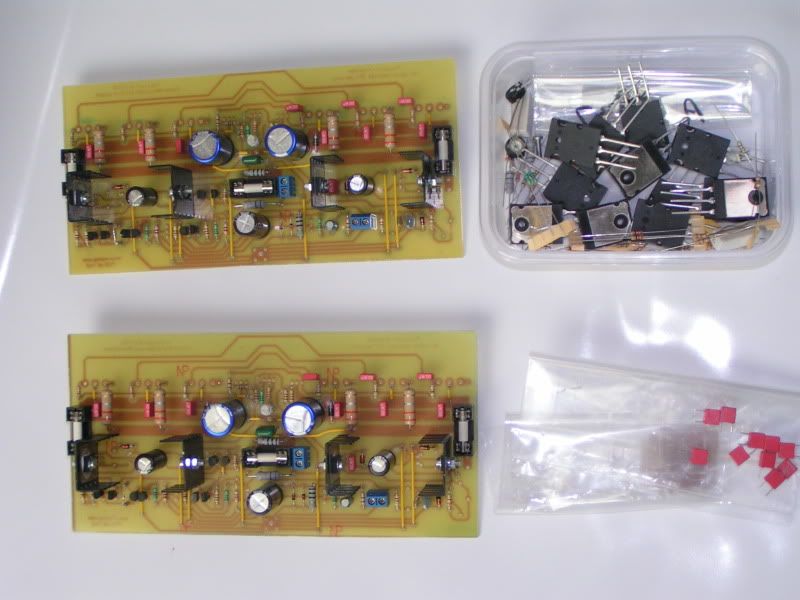

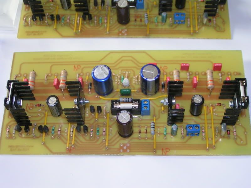

DX precision 1
Hello everyone, i have a DX precision 1 work in progress. Still missing parts.
I will post more pics after completion. Thanks.

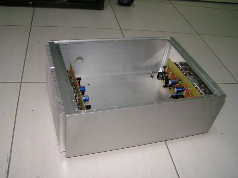

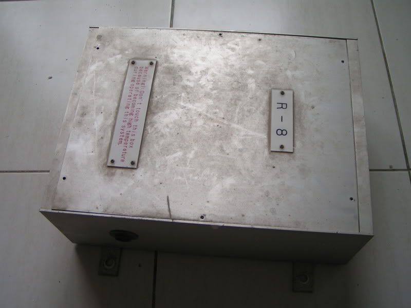

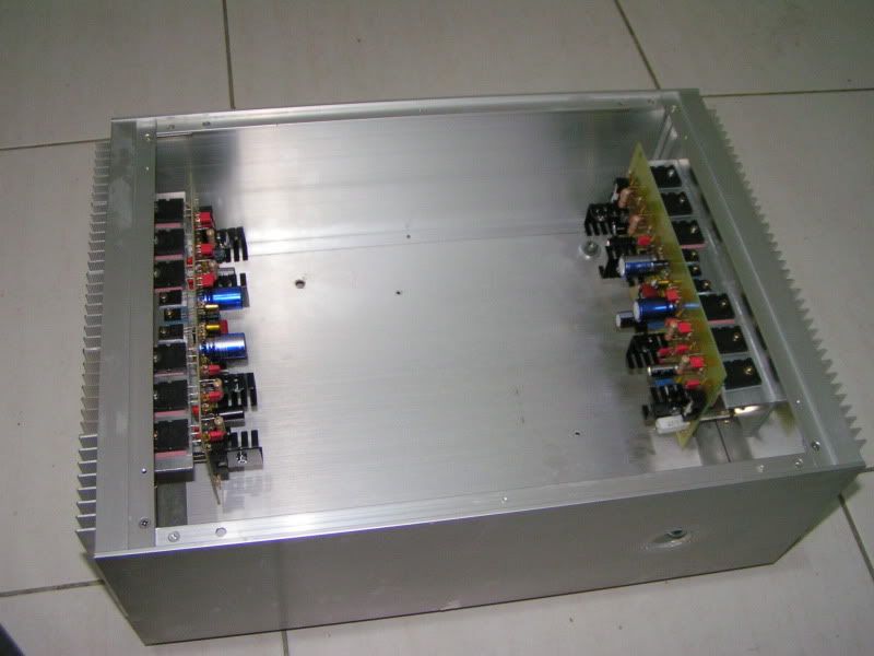

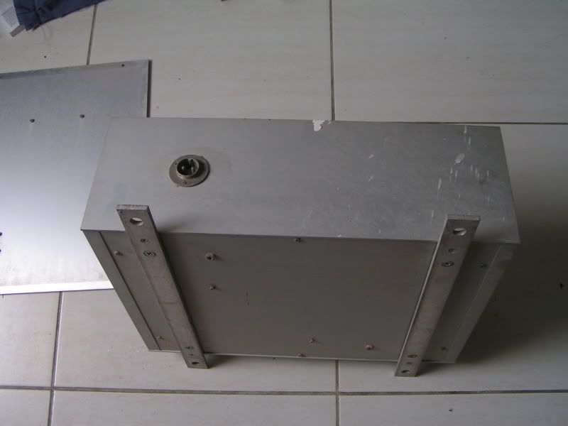

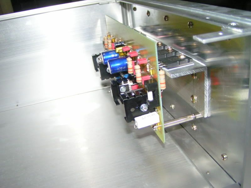

Amp case
I found the below box in our office trash...thinking of something useful😛 A DX amp Case!!
Cleaned it and Viola!!
Almost done
Almost done
Thank you , Junie !! 😎
I never thought of that mounting style using the Aluminum angle. A real space saver.
Great what you did with that E-waste as well !!
