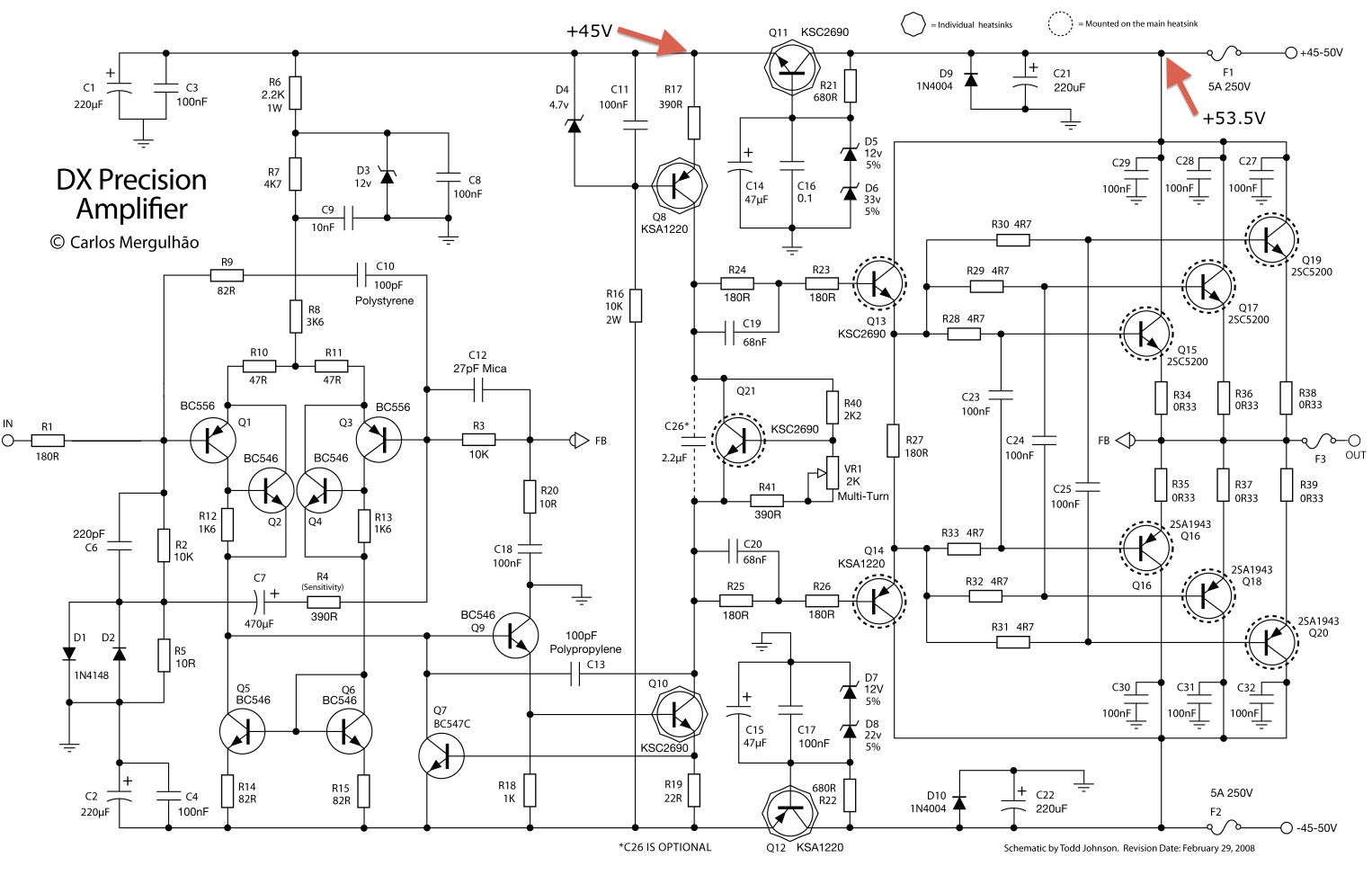

I have one question. I swear it will be my last!
Regarding Q7, the BC547C "amp murderer" as carlos calls it. Back within this thread it is said that this should be a BC546C, as the BC546 has adequate voltage rating. I have some other transistors here, namely a 2SC2240 GR. All is well comparing the two transistor's datasheets. I notice that for the BC547 it is a "C" classification, having an hFE of 420-800. I need to know if this is critical. The 2SC2240's that I have are the "GR" type, having an hFE of 200-400. Will this make much of a difference?
And, if that is no good, it is also said that the transistor can be removed. Carlos actually does not like it there at all. Apparently some others requested it to be included. I would like to know if it comes to it, can the transistor be pulled right out of the board simply, or if their will have to be a circuit modification done first.
I would prefer just to replace the transistor with a 2SC2240, but if that will not work I will remove it. Or worst comes to worst, I will have to buy some BC546C.
Here are the datasheets, if anybody would be so kind to help me out.
2SC2240
BC546
I am aware the pinout is different, and I will have to curve some pins...
Thanks.

2SC2240 handle only 300mW thermal dissipation,
while the BC546 is rated 500/650mW, depending
on the manufacturer.
Edit : looking at the schematic, both are adequate
since worst case thermal dissipation will be negligible.

Because of different gain....maybe you will have the sonic killer operating much more
than we hope and much more than we need.
This can kill much more your sonics...well.... try it and listen both of them and then inform here what you have perceived...give yourself a chance to listen without the sonic murderer.

To remove, can I just pull the transistor out?
Yes...remove it entirelly instead to dessolder the base
remove from the board, at least two leads, and one must be the base.
pull it out...yes....better this way....and listen.... and increase volume in the input..observe dinamics and treble high end.... you will notice something.... please... return and inform folks if you perceived something and what you have perceived...this will be a good cooperation with the community.... some review.
This transistor (sonic murderer action) depends on the input level... it compresses, kill dinamics, distorts high end..makes sonics very poor....limiters, in special V/I limiters are a very bad solution...people use because they do not use to listen both options..so...they do not know the real thing...they go believing in fake things because some of them are lazy to remove, re install and to try several times...too much arrogant about their beliefs and technical skills that drives them blind to the real thing.... well...some of them are just lazy.
Now a days i am using these transistors in the output (with complementary naturally)...they are good, strong and stable..not addicted to oscilations..have nice current... and good gain..... i do suggest folks, if possible, to use these ones together my amplifiers for more and more reliability...these ones was gift, sent to me from Canadá, by Evette.

Thank You for your help, i think i will try to etch the pcb myself but i have different transistors / psu voltage than the original circuit.
i photoshopped the original circuit and modified with my parts can you please tell me if this will work with these transistors as good as the originals.
also if i use the BC546/556 should i use the A,B,C version of the device.
