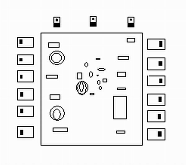

The black transistors go under the board in real life.
Ok tried a butterfly layout.. still think an inline layout gives better spreadout on appropriate heatsink..
This board is wonderfull too... i like it.
But i do not like the solution of power transistors under the board... this way you made, that difference you made as you place the transistor screw free to attach is better, as you can screw them into the heatsinks from upper board side.
This solution, or the last solution are fine to me...also another third option will be good too...i think you are very developed, now a days very skilled related to make boards and to find good solutions to the problems you face.

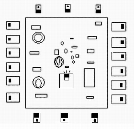

I like the board too, but...
Greetings and thanks for playing around with this. Does that mean you are going to tackle the big amp too? Count me in for a board set if you do.
The butter fly arrangement may get too wide for common heat sinks if you did that, but like Carlos I think would be better if the transistors on the heat sink could be removed (to replace failed ones for example) without having to unsolder all six (to remove the board to get to the screws attaching the to the sink). Would it be possible to have the front end circuitry between the output transistors to keep the width of the heat sink narrower - just wide enough to accommodate the width of three transistor (plus bias servo)?
Where does the bias compensating transistor go? Is it the one shown between the left most power transistors? If so how would it be installed on the heat sink and replaced?
I could not guess what is the yellow/green band to the left of the power transistors is? Seems like there might be board space to be saved if it does not have a specific purpose. How big is the board as you have it now?

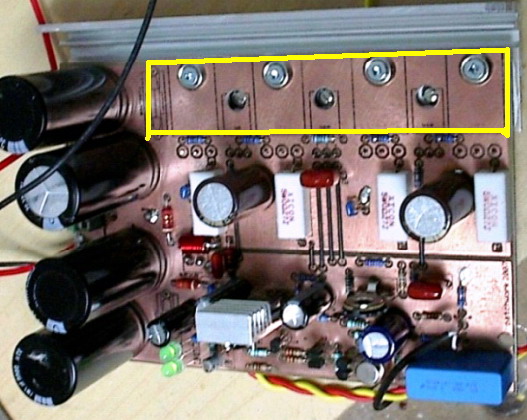

No need to configure it that way. It could be screwed through the board into the heatsink (see pic). Soldered on the bottom side.
Lose some board real estate, but I now believe it's worth it. No worries about breaking a lead out, everything held tight, safe and sound.
Looks good too.
Francois G said:
...but like Carlos I think would be better if the transistors on the heat sink could be removed (to replace failed ones for example) without having to unsolder all six (to remove the board to get to the screws attaching the to the sink).

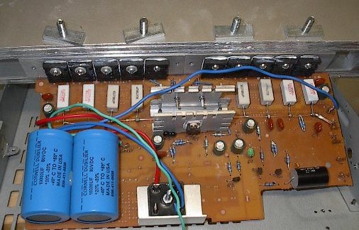

Dear MJL21193
Your construction is fine, there's no problems about that to be made into our home.
But to order boards, from board's factories, area, size, are things very important that can make huge different into the final price.
Your method, despite nice, would be the first thing you would change after collect board factories price to order hundred boards for instance.
You see that there's are wasted, doing nothing, or...covering power transistors only...and this can be also annoying to some people that appreciate to see the "little soldiers" aligned on the board top or around the board.
It is not so easy when you need to make repairs..in the reality is not good to repair as you cannot replace a single transistors and have to dismount the whole thing...or have to remove all screws..and a lot of mess happens, that damn grease, thermal grease will make enormous mess into our lives...also insulators...will be a nigthmare...at least compared to other more simple, less sophisticated ideas, it is more difficult, more confused, less economic.
You see the area wasted...no one see transistors...only copper and screw... copper without function, that also will turn dark after some time pass, because of oxide (maybe you have painted with varnish to protect the copper, a very clever idea)

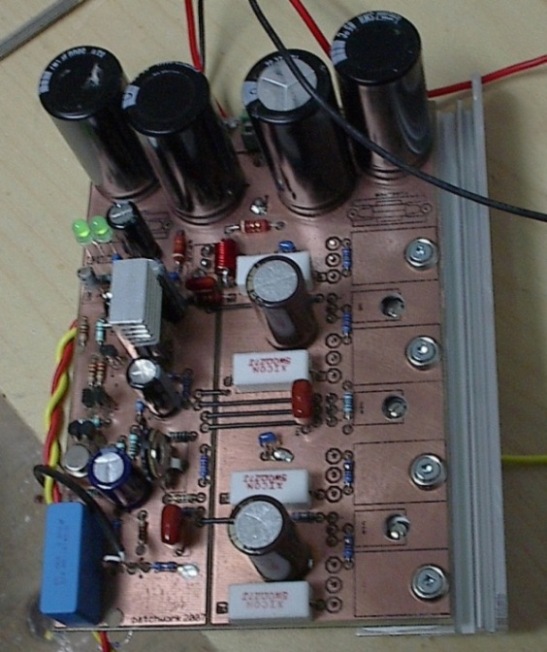

Also, dear friend, MJL transistors and 2SC also are very pretty units
Nice big hard Epoxi blocks, we will happy to see them.
People can see and say.... uow!... a lot of power units...this shows power... alike the smell makes the food better... the transistor quantity makes we feel the power with our eyes too.
See the image, the more traditional way to construct can produce around 20 percent of board area economie.
Thank you to offer us your suggestion and to explain us your point of view..almost good to individual home construction, not the best to group buy

Hi Carlos,
Yes, the price of board production is high, and the extra square inches costs money, BUT I think it's worth it. We are building audiophile equipment, right? Not in competition with Sony.
If it's a couple of dollars more is that too much?
The copper above the drivers/outputs is a ground plane and the bigger, the better (I've heard). Proven too (for me). That amp does not make a sound when running - no hiss, no hum.
I have coated it with lacquer before assembly. Brown copper wouldn't bother me anyway, look antique but I can't see it inside the case.

Well, I don't have those T /L brackets you guys seem to screw your transistors into.... All my boards so far have been soldered underneath ... and the transistor is the filling in the sandwitch.
So I'll be damned before I design something I can't use myself
You can solder transistors over board if you have L Bars.
The gold bar is a kind of placeholder as I need to think about the GND connections, I thought I will have 2 GND stars, one for front, one for rear, both connects to chassis ground star.
I still think haveing all transisotrs on one side of board is better, as it allows a greater selection of heatsinks..., as long as your sink is about 20cm long it will work.
Relating the capacators, I chose to allow for two capacitors in parallel so that you can use lower values, but almost all the larger value 100V caps from about 1000uf are common in the sizes I used.
I am not sure I agree on the impact of caps close to the transistors.
After I followed Grahams advice on adding large caps right to the transistors in the original DX, there was a HUGE improvement. Not subtle, not something to argue about, it was concrete fact. So much so, that despite poverty, I now save up and buy those large caps, they are worth every last cent.
On the topic of caps, Am i right when I say if the ripple rateing is higher than what the load demands on a single cycle (which I think we can consider a ripple too...) can draw down, the Voltage on the cap should stay unaffected...?
Also I nearly fell on my back the other day when a friend showed me his 10000uf caps, they were only 100V, but probably 8cm across.. and 15cm high, absolutely giant... according to him, they are "better" than the regular "small" ones...

I think I will go with the onesided transistor boards.... with some modification...
It just has so many more options it allows for... especialy now that I am looking at foto's of such a layout.. will even reasonably accept those round can transistors using short wire leads...
Can more easily be fitted to lower profile cases etc... another probably money saveing feature...
