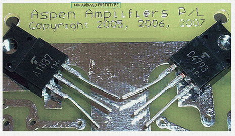

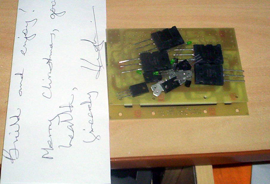

The picture:
Letter including boards made with the King hands

The picture:

About boards received.
They are not from Hugh line....only one of his ideas...a brainstorm he had... different design, sounding very good...but not the top performer he was searching for.... i have asked those boards, he made 4 and used two to listen the prototype...then i asked the free ones to me.
I have said that i was on troubles with parts..that even with huge stock that would arrive from Duda and from Nordic, that i would be zeroed related output and good high voltage drivers..so..he sent me.
regards,

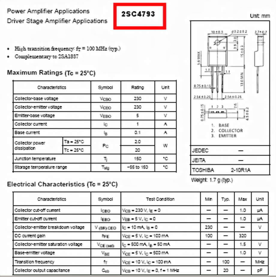

This ones will make you happy, will fit into many amplifiers, see the specs.
Observe data sheet...and see it is insulated, made with dark plastic material.
It is not expensive.... reproduces perfectly the sound that enters the base.

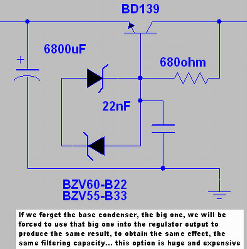

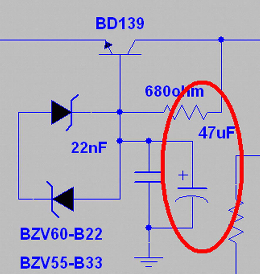

I forgot condenser that works into the rail regulators
The ones used to capacitance multiplier effect.
Please Nordic, include them into your prototype board.
They work multiplying this 47uf condenser value by the transistor gain.... and the gain is around 150.... so.... this is equivalent, has the same value if you place a big condenser from the emitter to ground.... as rail filter...... 47 multiplied by 150 results in 7050.
So.... the use of this "trick" you will have a "virtual" condenser, as rail filter for the input circuits, bigger than 7000uf... and WITHOUT the need to place "whales" there.
Of course...this is a matter of personal taste..if you want...place whales there, but remember they waste ground space... the are huge and use a lot of room to fit into the boards...and ugly as a hell (my point of view)... also shocking, as condensers are things made to supply boards, not to amplifier boards..we are using because we are crazy....or exotic if you prefer....ahahahha..maybe fanatic.
Also the current we have flowing into the input circuitry is very small... having not the need of huge condensers to stabilize... our 220uf is already an overkill.
Here is the circuit... this is the option 1... using the Capacitance Multiplier effect (see Doctor Rodd Elliot, our better teacher)
regards,
Carlos
here is the image.
regards,
Carlos
here is the image.
Here is the option 2, not to use the capacitance multiplier effect and the use
of filter into the series regulator output.
You see, more expensive, bigger condenser into the output.
And dinamically working.... both circuits have the same quality.
We are not using an extra transistor as error amplifier because there's a very small current variation into the input circuits...so...not needed to make corrections into the voltage.
regards,
Carlos

Pretty one alike that one you have made to the Dx operating 55V.
But do not bother to use parts reference numbers, as this will follow Nordic computer data.
If possible, place only values, 100 ohms, BC556, 100n....those things...no reference numbers.
This makes things easier to the ones construct without boards...doing their own boards, and so, they use the direct values, not to have R1 into the board and the guy will need a sheet of papper to translate what means R1.
You know...direct, instantaneous informs about parts values.
Precision II maybe will be this way...boards to be sold and instructions about construction and suggested parts...no parts going together... this will reduce Nordic work and will make me able to sell from my place too (not easy parts here)
Also when you place values, you do not need to give schematic..people will need only to place resistances, transistors and capacitors following board instructions..hehehehehe
Of course people can copy watching boards, but some parts will go assembled, in smd, and covered with epoxi cement...has to destruct the board to watch what is there hidden.... also a cover having a web of metal will confuse dentist Ray X.... infrared and Thermographic images will not show too.
The schematic is what i want...without parts number..only with the parts value is what i am asking you Todd.
Black and white, good image, without too much informs, only the essencial informs....PDF will be better (I can convert here)..but PDF must be smaller than 100K to fit our forum.
The sub circuits produces excelent sound, no one have discovered, only the one that create that.... and he uses different sub circuits compared to mine...so...copying mine will not know his circuits, and the opposite is true also.
Circuit tracking difficult also..diodes will confuse measurements.
regards,
Carlos
