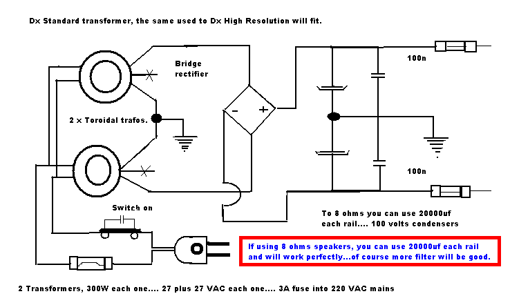

I have simulated... resulted in 200 watts RMS over 8 ohms
undistorted, continuous tone.
the rail regulator can be into the power amplifier board, or included into the power supply board.
I can arrange that if needed.
The difference is the fourth pair of transistors, as more than 340 watts will be possible into 4 ohms and this rail regulator.
Condenser will be into the supply board and into the amplifier left side (input side)

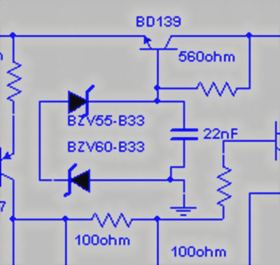

I am needing a good friend to produce decent schematic to me.... for the Precision
It seems this model will be the last.....well.... i hope so.
The rail regulator included, it is using 3 output pairs (not shown into the schematic (I could not...was too much ugly..a mess)... a switch as option to connect the power output to the feedback line or not to connect it to the feedback line.... or to have one connected to the feedback line and the speaker out from the feedback line.
A single voltage supply, that can be something from 50 volts to 63 volts simetrical (needing adjustment into the rail zeners to match your special supply).
Standard supply is 63 volts...others can be used....if you will use other voltage, each case can be studied separatelly...board will be a single Precision model...one board model only...how many output transistors you will solder there will depends your supply and your desire to have 3 pairs or less pairs.
This one will continue to provide something around 163 watts RMS over 8 ohms.... minimum, continuous, sinusoidal, undistorted power.
Atention...schematic not showing 3 output pairs...but the amplifier uses three output pairs.... and could be better to use 4 or 5 pairs...we are considering 8 ohms safe operation... and less safe 4 ohms operation (not dangerous).
The bypass, decouple rail capacitors, can go from 27N to 220N.... you can change them in acordance the values you find easier and cheaper in the part's market..they are not critical..only to drain HF and to cancell the electrolitic condenser inductance....a low impedance patch to ground only.

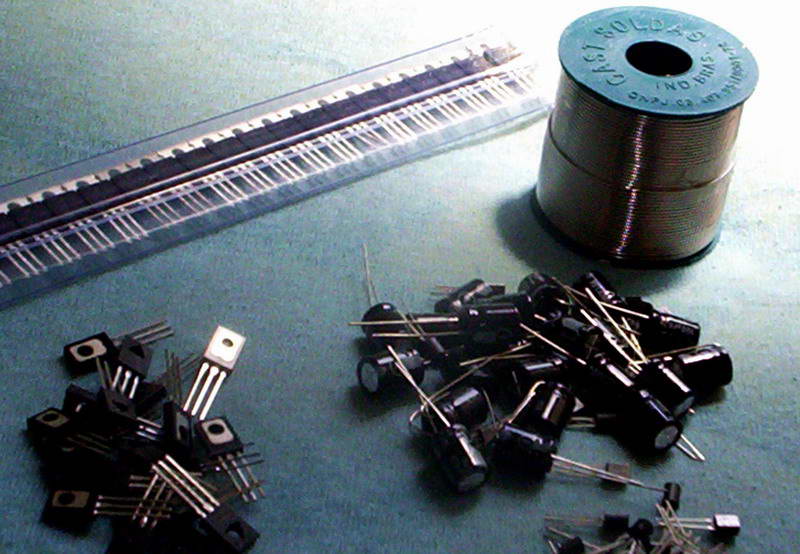

I was out..buying some parts into local shops
40 BC556C
20 BD139 and BD140
20 TIP41 and TIP42
1 Pound of solder
22 electrolitic condensers, Hitano, 100uf/63 volts.
Those folks are use to prototypes till 50 plus 50 volts...i use to burn a lot of them...the BC546C was already provided by Nordic.
My god!....50 bucks!!!!... means 50 US Dollares
Transistors from Fairchild and STI...matched ones...good gain

40 BC556C
20 BD139 and BD140
20 TIP41 and TIP42
1 Pound of solder
Solder is normal 60 by 40 ratio of metalic elements into the composition.

Hi Charly, Yep, sorry I woke up a little grumpy today, I suspect the topic we are discussing via e-mail has depressed me a little...
I will look at the new schematic a little later so I have time to go through it carefully... I much appreciate the extra work.
Hi Andrew, Yes I'm aware that lower voltage amplification voltage stage can only drive the outputs to the voltages provided by the front.... But I suspect carlos did this as a way to buffer the voltages on the front from dips due to output peaks...
The design was allready centred around 55V input stage... I just believed (I understand a seperate front supply is superior), that there could be quite a saveing on rather just regulateing the output sides voltages to the 55V...as per design.... It will save money on extra transformer, and if you are going to buy a case, one that has space for 2 trannies will probably also be more expensive... Think third world economy design for first world audio enjoyment.

All that is required are a pair of 5Vac low current windings added to the main toroid. Use either 0.5mm or 0.6mm diameter enameled copper wire.Nordic said:The design was already centred around 55V input stage... I just believed (I understand a separate front supply is superior), that there could be quite a saving on rather just regulating the output sides voltages to the 55V...as per design.... It will save money on extra transformer, and if you are going to buy a case, one that has space for 2 trannies will probably also be more expensive... Think third world economy design for first world audio enjoyment.
eg, 40Vac + 40Vac @ 5A becomes 40Vac+40Vac @ 5A and 45Vac +45Vac @500mA. A bridge rectifier on each of the 45+45 gives the high voltage low current supply for either a simple PSU or a cap multiplier or a regulated PSU.

People told me the Precision is expensive.....maybe, but we can make some reduction in costs...in special Dx crew that already have two transformers to use...just disconnect from the Dx Standard, or HRII amplifier you have and can use it to listen the Precision...
Here a sketch...how to use them together.
