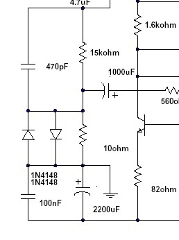

Here is the updated, corrected schematic.
Included the third transistor pair.... each one of them with their own emitter resistance.
Each one of them with their base stop resistance.
Each pair will need a suckout condenser directly connected into the output bases.... you see, into the circuit a single capacitor... better to use three...one to each pair.... the schematic is crowdy..not space to include more details.
The input condenser is 4.7uf or bigger.
If you will use 4 ohms and full power all time long.... into professional applications...then it is better to dissipate only 60 watts into each pair... 6 pairs will be good to hard work... to full power.
If you are bad... very bad...and will inject square wave into your amplifier.... 6 volts peak to peak of square wave.... low frequencies... continuous and into 4 ohms speaker...than use 12 pairs!
regards,
Carlos
No Monsieur Gaetan. not to remove them
Remove them ONLY and IF you find problems.
I have listened reports, from other friends, that those diodes detect Radio Frequency... also i had problems once, and recently i had problems even into the simulator.
It is difficult to me to explain things in English.... keep them in place IF you face some problems.... remove them, as the first suspect, if you have unstabilities.
I had....but..they are very protective to the 10 ohms resistance... and when that resistance burns the problems are very big...so... diodes are nice thing... they are needed...they are a nice solution...they are a clever solution..but they have shown problems.
Telling clear.... if you face unstabilities and crazy behaviors when measuring your amplifier, remove those ones, disconnect one side of each one of them to check if they are the problem.
Not to remove them....KEEP them in place...BUT, understand they can be a problem..attention on them!
regards,
Carlos

Dear Nordic
Good people, in our forum, some enginneers, some Masters and others use to suggest some modifications... the diodes was one of them... years ago Pavel already mentioned the need... and i know people that made that and had problems with Radio Frequency pick up... so.... some ideas can protect, but can produce some consequences... some side effects.. alike drugs.
Another example is the protection into the VAS.... people said..may blow...i tried to blow and could not blow...but peoçe re-calculate and said..for sure can blow..and i have tried real life and have not blow... so much they insist with that, i decided to include the protection... will not blow anymore.... will be technically better..but will sound worst... reason why i said...wanna protection?... use it.
But switch the damn thing off and listen.
The protection circuit, even well adjusted, compress the audio... the sound turns worst... and you can listen that high volumes switching the protection on and off.
There are decisions, token under the name of reliability, that kills the sound...it is a matter of decision, if the guy want an amplifier huge as a war tank or and amplifier that plays sound in a beautifull way.
Those diodes have caused "recall" of sold amplifiers... so... you see they are dangerous.
Do they protect?.... Yeah!
Are they nice solution?... Yeah!
Technically correct?... Yeah!
Politically correct?... Yeah
Do you trust in those diodes?.... not too much...just a little.... and scared.
There are many folks that knows more than i know...they may be rigth and i can be wrong...because of that you have introduced the diodes and you have not istened my complains about the subject.
regards,
Carlos
