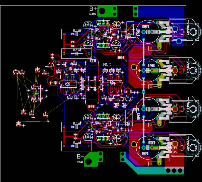

destroyer X said:
.... if you prepare a board to be perfect and waste too much long time, and decide to give it another look,you will see that something could be made even better... and this can make you to start all over again... to be efficient we need to reduce our obsessive behavior to match our modern world reality..... if we do not control those things we gonna have a lot of things we start and never finished...because we are never satisfied with anything...we have to learn to say "it is enougth" to ourselves, or the Madona of Michelangelo would never be ready.
Hi Carlos
How true this statement is....🙂 ......
I finished the PCB drawing for my new Bridge Amp, but alas I didn't like the layout. The signal wires were too curvey😀 and the components were not properly placed so I started all over again. This PCB takes a while to make in Eagle, but if I am going to pay a months rent to have it manufactured, it MUST be optimized. If that takes me another week or two to redraw it correctly, then so be it. However, I'm a few years away from 56... 25 years away....
This is how far I am at this point, still 3 circuit sections to build, much work yet to do but that's another thread...😛

Niko,
Had a chance to look at your recently published Precision BOM today. I am grateful for your work on it and your stellar contribution to the cause of DX bliss, so thank you!
However, I'm worried -- worried that those small pitched parts are carried over to the PC board design. I hope that the PC board will be more generous with pitch. (It would be nice to see a picture of the board design now that it has been prototyped - perhaps my gripes would go away when I see the beautiful spacious board layout).
Most metal film resistors of 1/4 watt are almost 7mm long - could we have 10 mm for all those 1/4watt resistors on the PC board?
There is a bunch of 100n capacitors that you have as 3x7.5. MKP Wima capacitors are 5x7.5. for 100n/100Vdc, and they are the smallest polypropylene caps that I know of and can get in the States.
On a different note - I spotted three difference between the BOM and schematic that I wanted to point out. (I know there had been a few mods, but these I have not seen):
1) BOM listed 470 uF for C21, C22 --- The schematic 1000 uF. (I would like to use much larger, like on the HRII)
2) C7 listed as 470 uF -- schematic 1000 uF
3) I don't see the 3k6 resistor that Carlos specified to replace VR1
Francois
Francois,
You missed the latest schematic at post #570. It is still missing the output fuse and output section bypass caps - these and probably some minor changes, if determined, will come in another schematic, when Todd has the time.
billabong.
billabong.
Re: Pitch of the BOM parts
Thanks Billabong - I have indeed missed the schematic of post #570.
Sorry Nordic, I thought I was helping to eliminate errors, but turned out to be the one that erred.
Francois
