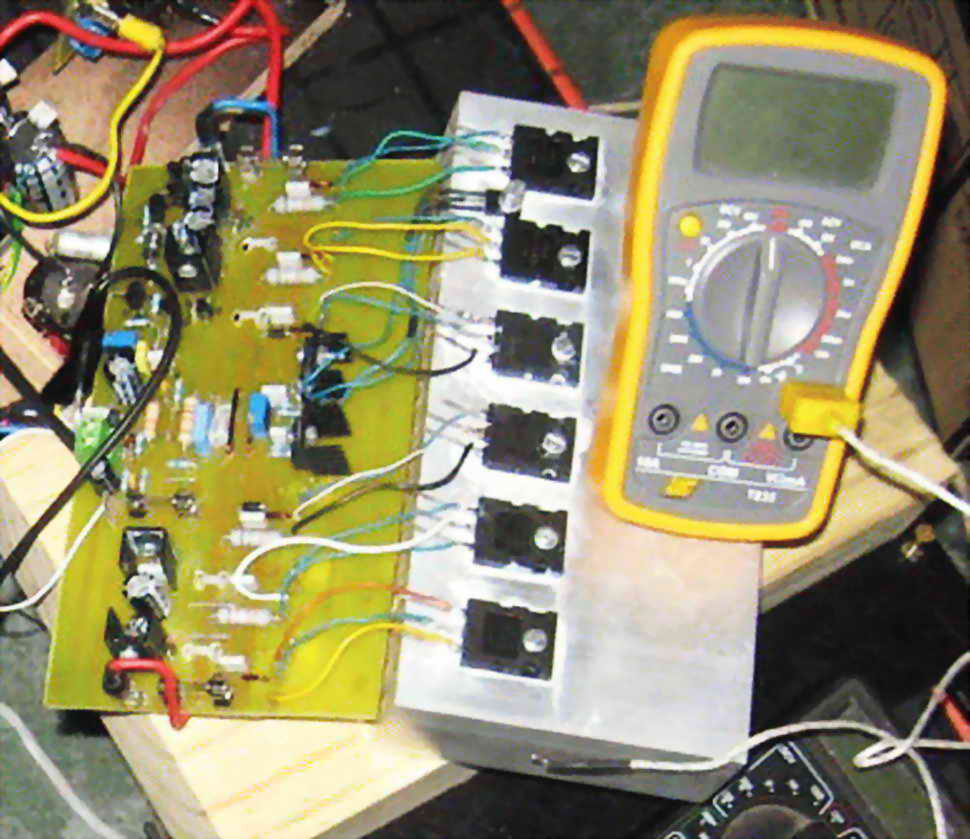

Here is a croped shot, the board is not fully representational of the final layout, but it was instrumental in finding the reason earlier prototypes would not work.

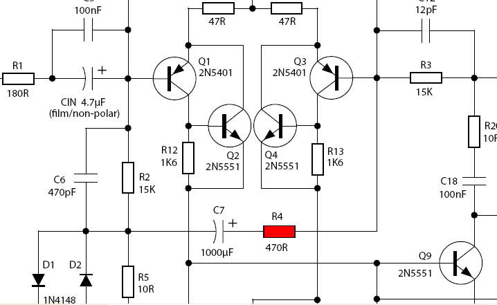

Well, sensitivity was adjusted to 750 milivolts RMS, and i imagine good for DVD
output and CD output.
But, as you use, during testings, the Ipod...it is possible to have low sensitivity to it as you have told me in direct mail.
We have R4 to adjust the sensitivity..so..if someone needs more gain, more sensitivity, if not reaching high power with audio source adjusted to full volume, than you can reduce R4 to 390 ohms or 330 ohms, 270 ohms or even 220 ohms if needed.
I suggest to keep the standard value for a while as we will already have to adjust R27 to 180 ohms, as the value show was a mistake because of Precision II that use this small value there..but with other driver current feeded by a CCS.... higher current than Precision I
Well... now one more step advanced.... board already had preliminary test..so... seems layout is safe.... next step is to test a board made into the factory and to release the Precision I to everybody.
Well... i can be wrong...but it seems to me that Line out level and impedance
the one we find in CD players, DVD players, Monitors, computers line out plugs and others are the standard.
Also the standard in level and impedance are the Pré amplifiers, and a lot of folks use them, because needed, to play Vinyl discs.
Because of that the sensitivity was adjusted this way but up to you builders, to decide the way you want and to adjust in such a way make you happy and matches your audio sources.
Here is the resistance was changed.... near future i will ask Todd Johnson, our friend TAJ from forum, to change this value and we gonna wait some days to see if something more will need to be modified to make the modification just once.
R16 will need the 2Watts mark on it...also R6 will need to be marked 1 watt and we gonna inspect more details too.

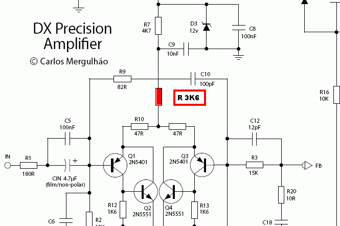

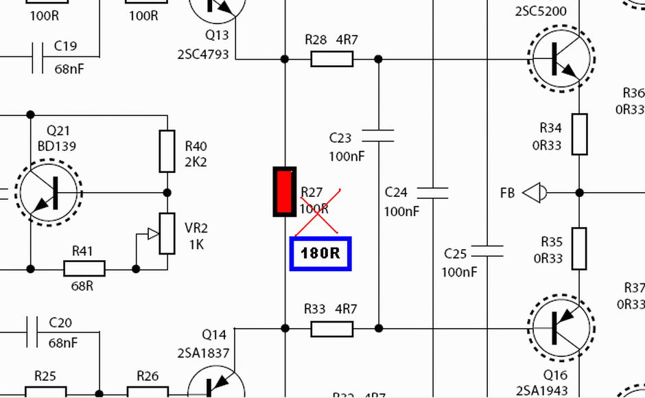

Be attention boys!.. this one will need replacement
A new value is 180 ohms
Was a mistake, because the Precision II.
Value correct is 180 ohms.... with the previous you have underbias into the output.
So, when you increase the main bias control you will have to produce too much current into the drivers (high VBE) while the output shows 480 milivolts only.... now, the VBE voltage is shared in a better way and you can adjust to from 2 to 5 miliamps to each power transistor related the colector to emitter stand by current.
regards,
Carlos

You have busted another old Myth dear Nordic.
People use to say that wires connecting transistor to boards causes oscilations.
And you have a stable amplifier...i always use this method even with bigger lengthes.... i have used 5 inches and wire was twisted one with the other and never had problems.
Of course not the prefered way..but you have busted another Myth.
Good....showing reality, home constructions, we show that a lot of Myths are not really truth.
Of course... small lengthes will be better...for sure....and better to be very short...but amplifiers works in other ways too..and sometimes (not always) very stable.

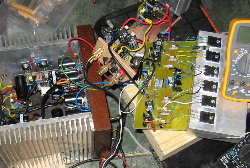

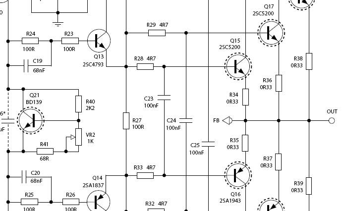

Todd Johnson, our TAJ, sent me the final schematic
Revised.
Very pretty work made by Todd...he is very good with Adobe Illustrator... his work quality is excelent.
Thank you Todd!
Schematic is attached.... drivers goes to heatsink, also VBE multiplier transistor goes too.
All other mid power transistors use heatsinks... and will be good not to use the smaller ones... dissipation there goes to 1.5 watts into stand by mode.
I hope you enjoy...

Carlos, heatsinks on Q11 and Q12 are unnecessary.
The collector current is ~20mA, the Vce is ~8V. Then dissipation is ~160mV.
Rth j-a of the device is 100°C/W, so even at 30°C ambient temperature the temperature of the transistor's case without any heatsink would be 30+16°C=~45°C. That's fully acceptable.

We know how to multiply current by voltage from coletor to emitter my dear.... also to observe datasheet.
Sometimes real world do not confirm our thougths, then we prefer to obbey what we find into real world testing.
Heatsinks are keept as standard, of course you can remove them from your units if you want dear Francis
