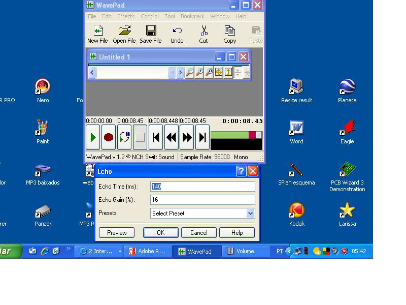

Jaycee.... i was thinking about you and i decide
To post some informations that may help a little.
Your amplifier using 48 volts will not need 3 output transistors as you already know, but you may use despite that to make boards seems pretty... will not be bad to use three transistors, but i could perceive in my home that when you reduce them the audio quality increases a little bit.... maybe they interact because differences they have as normally they are not from the same factory "waffer"... difference is small and can be inside my "illusions of perceptions"....maybe more connected to my own fears than to the real audio modifications...very subjective and i do not guarantee this informs i am posting here as something real...i would tell you i have perceive some...but i can be wrong.
What i mean with that.... a simple test is to you make audio recording using some wavepad program you have as freeware into the web, and them you make a post processing after recording, you add some echo... that means your audio repeated with smaller level.... then you adjust the delay to be almost nothing to your ears.... well, the sound turns more rich, as each tone seems a little bit longer, and in the reality it is longer because repeated... this effect is what i have perceived when i have installed 6 pairs of transistors in my home...i was very shocked, already had some fear about and when i listen was confirmed and i start to swet, fear to be suggesting things into the forum that sounds worse than the best possible.... responsability..that moment i could see in my mind as i was inside the Roman Coliseu and all forum folks with the fingers down to cut my neck into the gladiator's battle field..... and people screaming...lyer!...lyer!...lyer!...... yes.... i accept that this could be illusion, a product of my fears, the same way when i miss my mum (died many years ago) i can listen her voice inviting me to a coffee with a nice piece of cake....illusions from my broken heart only.
You amplifier may put out 98 watts into 8 ohms and near 170 into 4 ohms, but this if your transformer keep that voltage of 48 and if you arrange zeners to have 45 into the input circuitry voltage..... 30 volts zener if exists this value and 15 volts zener or other combination of zener diodes.
In the reality, the 500 VA transformer will not be able to hold 2 channels without loose a big voltage under hard load conditions, into 4 ohms you gonna have 3 amperes each rail (around 1.55A to 8 ohms loads)... and this may result your voltage fell down to 42 volts... this means your zeners should be "adjusted", in this case, to 40 volts.
This will be more real sittuation to a 500VA transformer i think..... and your gain resistor (R4), the sensitivity one, will need replacement to a value around 750 ohms (more or less)... your power will go down because supply voltage dropped (I believe it will under continuous tone, steady sinusoidal tone, maximum undistorted power) and will result into 75 watts to 8 ohms and something near 120 watts into 4 ohms.... this way, you can even remove one more pair to operate into 8 ohms and may use into 4 ohms if do not go full volume for too long....R6 will go to 2K7, and your current will be around 1.4A into 8 ohms and 2.5A into 4 ohms.
What this means..... the HRII big brother related power, off course sonics is different, but so many parts and work to have small difference in power....you will not perceive this as huge advantage, as we perceive more clear when the power is multiplied by 4, and this is the 64 volts version.

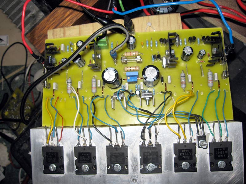

Great!... thank you very much to test boards, very nice you care to
give folks guarantee related your boards.
I see no flange, and good that you are showing a stable amplifier even having long wires connecting board to heatsink... this is one of the Myths people use to believe.
I see i gave you a hard time because of those boards, and i thank you very much to tollerate the bad mood i had in many moments, you behave kindly all time long... a very nice man you are, and also very competent, now very skilled with boards.
Aussie friends sent me mails and have complained the way i was talking with you..... you see that good friends do not let things goes wrong and you have a lot of friends into my aussie friends too.
Lovely those aussies, despite i know i had good reasons to be upset, i see i was not kind... they called me rude... and i have to thank them to say to me:

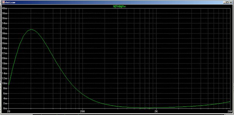

Hi Carlos,
I just did a THD spice analysis of your your latest amplifier schematic (see below). It's good from 300Hz - 20kHz (under 0.003%), but there's a peak of 0.03% at around 40Hz. Do you have any idea whats causing that?
I used Helmut Sennewald's perl THD script attachment to LTSpice
Murray
Murray

No... i do not know the reasons of this peak
You may not know me.... i am not a real designer...i use to make the Dc design only and to join sub circuits together...and them i go tuning using the best top modern instrument... the Spectrum Superb Harmonically sensitive wave meter THD sensitive instrument ever made.... EARS!
So... things goes this way... i found bass huge.... was an accident, nothing desired or previously decided into a working bench, simulator or calculator...i have accepted as interesting, as people loves this frequency (also sharks love this frequency).
I am sorry to say... i have no idea how i could get there.
I would say that i am protected by all the Gods...they love me and everything i do sounds nice...big magic.

Re: No... i do not know the reasons of this peak
I've looked into it a bit further Carlos, and what causes the increase in distortion at low frequencies is the 470R/470uF filter on the feedback connection. If you lower the frequency of this filter (make C7 larger for example), it shifts the distortion peak lower into the inaudible frequencies. Whether this has a bad affect on the performance of the amp in other areas or not, I don't know.
By the way, I must compliment you on an excellent design - it performs very nicely in simulation, and I'm very interested in building it.
Murray
Murray
