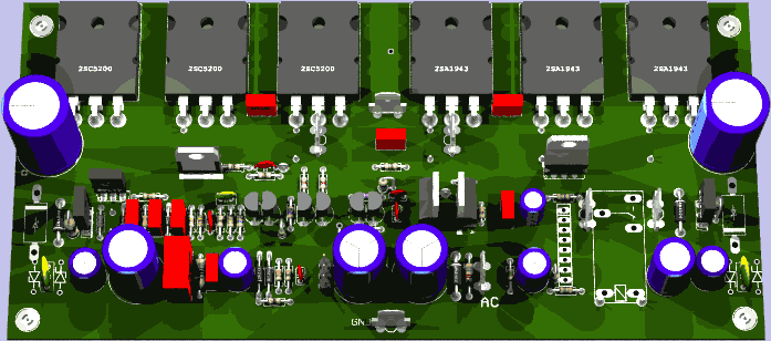

Have a look at a P3A PCB from ESP as it's a great example..... you can mount it several ways.

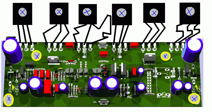

The same as suggested above as a sandwich, ala AKSA (ledge heatsink)
The devices under the PCB ala P3A or P101 (flat heatsink)
The devices at right angles to the PCB as per the HRII..... would require a scored section that can be removed (flat heatsink)
That way all camps are catered for. It was and is a very clever layout from Rod.
The trick is, the power resistors go under the board, and therefor the area under the output transistors is mostly used up.
The only other option is like mentioned above to go back 2 or 3 layouts to where the outputs were on the edge, and then have an area that is scored but not cut. so you can also mount them flat... although that would be a comparatively more expensive excersize due to the unused board.

Ehem.....not to disappoint you, I indeed vote for the non-bracket installation. Why? It allows a bit more flexibility with non-custom heatsinks. But I don't feel strongly about this, and besides, Nordic already has his board design. Your point about increased capacitance caused by PCB installation is something I have not even thought about. What effect does it have on performance/sound?
Supporting the PC board at all four corners is good and nylon spacers are easy and cheap (at least States side). I believe heavy aluminum angle stock for the bracket will be harder to find for DIY crowd.
Francois
P.S. I already have heat sinks that are 300 x 135 mm with fins in the 300 mm direction.
I bought them here (http://cgi.ebay.com/ws/eBayISAPI.dll?ViewItem&Item=170185437891&Category=31489&_trksid=p3907.m29)
Plans were to install them vertically with both fins facing each other and enclosed to form a "chimney" (with fan) in a columnar enclosure. With the "AKSA" bracket mounting method the board will be sticking out, away from the column.

Carlos what happens to your picture if you install the transistors upright...? i.e. not flat... so the PCB and flat heatsink form 90 a degree angle...
I agree trying to get even two transistors properly lined without some board or template on a flat surface is damn hard, and 6 will be pretty silly hard...
So the person who had the idea of adding an area that can be broken off optionally might have the most flexible solution... but it is the most expensive...
Re capacitive effects, you should be ok as long as you have about an 8mm clearance between the PCB and heatsinks...
Before I lifted my HRII boards away from the sinks I could hear it when I tapped the heatsink... and stargest thihng of all, I have this one old CD player that would stop playing through one channel when that happened... would work fine if powered off and on again... all I did to fixx it was to move the board higher from the sink. Didn't even need spacers... Cut M3 thread into the holes on the board and M3 holes into sink so I could adjust the height using just the screws...
David, you could still mount on your heatsink using a U shaped piece of aluminium angle I guess....
But our objections seem to be based around the same thing... where to get the alu from... and will it compromise heat transfer to the actual heatsink....
I think the easiest answer is to just get the prototype build up, and see if the damn thing works... I am still haveing sleepless nights as I got so little feedback from HRII yet... maybe people are just trying to be easy on my feelings...

I like best the mounting approach suggested by Carlos since it provides means of supporting the board without any additional screws.
If the transistors are attached directly to the heatsink it would require either an L-bracket to secure the board (if perpendicular to the heatsink) or four spacers (if mounted parallel to the heatsink). Yes, I am a lazy bastard...
I wish "flanged/ledge heatsinks" would be easily available here in the US... I guess I will keep looking on eBay.
Regardless, the board design to accomodate either the "flanged/ledge heatsink" or the L-bracket would be the same.
I think Nordic's most current design (shown on post #302) reflects what Carlos is asking for.
The layout shown on post #278 would also work if a large whole is drilled to acomodate the quick disconnect spade. A little more work, but not a big deal if really required.

Three votes to "L" profile mounting... 1 vote against.
Stuey and Rabbitz have not confirmed votes... seems to me Stuey will vote "L" profile and Rabittz against..but i cannot compute those votes, not clear, not confirmed.
Also Duda was not entirelly clear, but left strong beliefe into "L" shape mounting adaptor...better to return, dear Duda, and write clear..vote of "L" shape!
This "L" is made at home with a piece of aluminium..the door gap or some metal gate.... you insert the aluminium and bend it with your hands.
