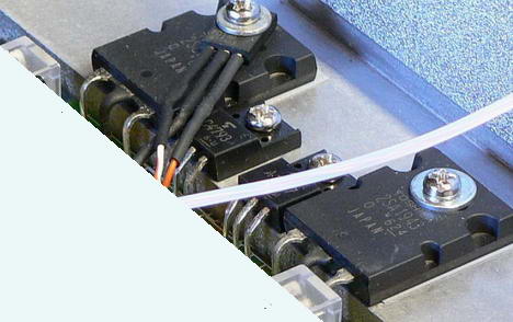

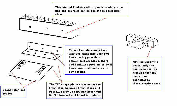

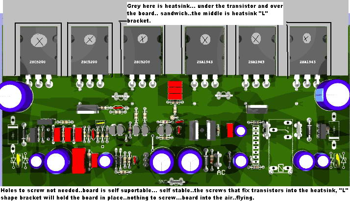

The heatsink will be a "L" shape bracket.... aluminium in "L" shape that enter under the transistor...the aluminium goes between the board and will be also under the transistor.
Alike a Sandwich.... into the middle is the heatsink.
This makes the board to be fixed by the transistor screws..it is to he hold (held) by those transistor screws only.
the board may fly...nothing under...or, some metal rule will fill the gap between the transistor and the heatsink if this is the builder decision.

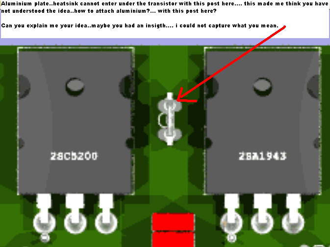

Nordic, there is a post into the middle point..between the power transistors...nothing can be there upper the board... that place will have the transistor.
Negative to mount the transistor under the board...if the builder wants to do this way.... no problem..but the amplifier is beeing made to use "L" aluminium.
Transistors under the board are not standard...i do not like them under...i feel them very ugly that way.

Hey Carlos, I know what you said.. and I made the boards like that...
People are just asking the same questions I did... Why add an L-Bar If you allready spend money on a heatsink...
It is fine for the cases you sent me pictures of, but such an unnessecary thing for other cases...
Nevertheless I don't feel like redoing it that way again...right away. So we stick with the way Carlos wants it... He da boss!
Yes there is a tiny seperate piece of board for the VBE now...

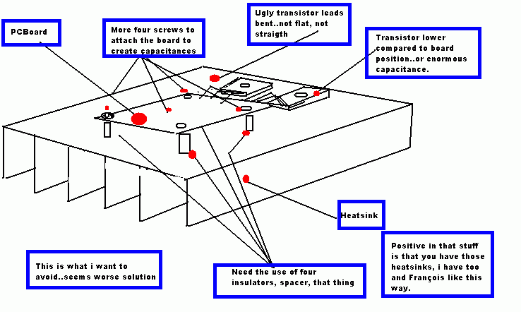

Because you do not need to use insulators, plastic tubes, ceramic tubes or whatever you want, under the board, to attach it into the heatsink.... also, not doing that way....not installing board into the heatsink, say..over the heatsink, laying down over the heatsink flat surface (back the heatsink in the reality) you will not have the capacitances... the heatsink is ground.... a ground place, so..you have capacitances from many board points to that ground..the flat heatsink surface.
The other idea, the one i defend, the board goes aerial... and there are heatsinks into the shape needed to fit the board..or only in Australia?
Also, the transistors, under the board...or going down to attach the heatsink surface are a hell ugly... seems very amateur, and we are trying to make better, trying to develop better things..into a development moment.
To use into a flat heatsink, the one you have for instance...i have those ones too, you will need four screws, for spacer, insulators, plastic tubes or other material to attach the board over the heatsink...and more.... all the transistor bolts and nuts...when you can only have the transistor bolts and nuts to attach the whole thing.
Dx amplifier started this way.... the way the heatsink entered between the board and power transistor was that way.... the HRII i left you free do do whatever you wanted.... and you put the transistor in that way i do not like...fitted your heatsink, but did not have fitted my heart feelings about..was a baby that born with health problems in my heart.

This is what i want to avoid.
Not "da boss"... i do not like that "vision"...it is wrong.
The idea to attach the board, used by Aksa is much better.
Reason why i want to use it.

Relax Carlos, we are making the boards the way you like....
I am still trying to get angle stock locally, amybe once I have found some, I can relax too... at the moment I am just stressed as I will not be able to test the boards before I can get metal brackets... even if my sinks were all I needed...
There is no disagreement... I see what you want, and hopefully did it that way....
My first designs just suited my materials availabe better.. I.e. I could visualise the whole process of assembling...
Now I have to find metal stock, cut it to size, tap holes to attach it to the sink, then tap holes to mount the transistors... same amount of work realy, it is just diffirent ways... it is probably all the same...
Do not get dissapointed because you can not seem to "convince" me, I am much more hard-headed than you. I have no problem in agreeing to disagree, and to give the other guy's point of view a try... I can always go back to my prefered methods if things don't work out, and on the other hand, maybe even learn new tricks...

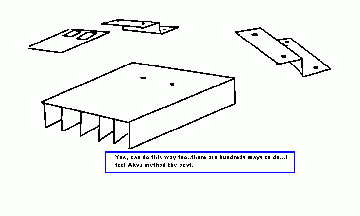

There are hundred ways... i have just selected the one
I feel as better in how it looks, into technical details too.
I feel the solution used on Aksa the most intelligent idea.
I could not see any other one better, my point of view.
Yes, there are better saving space ideas..but this one has class..elegance.
But i am ready to accept forum opinnions.
Vote please!

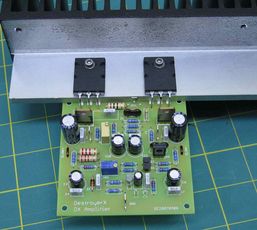

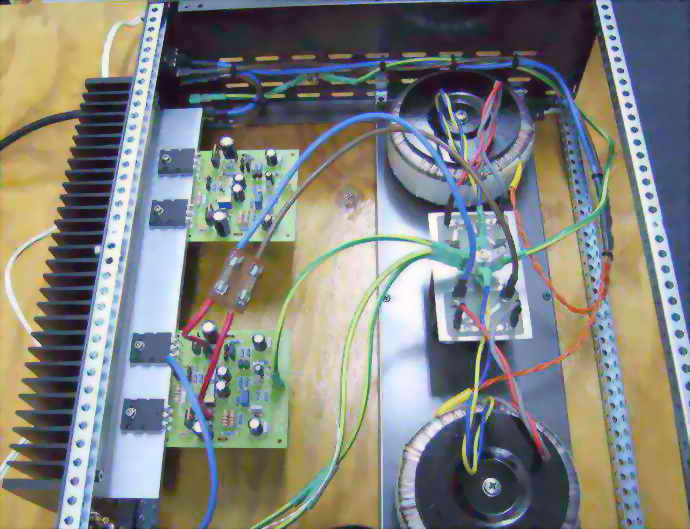

Erskine's Implementation
It looks like Greg's solution was to use standard L-shaped stock (or he had a piece bent), and then married it to a flat surfaced heat sink.
Am I correct?
Also, if this is the case, can you just use the bare metal to metal contact, or just a WHOLE LOT of Thermal Compound for such a long connection.
I apologize in advance for such a basic question.
Dave
You should never use a WHOLE LOT OF THERMAL PASTE EVER ANYWHERE!
Paste should be applied as thinly as possible, it is to fill microscopic (and larger) pits in the metal surface which otherwhise would be occopied by air, which is a thermal isolator (anti heatsink) The paste itself actualy does not have that good thermal transfer, just a hell of a lot better than air...
So idealy you wnat two perfectly flat polished surafaces meeting each other...
A good way of lapping (to sand surface flat), is to take some glue (I use common cold wood glue, even used Pritt) apply to the back of a sheet of sanding paper (I have gone up to 1500grit for my computer's processor) glue the sheet to a flat piece of glass (easy to remove afterwards... I just use a mirror) now you have a flat surface to sand your block, chips, transistors, etc. on
Whith the flat surfaces you then want to apply an almost seethrough thin layer of thermal paste... (which is not so easy with the white goop sold for electronics... But I reccon a tube of artic silver will probably be enough for the amp, if you want to use something a little better for a fiver.
Am I correct?
I don't think so. There are a few electronics sellers here in Australia that sell a 300mm heatsink which looks like the one in the picture and contains a 'shelf' at right angles.
See www.altronics.com.au for example.
