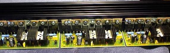

My preference would be for no L bracket. I like the PCB parallel to the heatsink. Less case real estate consumed that way.

Five votes for "L" shape adaptor and 4 votes for boards running parallel to heatsink
Could you perceive, folks, that you have to disassemble all the stuff to repair...have to remove transistors and screws that attach board to the heatsinks?... if dessolder transistor leads they may broke into the point they enter the black epoxi case.
Also the capacitive effects, board near the heatsink?
Well folks...one more vote and we gonna close votes.
If result 5 to 5 points..i will my chairman position to order my preference.

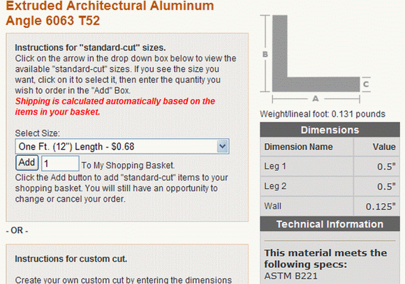

US Angle Stock Vendor for that L shaped piece.
I haven't used this vendor, though I've heard of other people gettnig great results.
They will cut to order the angle stock of your choice: OnlineMetals.com.
They have 2 different aluminum angle stock types, 6061 and 6063. I don't know how they they compare regarding heat dynamics. According to their website, type 6063 has a smoother finish. That would seem to make it the obvious choice for ease of mating to another surface.
And their prices don't seem too bad: 1" x 1" x 1/8" (2.54cm x 2.54cm x 0.32cm) is $1.41 per foot or $0.20 per inch cut to suit. They claim to have no minimum.

6061 Aluminum
6061 Aluminum is, by most any measure, the most commonly used aluminum alloy. It is specified in most any application due to its strength, heat treatability, comparatively easy machining, and weldability. If that were not enough, it is also capable of being anodized, adding a layer of protection for finished parts
6063 Aluminum
6063 is often called architectural aluminum for two reasons - first, it has a surface finish that is far smoother than the other commercially available alloys, and second, its strength is significantly less (roughly half the strength of 6061), making it suited for applications where strength is not the foremost consideration.
6063 is rated as "Good" for forming and cold working operations, "Excellent" for anodizing, and "Fair" for machining.
In other words you want the 6061 as it is easier to drill and tap...

I vote to "no L shape". like lynx v3.0
it will save many space into the box. n look very cool!!

to my knowledge it seems that there are 5 votes FOR the L profile and 5 votes AGAINST....
this is normal .... each of the design aproaches has its own positive and negative sides........
