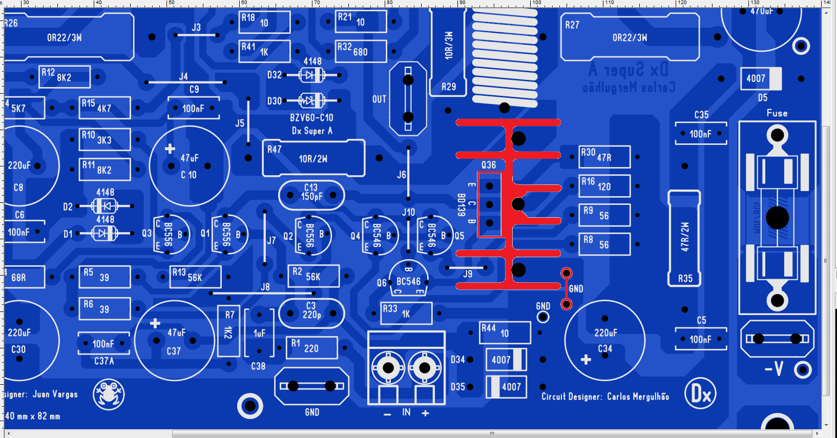

i used willy b cerna board. everything ok except dc offset -20 v...!!!
is it because i use ordinary simetris 5a 20v for psu?
man... my inductor are burning. 1mm 12 turn 1.5cm diameter
No, amplifier is functional even with +/-12v

Check if you put out.trans npn on (+rail )& pnp on(-rai).
What type output transistors you used ?
Do not connect any output load before you see <100mv out D.C voltage.
Many times in this forum has explained the right method for first try after building.
If you don't know how test this,please ask again.

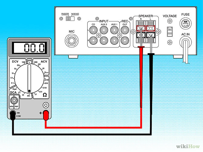

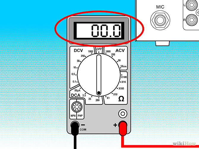

when you say -20V do you mean -20 mV ?
here is what I found I know there are amplifier that can have even lower offset reading but reality is that I let that subject to experts.
How to Measure DC Offset: 5 Steps (with Pictures) - wikiHow
Analyze the result of your reading. The ideal amount of DC offset is 0, which results from a perfectly balanced AC sine wave. In reality, an offset between 0 and 20 mV is very good. An offset between 20 and 50 mV is slightly higher than the ideal range, but the distortion caused will barely be audible. A range from 50 to 100 mV will begin to cause noticeable degradation of the audio quality, while an offset over 100 mV may cause permanent damage to your speakers.
don't mind about the meters the illustrations are wrong 🙂

mr thimios, why bd139 wired to ground? i used c5200
NO,the HEATSINK wired to ground ,not the bd139.
Bd139 MUST TO BE isolated from heashink(use mica)
2sc5200 is NPN and must to put this in plase of mjl4281
2sa1943 is PNP and must to put this in place of mjl4302.
Do not take care for these 10R ,now it's important to solve this -20V output D.C.
Thimios.

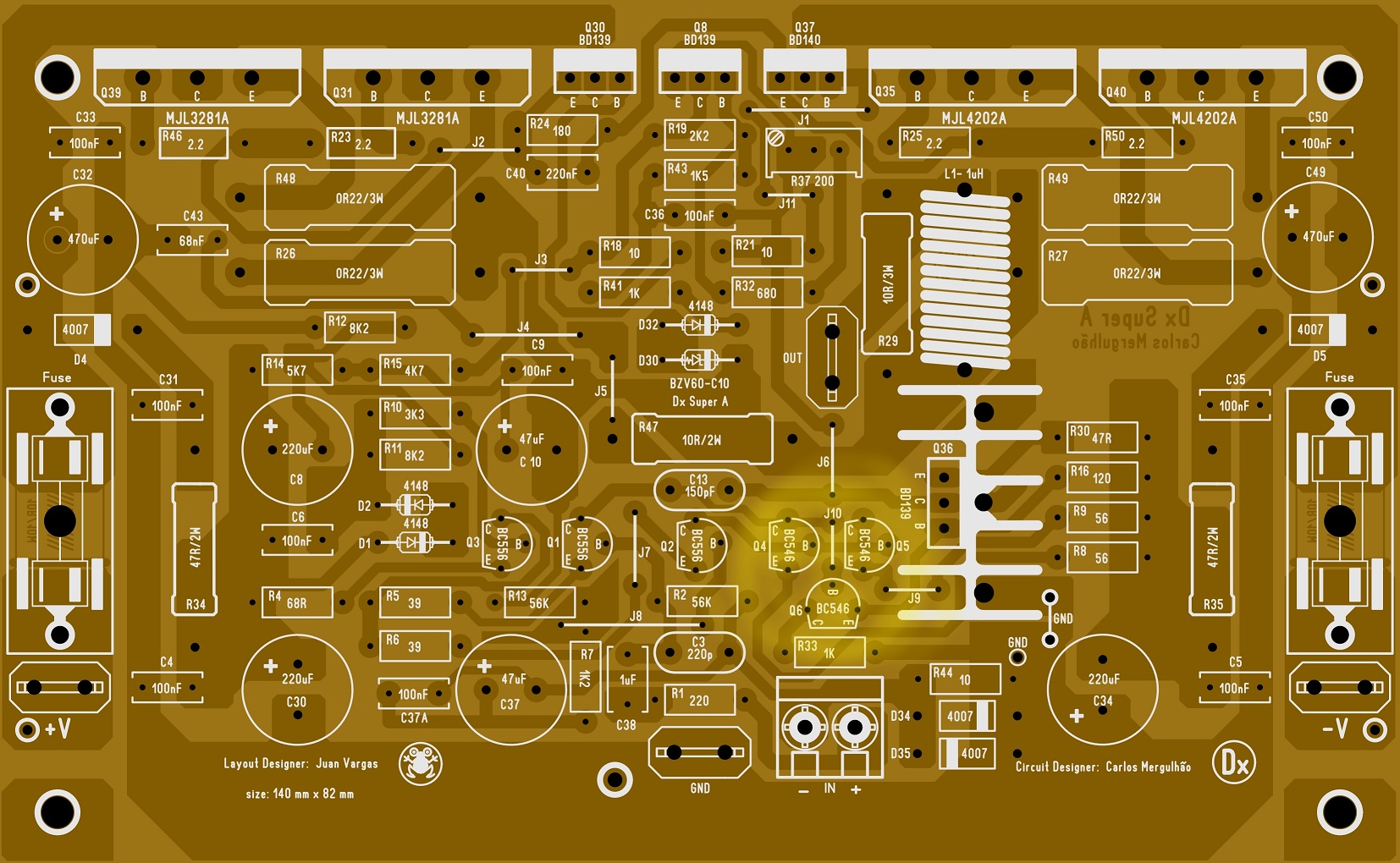

On my first boards I use 220nF on the new ones I use 100nF honestly I did not see any different in sound or other changes Mr bagus
now that I'm thinking if you have -20V of offset probably one of the TO-92 are defective maybe you install with out notice counterfeit ones
it does happen a lot.
Juan
sorry i dont have the camera. my bc546 n bc556 kind of strange. its pin same as 2n5401 n 2n5551. i revert all and start all over again, n bias is set. but offset back to 12volt not mv again. n input have huge current amount 1,5v. hhhhh... this must be the cause.
thx you all for helping me.
Mr bagus I guess you can but remember you have to rotated them at 180 degrees because legs has different pin orientations I mean if you don't have BC546/56 on hand at least with those 2N5401/2N5551 can get you going but keep BD139 and BD140 if you know they are not counterfeit you should be good, what brand you use ? I usually use On semiconductors brand

yes mr vargas. i put 2n5401/5551 and turn it on...
damn... it's on and a LIVE....!!!!
bass so good with compact mid. I LOVE IT...
thank you mr Vargas, mr Andrew, mr Thimios and speccially to author mr Carlos.
thank you very much. you give me a lovely amp
