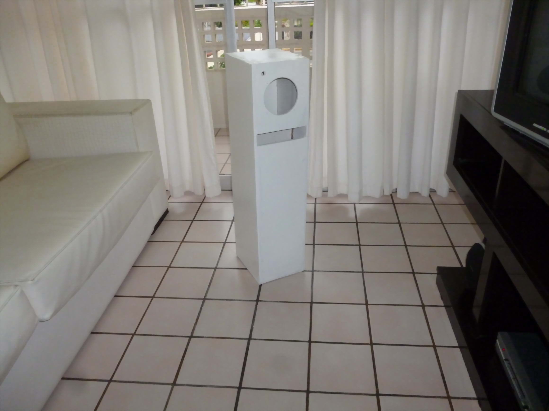

I am still doing my stuff...but now in secret...not DIY anymore.... doing for Brazilians in most of the time....finishing speaker with 2 meters or folded tube inside...Transmission Line speaker...having fun...as i always had....it has valves to open and close saxophone alike.

Speaker shown, externally is Baubo, a Brazilian design..but internally it is not anymore.... it is Dx..the tube solution is mine...uses compress and expand method... exclusive design not shared with anyone...even when i send layout to some friends to copy i am sending the standard Baubo and not showing my discoveries anymore.

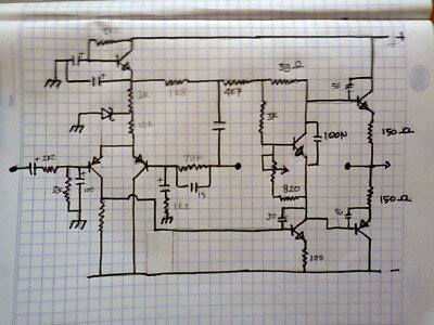

In India they have made an industry....in Facebook
you can see the factory...the guy came to me in 2009... asking about a good schematic....now we know the purpose.
See the schematic...the Dx amplifier with some makeup....differential feeded by a voltage regulator with zener reference.... differential colector load as resistors, simple VAS, bootstrap and emitter follower.
They use this kind of schematic because it is really nice..in special the bass.

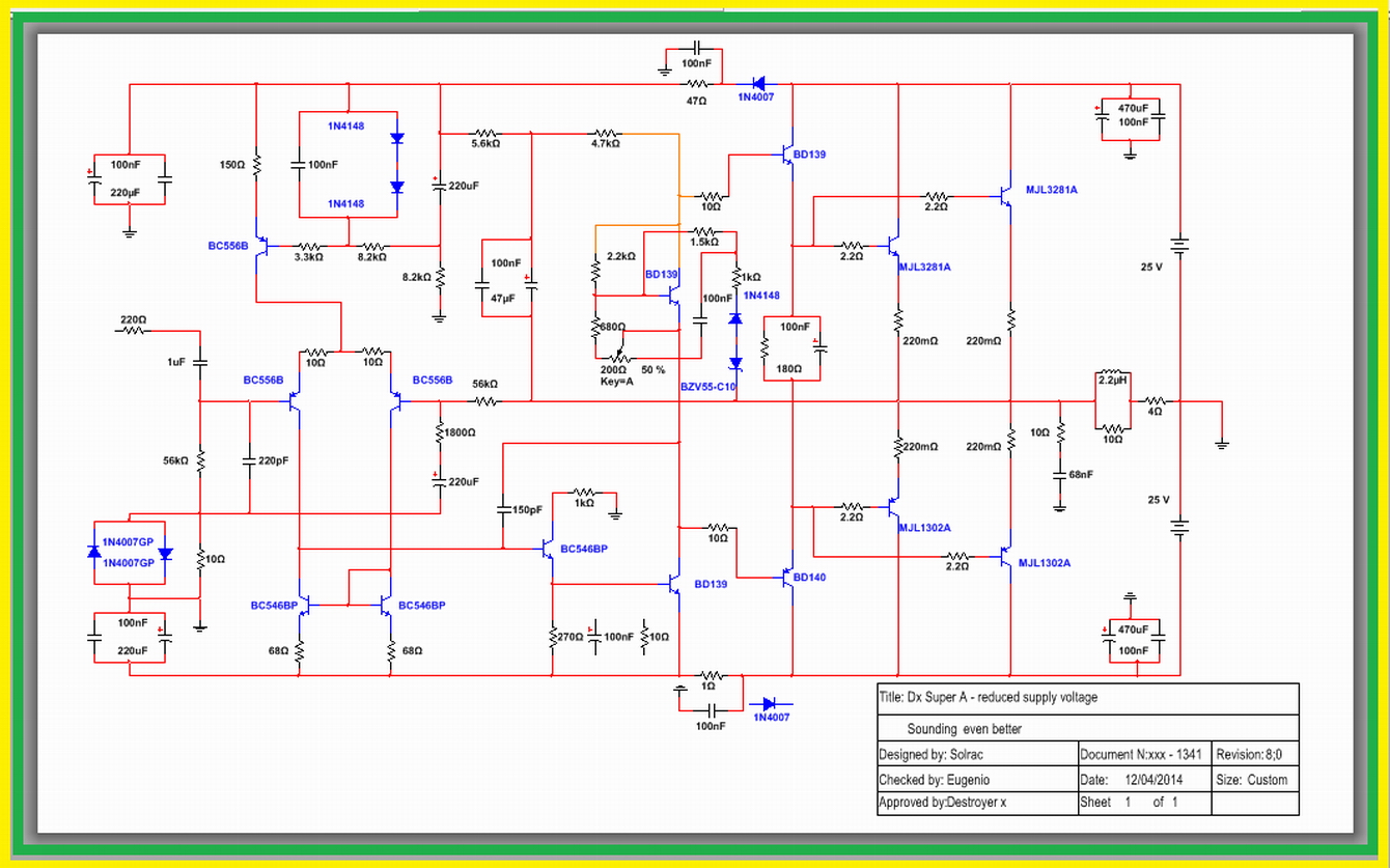

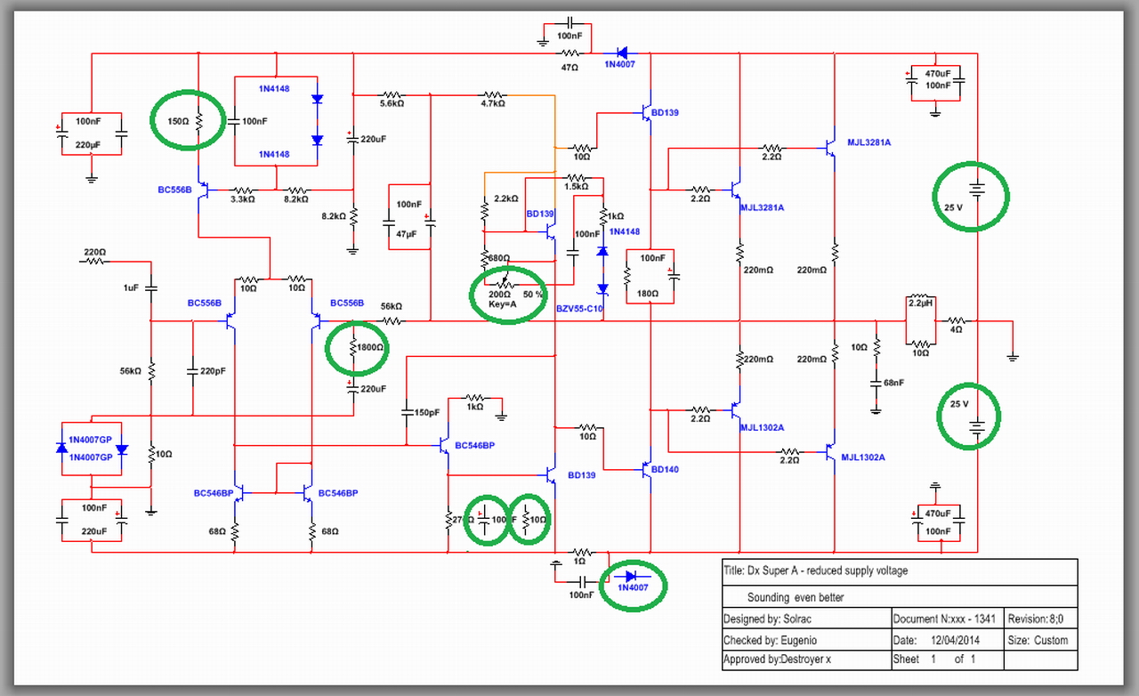

The Dx Super A, dear Terry, is something a little bit problematic to me...you know, i drive myself into the new world of non DIY products....without shared schematic.... top secret....all that stuff....but i found difficult to make something better in sonics...it is really lovely.
But i feel something interesting in my home.... it is sounding even better when i use lower supply voltage.... i have several models, all them Dx Super A schematic...but it is clear to me that some of them (2 in 6 stereo amplifiers that populates my home), the ones are feeded from 23 to 25 volts DC are sounding even better...maybe because of BD139/140... the linearity maybe.... in these ones i have reduced the bias...so...not more that increased stand by bias that i have named Dx Super A..... just 90 mA per rail...and sounded better.
Mine ones have not that capacitor (100n) in parallel with second VAS emitter... also i have reduced current into the CCS to the differential...that resistor atop the CCS that controls the current.... well...will post the schematic soon.

Well...to understand what i did..please, go to the video
Then things gonna be clarified:
https://www.youtube.com/watch?v=9cR1SSFGyik
It is raining cats and dogs in my place!🙂
I am still sleeping.... video was cutted in a half by accident (the rain).... but watch the schematic and you will see modifications..observe 270 ohms in the first VAS emitter.
regards,
Carlos
