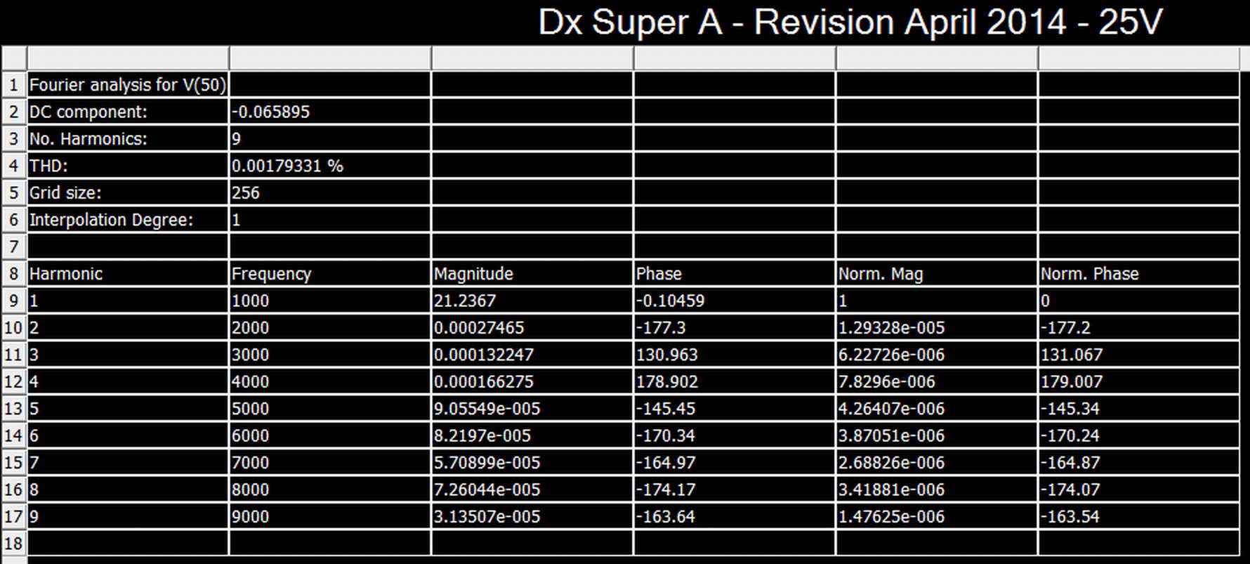

Fourier have not became better.... in the reality it is worse
I had a better ratio in between second and third harmonics... at least in the simulator.
Well...this takes all parts as some standard... real world parts are never that way....so...this is just a "reference"..not something to take too much serious.
This is under 4 ohms load....60 watts RMS approximately.

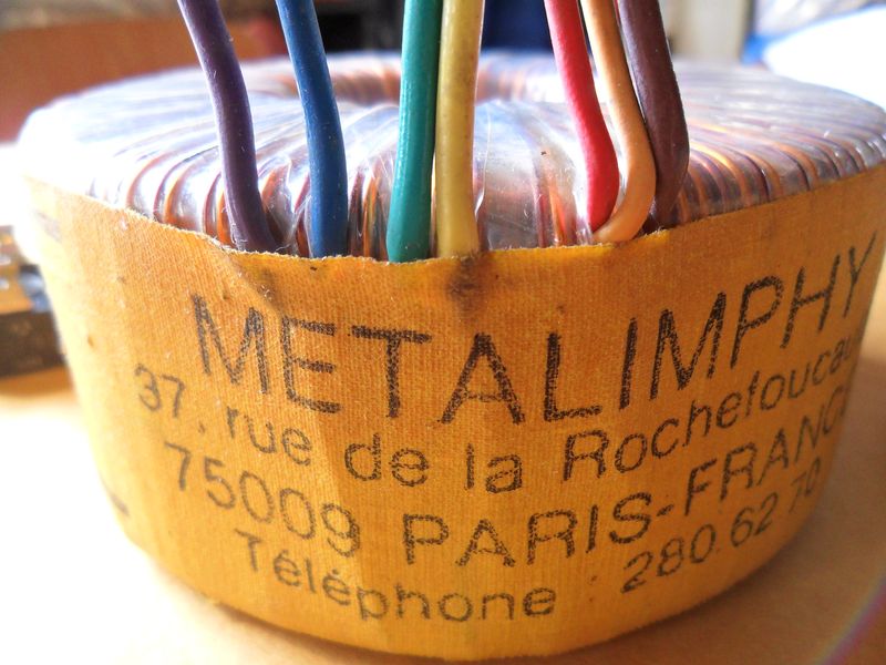

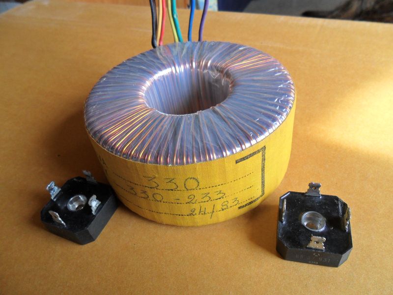

I have recovered an old transformer "Metalimphy (2x33V - 330VA)" and two diode bridge rectifier "Thomson BD37931" in my attic. The transformer was for 220V but the 240V which is now in France, which gives me 2X37.5V output.

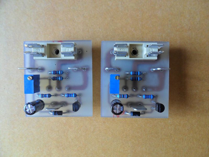

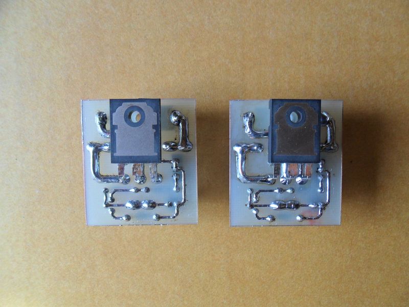

I have created two controllers that give me exactly 40V.

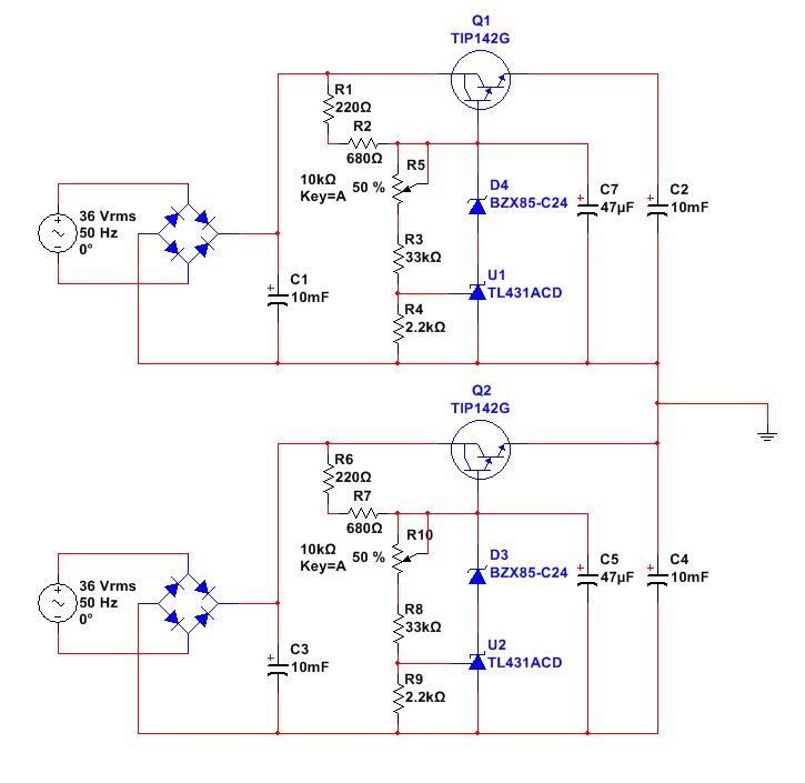

TL431 Regulator
C1 and C2 are capacitors bracket (CO39).
I realized two Postif regulators for + / - 40V and ground.Do you've a schematic and layout to share of those controllers?
