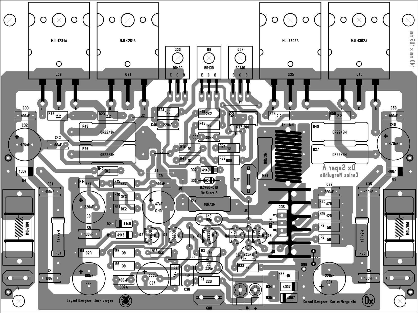

I made this last night the Dx Super A BOM and images so you guys can have and idea what to get, I use DigiKey websites as reference, I personally used DigiKey because they deliver faster to Puerto Rico and shipping for me is lot cheaper too, you guys probably have the supplier of your preference too, I already order parts last night so I hope I can get those parts soon.
Regards
Juan
Hello Juan,
Can you post component guide with tracks in gray color and white background, tracks can no longer be seen on actual printout with this green or blue background, Thanks...
Got you Willy ! 😉
Regards
Juan

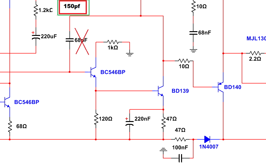

I have made some torture tests, and i understood it is better to increase
Miller capacitor value...trying a different transistor (Video) i found this need.
So, here is the suggestion, increase it to be in the safe side.

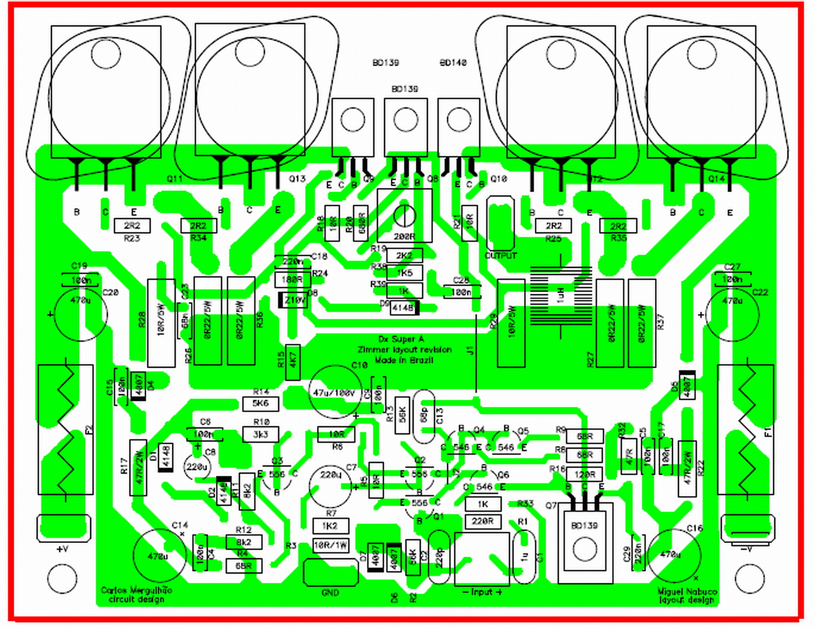

Zimmer, from Brazil, will produce pcboards to supply internally in our country
But he can also provide you boards if you need.
Now a days we are testing.... he will assemble to test using scope to watch if something in the pcboard is creating problems...square wave, triangle and sinusoidal in several frequencies and levels will be tested.
Then he will order first batch of 100 boards to provide Brazilians that have already reserved.
We decide to provide the option to T03 because our rednecks have not sophisticated transistors in their towns...they have to order into the WEB and people here do prefere to go to their shops and buy from someone...our tradition is this way...and people want 2N3055 and 2N2955, so, i have prepared a pcboard in order for them to use these transistors into 8 ohms and with some reserves to use at 4 ohms (in this case i have suggested some modifications).
Also people here wants TIP35/36, because they are the second most popular transistors in Brazil, used in hundreds of automobile amplifier models.
So, we will provide these three options in a single board.

BOM for Zimmer's pcb
Hi Carlos,
Will Zimmer's board accept the same BOM as Juan's? I mean regarding the physical size of components.
Cheers
Hi Carlos,
Cheers
I have asked Zimmer, he will prepare the BOM
Then you gonna have it..... wait a couple of days and write to him, he may share black and white layout and BOM.
The gerbers he was instructed not to share because pirates are terrible now a days in Brasil, they are searching for good amplifier and they are copying to sell in Brazilian free market (E Bay)..so, we are not publishing gerbers anymore the way we used to do because of that.... not publishing and not sending to people as we never know if the one we are in contact is a pirate or not... we cannot know people decense while in internet..this depends on long knowledge and close non virtual contact.

Compared to the Dx Blame St i have made modifications...the inclusion of a 1K resistor in series with the first VAS colector, the gain resistor now is 1200 ohms, the input resistor that sets the input impedance is 56K and this will allow you to use 680n capacitors to the input.... maximum is 1uf in the input and please try units with small insulating voltage..do not use big ones to 250 volts or more...better to use 6 volts of insulating voltage there...or even less..capture electrolitic condenser from a junk... small cassete players, small radios.... these ones have small insulating voltage condenser and capacitors due to their supply voltage that is low.
regards,
Carlos
