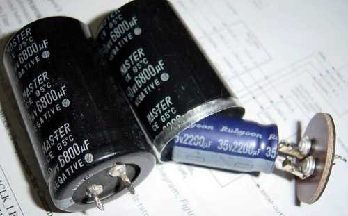

I have images of several capacitors if you want
To make your life easier to identify them.

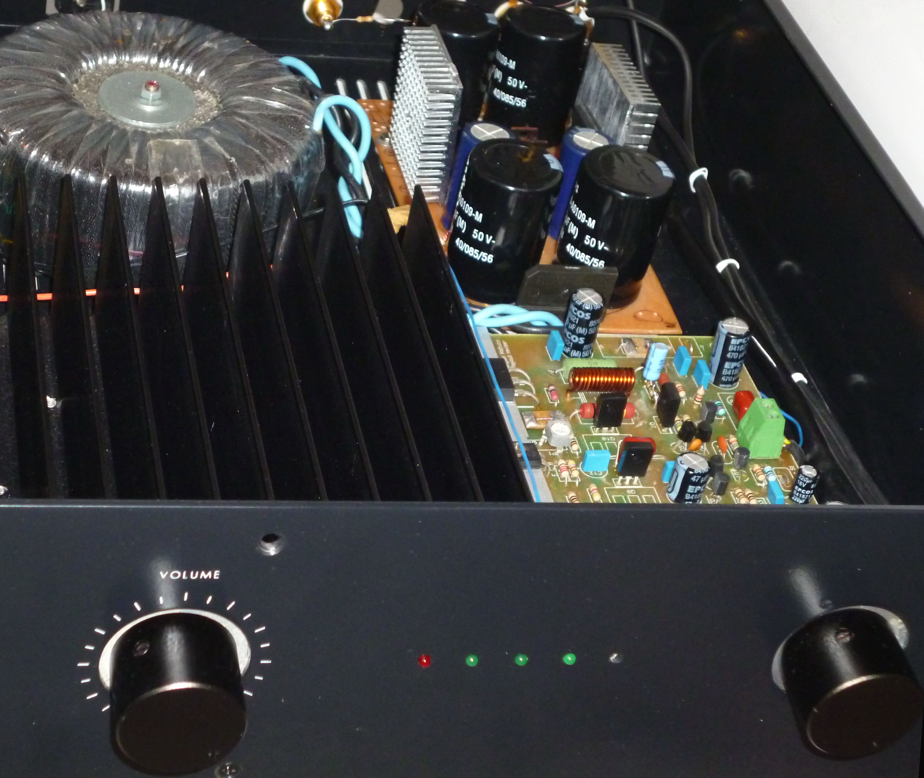

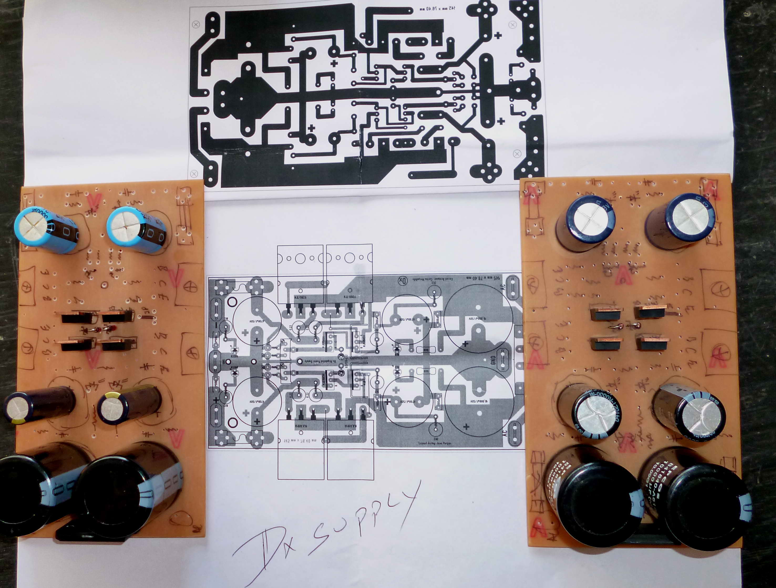

I am preparing the Dx Supply to the Dx Super A triple.... a third channel will be used with an active low pass filter...so... a third channel only for subwoofer.
You see i am already assembling the pcboards... i will be waiting new electrolitic arrive from Dudainc (USA) as i will receive an entire box having 40 units ... a gift from Evette and Dudainc.
These capacitors (picture) are all made using plastic film... polietilene, poliestirene, Mylar and other materials... they all sound the same, some of them have a little bit more distortion than others, but you cannot listen the distortion as the level is too much low...so, it exist but cannot bother you.
Dx Supply (under construction but already tested... search for the thread about) is shown using temporary condensers... as soon i receive new ones i will replace the smaller ones, the big one is 10000uf... the ones i will receive gonna be 4700uf/63V
Here you have Dx Supply thread:
http://www.diyaudio.com/forums/powe...utput-adjustable-stabilized-power-supply.html

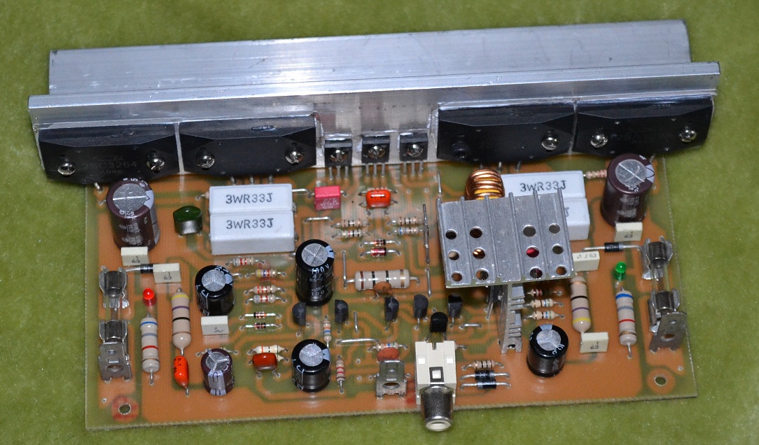

DX Blame ST Super A SANKEN Version
Uncle Charlie,
My DX Super A SANKEN version is now singing...... and all i can say is WOOOOOOWWWWWW!!!!..... i'm very happy about the quality...
So far I'm currently playing with low voltage only using my voltage transformer but high current 12-0-12VAC/30Amps. but this amp still works with very very fine in high and low frequency, i like the base soo much... but so far i did not set the bias as i'm not sure what is the correct bias using this low voltage.
But tommorow i connect to 40-0-40VDC/600VA and adjust the bias accordingly as getting late now in my place....

The amp is very cold
With 10R/10W in +/- rail all components are very cold like the amp is not powered, but the sound is very clean and crystal clear using my ipod nano, sound quality doesn't need tone control to blend as it sound like it's already has tone control and completely blended perfectly from my taste.
Anyway right now I can’t play in full power, but I will do that tomorrow using the correct supply voltage and will update you.
Wiljj78
Wiljj78

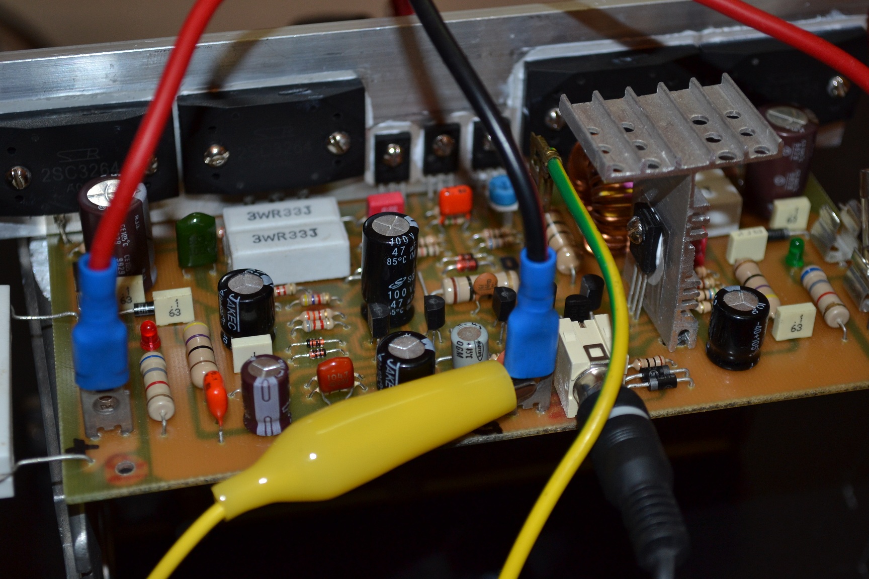

Preferred bias voltage for +/-38VDC
Uncle Charlie,
I have connected the amp supply @ +/-38VDC and i'm trying to set the bias on 10R/10W resistor but the max. voltage i can set is only 2.35V and the heatsink is warm.
Please advice what is the preferred bias voltage for +/-38VDC as my trimmer was on the maximum but bias voltage is only 2.29 on the positive rail and 2.33V on the negative rail and i'm not sure if this is the right bias according to the supply voltage.
Wiljj78
Uncle Charlie,
Wiljj78

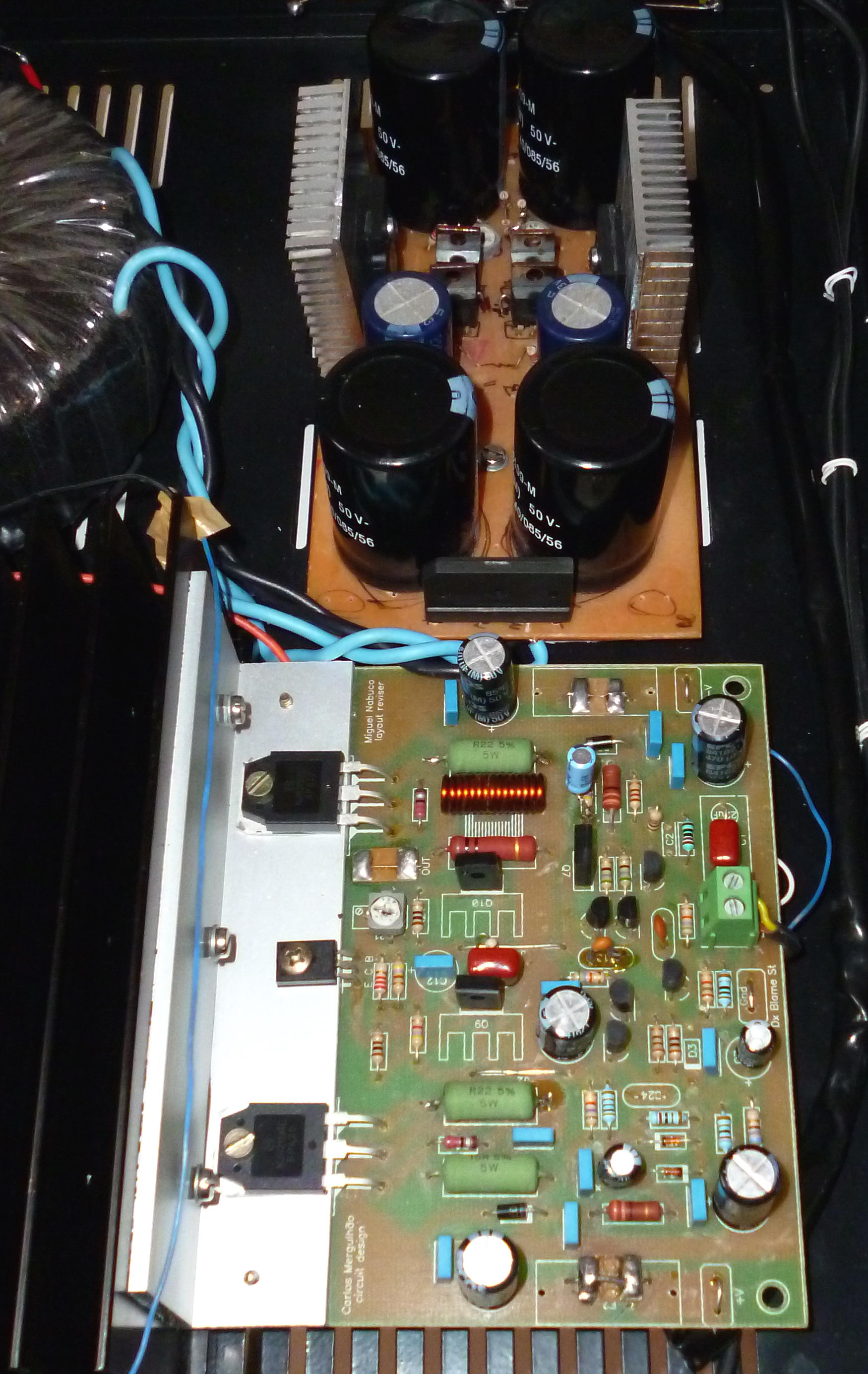

It is all rigth Wiljj78... relax.... let it be this way as you're using 38 Volts
I am trying the Dx Supply once again, this time i have installed 25.000 plus 25.000uf, the amplifier is operating with 38 Volts, the supply voltage unloaded is 44 volts...loading it drops to 40 volts and keeps the output voltage stable...highly filtered as i tortured with 1 hertz and no noise from the supply, totally and absolutelly silent even when we drain high currents.
Speaker is using 4 ohms coil (it is dual coil) and i have pushed almost 100 watts RMS... due to 6 volts of voltage drop into the series pass transistors (from colector to emitter) i am having some heat into my test small heatsinks.... but when draining high current the voltage drop into series pass transistor is only 2.3 volts...this way heat is not that big.
Circuit is Dx Super A operating with one single pair in the output and i cannot push it hard because of that.... 100 watts only a few seconds.
As you can see, i have simplified the supply to enjoy it's power while i am waiting more transistors, pcboards and electrolitic condensers.
Just to be listening the Dx Super A and to have fun.

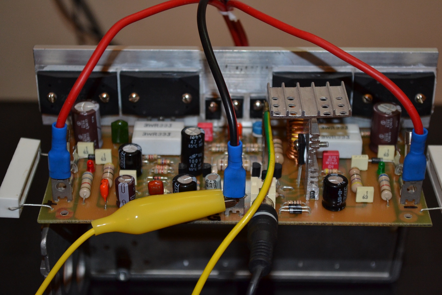

Uncle charlie i will keep the bias in 2.0V while i'm using
Temporary heat sink, but I will set and readjust the bias in max to get 2.33V when I move to the final heat sink, so far the heat sink is little hot when i supply +/-38VDC but the amp looks stable and I feel comfortable and nothing to worry about....
Today I’m having fun with super A and really it has lots of power as I can’t push it hard to the max volume I can feel my speakers can’t survive the power, otherwise will be sorry Hahahaha….
Wiljj78
Wiljj78
Decrease the value of the resistor you have in series with the trimpot
then you current will go up...but i do not think you should...you can do it, but this will not change that much the amplifier performance.
It is better to enjoy the sonics than to go tweaking...it is time to have fun..not to be working hard.
