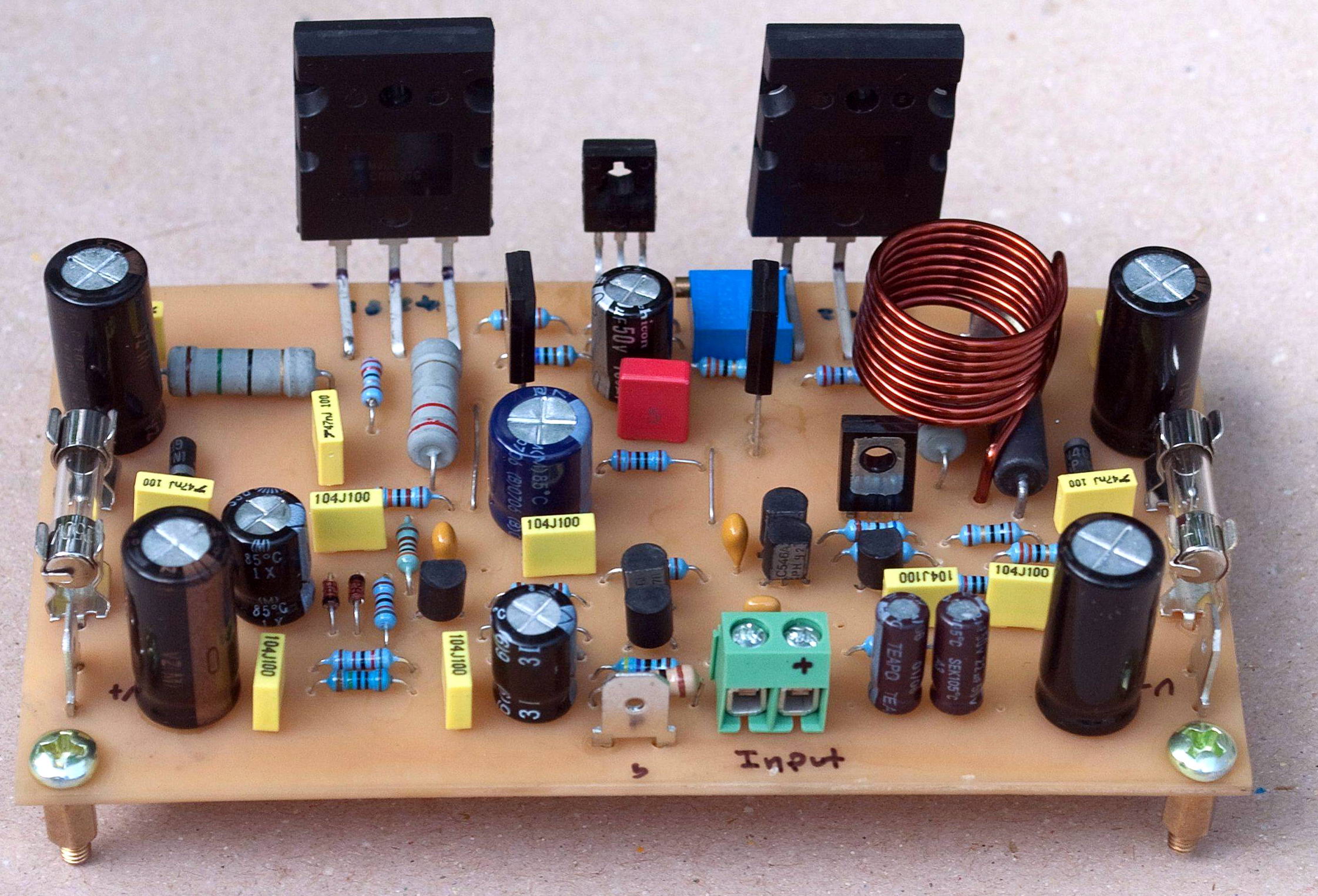

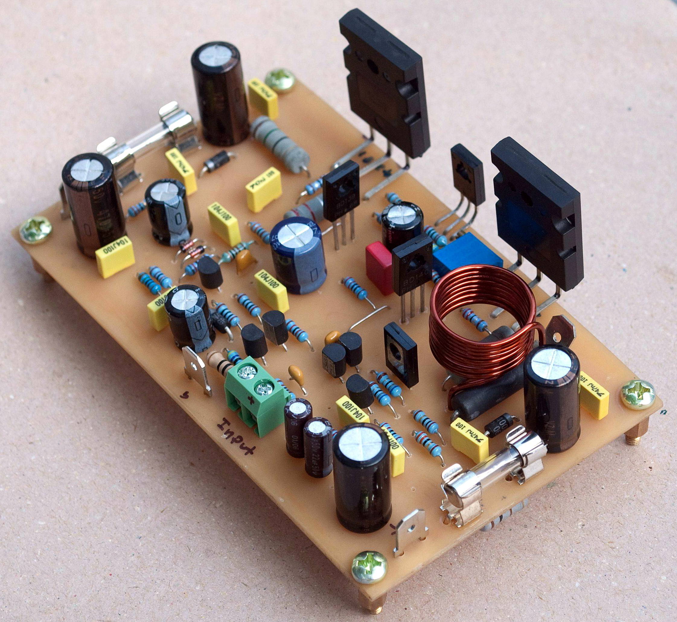

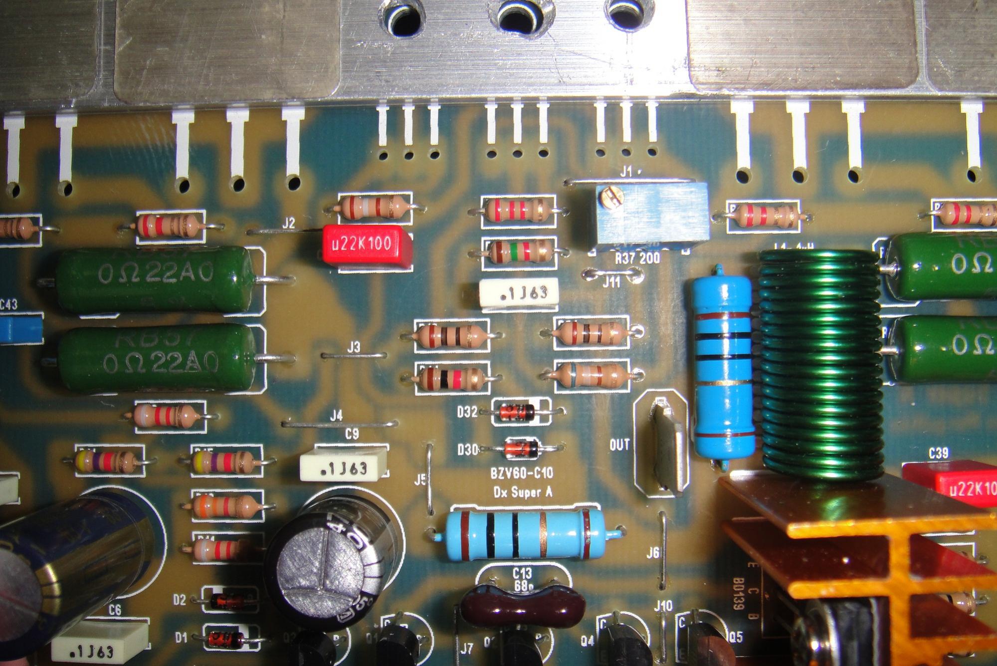

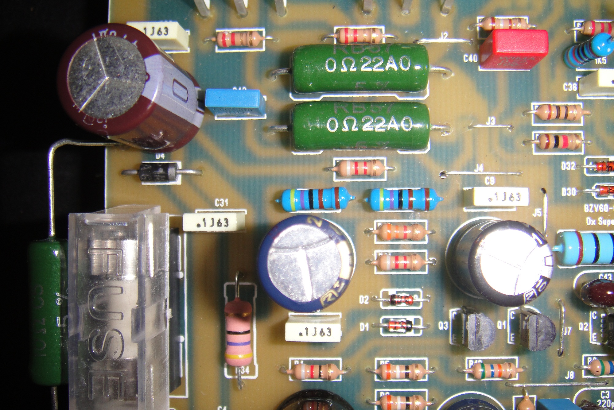

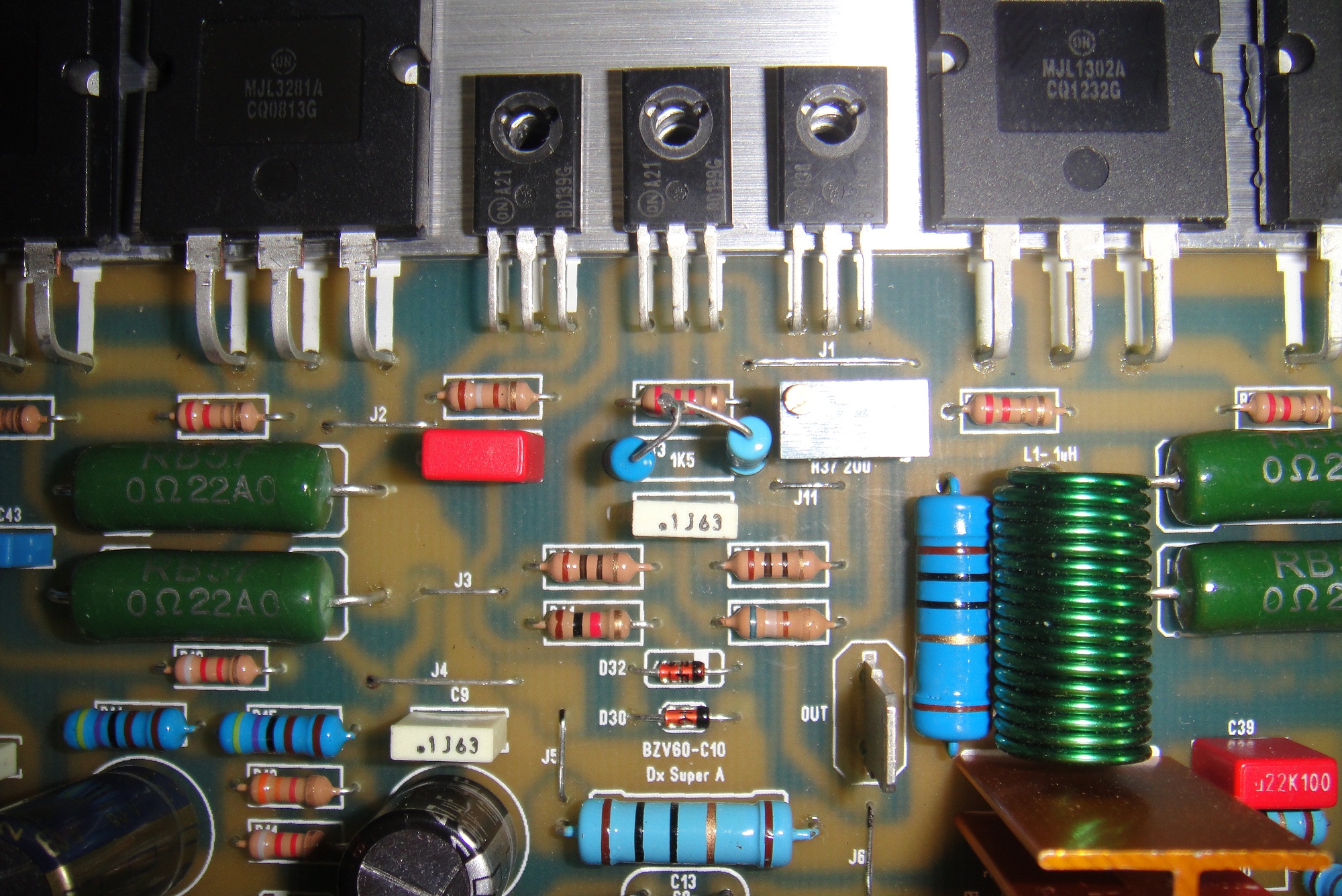

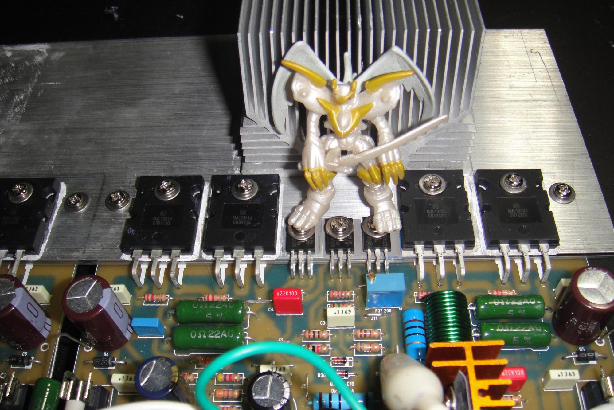

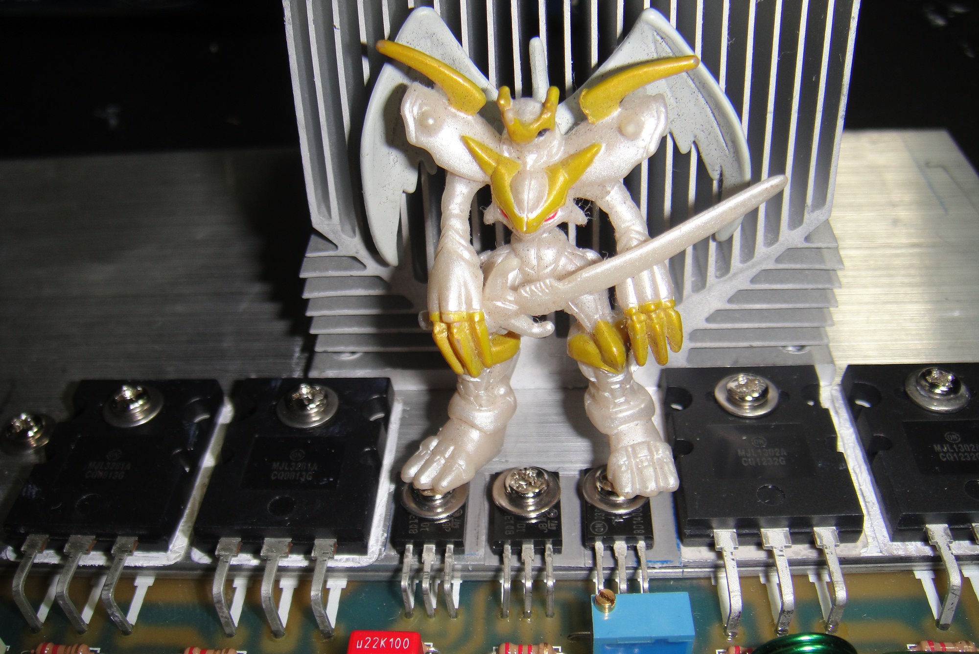

I have made the drill today, and it was not easy to keep alignment so I did the best I can, I have found a bottle of "chingiling" thermal white paste just enough to apply to the heat sink insulators, maybe today I might be able to bias it, if all goes smoothly , also I have to replace those resistors with the correct size one now that I have them on hand, and yes mister Carlos, I still have that Toshiba from my friend he didn't pick up up yet, but is a vintage amplifier, but it can not get even close to Dx Super A sound quality, and Super A has even more power than the Toshiba SC-665, sorry that is my opinion, 🙄 oh sorry again damn! , about the resistors here are the images so you know what I mean about replace those blue color resistor for the brown ones.

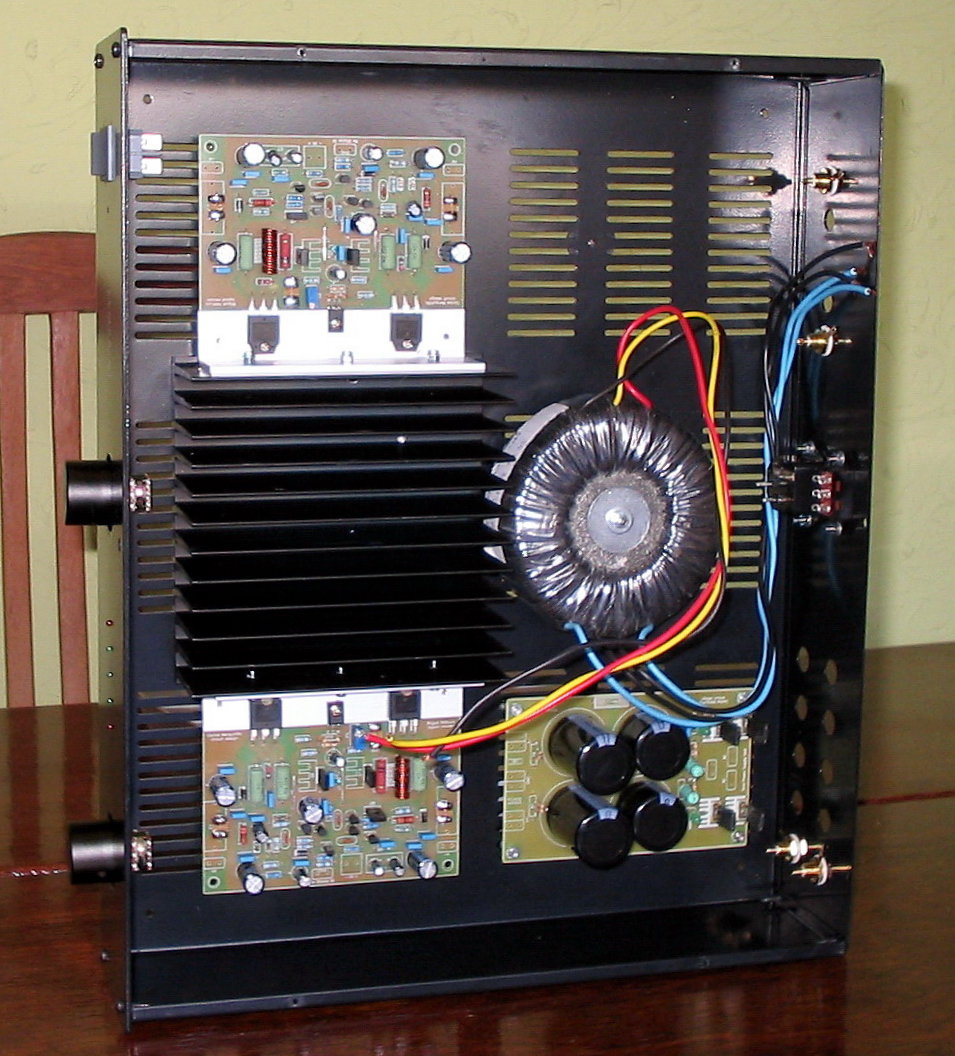

This enclosure have Dx Blame ST already modified to Super A
But these boards will be removed, a Dx supply will be inside (stabilized) and two Dx Super A pcboards will be in place too.
I am just waiting my boards to arrive to make it.

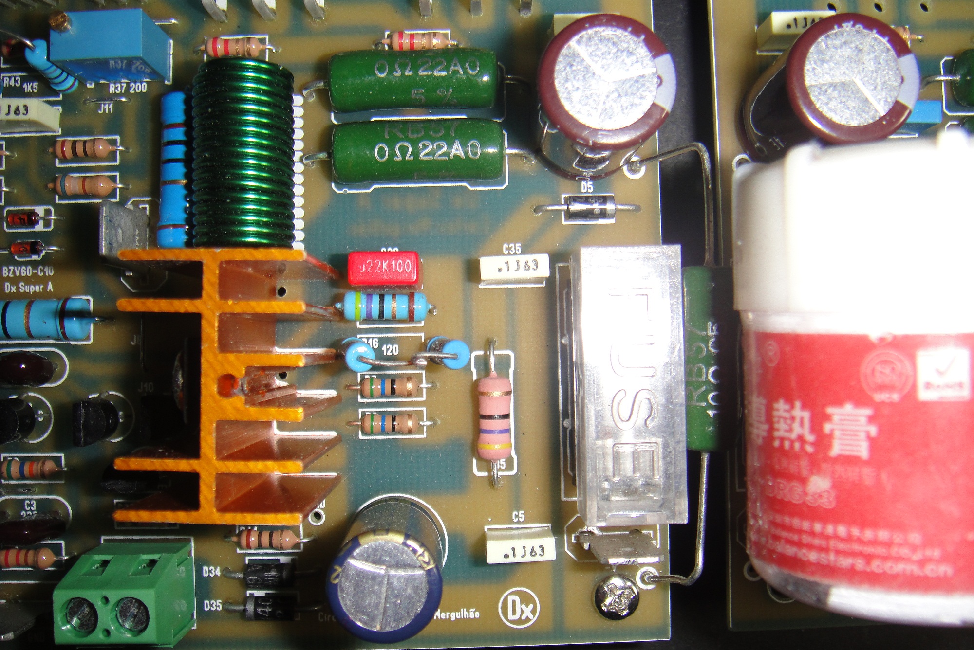

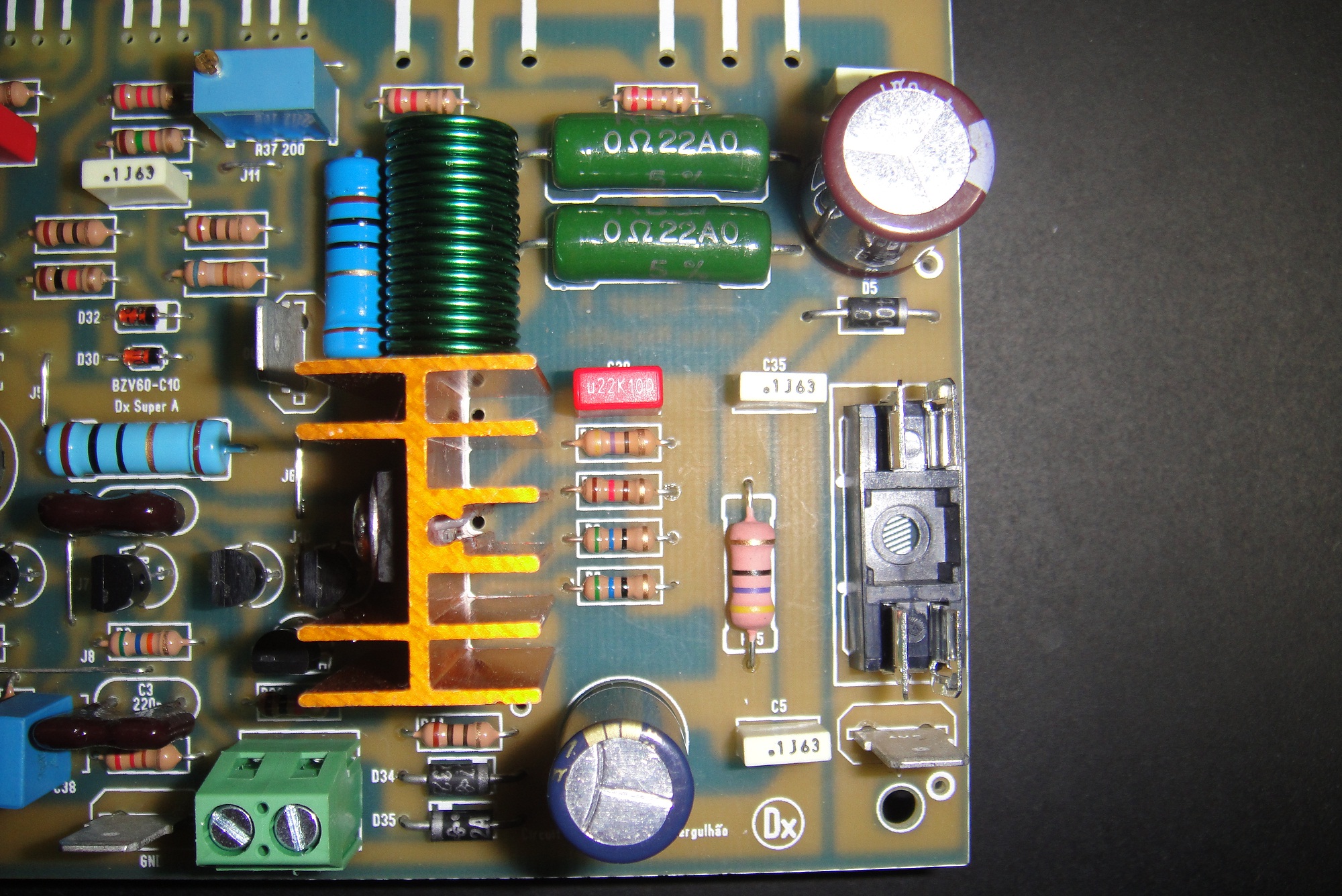

Yesterday I completed the other board, now I have to adjust the bias today and soon I will have stereo. looks really nice. 😀
Regards
Juan
Great job Juan!!! Congrats.....

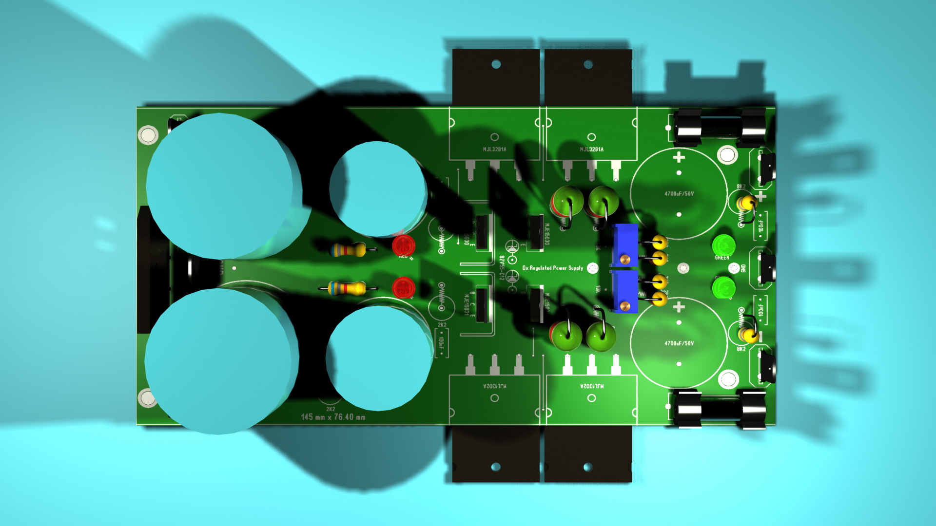

WilJJ78, your case is a little bit complicated.
I will post the answer here and also will post this stuff in the Dx Supply thread that was moved (sadly because it is to be used together this amplifier)...i have made a mistake....the good idea was to publish inside this same thread because it is an accessorie to the Dx Super A.
Dx Supply was made for our friends to save money because electrolitic condensers are very expensive.... It also provides yout stable output voltage and this helps you to achieve the low levels of distortion published.
It was made to receive maximum of 60 plus 60 volts DC and this comes from a 42 plus 42 volts alternated transformer... the maximum power to be drained, under these voltages, is 180 plus 180 watts, and this represents 360 total watts.
So, it was made for you to adjust 42 plus 42 volts into the output...this is the correct voltage to feed the Dx Super A amplifier.
Observe Dx Super A power specifications (42 plus 42 volts), results from the simulator with the supply voltage stable (regulated, stabilized at 42+42)
- 85 Watts RMS at 8 ohms, THD 0.001%, 1.5A plus 1.5A of current drain, that represents a power consumption of 63 watts plus 63 watts (63 watts per rail) and the total of 126W (efficiency is around 67% to 8 ohms).... rail fuses should be slow blow, 1.5A plus 1.5A or a little bit more if you like to enter clipping... speaker series fuse is 3A or a little bit more if you intend to enter clipping.
- 160 Watts RMS at 4 ohms, THD 0.002%, with 3A plus 3A of current drain, that represents a power consumption of 126 + 126W, or total of 254W... rails fuses should be 3A or more, all them slow blow... speaker fuse 6A or more...also slow blow.
- 250 Watts RMS at 2 ohms, THD 0.005%, with 5A + 5A of current drain, that represents a power consumption of 210 + 210W, or a total of 420 Watts of total power consumption.... 5A plus 5A slow blow fuses to the rails and 10A series fuse in series with the speakers (slow blow)
But, if you accept some distortion (we all accept..if we do not accept, the amplifier clips anyway and sometimes we do not perceive so fast it is)...then it can go to:
290 Watts RMS - 2 ohms - 1 percent distortion
330 Watts RMS - 2 ohms - 5 percent distortion
360 Watts RMS - 2 ohms - 10 percent distortion
10% distortion is not that crazy as you think, because some manufacturers (respectable ones) publish integrated circuit distortion at this level of distortion to increase the numbers...watch manufacturer datasheedt about them.
360 Watts RMS is the worst case scenario.... where the supply will face the maximum consumption resulted from the Dx Super A operation at 2 ohms and with 10 percent of distortion... here the current drain goes to 6.3A each rail ... and the consumption is 530 watts to a single channel.
The Dx Supply is good to feed two channels operating simultaneously, at 8 ohms and full power.
The Dx Supply can to feed one channel if you operate at 4 ohms, so, under this sittuation you will need two supplies, one to each channel.
The Dx Supply will need an extra pair of transistors to operate safe if you feed one channel at 2 ohms and drive it to full power (distorted)... you should check your rectifier rating and electrolitic condenser values because the supply was made, mainly, to feed two channels at 8 ohms.... two pair of transistors was the choice to save money into this supply.... so... you gonna need to tweak if you decide to push the limits into 2 ohms loads.... one of the main need is the extra pair of series power transistor...so... as a result, you gonna have three ouput pairs.

The dissipation into these series pass transistors
The ones are in the Dx Supply, made to be used together the Dx Super A audio power amplifier.
We gonna have, as the worst case scenario, (when transformer have no voltage... but this is almost impossible....but for safety reasons we take this into our calculations) a voltage drop of 18 volts (60 to 42C) into the series pass transistors, so, multiply this voltage drop by the rail current (that gonna depend your case/choice)... then you will have the power developed into the series pass transistor colector to emitter junctions (input to output of the series pass regulator transistors)
As an example, to clarify the subject, if you have TWO Dx Super A channels, driving 8 ohms loads, operating full power (undistorted), draining energy from a single Dx Supply, will result in 54 plus 54 Watts of power dissipation.... in real world this use to be much less, because we have voltage drop into the Dx Supply input, so, voltage drop from colector to emitter being reduces will reduce the result of the multiplication of current by the voltage that results in the power.
My Dear WilJJ78, your case is a little bit complicated, as you want to enter a higher voltage into the Dx Supply input....much higher than we have calculated.
52 Volts AC means aprox. 73 Volts DC, so, your voltage drop into the series pass transistors (adjusting 42 volts at the regulator output) will be 31 Volts, so, i strongly suggest you , dear Bahrain, to build two Dx Supplies feeding your stereo with two separated power supplies, one to each channel... and each one of your channels will need three output pairs, so, you will have to install an extra pair the way you can...also rectifier must be checked, it must be minimum of 15A, also the first condensers, the main filters after rectification should be reinforced..you have to prepare extra boards to put more units in parallel with the ones are in the Dx Supply board...all this special because you case is special.... your dissipation power into the series pass transistors may reach 200 Watts each rail and this is huge..and all that stuff is due to the higher input voltage you will use...this is what will create all troubles....you gonna be using 10AC volts more...this increases the load into the series pass transistors a lot!
Another option is never use 2 ohms..then you can try the standard Supply with 4 ohms loads...but use two supplies....if you decide to use 8 ohms only..then a single supply will be good enough.
In all cases, your power dissipation into the supply series pass transistor will be huge.... the difference in between the input voltage (73) and the output adjusted voltage (42) is too much big... and you cannot increase the supply voltage because it is already in the limit to the power amplifier to operate at 2 ohms...so... cannot increase to reduce your heat.
I do Think your transformer is no good...too much high voltage...will create troubles to us.

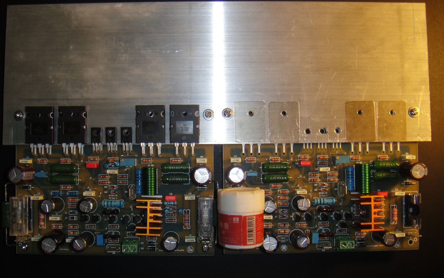

Dx Super A Stereo

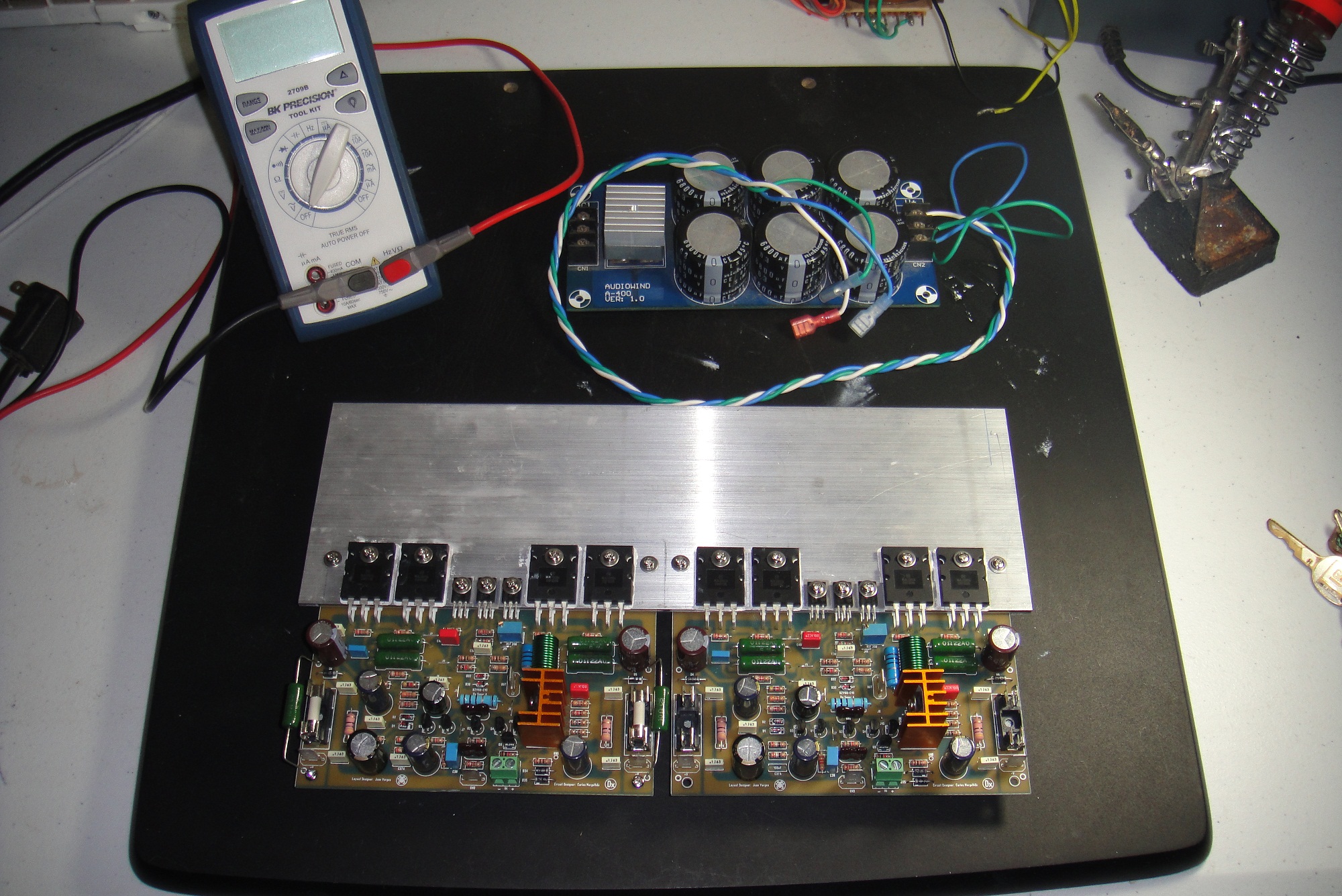

All done! I have both channels working great!, sounds great! and the must important thing, I'm having fun!!!!
1. thermally stable didn't not get that hot even with out a fan.
2. responds really good like the first board.
3. adjustment same way no problems at all.
4. bass is nice.
5. the woofer is 8 ohms so it will stay on the safe margin so is cool.
6. at the moment I'm writhing this the music I play is destroying my 15" woofer. jejejejejejejeje
7. no guys, but seriously this an amplifies to have in a nice chassis nice volume knobs, to enjoy music in the living room and relax, I like lot of style of music so is double the enjoyment for me.
now I have my
A, ready... later the regulator is need it. and going to get a nice cold Coca Cola really cold
bien fria!!!!!!!!! really cold!!!!
