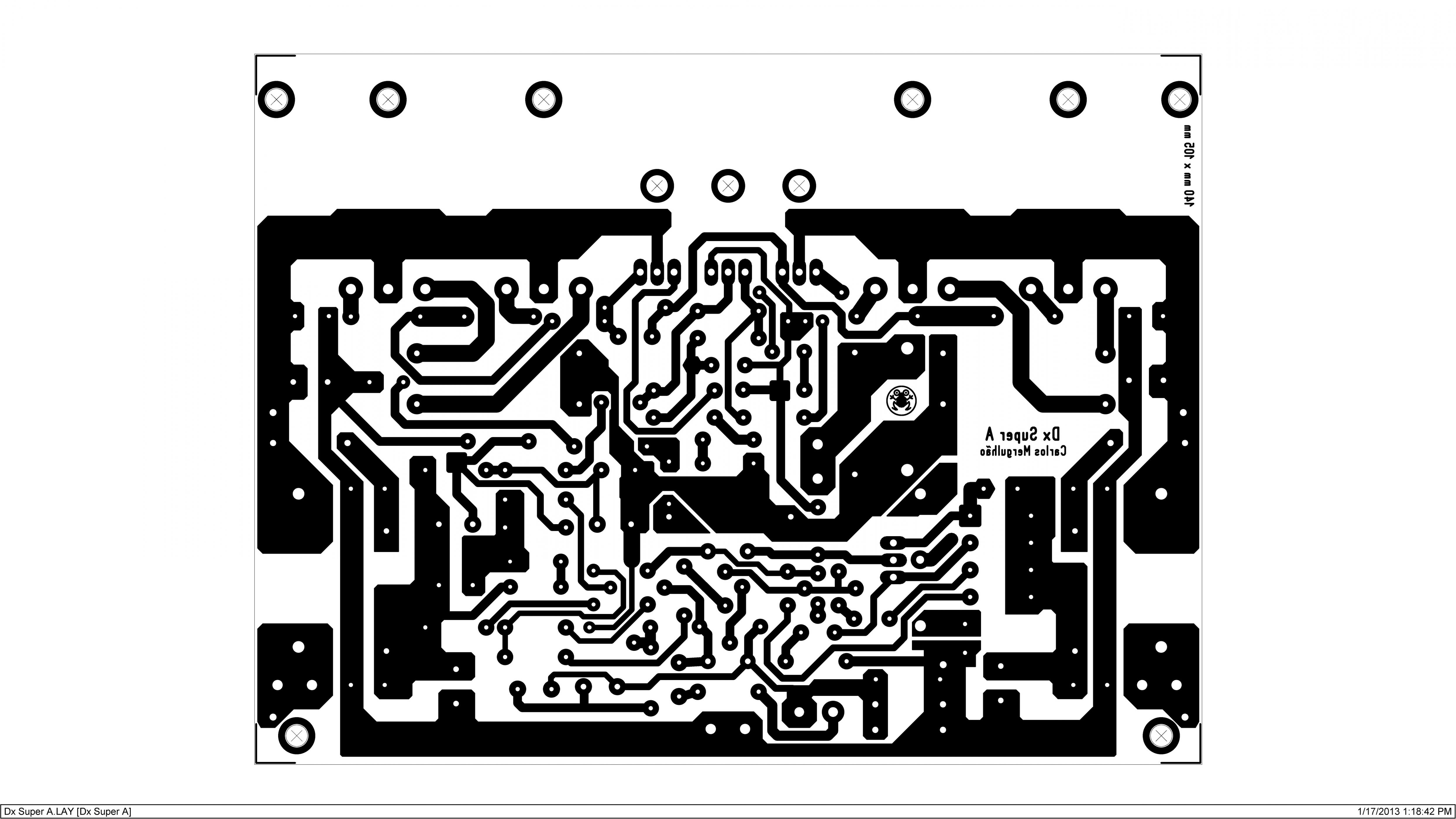

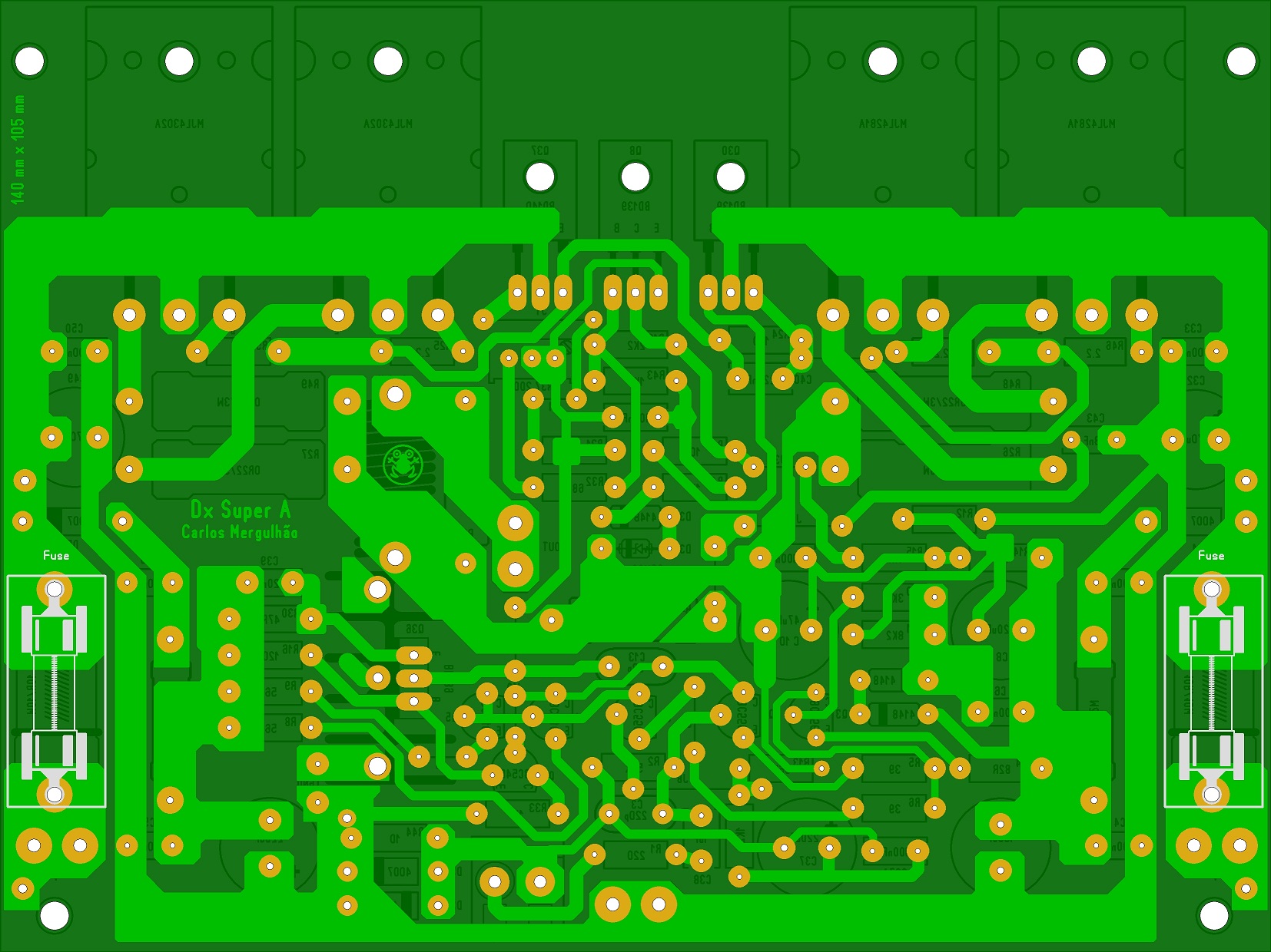

Here are the files for etching method and also the size of the board and many other images for reference and also I will provide information about pitch distance of the components as soon as possible.
Regards
Juan

Here are the etched material guys, a larger one and a normal size etched files
Willy so you say you have to adjust your printer ? did you try 1:1 ratio ?

Yes i did all the possible solution but adjustment didn't work once in PDF file means it's lock i can only select the type of paper sizes to print.
Ratio 1:1 will not help eather if you print in A4 size still the actual printout size are inaccurate, at lease in jpg file can be adjust using the picture editor or on microsoft word file.
oh ok let me send you a HD image file ok here we go really large files ready to go.😉

This is ok now Juan, i can manage to adjust to get the right dimension.
anyway i'm using this printer to print my toner transfer and my paper size setting in A4 size, this printer can print A3, A4 and A5 paper size but our standard settings in A4.

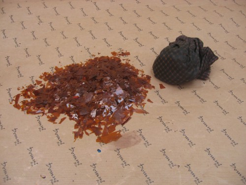

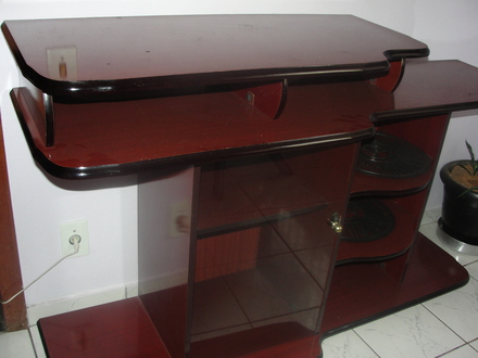

We had something, in the past, we used to dilute with alcohol
something that reminds cockroach wings.... this resulted in a varnish very good and shinny to wooden furnitures...the trouble was that had no resistance to alcohol, and i do think water attacked this material too.
Old times product, brown alike cockroach wing..... maybe something alike that... was extracted from plants...in the past was the varnish used in furnitures.... in 1960, in Brasil, was the thing we had..the main varnish we had... the cheap local varnish we had.
Goma laca was the technical name.... asa de barata was the popular name.
This is something can make paper cone a lot more resistant.

Here is the accurate dimension in pdf file, tested on actual printout using A4 size.

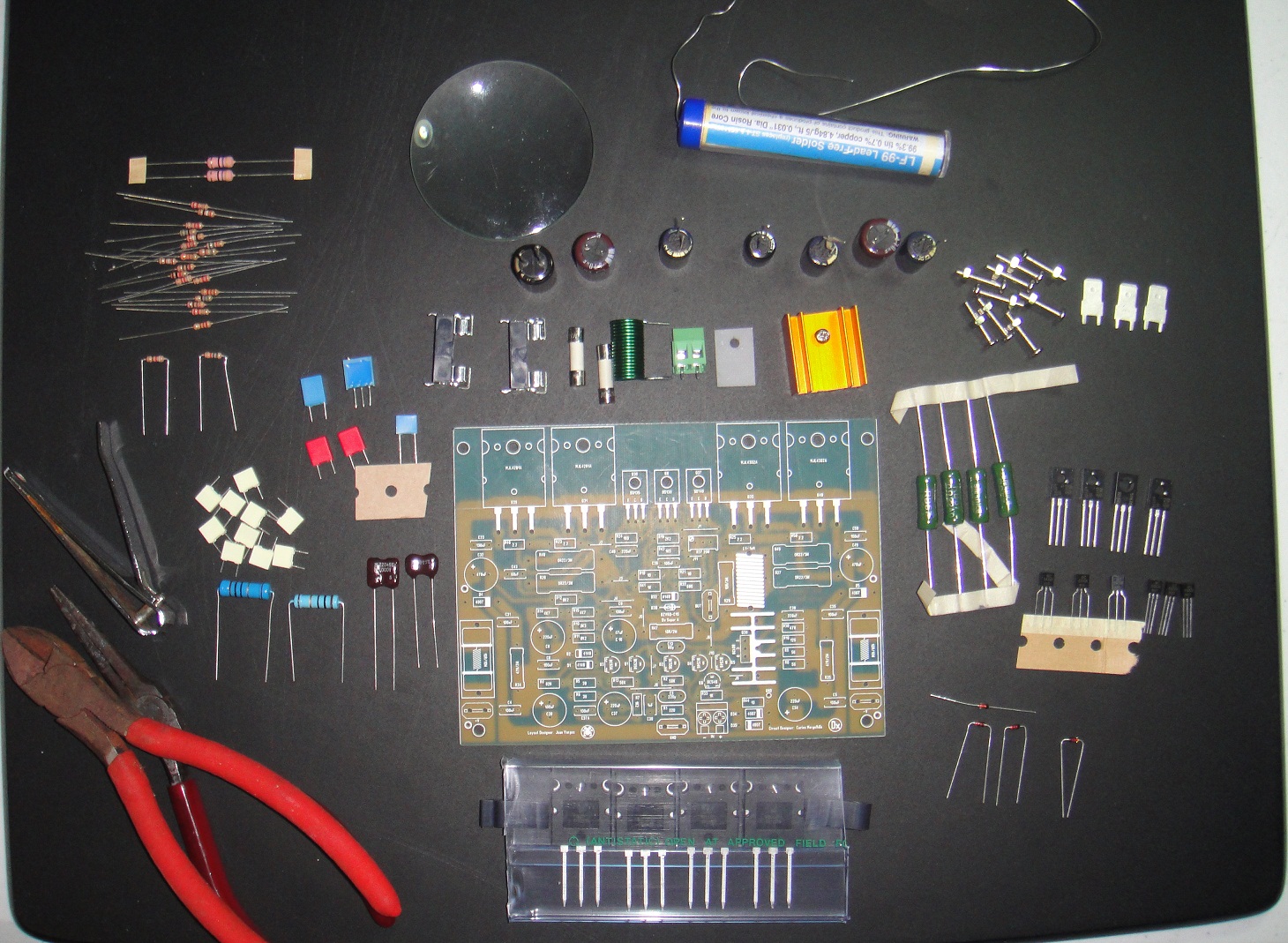

Thanks Willy, man 🙂 I was really tired yesterday putting together the other board, wow but at least finally got the second board good to go "I always say that word" jejejejeje, I will revised a couple of times just in case, the only thing I have left are to drill the holes and install all main power transistors and BIAS the unit to 2.5V. I was checking online for toroidal transformers, and I found one that fits nicely for the two boards the brand is Antek and I'm going to safe money for that maybe two months not sure,

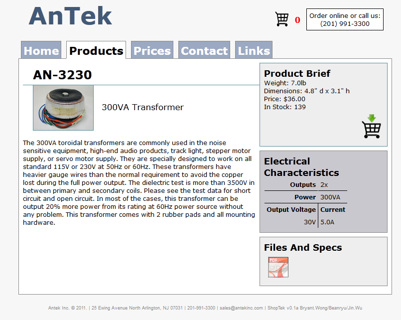

is the AN-5230 a 30V 500VA 8.3A "according to the info" but also I can have the less powerful unit and have two 300VA the AN-32-30 for $36.00 USD many options to chose, I mean works for me the shipping from this company to Puerto Rico it is a lot cheaper I try many, but many websites and is quite expensive the shipping,
Here the link of the website I mean is someone is curious about this,
Antek - Your reliable source of transformers, power supplies, and more.
I just want it to add one more think is good thinking of mister Carlos ideas
of how to chose the "trafo", on his video tutorial about to chose a toroidal transformer, to fit our needs, now is more clear to me than before, good stuff!.

That’s lovely stuff Juan looking very good, hopefully next month I can taste how delicious the Stereo of Super A, But I will just use 1943/5200 these are the available power transistor in my place, hope I can get the same power in 4 Ohms.
Willy
Prepare yourself to very strong emotions Bahrain
You will listen the ultimate amplifier.
Search for a physician to give a check on your heart.... huge emotions are to come to you.
I am sure you have never have listened so good amplifier...i just could not believe i did it...was something i could not imagine was possible...in my point of view anything and nothing would beat the Dx Blame ST...but this one smashed with the Blame ST, also MKIII Hx and many others.
Use the best audio source, the best song to play, the best speakers and be sure you will be listening the best possible amplifier....i am 52 years searching and researching and this is the ultimate..the best, the superior...anyone can beat this one.... no chance for others...they will loose the competition and will run alike a dog with the tail in between the legs screaming the way dogs scream when hitted.
You gonna dance, gonna be excited, heart beat will acelerate..you may dance...prepare a digital camera to show us your expression of surprise with the first seconds the music will be playing with this amplifier.
I almost trow all others i have at home (amplifiers) into the garbage can.
Juan when played first time..he just could not stop to be listening..ask Juan if he have listened a better amplifier?
