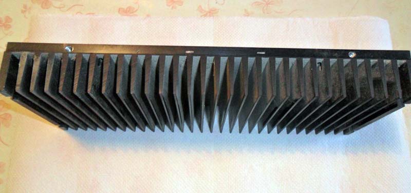

180 watts RMS of audio power, continuous, can be dissipated by this heatsink
Answering Soheil and Project 16
Soheil If your environment is 30 degrées celsius and if you accept 15 degrées celsius of increase of temperature that may go to 45 degrées celsius.
This is what the heatsink can face...audio amplifier power..not heat watts.... Class AB audio amplifier power..continuous, undistorted, sinusoidal and continuous.
But music is average..so.... twice of that is safe... 360 is safe.
This way i do think you heatsink will do the job to 8 and 4 ohms..but you ay need a fan blower if you push the amplifier to 300 watts RMS..then two channels assembled in this same heatsink will not be stable...as gonna need a heatsink able to face 600 watts RMS when your will be good (more or less) to 360W...or more, if your environment has lower temperature than mine.
Good heatsink..... not good....excelent!

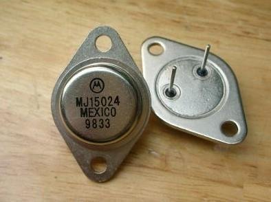

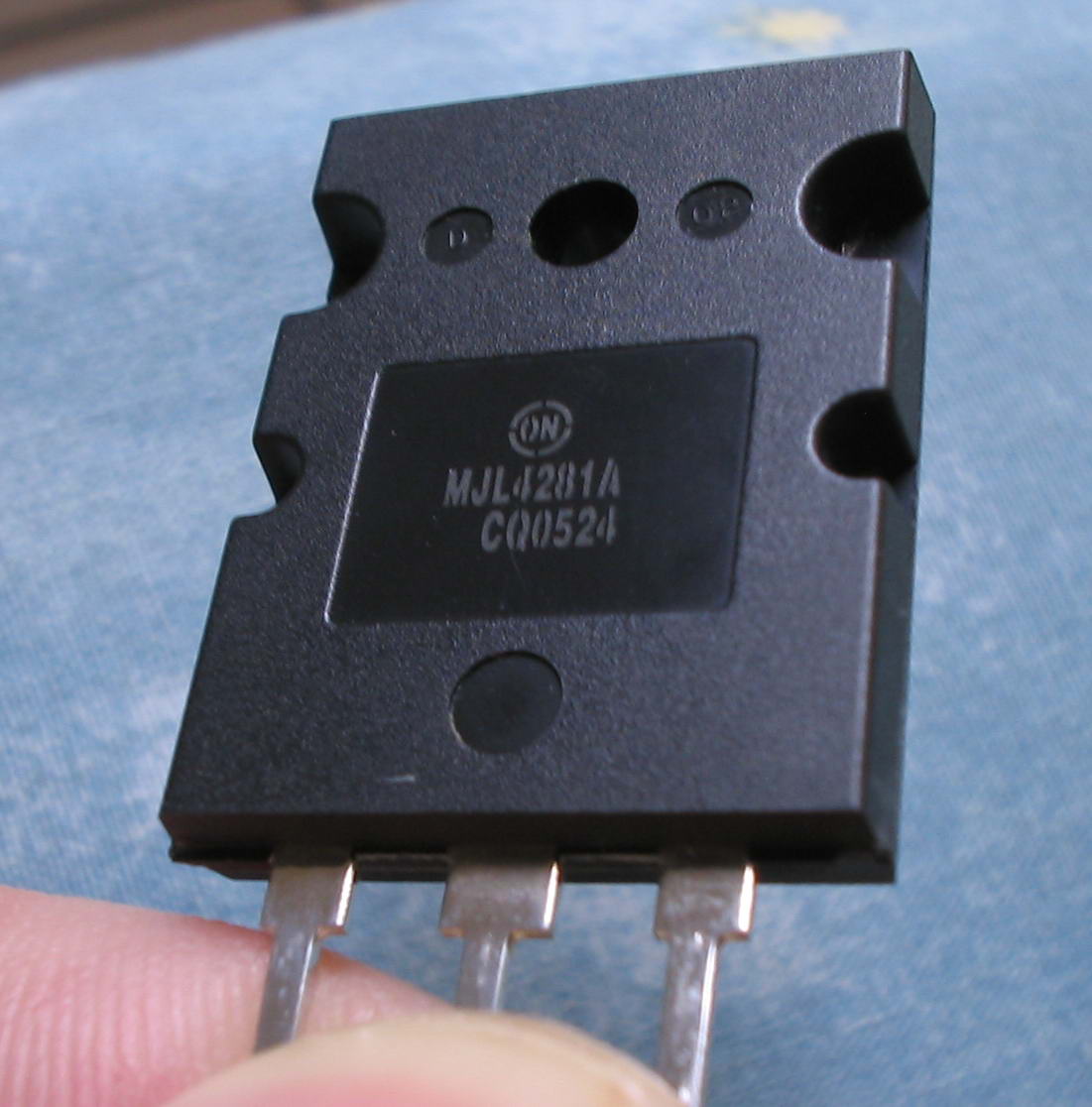

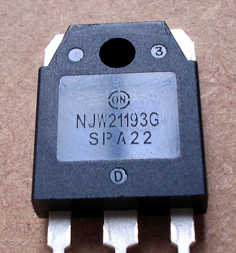

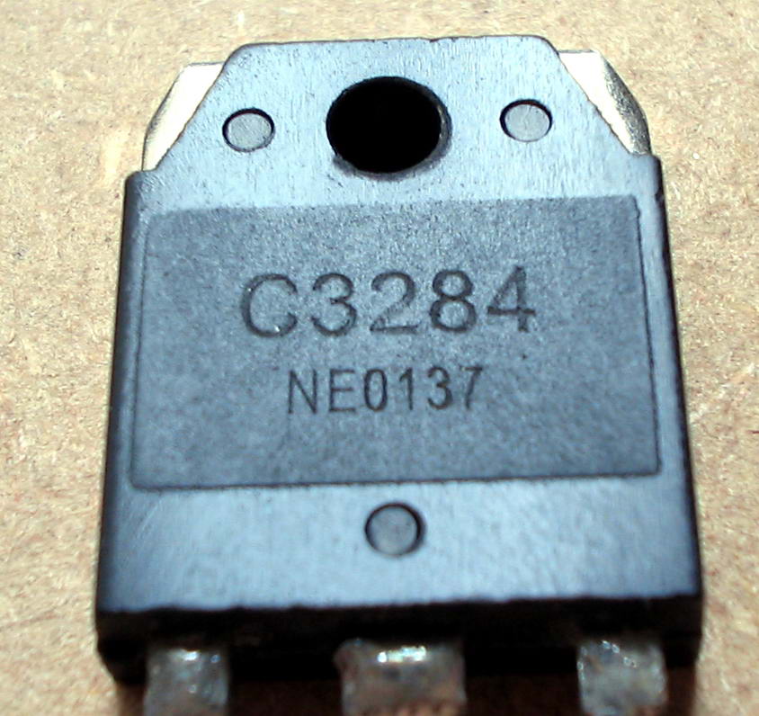

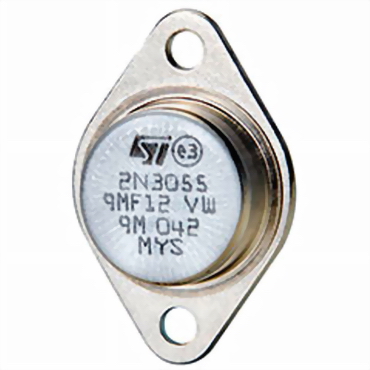

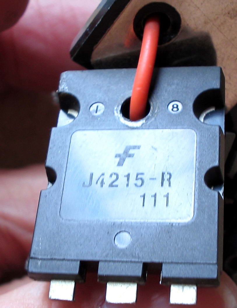

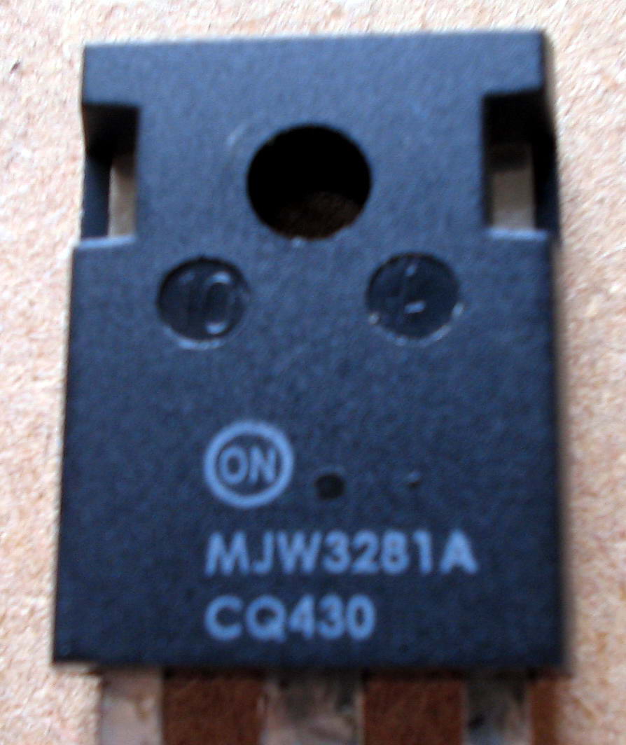

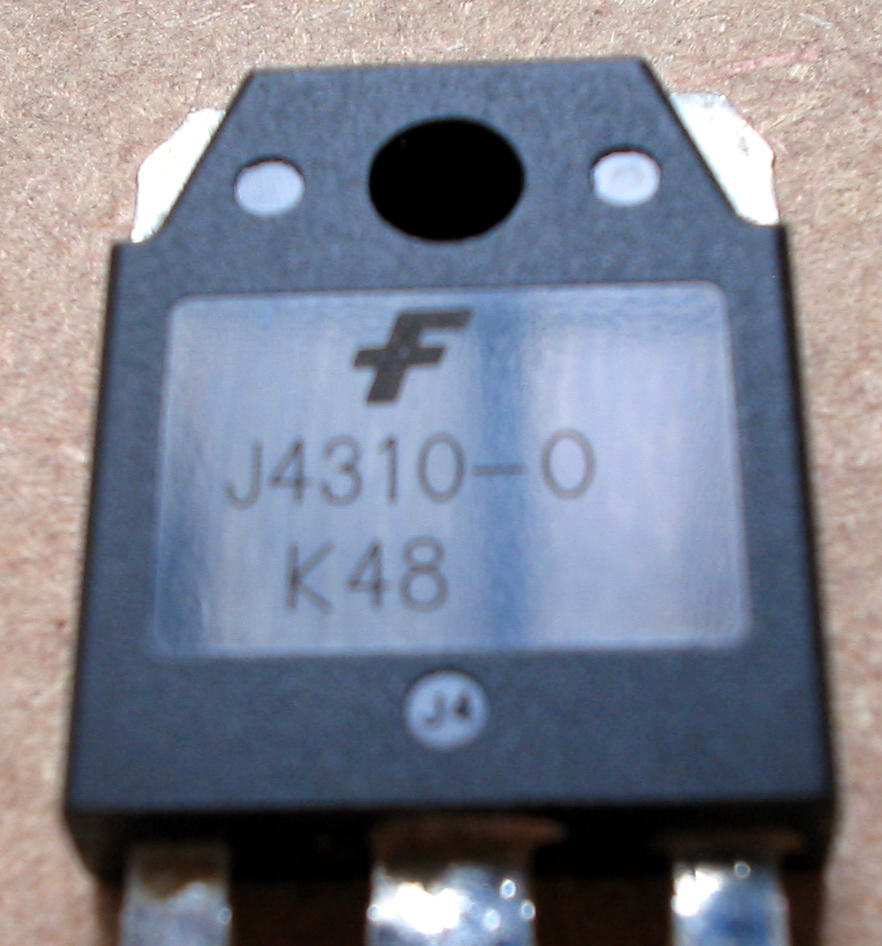

Project 16... About transistors..the ones pointed are able to face 2 ohms loads...others will not survive and may be fried.... if you use others, then do not use 2 ohms loads or strange speakers that has impedance valleys due to internal passive crossover or even speaker itself.
All power transistors can be used..even the famous 2SC5200 and 2SA1943, they are almost the same...all they cousins...even old MJ15024 can be used, and several others..they are one copy or the other..all them result of the now a days actual development....use the ones are available, the ones you like and be happy, because better sonics you may have with 2SC2922 from Sanken..but it is so small the difference that does not make this one to be the choice....it is the same if you increase treble into a tone control from 12 hours to 1 hours and a half...not that big difference..in treble only, you can compensate this with your speaker positioning and adjustment of the +3DB switch...or even removing absortion material around..moving the speaker or installing ceramic tiles below the speaker stand.
J4215, 2SC3281, NJL3281, NJL4281, and many others...there are hundreds that can face more than 100 volts and more than 10 amperes, for audio purposes.

So, use the one you like, the one is available and avoid low impedance loads
Just that.
Difference in sonics exist..but not that important..the amplifier is so good that will play excelent sound with ANY power transistor.... even 2N3055.
Why i have suggested the big ones.....because huge....can face 2 ohms.... that was the reason why..others are a little bit weaker.
Type your transistor numbers in google and then type datasheet....there you gonna fin the complementary to all these ones.

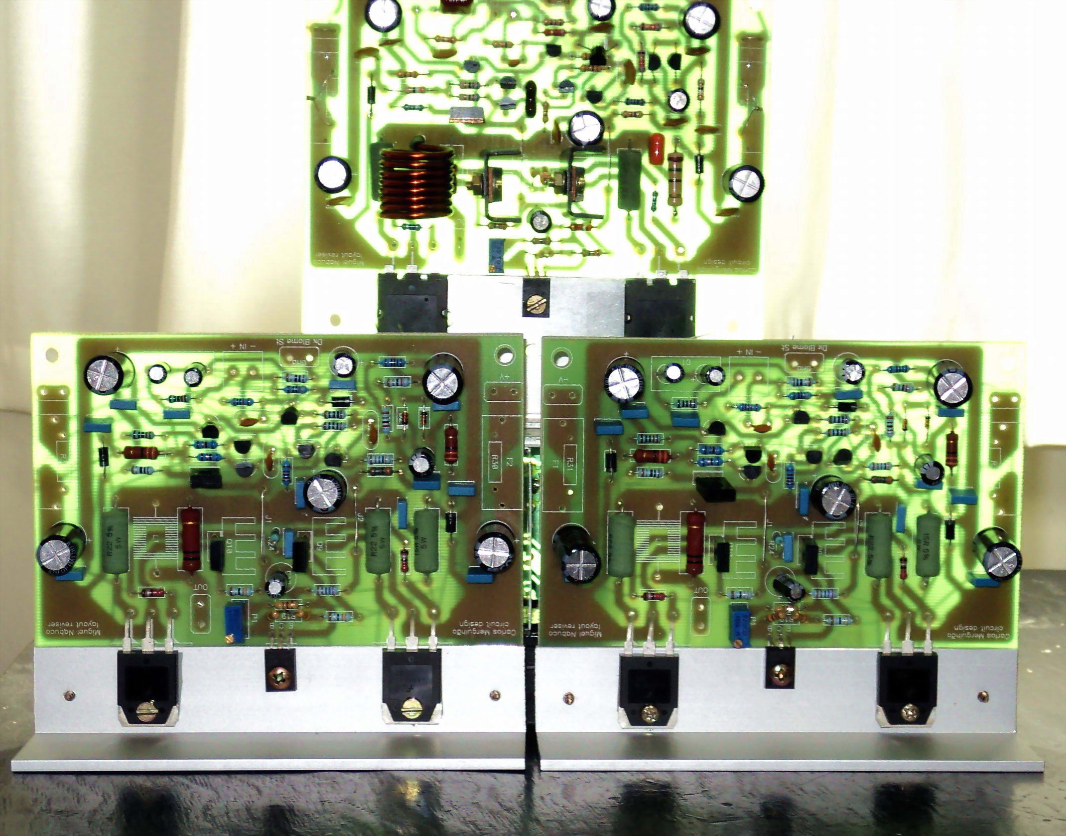

Dear Meanman, Juan Vargas internet was out from the air
His internet was down.
I have reserved to your the pcboards.... so, anytime you want... reserved!
Listen boys...and tell me if you can listen so good sound with these cheap dirty damaged poor awfull speakers..... this is because this amplifier.... plays good with any speaker.
The ones have assembled, Brazilians and Juan Vargas, just cannot stop to listen at it...ask them and you gonna know they are astonished!

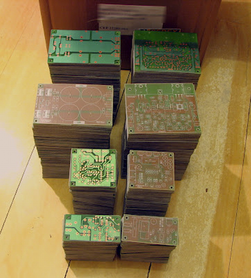

The idea is to allow them to use pcboards already provided
100 guys have assembled in Brazil having these green boards...more 100 guys have assembled using the Supercharged blue boards*, so, they already have their green pcboards to be adapted...they will use fan blower and will not install 2 ohms speaker anyway.
This was an effort to allow them to use the old pcboards they still have without the need to make another one or to have the need to order new pcboards...they can operate Class AB high biased to 90 miliamperes or even use 250 miliamperes without having the DC bias reduction we have in the Dx Super A.... other options to them to continue with their pcboards.
There are several options... Super A, High bias Dx Blame ST operating class AB and normal bias Dx Blame ST operating class AB (30 mA) but using the new tune Dx Super A circuit values.
It is "a la carte" service.... customized to my friend's needs.

Power transistors goes atop of the heatsink naturally
But we will need an "L" shape adaptor that you can see watching this video, it is an "L" shape profile.

Heatsinks:
To each 10 watts of audio power ( the maximum power you gonna reach depends your transformer power and depends on your speaker impedance) then use an aluminum blade of 10 by 10 centimeters (4 inches by 4 inches..so..squared)...this is the equivalent size to 10 watts of AUDIO power... so.... depending your power you can evaluate your heatsink...use fan blower anyway... this heatsink dimension (tested in laboratory, under 30 degrées centigrades environment being able to face a 10 watts RMS audio amplifier, operating class AB or class B, having sinusoidal signal in the output, undistorted or unclipped waveform)
This is to continuous.... music is average.... this results twice the needed size for music...so...you can calculate.
But Class A and Super A operation is different..generates too much heat and these calculation does not make any sense.... reason why i suggest to install fan blower having LM7808 or even LM7805 or other manufacturer, voltage regulator integrated circuits to power the fan, reducing voltage will reduce fan speed and fan noise....but be attention, these Voltage Regulator Chips have a limit of input voltage you should see in the datasheet.

Heatsinks:
