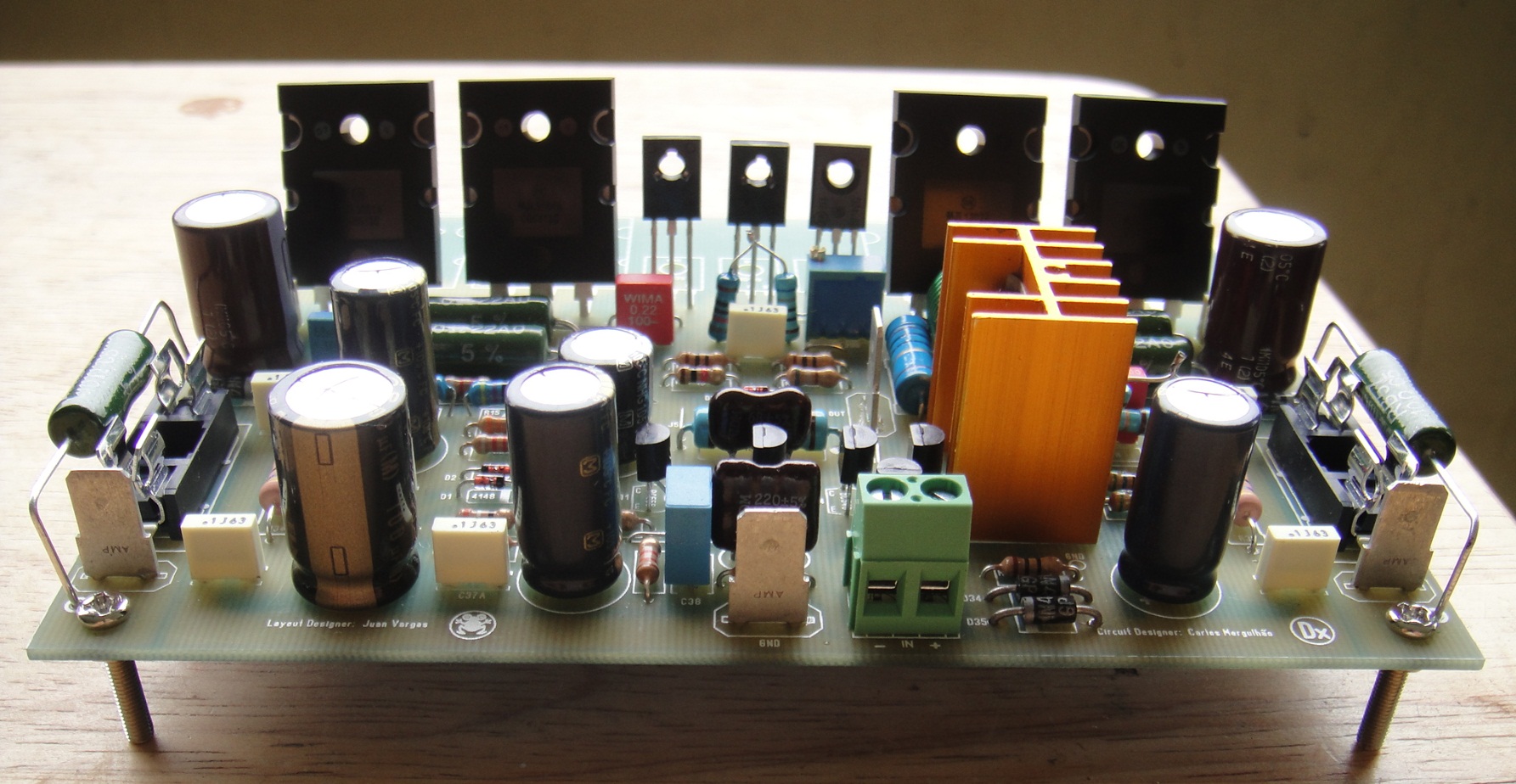

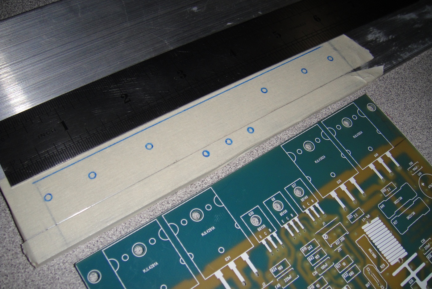

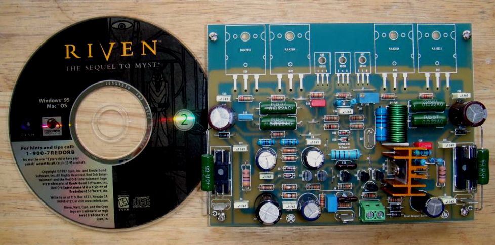

I have pictures of my Dx Super A and I just need to make the holes for the heat sink and continue the build, this are my favorites pictures. 🙂 also a small video too Dx Super A build Cats, guineas, Rosters,birds - YouTube cats,rosters,birds guinea birds sounds lol 😀
Regards
Juan
Regards
Juan
Please dear friend Juan, inform your heatsink dimensions
in order to uncle charlie check if it gonna be enough or not....it looks not good enough as you gonna use a huge 45 volts supplies.
I see you will use 6 electrolitic condensers, 6800 each one of them and bypassed to ground by small capacitors.
Inform the output impedance you gonna use and if this aluminum block will be used for one or two amplifiers.
I know it is thick, but this just increase the delay time till the aluminum block reaches a temperature above the environment temperature... after that moment, when you start to exchange heat to the air, the area exposed to the air is what gonna decide your heat transference capacity.
It look small...too much small for this amplifier.

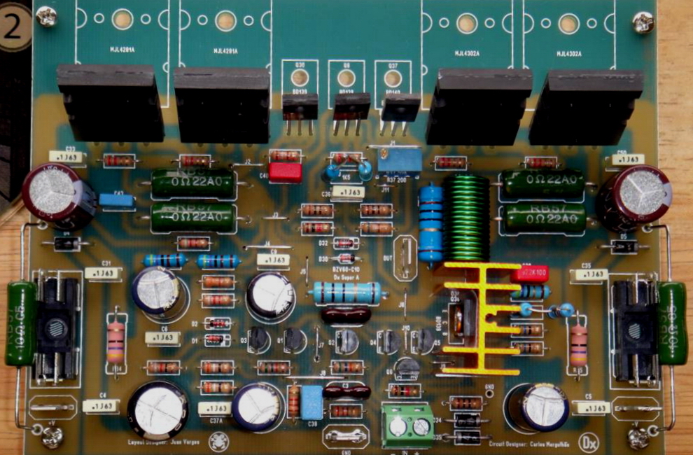

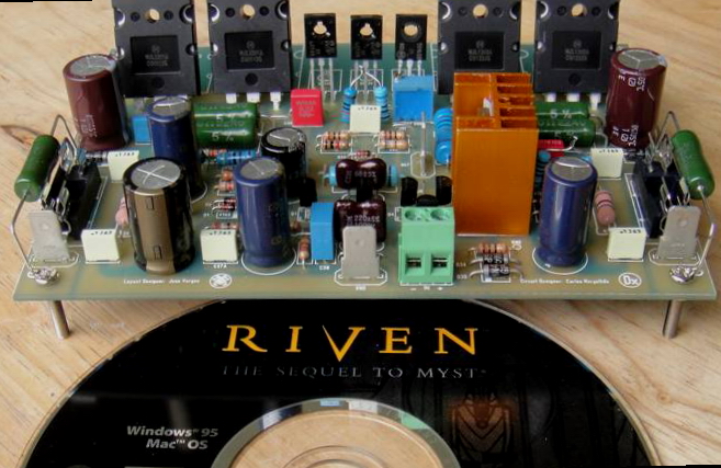

Finally! 😀
I guess for me was really easy to adjust the bias “I’m guessing here” first I check all connections all track to make sure I don’t have lose solder around,
I’m right know testing with louder volume, wow it does have a different tone than the supercharger, it has more “life like sound” the timbre timbales drums are a lot more richer
the highs are so nice and noticeable, bass is punchy and nice, also is a lot more louder I feel the sound come out good and clear, I have the volume at 78% in my PC and is really loud
I mean it has power to it, man I’m about to be deft in a minute lol, also no distortion at all.
Set up conditions:
Power Supply +45 0 -45
trim pot to high value possible in my case 191 ohms
I use thermal compound and all main transistors…
side resistors 10R 7 watt…
so I apply power…
I check with my finger the side resistors, warm to the touch, “not hot”…
place the multimeter the voltage was really low 0.098V…
then I begin to adjust to at least get close to 1.5V I start slowly…
after about 25 minutes, I adjust again to 2.48V and wait a little more…
then I decide to leave it like that 2.48V but I still can adjust… “this my case”
I then place the RCA cables, play some music low volume first…
now I’m enjoying I’m happy happy happy !!!!!!!!!

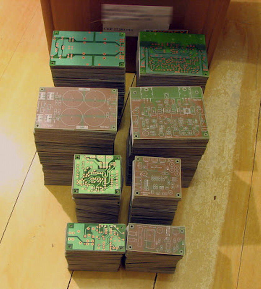

Green boards i told you we have made to Brasil, are these ones
We are making the Dx Supply, to use together Class A and Super A amplifiers.... in the reality you can use with any amplifier... output voltage is stabilized withing 0.25% and voltage is adjustable from 12 to 32 volts... symetrical supply having capacitance multiplier effect (electronic filtering)...it saves capacitors and removes all noise from the mains.
Video available in youtube... test video.... type Carlos Mergulhão or use the link provided in previous posts.
