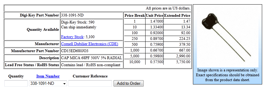

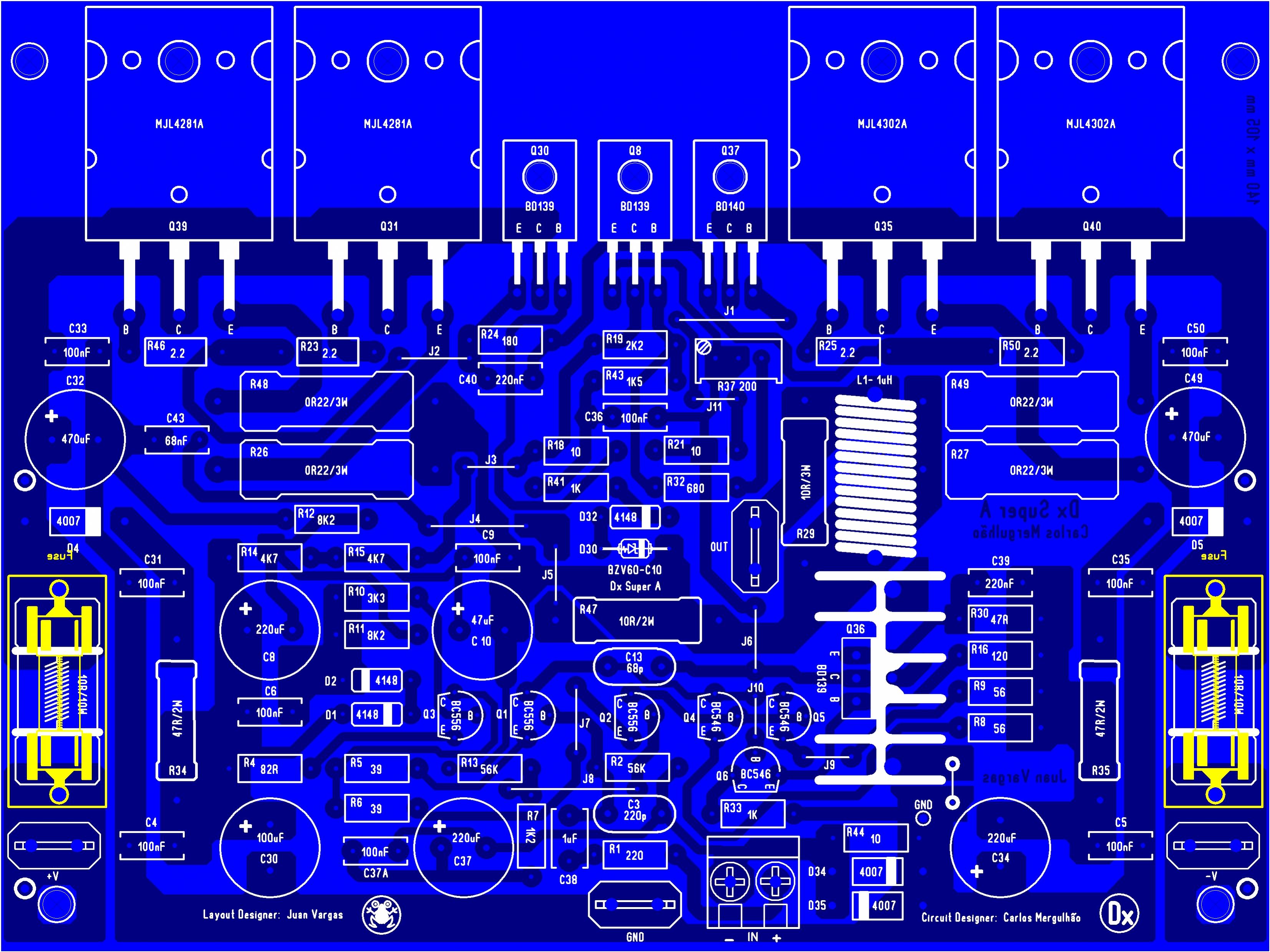

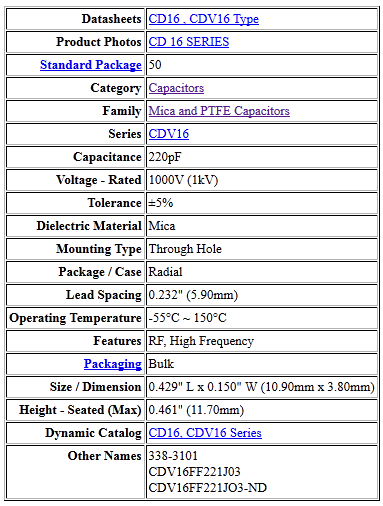

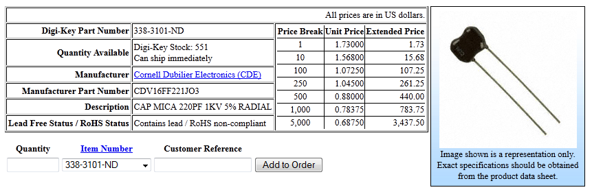

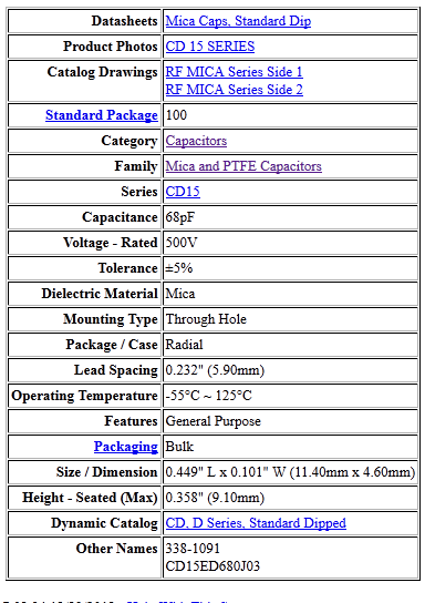

Exactly sir, Cornell Dubilier because the board macro I made it for those caps pitch of 5.90 mm. but other brand can be use but keep in mind the 5.90 mm pitch for 68pF and 220pF caps. I forgot to add something actually they don't need to be 500V or a 1000V, I just like the way the look so this are the ones, "for my be happy", maybe is silly but I like to see nice things on the board, not expensive of course.

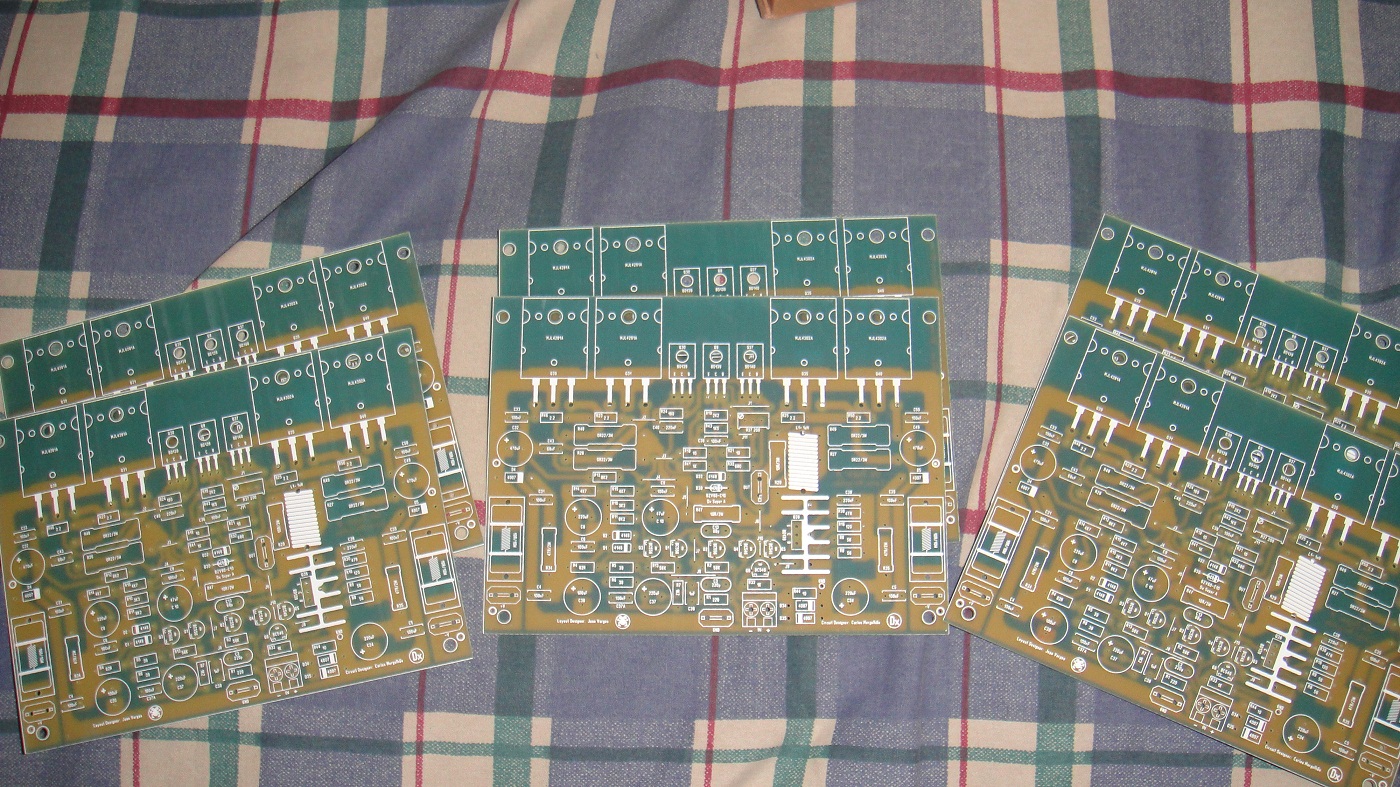

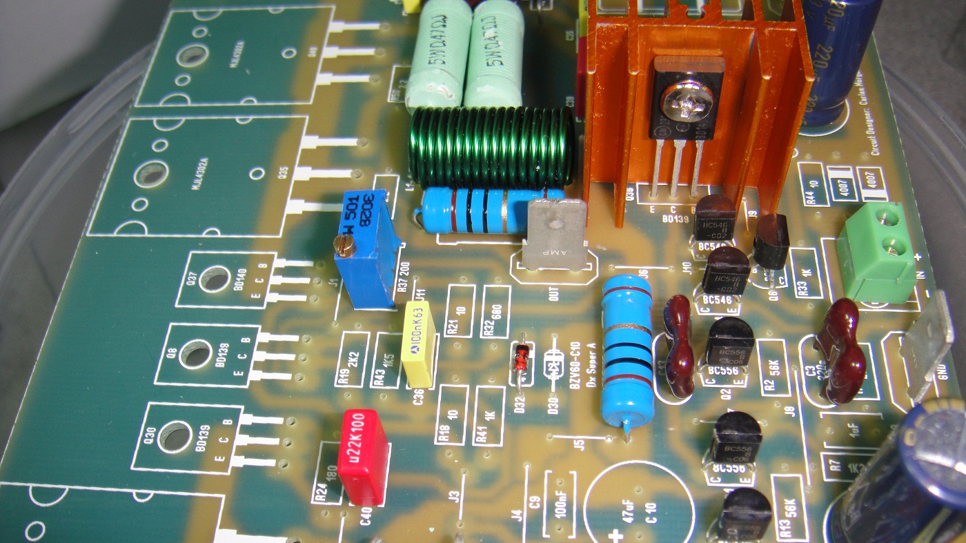

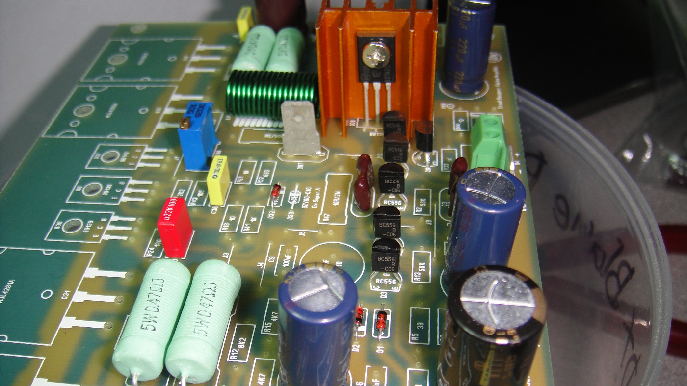

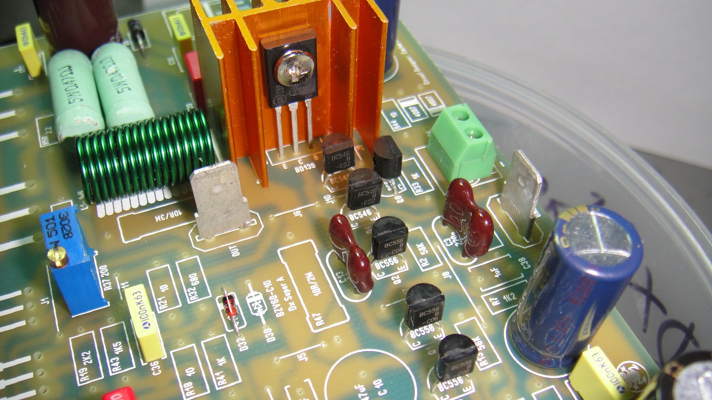

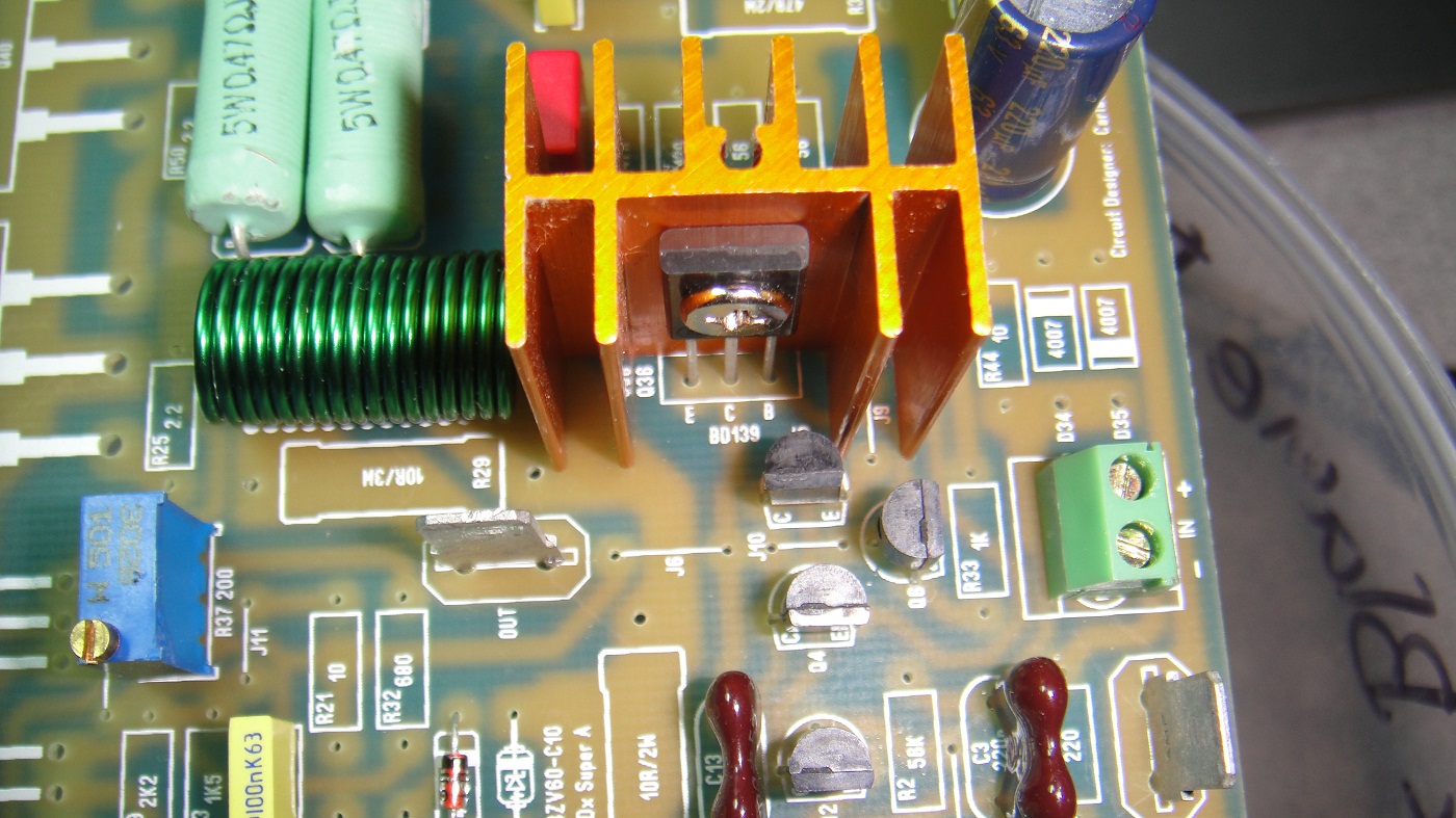

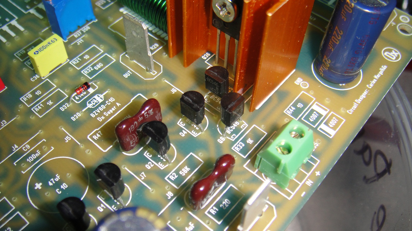

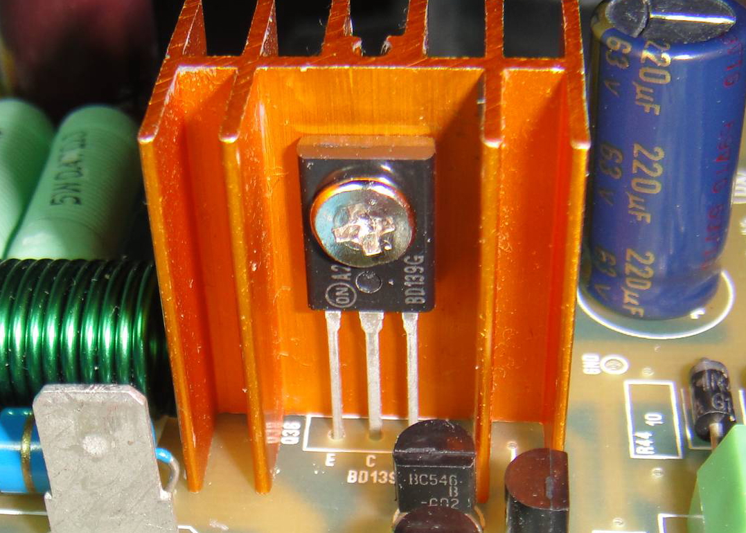

I thought that I don't have more BC556 and BC546 I found them in a bag nice! so I took more pictures so you guys can see how it look I will try to get the parts this week so I can place a full mounted board photos, here how it looks with the BC546 and BC556 plus I add the emitter resistors, actually this are not the one I'm going to use is just as visualization purpose so you guys have an idea you can use 3 watts too, I hope you like them.

I ok guys I'm just "modeling the board" calm dawn guys" jejejejejejejeje. all parts all lose don't kill me please I have to order those parts.

I was admiring the photos and a number 4 that caught my attention ... If you stay on site would become a real destroeir x (Google translate)
Ele botou o que tinha à mão Edson.... he used the transistor he had to show
how the board gonna look with parts populating it.
Agora corrigiu e vamos encerrar esse capítulo porque não foi êrro...e indicar êrro não é bom.... now corrected and i suggest you to end this chapter (conversation) because this looks you are finding errors and there's no real error.
He knows the transistor is not correct..he put there only to have something inserted into the holes.
Poor Juan..he dismounted something to fix the stuff not to generate panic.
Pobre Juan...êle desmontou alguma coisa para consertar a imagem para evitar pânico.
I do think is not your intention to generate panic..but this causes a lot of troubles..to point errors... and there's no real error on that.... parts are not soldered ..they are inserted into the pcboard only to populate and to produce advertisement photographies... as peças nem estão soldadas..foi só pra mostrar a placa... agradeço mas encerra por aqui por favor.

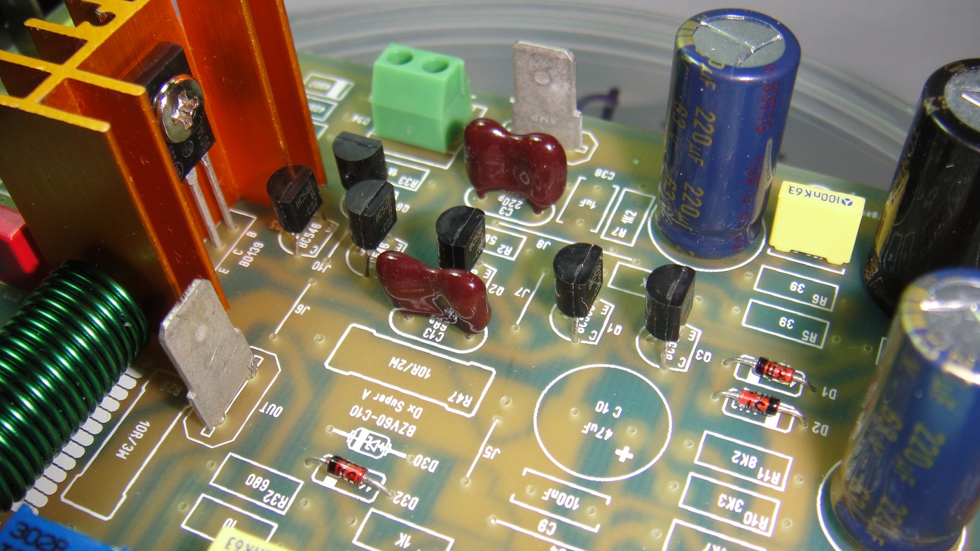

Hello guys!
I made a small video talking about pitch distance of the components also to show you guys how it looks I apologize for my Spanish accent came out to much, I will get the rest of the parts as soon as possible I'm working on mister Carlos Dx Regulated Power Supply I hope you enjoy this video, by the way those 100 ohms resistors are just to demonstrate how the resistor look like I have to get two 10R 5 watt resistors.

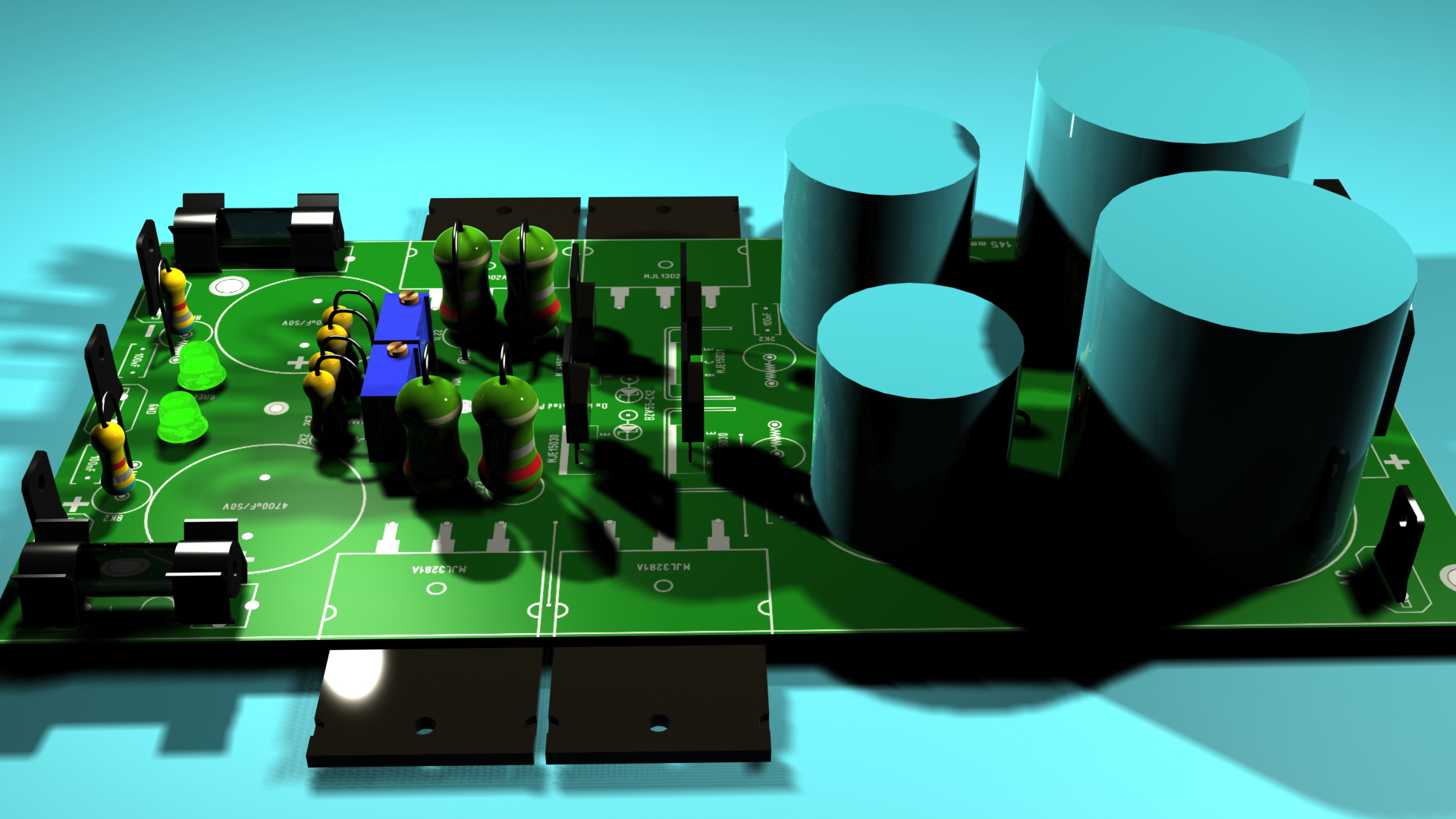

Here you see a 3D virtual image... we are finishing the supply layout and it gonna be published here, because it was made to be used together the Dx Super A.
