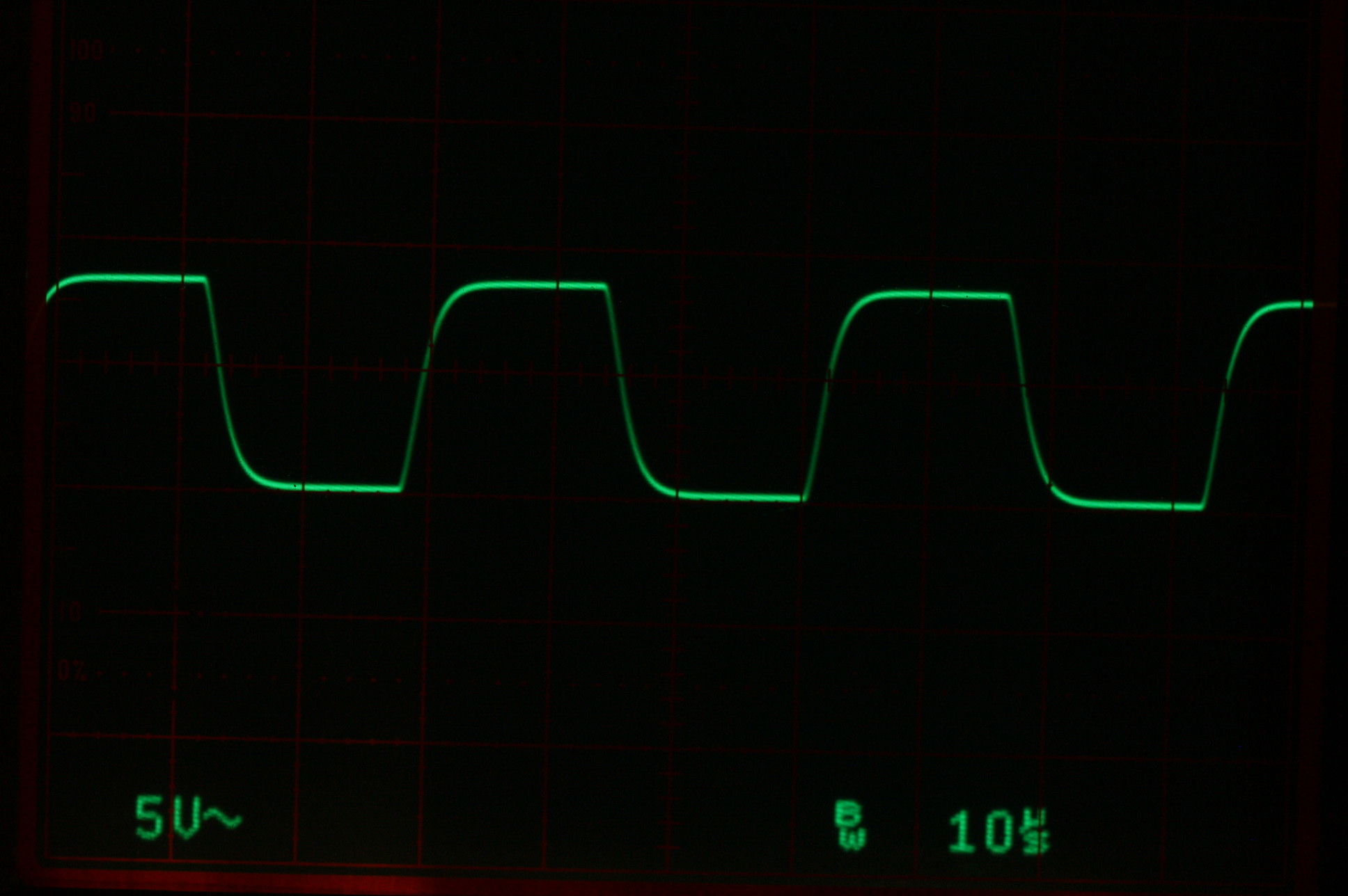

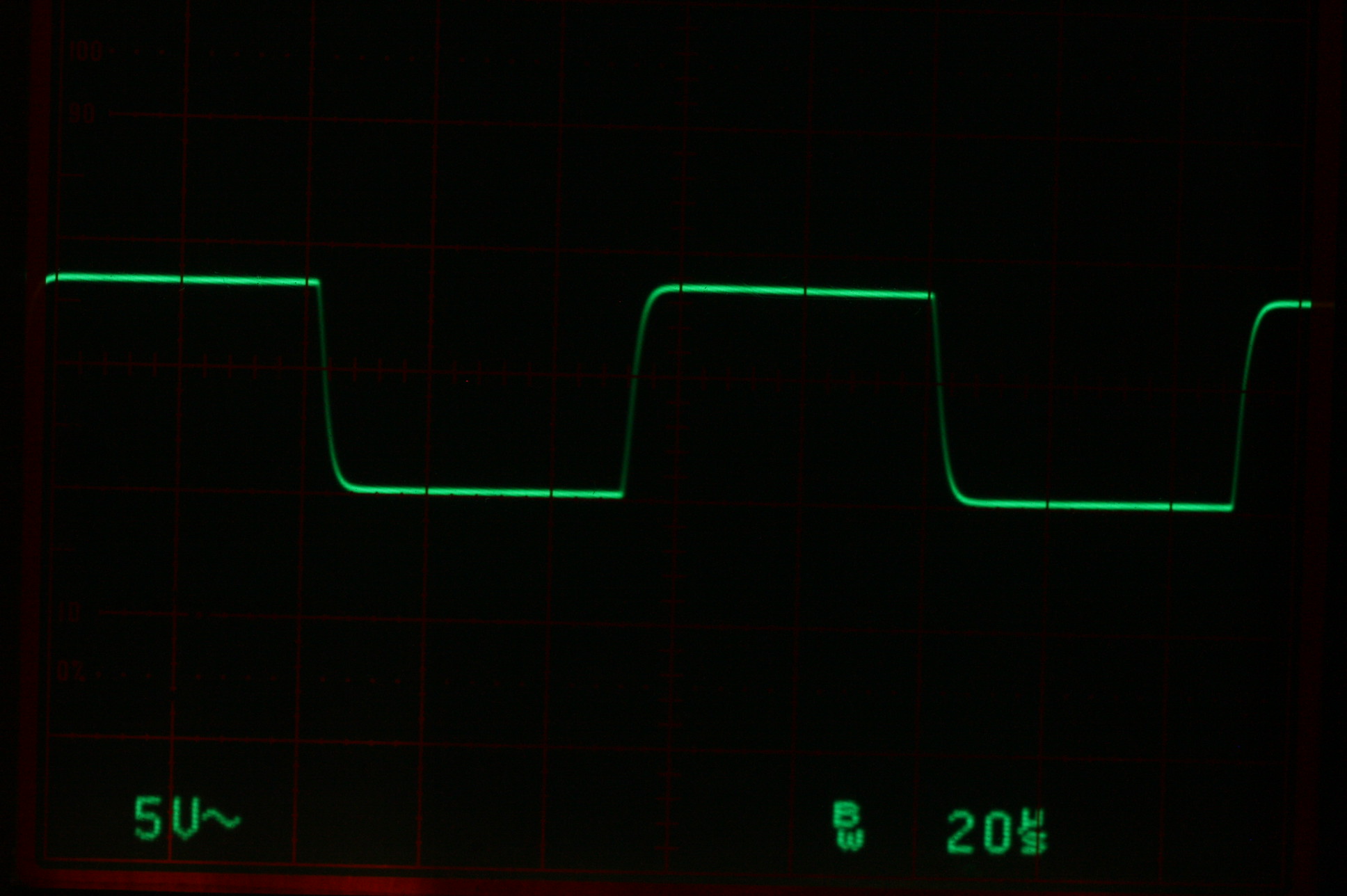

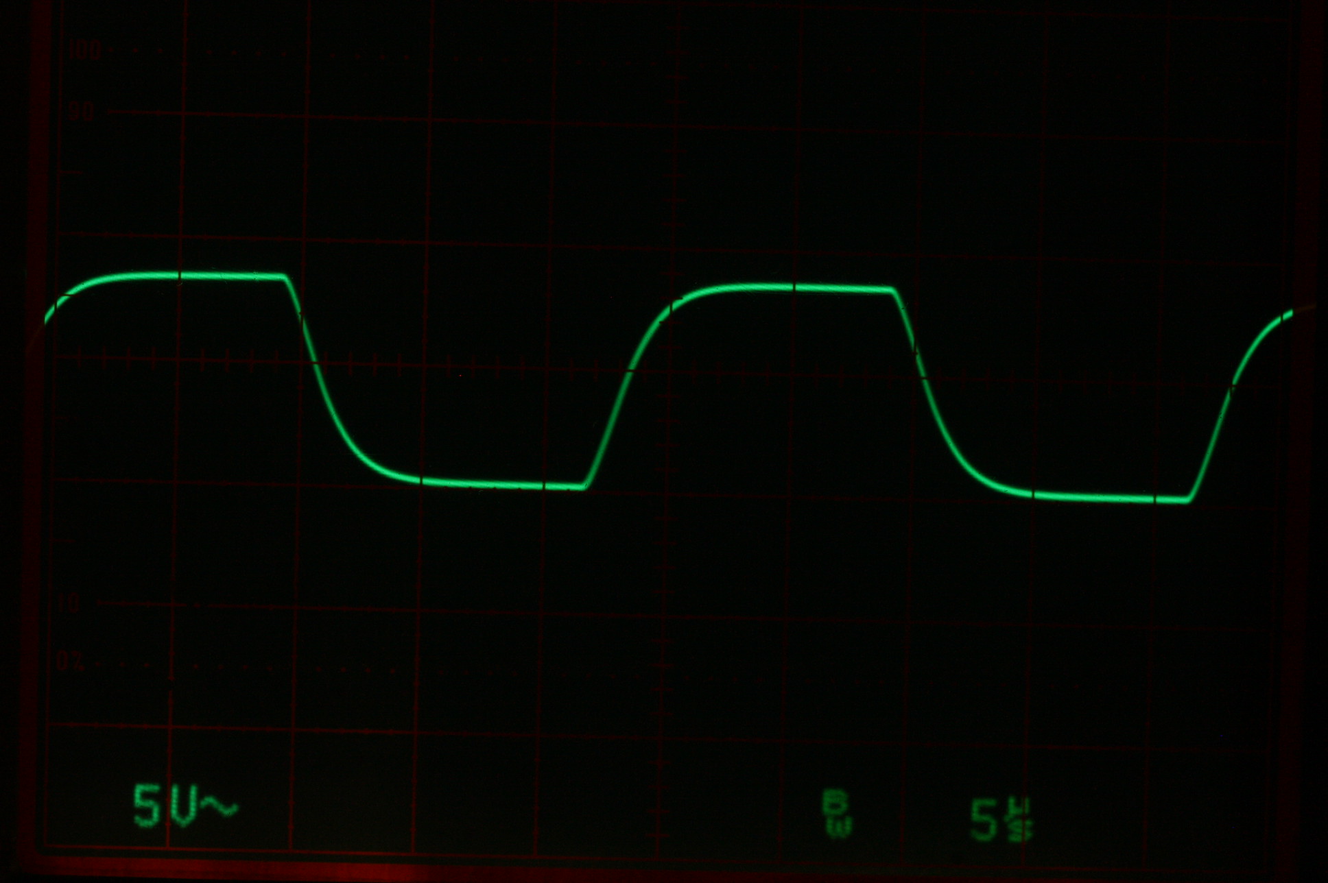

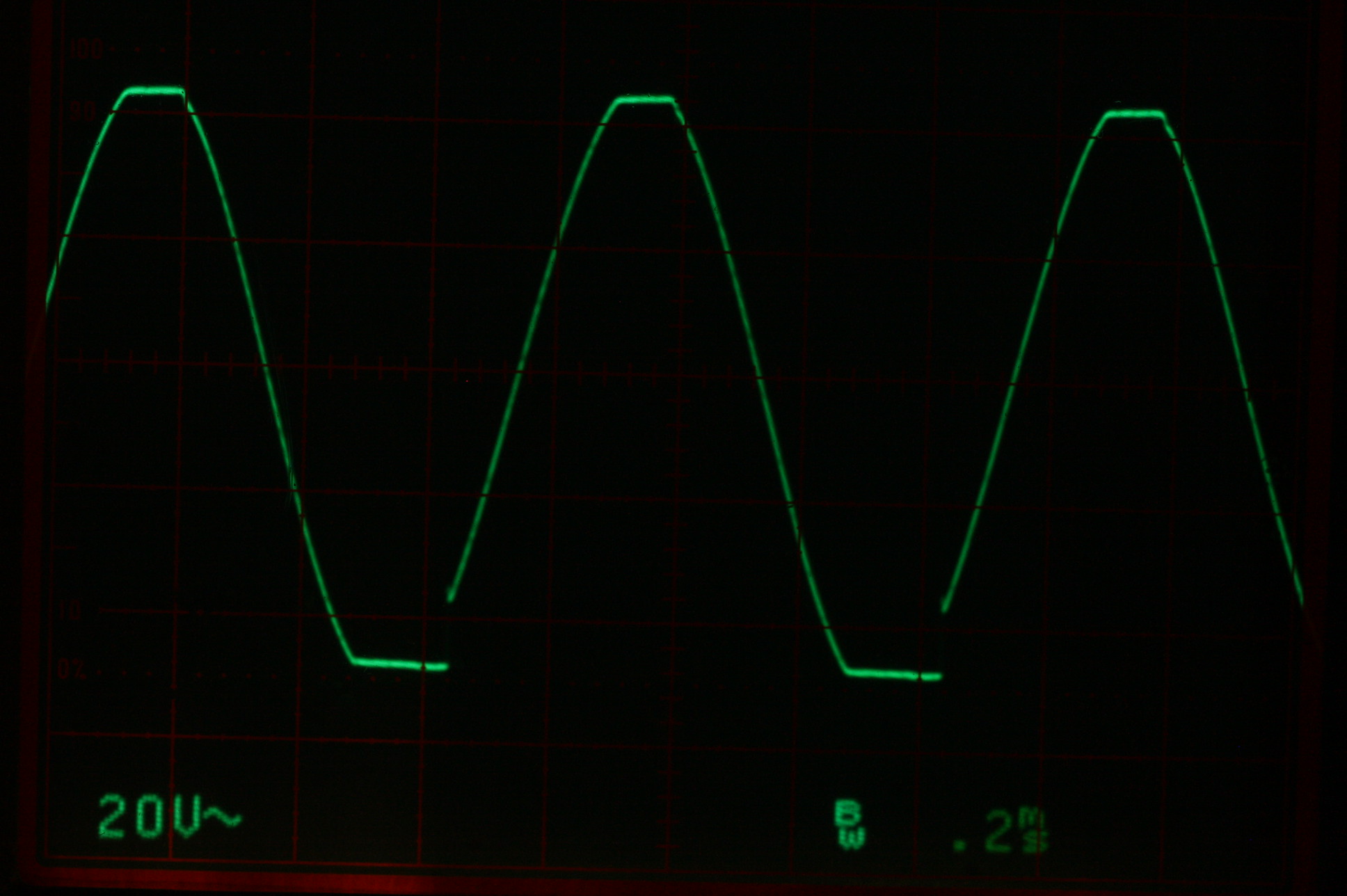

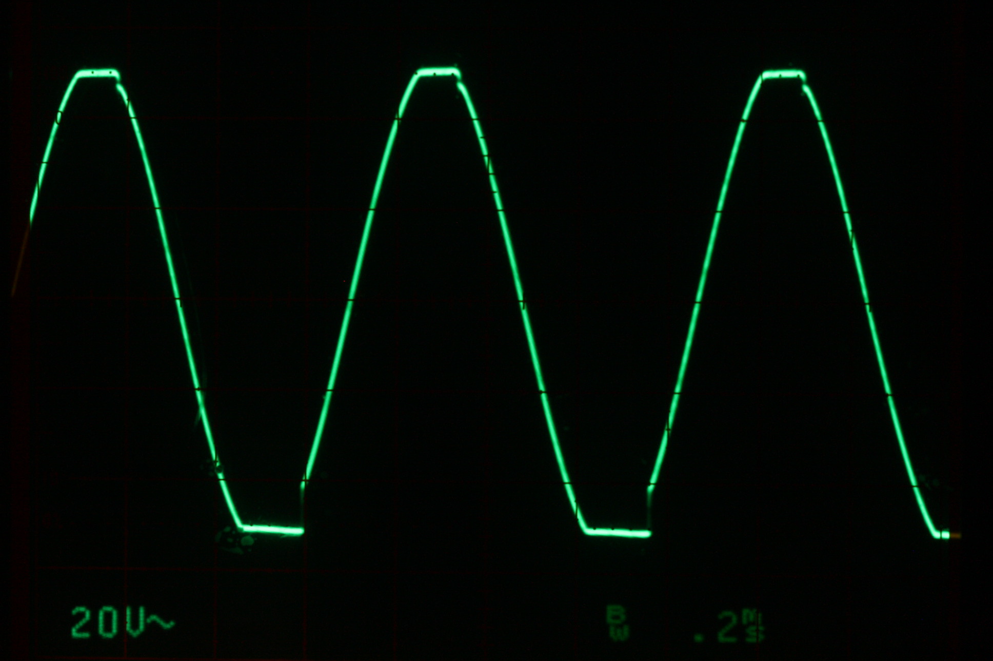

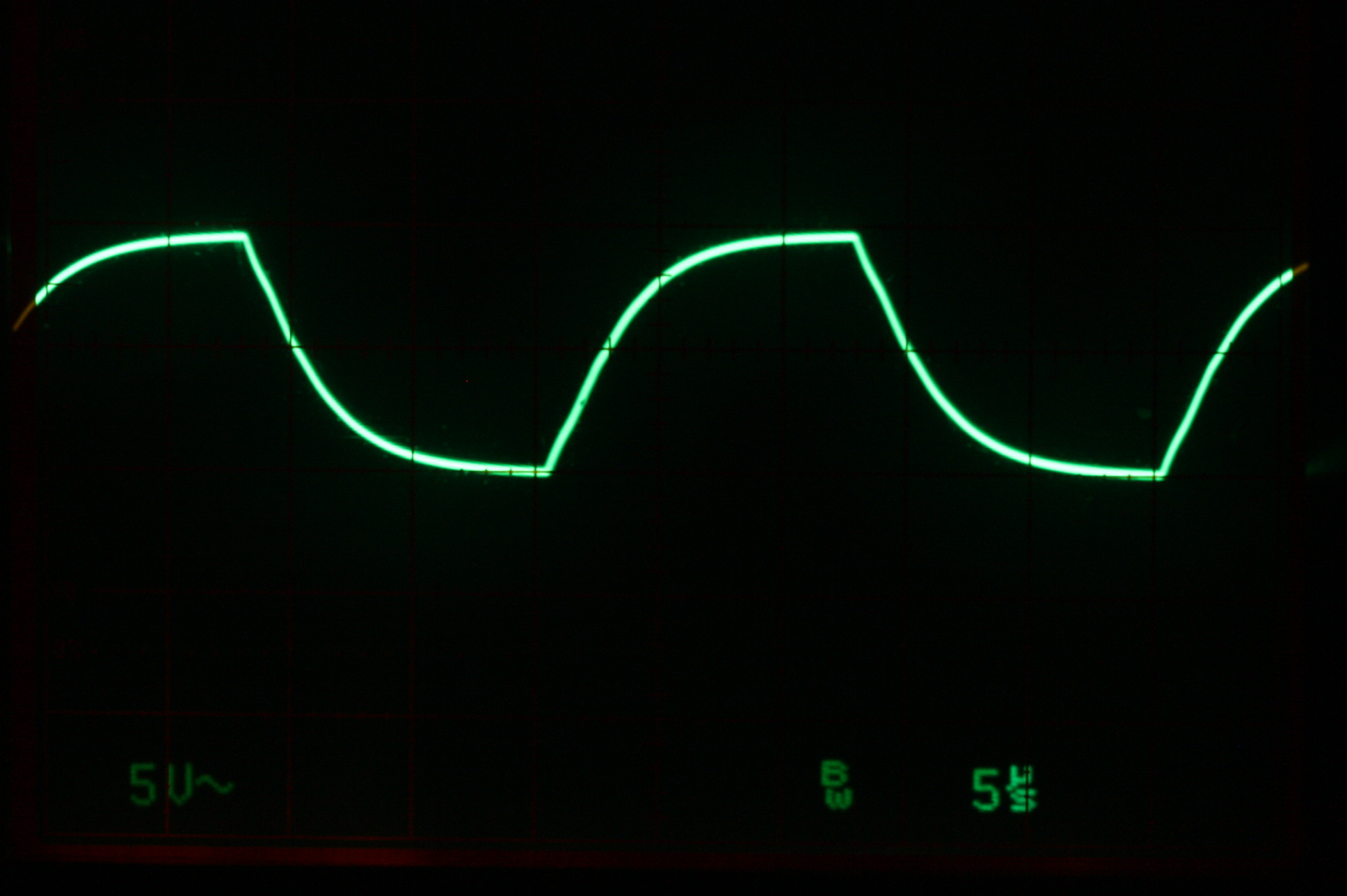

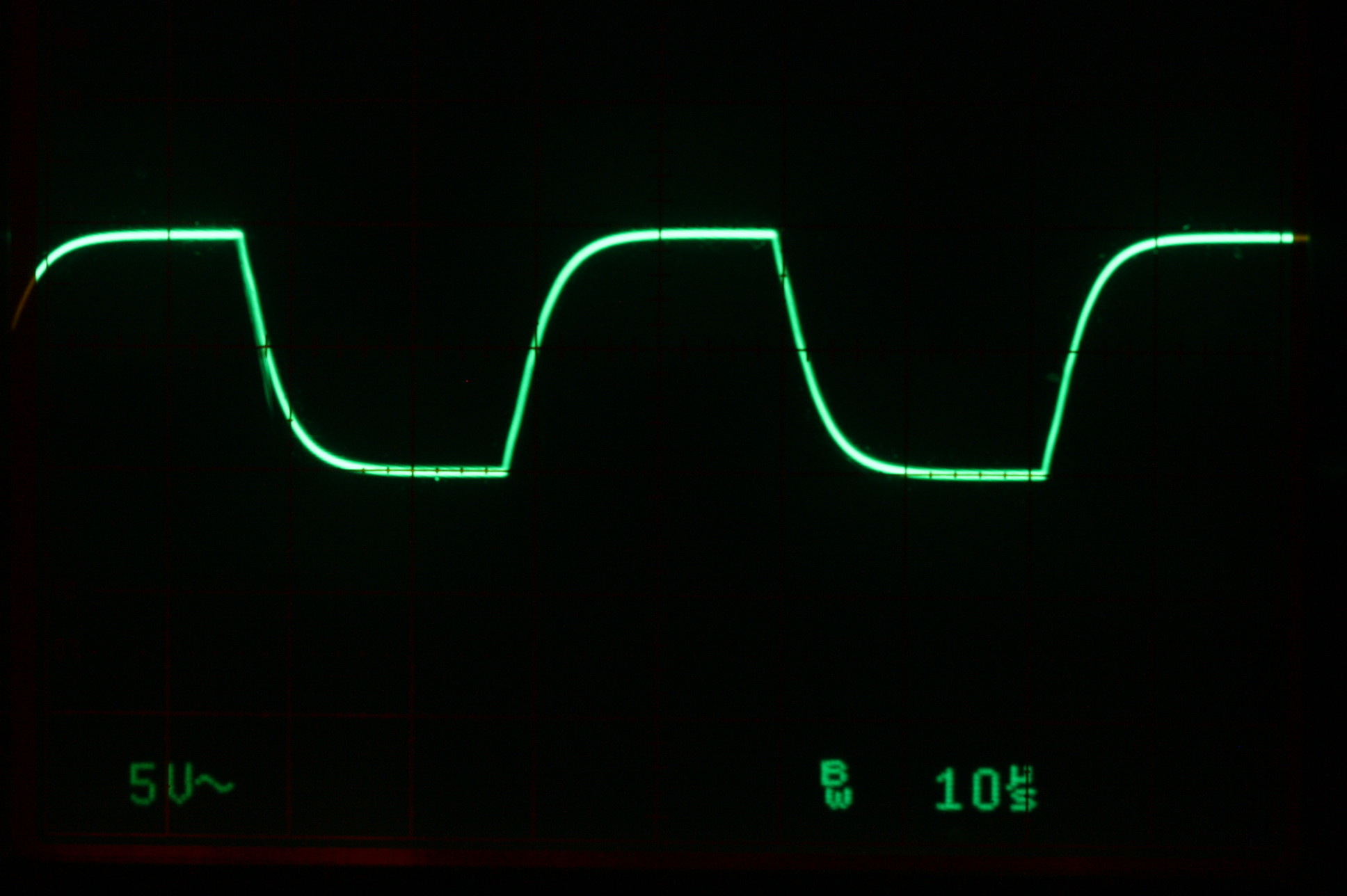

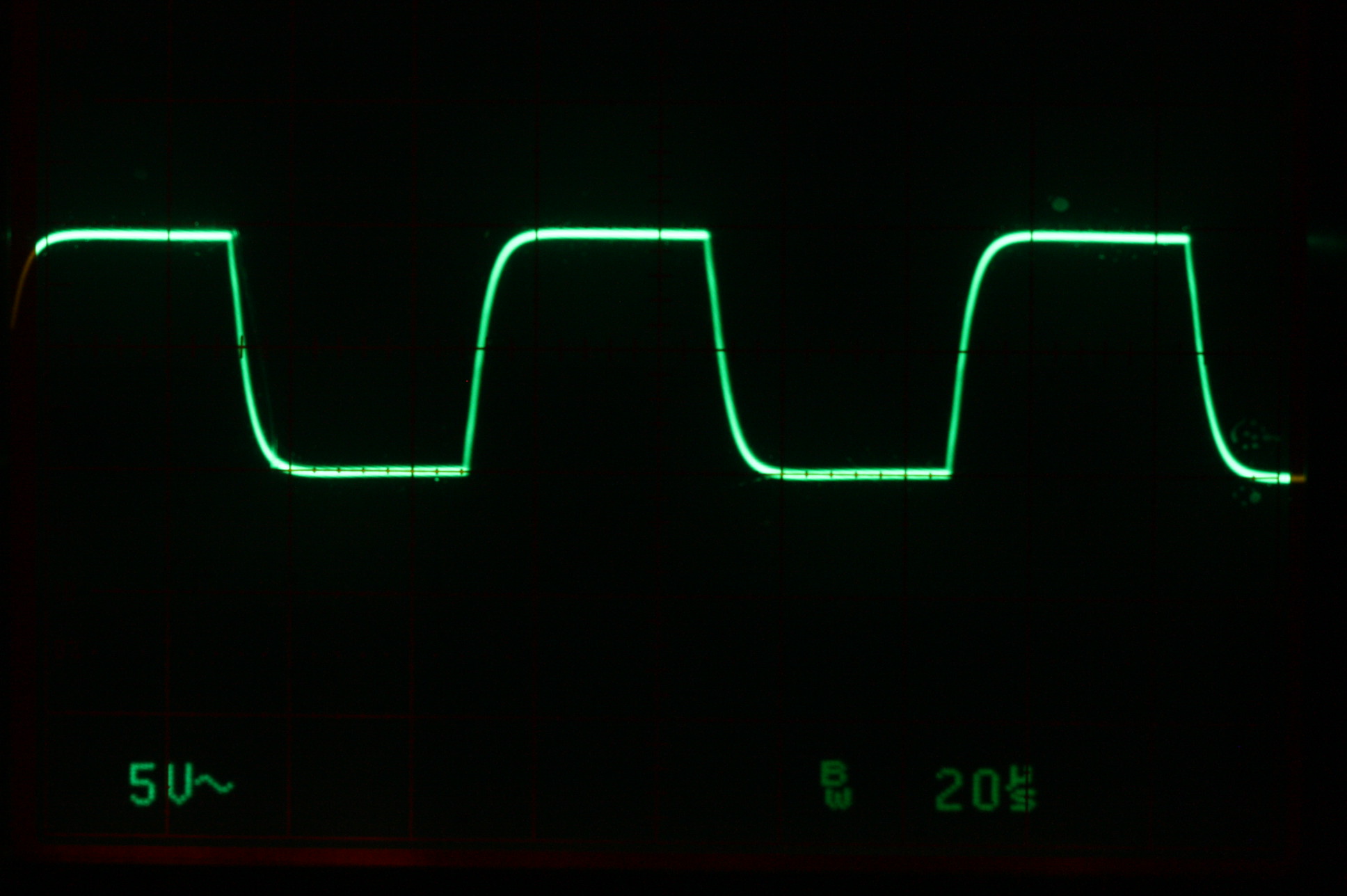

Blame Dx MK III test results
I have just completed some testing of a modified (lower gain) and unmodified Blame DX MK III. Both versions use 4 output pairs and have had driver base resistors increased to 56 ohms. See post 1212 for details of the modified version. Both produce their lowest measured distortion with about 56 mv of bias measured across both emitter resistors. 1 Khz THD into 8 ohms in the modified version is significantly lower by a factor of about 5 times at full power. This is presumably due to the higher feedback factor. Both sound very good to my ears.
See attached scope shots

The bias level that produced the lowest distortion is very close to that identified by Dr.Self as optimal for EF output stages with .47 ohm emitter resistors (see page 183 of Audio Power Amplifier Design Handbook. It does result in more idle current than the recommended bias and consequently more heat so adequate heat sinking is required.
The issue of troubles with parasitics is a separate matter. If you are unable to view waveforms on a wide band scope you don't know if you have this problem. It seems reasonable to take the precaution of installing the higher value driver base resistors as a cheap form of insurance.
Steve
