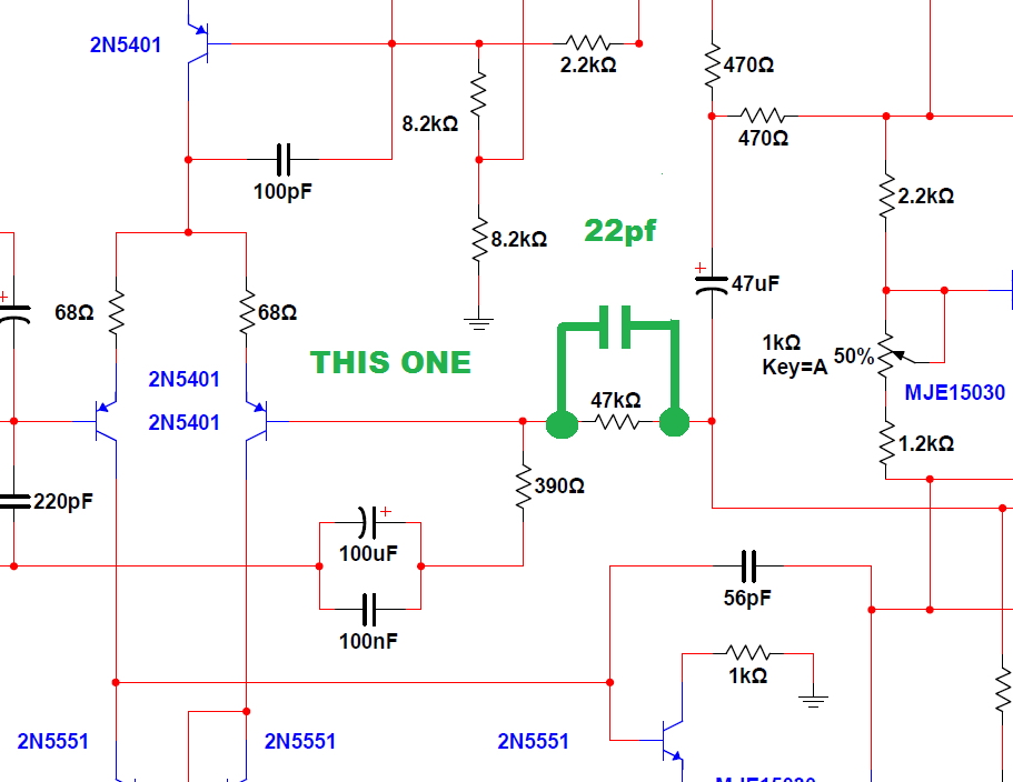

Frequency is approximately 4 Mhz. Checked all caps and they are standard per the parts list. No changes made at this point.
It seems unlikely that this oscillation is related to loop instability at so high a frequency. Do you agree? If it is purely a parasitic then I assume changing Cdom won't help. Any ideas for hunting down the source would be appreciated.
Steve
Usually oscilations are higher in frequency....i do not know what is this
I would use the try and error using the standard practices to cancell unstabilities....capacitors from base to colector, increase of Cdom, increase of stop resistors, reduction in gain and inclusion of NFB line capacitor.
Also the search of interferences... if using audio sources it would be good to inspect the input signal without plug it into the amplifier and then after plug it into the amplifier input.... the search of Radio Frequency oscilators around.... digital watch, electronic Baby sitter, wireless telephone...well...things that can use 1 Megahertz clock cristal multiplied by 4 or a real 4 MHz cristal instaled as clock oscilator.... well....i do think you already did that.

Thanks Carlos. I will look into all of those. One question about "inclusion of feedback line capacitor" I'm not sure what this refers to. Can you explain?
Steve
Steve
There's a resistor connected to the second differential transistor...the one is
connected to the output line...and there, in series with the output line you have a resistor.... attach a low value capacitor in paralell with this resistor..this will limit the frequency response and and gain in presence of high frequency signals that reaches or be developed in the output...it just reduces the audio bandwidth cutting out HF energy..... withing the spectrum of frequency you are facing.
3pf, 5pf,7pf,10pf,12pf,15pf,18pf and 22pf are values more often used.... i suggest you to try the highest one because your frequency is low inside the HF spectrum (3 to 30 Megahertz aprox.)
This is called NFB (Negative Feedback Line).... so, it is the output line that has a more sophisticated name....i use to be simple.... output line is the way i call it.
Surgery i have made is called by Doctors as Dermolipectomy...i call this "removing excess of skin."
This works in a very simple way.... radio frequencies due to oscilations, or signal picked by antenna (audio cable) is present in the output line, or NFB line.... then it crosses the capacitor that is a short for such kind of frequencies and drives, as a result, the second differential transistor that automatically reduces the gain of this differential pair.... when oscilations are because of gain..then the trouble is fixed.... when the signal present is picked, then the reduction of gain makes it small in order you cannot see it superimposed to the scope scanning line...if you cannot see it..then it does not bother you and you go in peace living with the spurious without knowing it is there.

Introducing this extra capacitor often leads to extra or worse oscillation of the amplifier.
not as little as "sometimes".sometimes goes worse
Happened once that oscillated even worse.
More likely to be "often", particularly if one guesses at a value without realising why that capacitor should or should not be there.
