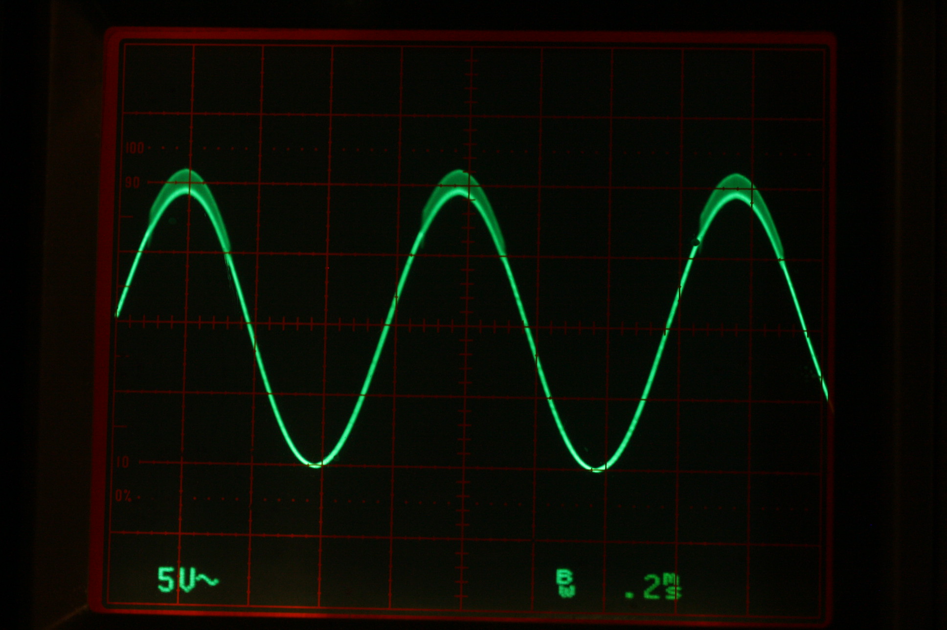

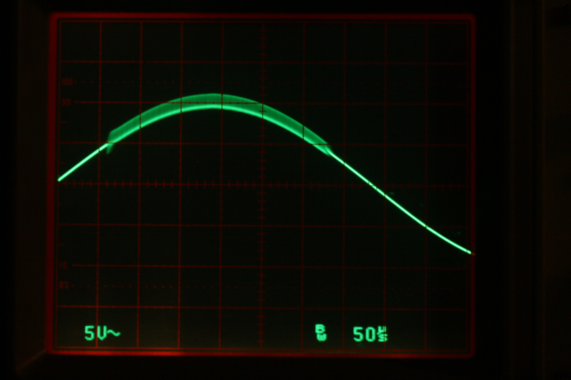

Awfull waveform Bonfis
This is not normal..... are you using big condensers (size) in your input?... please, post pictures.
Was this test made using speakers or resistive load (dummy load)...have your tried to unstabilize using capacitor in paralel with the load?

So 220pf gives best stability , but higher distortion, 52 pf gives lowest stability but lowest distortion ...?

Hi Carlos-
The input cap is 2.2 uf. Cdom is 180 pf. The load is 8 ohm resistor. Have not tried to play into a speaker or a capacitive load yet. I am going to recheck all component values and then try increasing Cdom. I will post results.
Steve

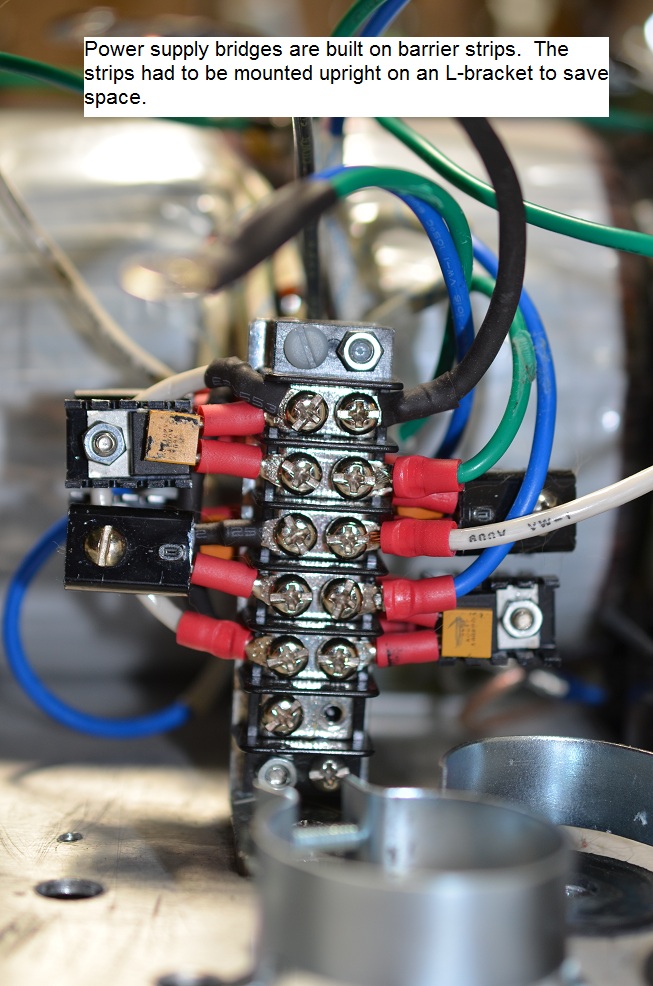

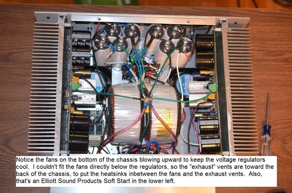

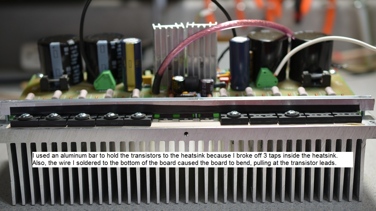

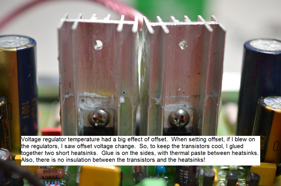

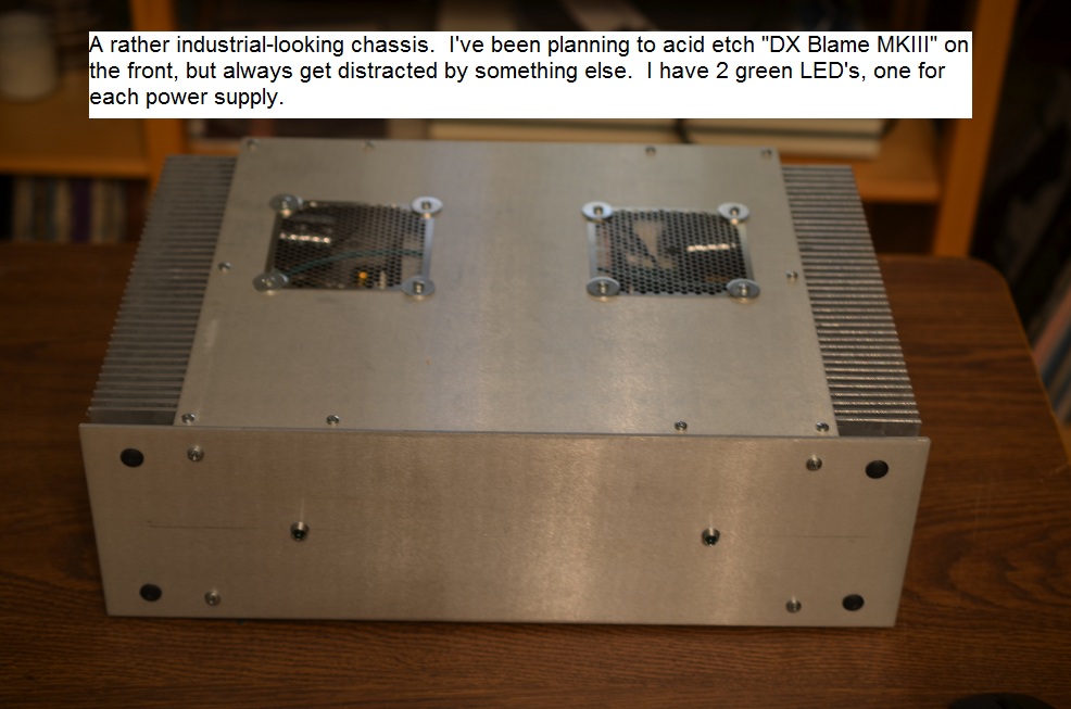

A re-post of my finished DX Blame MKIII with pictures
I noticed this thread has come back to life recently. I finished my DX Blame MKIII in January, and posted my final comments without any pictures, because I didn't have a digital camera. I've since bought a nice Nikon D5100 with a macro lens. So I thought I'd re-post my final build with photos. I haven't done any measurements, even though I bought an oscilloscope since finishing this. I guess I'm so happy with the sound - why measure anything?

Tried 1mv - 28mv across 1 emitter resistor. Parasitic did not change.

Yep..... for sure Bonfis
Can you please post pictures of your amplifier...this may help a little to observe if you are using something different than the standard spectation.
Also, can you inform the superimposed oscilation frequency.
