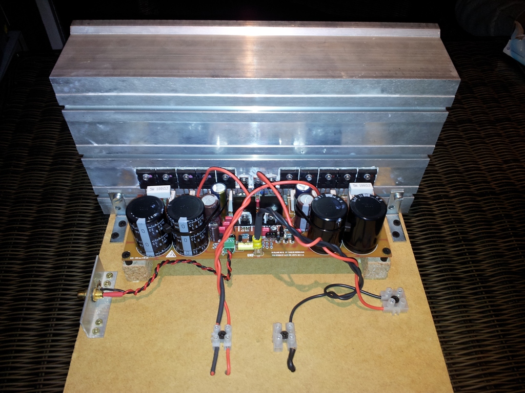

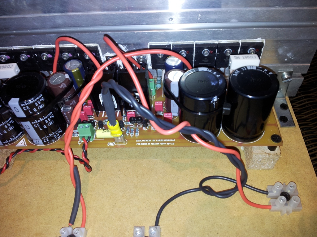

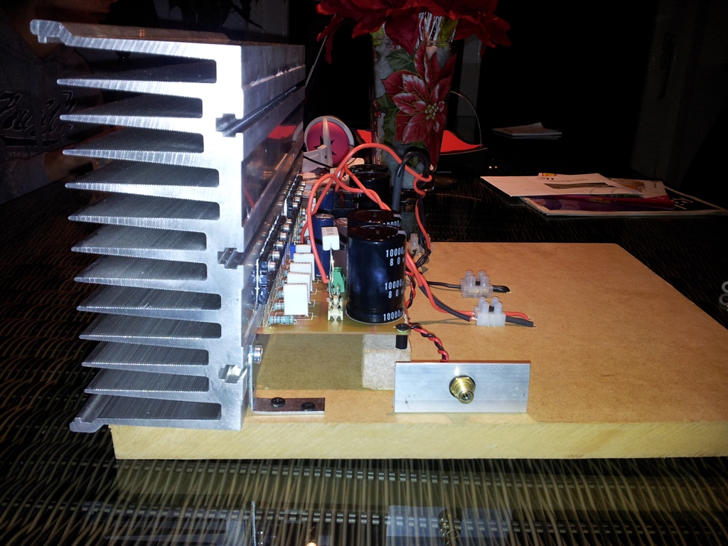

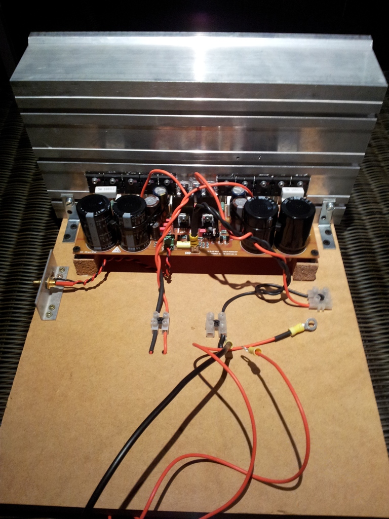

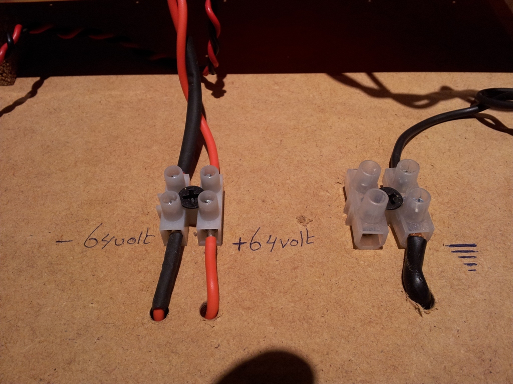

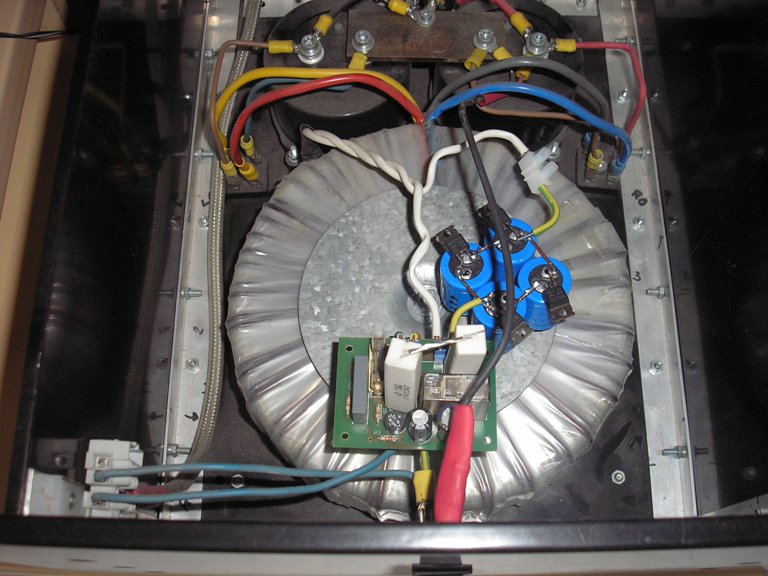

One Dx Blame MKIII-Hx amplifier is ready.
Tomorrow I test the amplifier with my existing power supply, 3 screws and the amplifier is connected.

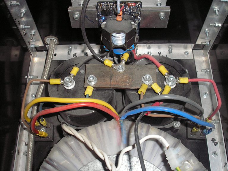

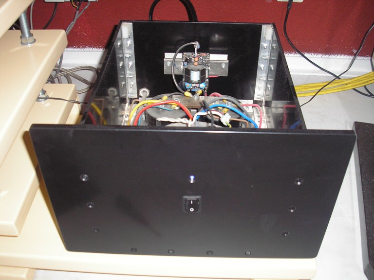

This is my Zappulse 2.3SE amplifier monoblock 1 Torroid 2000VA 2 x 42 volt, not look at the dust, this is an old picture
The 2 elco's are Mundorf 47000uF 80V MLytic High Current, I supose that 94.000uF is enough.
This is a homemade cabinet, front is 10 mm thick and side panels and bottom 6 mm thick.
Build another cabinet, because this cabinet is to small for the Dx Blame MKIII-Hx amplifier
