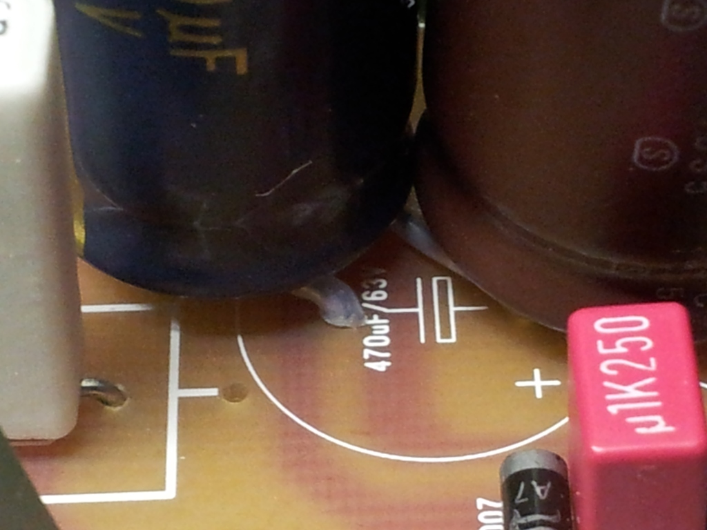

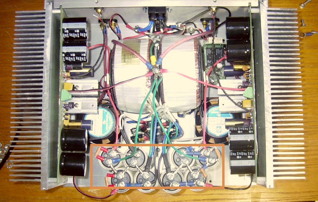

Oh!...that's terrible Byron.... connected to negative lead?
Not a good choice the condenser factory made..... unbelievable error from the industry..these can must be insulated from the condenser poles.... yeah.... retarded brain solution... a surprise to me these things...i have never found a unit like that.
Well...i am glad you have found the problem...now think in a solution to keep your lovely condensers..they look good and i know you love them...you may find the way..insulating it with rubber, wood, or any other insulating material...not to loose them.
regards,
Carlos

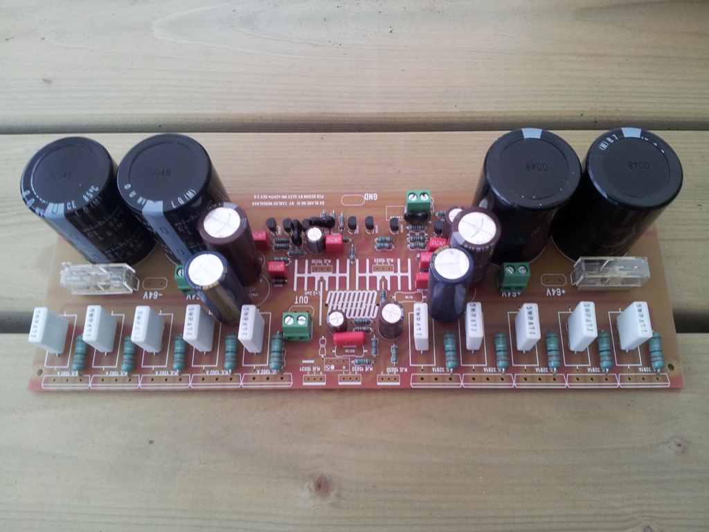

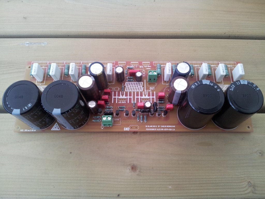

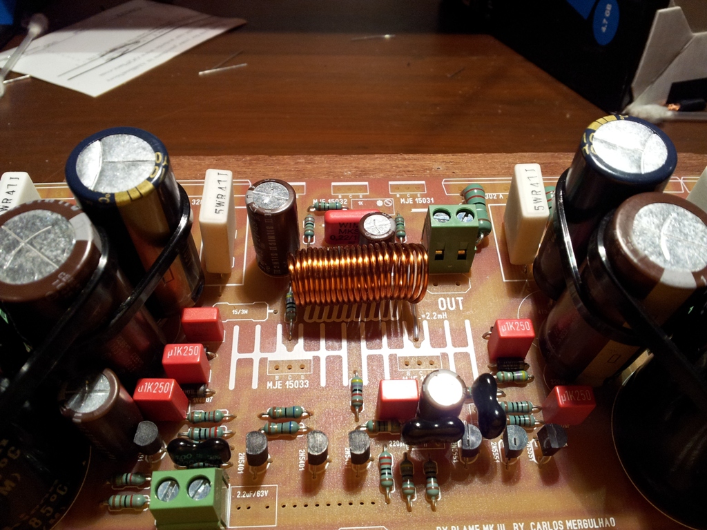

The components that you are seeing now on the board are soldered now, 1 amplifier is now almost finished I wait with the other board, first to test this one.
Now I make the light-bulb tester, I have all the components.
The small heat sinks are on the way and the M3 machine tap is also ordered for tapping into the large heat sinks.
On the photo you can see how I have solved the 220uF 100 volts caps issue
The capacitor legs, I scrolled Teflon tube.
Rudy
p.s. I order also 2x Roederstein MKT1813 1,0uF 100V

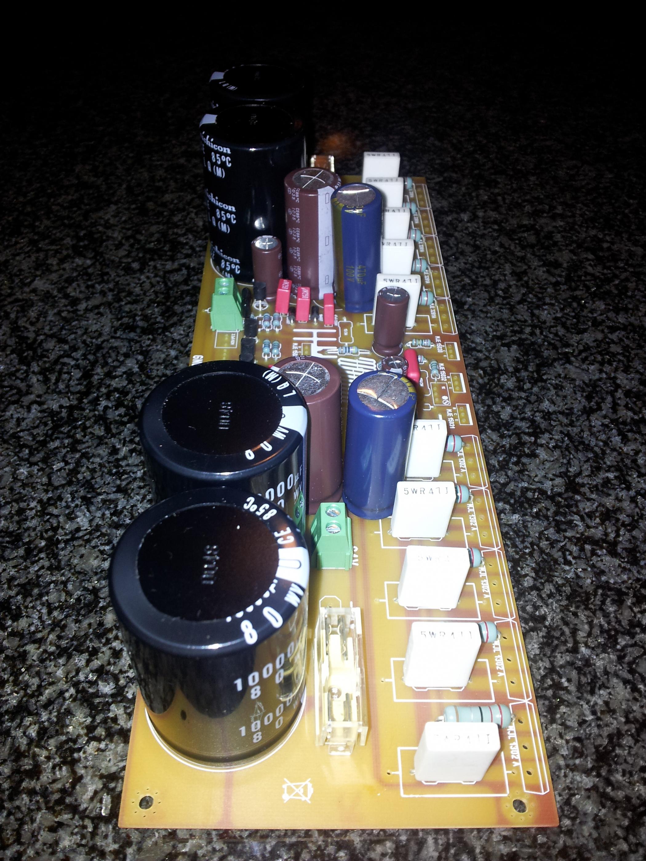

Tie wrap around a pair of close coupled capacitor cans is the equivalent to adding the bracing to the goalposts.
The +ve and -ve legs of the two capacitors are the equivalent to the bottom ends of the uprights of the goalposts.
I know next to nothing about football, glad i can compensate for it
with my knowledge of basic carpentry in this case 😀
You can apply the same technique to the 2 pairs of large powersupply-caps
by using some hotmelt-glue to link them.
This also has the effect of stiffening the pcb, the pair of ps-caps will act
as a brace.
Btw, i guess i was lucky with my Fischer & Tausche studded caps
10.000uF/63V.
I've seen studded caps in industrial applications mounted on a rail,
why a manufacturer fails to mention the connection from -ve to the housing
in the effin' datasheet is completely beyond me.
Klaas
