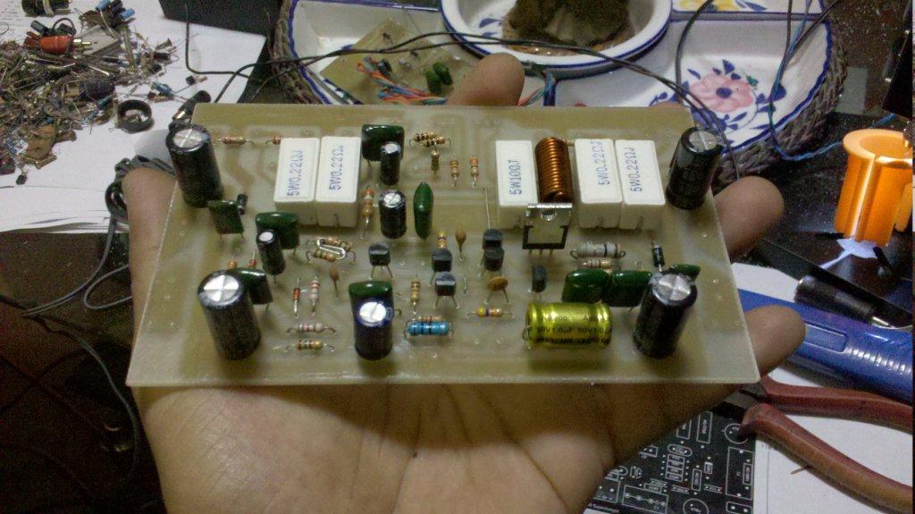

The output inductor is shown on the schematic as 2.2 uH and on the PCB it looks like 2.2mH. I assume 2.2 uH is correct.
Is there some guidance on how to wind the inductor - wire gauge, coil diameter and number of windings? I assume for this huge output some large gauge magnet wire is needed.
Thanks,
Francois
Use enameled copper wire.
Choose between 1.0mm diam and 1.6mm diam.
Find a former of between 10mm and 20mm diameter.
Wind on between 8turns and 20turns for less to more inductance.
The smaller diameter formers will need more turns to achieve similar inductance.
A single layer winding is OK.

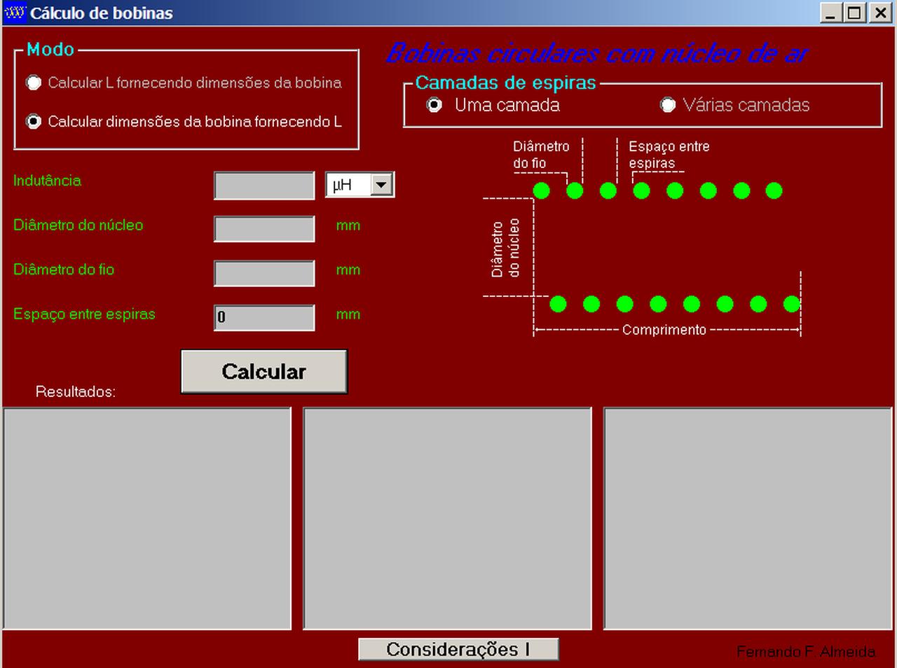

François G, if you have a basic understanding of portuguese
you can use a software i can send you...it is ony 1M size.
There are several coil calculator software around.... if you want this one them write to uncle charlie:
nanabrother@hotmail.com
carlos.eugenio1951@yahoo.com
Them i will send you the software.... there are some sentences you must translate to your language....but only a few sentences...see the image.
You can have any inductance value with any wire thickness...we use 1 to 3 milimeters thickness because they are easy to find, easy to make coils or (thick ones) they are mechanically resistant to continue having its shape even if you hit them with your arm, finger or any tool...you can make 2.2uh with any wire thickness, it is up to you to make it large or not large.... software offer mathematics calculation considering wire thickness, coil diameter, coil length and number of turns.
Image shows a picture with a small coil (more turns, small diameter) and other image shows a big coil, the one has less turns, thicker wire and large diameter.
regards,
Carlos
