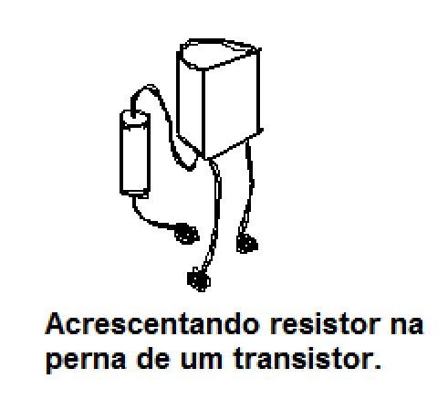

This is a solution when you have the need to insert a series resistor
a very ugly way to do...but works too...i do prefere to put underneath of the board as no one will see the mess.
regards,
Carlos

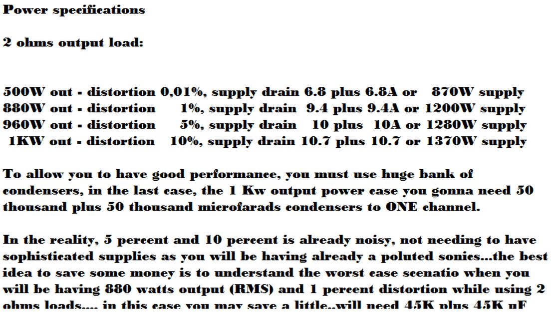

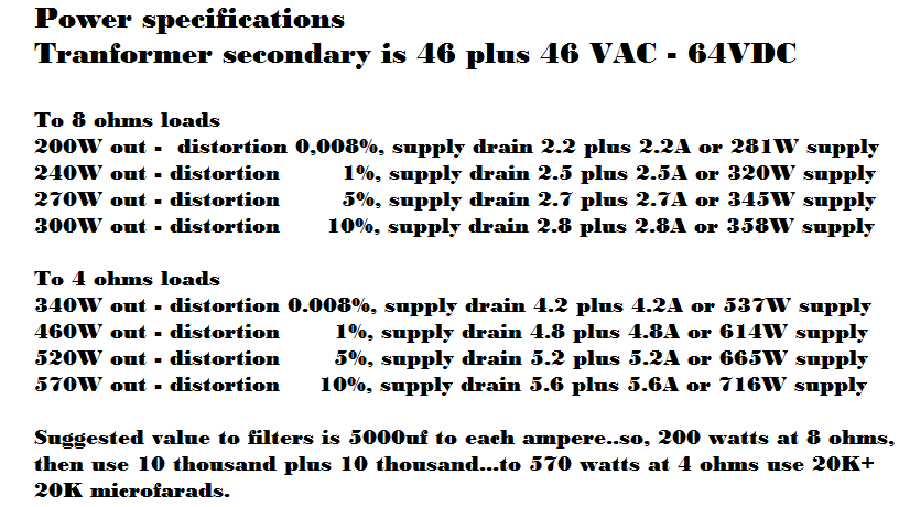

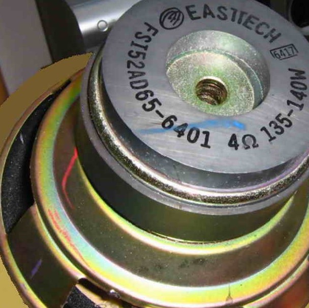

Be aware boys...you have now a high power amplifier
I was using my 150 watts Philips speaker and i have increased volume too much...power gone to 600 watts RMS and my speaker started to smell bad.... speake's voice coil resistance dropped to 2.9 ohms because of that.
So..... take care of your speakers...use high power driver units or do not increase too much your volume the way i did.

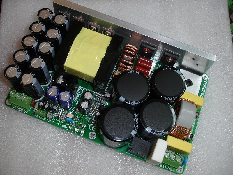

I've one SMPS in mind at SMPS forum and it's fully tested.What benefits we would have is the price and weight.Some people are saying that a conventional powersupply gives a better sound.Thelaudio claims that the regulation of a regulated powersupply may not be too tight it must have some voltage drop and this way you could use large spicing caps which benefits the sound.When I buy one it would be one of these from Connexelctronics.I must say the one I would build has almost the same layout.
The PSU must be able to meet the current demand of the load.
Transformers and smoothing capacitors can survive quite extreme overloading and continue to work without any apparent damage.
An SMPS must be designed to satisfy that same current demand, without suddenly entering some protection regime, because the speaker and the signal demanded more current than the SMPS was designed to supply.
Peak transient current specification must be developed to allow the SMPS to keep up with a transformer + smoothing caps.
