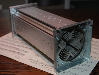

What a space, what an opportunity to spread the transistors physically!.................a better buffer for thermal transients.
The PCB is done. It fixes the devices in a tight group.
Looks like it is designed for blown tunnel cooling. At the maximum power expected they are more like PA amplifier PCBs, where blown cooling is the norm.
the PCB is done. It fixes the devices in a tight group.
Ah, with active cooling it's less of a concern yes 🙂 I just didn't get that from the chosen heatsink - if it would have been these high-density fin designs I'd have assumed active cooling.
^^^I guess you know this from your last 1kw/ch@1ohm build :rofl::rofl::rofl:
Err, ahh i guess you mised the xtra outputs or the 7" tall caps ...... room for the soft start, regulated supply and the 8.5x4 " transformer ..

Yes Andrew it is coated with a compound on both sides.I do use them very often.
Your concern is valid.
The PCB is designed for tunnel cooling, if high power must be dissipated.
That tall heatsink is quite unsuited to obtaining good heat dissipation efficiency with the PCB.
I will use this sink
Nice setup for fans, fans will not work for me due to the noise, i will have a fan to cool the case if temps escalate , but only for those brief moments. Also i do not like the heat concentration such a setup creates ....

Meanman,
I don't believe that setup at low speed with such a small sink will cool the outputs at such a load, well from past experience. Anyway such a setup was not an option for me , i needed a tall case and did not want a fan running constantly.
Why not the big sinks, it's not unprecedented ..?
regards,
They're nice heatsinks. I plan to passively cool my amp as well, they'll be reasonably big at approximately 0.0135 K/W. They will form the sides of the case and the PCB will be designed to be mounted to the back of the heatink. All TO220 semis along with the outputs will be cooled by it.
