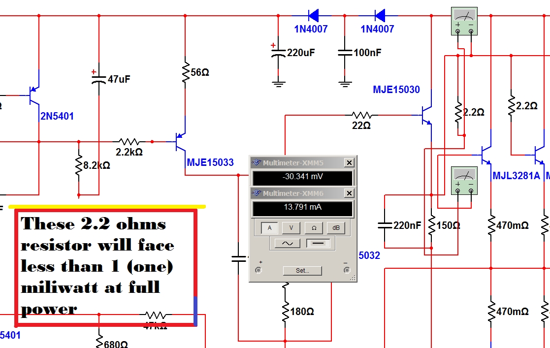

Tomorrow I will look to the bottom off the print, maybe I can soldering the resistor on the bottom off the board, then I use the 2R2 1 watt.
Rudy
Rudy
These 2.2 ohms resistors will face less than one miliwatt of power
I have decided resistors to be 1/2 watt as standard..some of them are very big to the real needs.
Do not exagerate guys...use the ones will look good, and in this case, the power is not something to worry about.
These are stop resistors, to avoid oscilations only..to work together the base to emitter capacitance....in that position we have a very small ammount of power folks.... even a micro SMD resistor will fit... use the one will look good filling the space we have... respecting clearance and aesthetics.

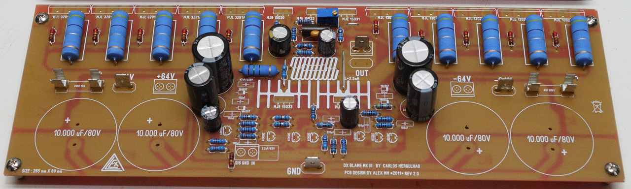

As i have made comments in a video... there are holes in this board that does not fit the resistor standard size related the lead diameter... the 1N4007 is one of them.

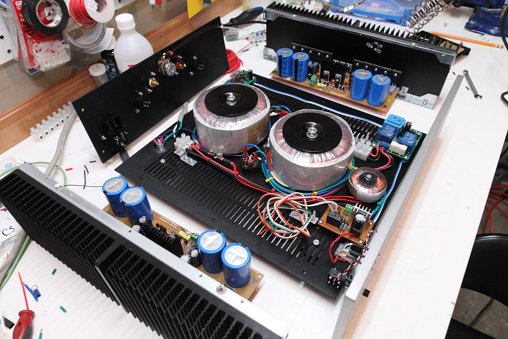

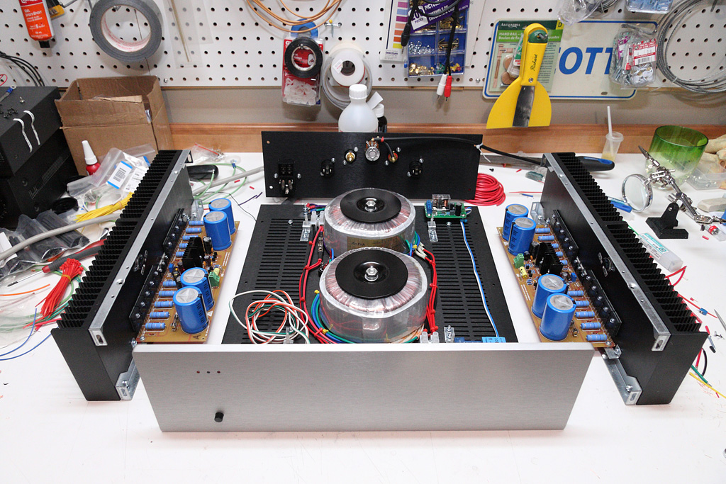

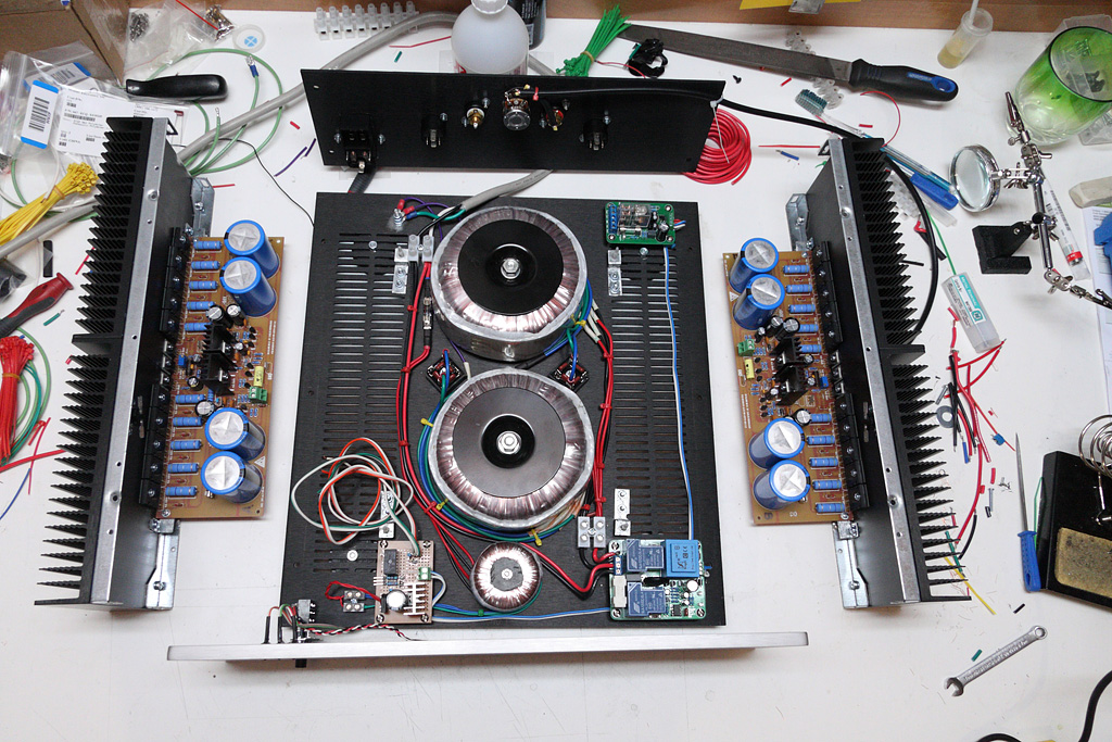

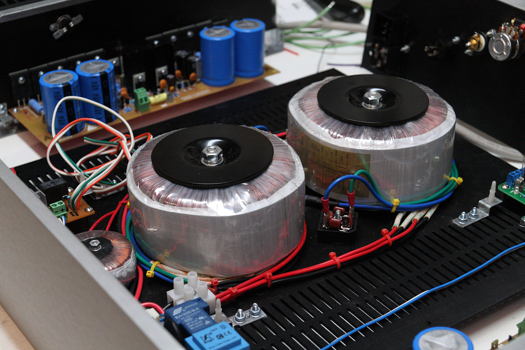

... back to the main subject, I just finished wiring all the AC portion, the standby circuit (except overheat switches), the softstart and speaker protection.
Next steps are to assemble the chassis, then wire the DC, line input and speaker output ... then, silence no more; enter tinnitus hahaha (well, it can only worsen that, D'OH!).
Pics below 🙂
You can see some of my shots >> THERE <<
Pics below 🙂

Hello Cannonica, which soft start did you decide on ...? OK , i see, what's the small tranny powering ?
The softstart is the one from connexelectronic. It does the trick, the only thing is that the hi-current terminal block is small and I had difficulties connecting 14AWG wires. I strip the thread on a screw on one of the connectors. I had to cut the connector and replace that broken connection with a post where I soldered the wire.
The small transfo you see is for powering the standby circuit I've created (bottom left in picture).
Martin.
The 15R 3Watts I installed is rather big... a Xicon 283-15-RC.
Hi Canonnica,
Are the 15R 3 watt resistors installed correctly? I believe the emitter resistors should be 0.47 or did I misunderstand you?
Francois
Hi Canonnica,
Francois
I was talking about another one. The 0.47R/5W in my case are Xicon 286-0.47-RC

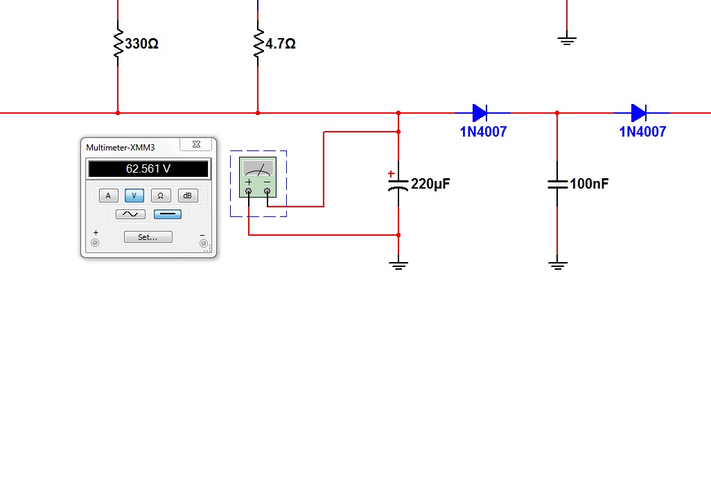

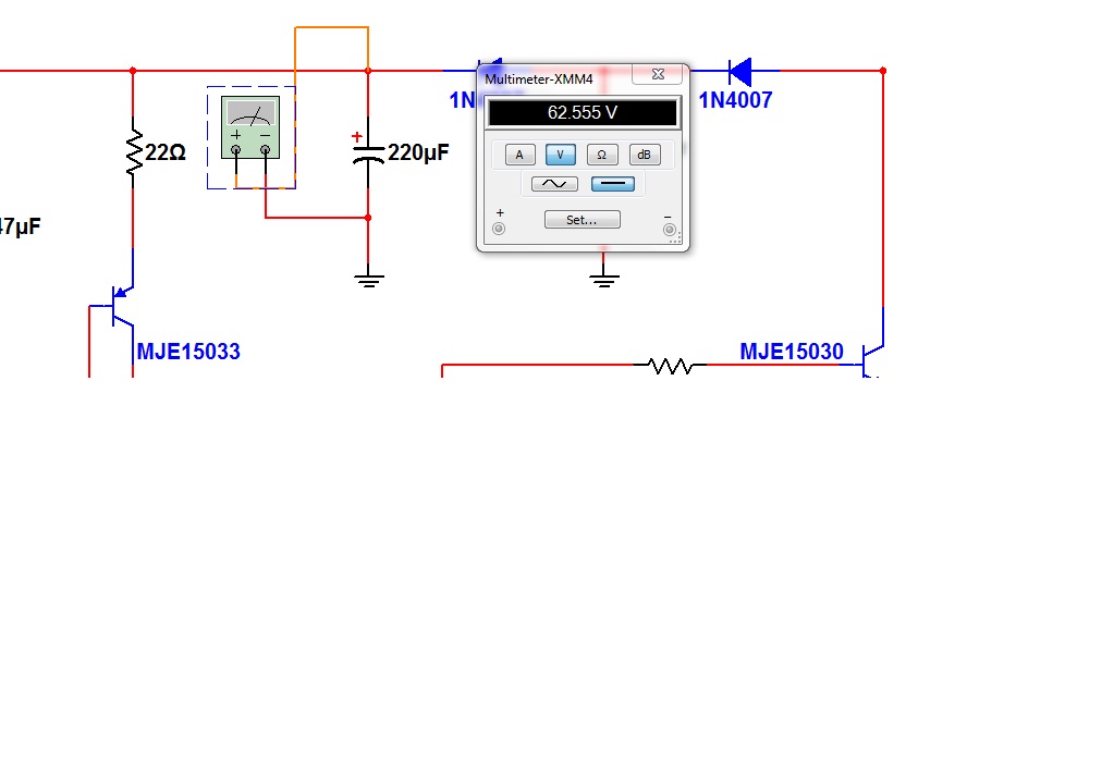

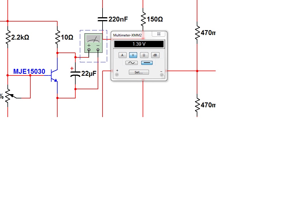

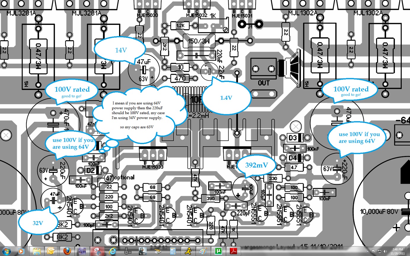

Maybe this picture is helpfull because some caps don't need 80 volt ones.
Rudy
p.s. The credits for this picture going to, vargasmongo
Rudy
Here some other pic's.
Vargasmongo using Multisim 11 software .
Hoopfully he don't mind I post his pictures, because everybody can use them.
Rudy
Rudy
