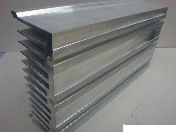

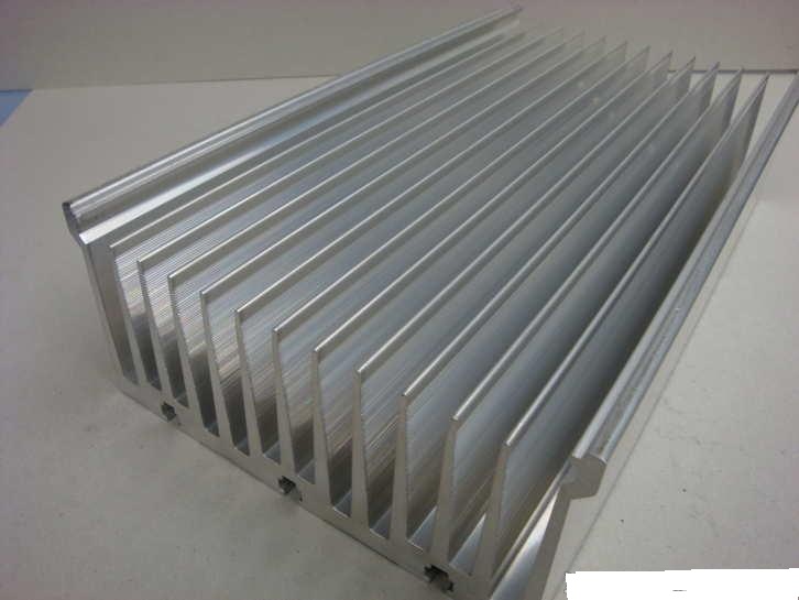

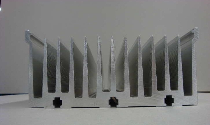

What a nice case, can you tell me the dimensions of the heatsinks?
Case and heatsinks are from Par Metal. Par-Metal It's the HS-11XX-x. Case is here: Par-Metal It's #12-19125-x. Heatsinks are exactly 4 7/8" tall.
Actually, I planned the whole thing out in MS Powerpoint, and knew it would be a really tight fit. But then I decided to add a soft start after I ordered the case, and my bridge rectifier ended up larger than I expected.

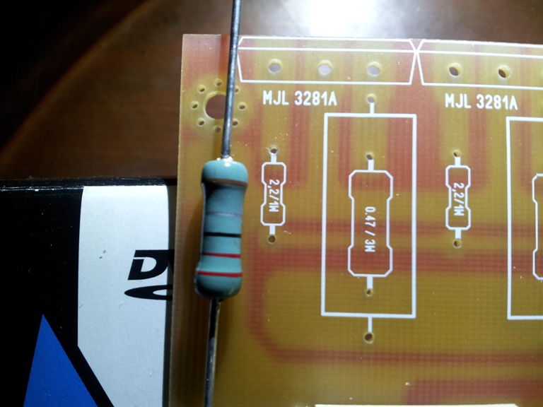

Yesterday 20 pieces 1 watt resistors retrieved and I have again a wrong order placed, because it does not fit on the print.
See picture ...
Rudy
Edit:
This is on the parts list: R24 A to J
2.2 1W 10mm PR01000102208JR500 Vishay Metal Film Resistors - Through Hole 1watt 2.2ohms 5% 10
