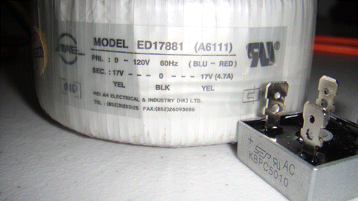

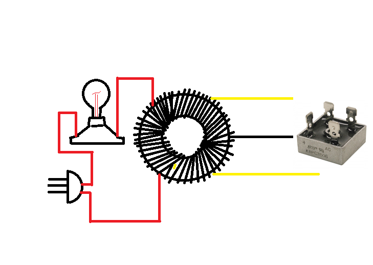

Can I use +24 0 -24 insteed of 12?
Hi mister Carlos!
what about 24V I have one toroidal transformer that supply after rectification and filtering exactly +24 0 -24 volts can I use that?
Hi mister Carlos!
Yes you can...but if your transformer is huge, or something
able to supply power... then you should use some protective resistor, values from 10 to 100 ohms...any value is acceptable, in series with positive and negative supply rail.
The idea is to try a low power transformer.... these ones we usually have available from preamplifiers, tape decks and other appliances...small transformers... units that cannot supply too much current under short circuit.
these transformers, for testing purposes, will be good if they have three wires in the secondary, or symetrical voltage.... 9 plus 9 volts, 12 plus 12 volts alternated, 15 plus 15 volts, 18 plus 18 volts and so on...small ones.... when trying big ones..then use resistors in series...because a short in your board will drain all current from the transformer..and a mid size transformer can supply 30 amperes or more under short circuit..and this current may melt tracks from your board.

Vargas,
use a light-bulb tester, something like this:
and wire it in serial with the mains.
The light bulb-tester will limit the current flowing into the primaries of the transformator to the value that you chose for the lamp
(for example: 30 Watt). The transformer's output will then be limited to this value as well!
Best regards - Rudi
Best regards - Rudi
Yep...the idea is to limit the current.... and the series
light bulb does that too.... it is a very good solution.

There are several possible solutions dear Juan
A variac controling the transformer primary voltage is also a good idea... also people can use two to one transformer...for instance; if you have a 110 primary and a 27.5 plus 27.5 VAC secondary.... so, reduction is 2 to 1... a step down unit....now connect this secondary of 27.5 plus 27.5 volts alternated into your main transformer primary... when this main transformer primary is wired to 110 volts and will receive a half of that...then your output voltage will be reduced to a half.
The idea is to try less power, less voltage, less energy, when testing appliances...sometimes we have shorts in the board...a short circuit may drain a lot of current and this current depends on your supply current...so, if you produce a "sabotage" using a light bulb, or series resistors, or Variac, or step down transformer..then you will supply less energy in order to save your pcboard to be melted.
Sometimes bias trimpot has bad solder..cold joint... cold solder.... or other problem.... maybe a misadjustment in the trimpot...then the current can go to infinite....if you provide infinite current than board will melt...if you provide current your transistors can face..then they will survive...this is the idea..to provide, while testing, small energy in order to save your pcboard or transistors if you have something wrong on there.

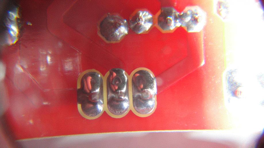

Oh I see, lower current that goes to the PCB track will keep them safe range so they do not act like "fuses", oh by the way my friend, today I finished put in all the trannies, and I have a magnifier and therefore check every single solder pad for shorts I have capture this image with the magnifier,good think you let me know about what would happen if I use to much current, nice man you save my life lol he he he he cool man.

Your picture shows a better condition compared to what i perceived
here... you have cleaned your pcboard, your solder was perfect despite looks that have already some rust on it....the clearance is not that bad.
