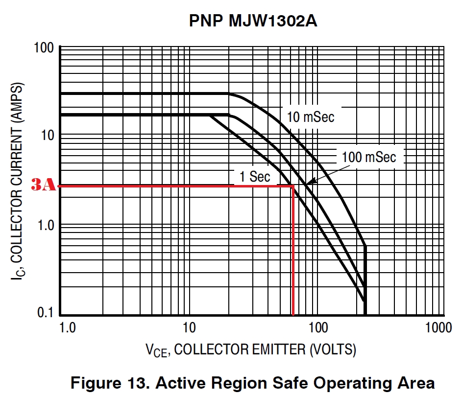

You should go to the smaller ones ...
... as they will be able to face 30A going to the speakers.... when the big ones (less quantity) will tolerate maximum of 24A.
Well... this depends if your supply voltage is really 64 volts...also the impedance you will use.
To our supply voltage, the smaller ones match the big ones...so... the advantage goes to the ones are in bigger quantity.
The advantage is to the smaller ones, in your case.
regards,
Carlos
My suggestion to use MJL4281A and counterpart is because
I have upgrading plans to increase power and supply voltage in the future...and then, the higher voltage transistors will be interesting.... also the 100 volts electrolitic condensers will be interesting, reason why i left them without correction to 63 volts.
One of these transistors accept 200 miliamps into 150 volts (VCE) and the other, the bigger one works with tree to four times more current...so, we can increase power when using MJL when we cannot do the same with MJW units .... MJL can work into 350 volts peak to peak when MJW will work maximum at 230 volts..... MJW will dissipate only 200 watts when MJL can go 230 (bigger case) ... and other advantages you can see in the datasheet observing graphics.... give a try to see datasheets.
regards,
Carlos

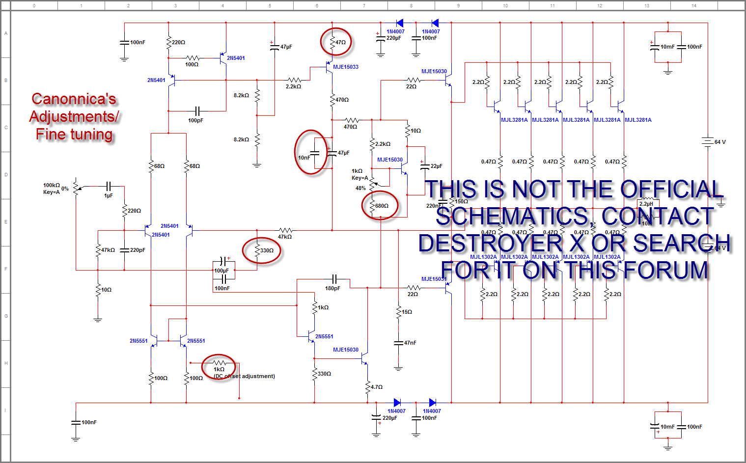

Amp boards are now satisfying
In the seek for perfection, I've done some adjustments and fine tuning on some components. These are directly or indirectly suggested by Carlos-The-Great
At the bottom is a picture showing 5 mods i've done for it to suit exactly my needs and desire of perfection.
These are:
1st: The 22 ohms CCS resistor have been replaced by a 47 ohms. This has reduced the CCS and VAS heat sink temperatures by about 12 to 15 degres Celcius. Now with boards on the bench, not enclosed, they're stable at exactly at: CCS = 42C, VAS 40,5C. (Ambient temperature is 22C and RH is 40%) I cannot hear ANY difference. I can only recommend this, it's an easy fix for a potentially serious problem. I can't wait to put everything in the chassis to check the temperature rise of these and imagine what it would've been with the initial resistor.
2nd: The replacement of the CCS resistor had shifted the bias considerably. The 1.2K resistor initially planned renders the bias adjustment impossible, correct biasing cannot be obtained. The resistor of the resistor-trimpot network has been replaced with a 680 ohms unit. Now biasing can be achieved. On the positive side I got 0,9mV and on the negative side I got 1,0mV on both cards (my multimeter's resolution is of 100uV)
3rd: The 10nF capacitor in parallel with the 47uF. In his monologue, at 14:30 Carlos mentions about this. I simply did it.
4th: I replaced the 390 ohms resistor with a 330 ohms, this is to increase slightly the sensitivity of the amplifier by approx 18%. It's a personal decision it's only some fine-tuning to best match with my preamp.
5th: Resistor in palallel with the RIGHT current sink resistor down the differential pair is there to decrease offset, or more precisely to increase negative offset. Both my boards had +46mV and +49mV offset, now with a 1K in parallel with the 100 ohms, I have 0mV for one board, and +2mV for the other.
That's it for the boards. Now still gotta wait for the softstart and loudspeaker protection to arrive from Connex (takes very long ), then I will be able to assemble everything in the enclosure.
Well thought out and implemented modifications.
Can I suggest one more pair of mods.
Increase 100uF NFB cap to either 330uF or 470uF
Reduce 1uF input cap to 330mF, or 470nF, or 680nF, or keep 1uF. Choose to suit your taste in bass in the room with your speakers.
Let's see if DX bans them from his thread as he does to most other modifications that don't originate from himself.

AndrewT - I'm assuming the 330mF above should be 330nF. Right?

Hello Andrew,
Why increase the NFB caps ..? what effect will this have ...... ?
