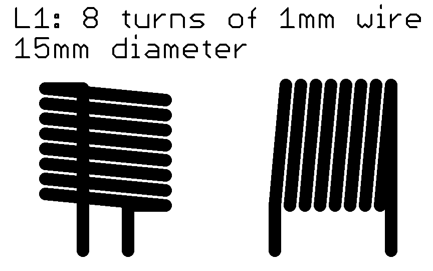

Mouser BOM
I put the BOM for one Blame ST channel in Mouser. I tried to follow Carlos' (and Metal's) instructions as closely as possible, and chose components that are available in single units. I also tried to pick high reliability components (especially electrolytics). The BOM does not include the fuse holder, connectors, heatsink, etc.
The most difficult part to find was the 0r22 5W resistor, and I'm not quite sure I've picket the right one (non-inductive).
I would appreciate any comments on my part selection. Please feel free to use the list as you wish.
Nikolay

Good morning Nicolay,
thank you very much for creating the public order.
Let me give you some remarks on it.
You need 4 "big" (5W) resistors for one PCB: R26 - R29.
These 4 resistors have a spacing of 22 mm (hole-to-hole) on the PCB.
Please check this regarding your order.
I like very much: Vishay RWM0622R220JA15E1 or a MPC71 type of resistor in this place.
There are 2 100 Ohm resistors soldered on the copperside of the PCB, across the fuses which are used for adjustment only.
You can take any type there.
All other resistors are 0.25 Watt; you can even use these for R3 (on the input) because metall-resistors are normally rated at 0.6 Watt.
Take one supplier for optical reasons, please.
C23 is a 100V 47nF cap - the Zobel cap. You remembered - very good.
Please use MICA caps for capacitors with a value less than 1nF.
For example:
Use Cornell Dubilier 598-CD15FD101FO3F instead of the TDK cap.
C1 will be a problem.
The best way is not to use C1 at all.
But only if you are 100% sure that no DC voltage will be applied to the input!
What type of source will you use? Does it decouple DC on the output?
If you are not sure (I am not sure either): use a MKT- (or even MKP) - cap as C1. Do not use WIMA MKS.
Mouser offers EPCOS B32562J1106K? 10 µF MKT, PCM 15 mm: perfect.
The EPCOS will give you a beautiful sound.
Best regards - Rudi_Ratlos
P.S. Nikolay: do not forget and order the mechanical components as well: heatsink, washer, 6.3mm spades, AKL PCB connectors, ...

Rudi,
Thank you very much for the pointers. This is my first project and quite honestly, I didn't know where to start with the tens and tens of parts available. Your input is much appreciated.
I tried picking all Vishay resistors, but some of the values are offered in large quantities only. Perhaps I can replace all metal film resistors with KOA Speer. Does the tolerance matter too much? I picked R's with <=1% tolerance. If I use 5%, I can probably do all Vishay R's.
Same goes for the caps - some come in large quantities only. Is there a reason to avoid WIMA in general, or is it application specific.
I'll use a PC source in the beginning, but the ultimate goal is to have a DAC feeding the DX. I can't be 100% that no DC voltage is applied to the input, so I'd rather use C1.
I'll do some more digging through Mouser later today and incorporate all your remarks in the BOM. Again, thank you Rudi.
Best regards,
Nikolay
ps. I intentionally left the mechanical components out. I'll probably source them from a local hardware store.
