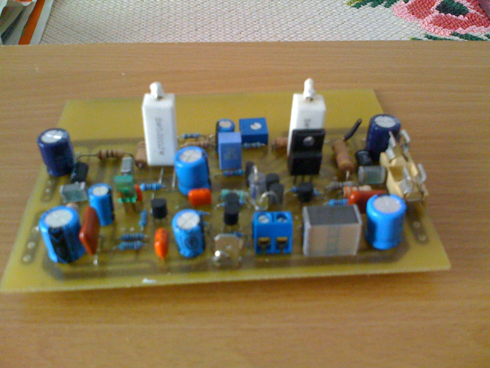

Hi Carlos and all members.this is my blame ST. i didnt have all the parts so i made small changes with everything i had spare. the amp is very good and i am going to etch 2 boards with the suggested component values.
Thanks Carlos,really nice amp.
By the way,how is the SMPS going? it will be usefull because it needs less space and a complete compact amp with enough power can be made this way.

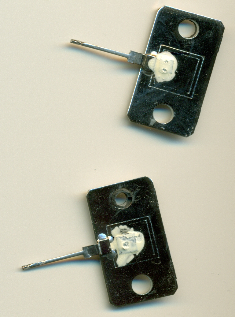

These Sankens are fake, for sure they are..the silicon block
use to be bigger, much bigger and there is another plate of metal...these ones are Sankens, but old units, very low powered units made for switching applications, 50 watts units...they substitute the indications...they erase original indications, component numbers, and paint another number on them.
