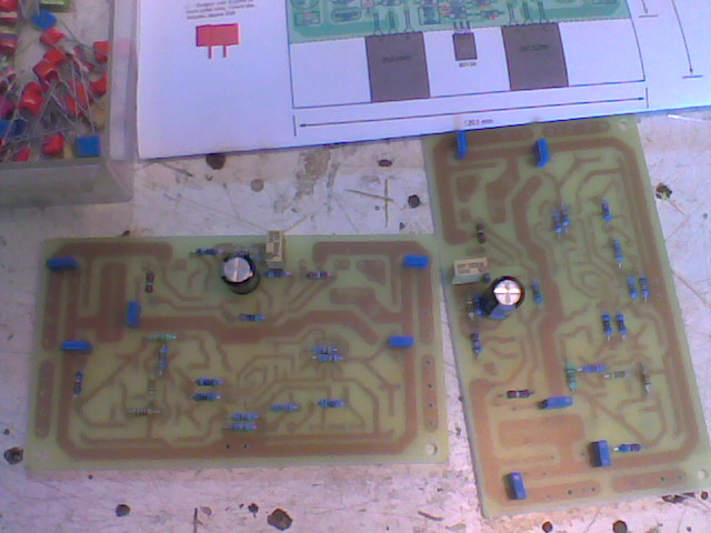

here we go ..
PCB has arrived in my shop couple of weeks ago ... but as i said we are so busy that there is no time for nothing ..
this weekend i got my shelf some free time and seems that i will manage to produce the amps ...
no tweaks here ....just the standard pcb everything as said on the BOM ... standard parts ...
The idea here is to capture what the mastermind .... had in mind ....
hopefully there is going to be complete pictures by monday ....scope signatures also

I hope you like it Sakis
This is very important to me....your evaluation is precious.
Watch the image as reference dear Sakis..you are busy and may assemble in a rush..i use to change the drivers position.....i made that several times..to install the NPN in the PNP place.... also there's a pair of transistors, the small ones, that one is looking at the other..face by face.... as as the board has not silk screen to reference the position to introduce the transistors... i use to make mistakes there too.

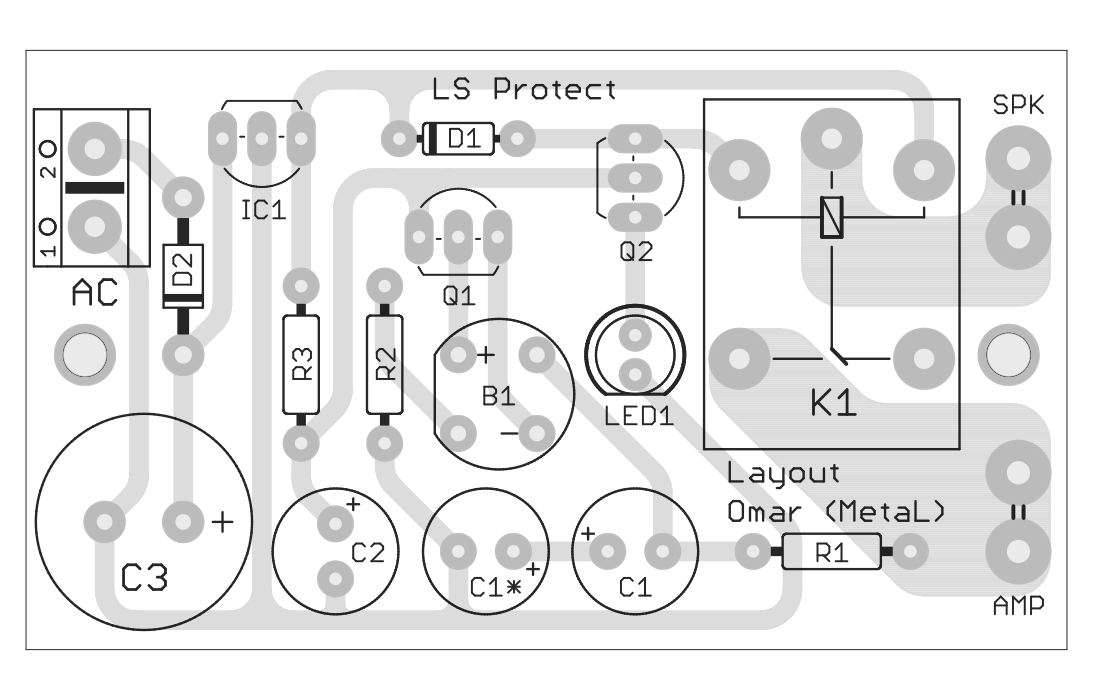

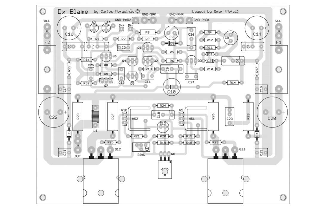

The German Group Order is placed, Finally!!
Dear All,
Rudi placed the order for Dx Blame (German Group) and LS Protect PCBs.
The order was of very high quality PCBs, Rudi has opted the best options so that people who were on the list are very lucky indeed, including I and Rudi. The PCBs we will get will be best quality. The thing I liked so much was the Gold Plated PADs, excellent Copper Weight and 2mm PCB Thickness, they are excellent PCBs. Rudi took extra care while placing the order.
LS Protect and Dx Blame PCBs were made as small as possible. I took care while designing Dx Blame PCB to enable older folks to be able to solder without mistakes. Too much close components will cause a problem to those who are going to solder. I think this was the best compromise between components spacing, PCB final size and tracks thickness.
Attached is what we have ordered. Dx Blame and LS Protect PCBs.

No!....negative dear Sakis..not needed!
Try to match, only NPN with NPN and PNP with PNP.
You can use 160 in the PNP and 350 in the NPN..... Dx Blame, as you know, is not complementary, the small transistors does not work in a complementary way..the current sinks are alike diodes.... the gain is not really used or important.
Go ahead my dear..and enjou the excelent performance of this amplifier that will match the ones you use to fix and will be a lot of them.
