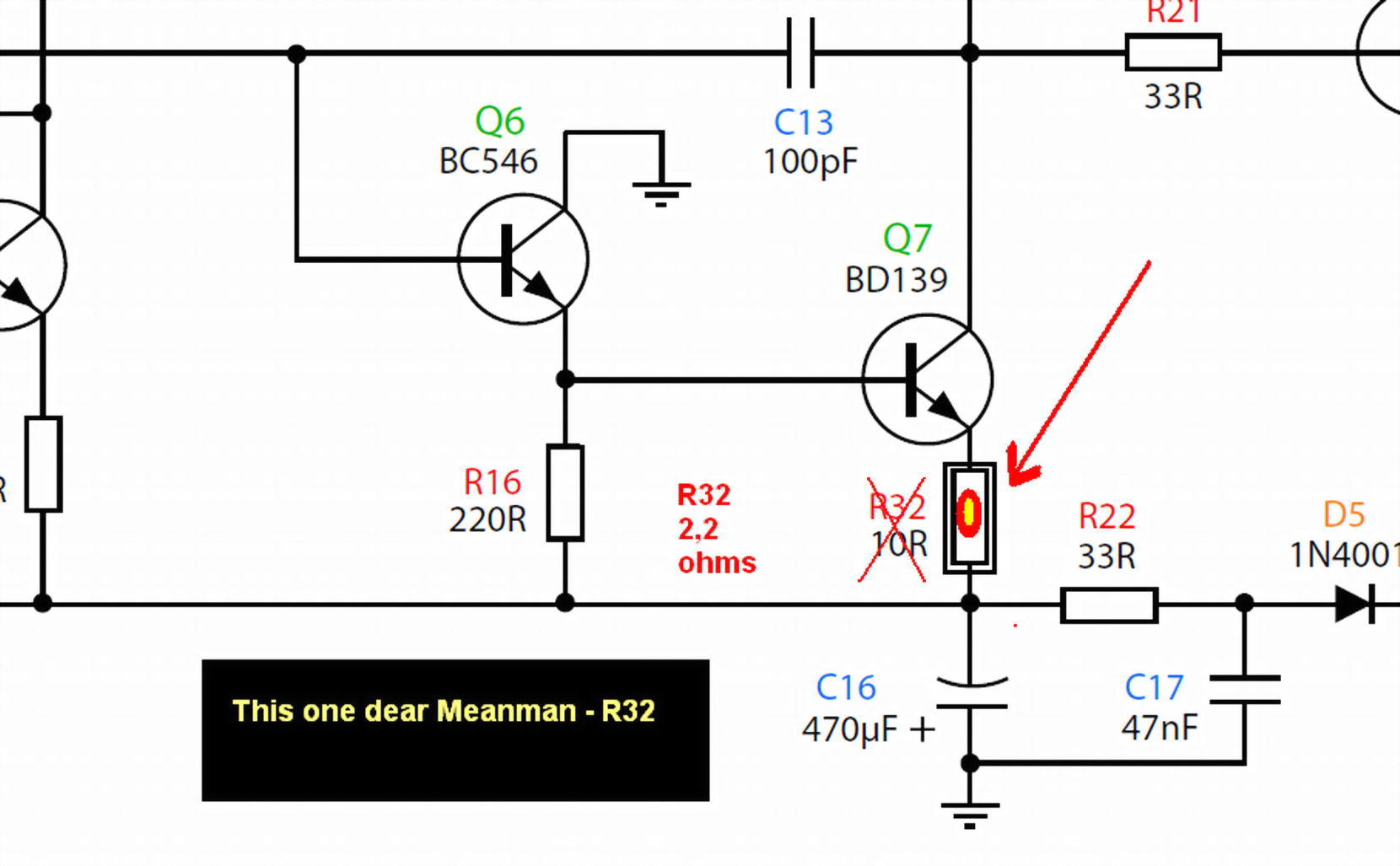

Remotion of a 18pf capacitor from the NFB line...it was in parallel with 12K, the one is connected to the second differential transistor
Remotion of 470pf capacitor that was connected from the second VAS transistor to ground
Inclusion of a 10 ohms (now reduced to 2.2 ohms) in the second vas emitter
Increase in the value of the first VAS emitter resistance... in the early schematic (ES) it was 100 ohms....now increase to 220 ohms
The compensation capacitor in the VAS was increased from 82pf to 100pf
Rail resistances, was reduced from 220/150 ohms to 39 ohms to both rails

Planning to start the building of the Blame ST with the boards of Rudi and Metal.Do I have to follow the Bom at Gregs website
(Inclusion of a 10 ohms (now reduced to 2.2 ohms) in the second vas emitter)Carlos wich one do you mean?(Rail resistances, was reduced from 220/150 ohms to 39 ohms to both rails) and this one?
What about the rail capacitors C20-22(470µF) can I use 1000µF there or is that to high?The reason is they fit better on the board.
No problems about the condenser dear Meanman
You can use the capacitance you want there.... 470uf is enougth, and more than that will be waste of money...but will not create problems tilll you advance to values bigger than 40.000uf (or something big alike that)...there are books and big Gurús that say this is not good...i am not sure about that..i just avoid them to big too much big as i respect these big brains that have much more experience than i have....book writers usually have all that experience..or they will not expose themselves to criticisms registering ideas on the papper.
I am glad you will advance in your construction... i am sure you will never regret to take this decision.
The resistance you have asked i am showing in the schematic.... i found this one the best value...but the amplifier works very well using resistances from 22 to zero in that position.... tuned listening, i have perceived this value as optimum.... so...if you have problems to find small 2.2 ohms..you can use other value that for sure will not destroy your amplifier.
Greg pages of course have the most needed informations to builders.... if you have not visited..it is time to go there.
