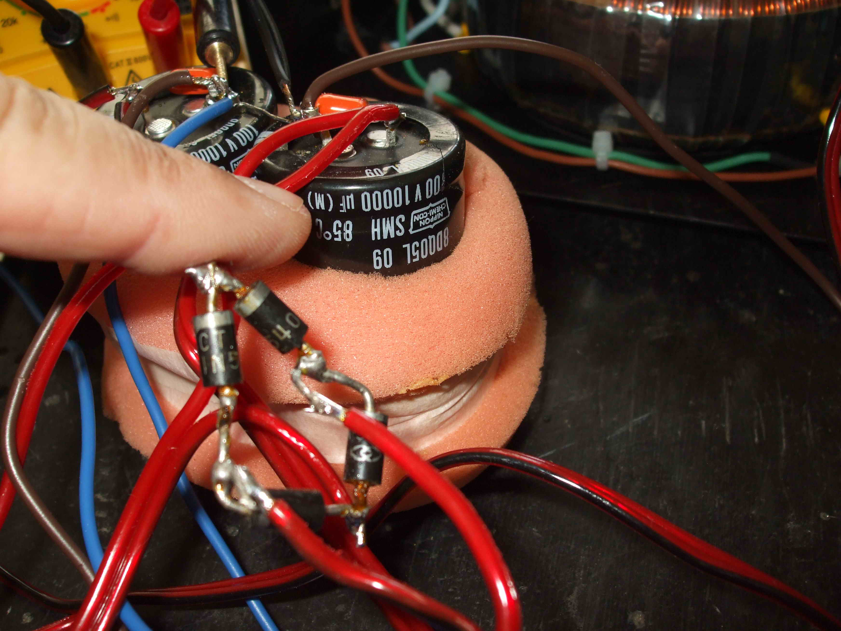

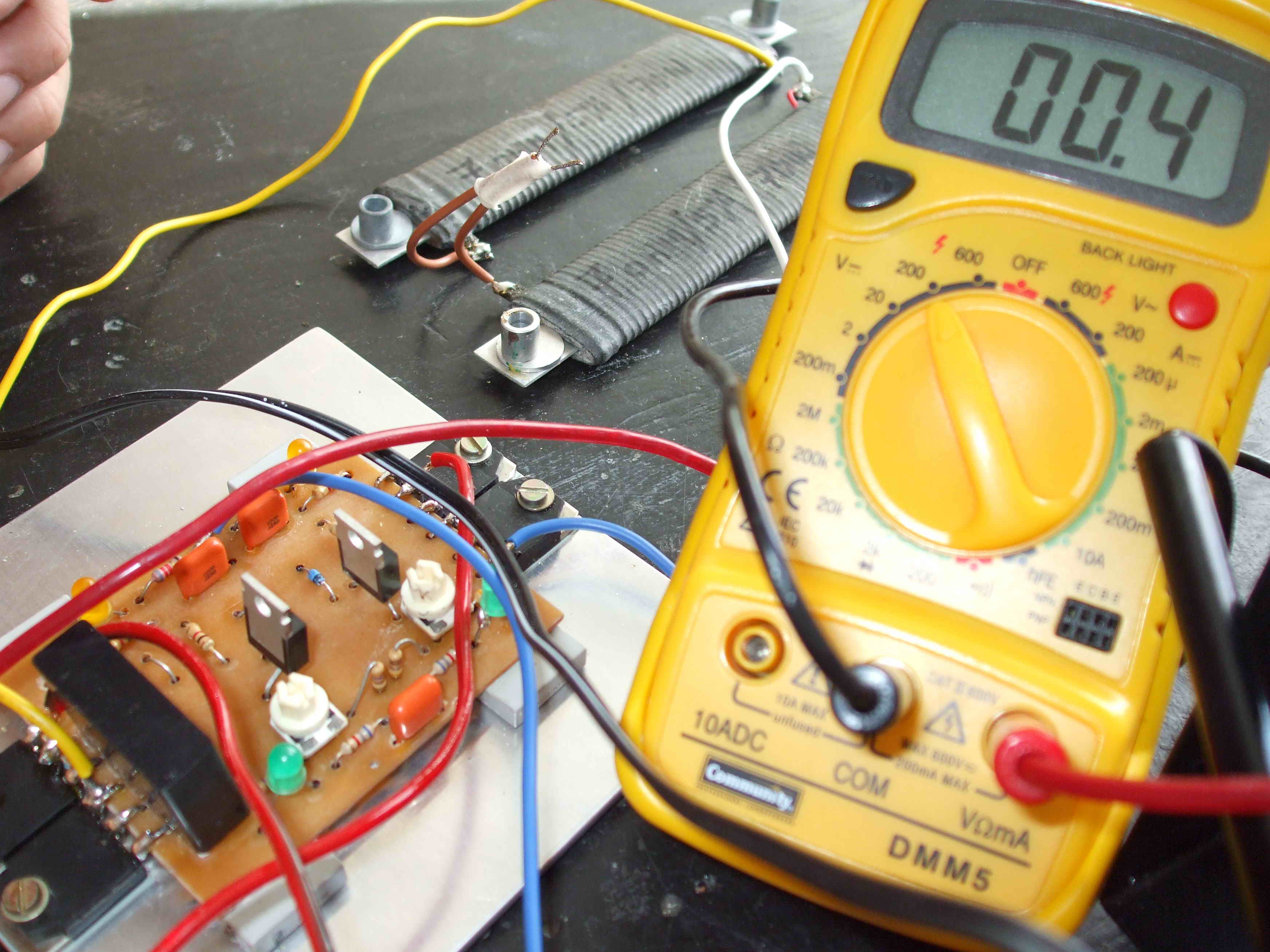

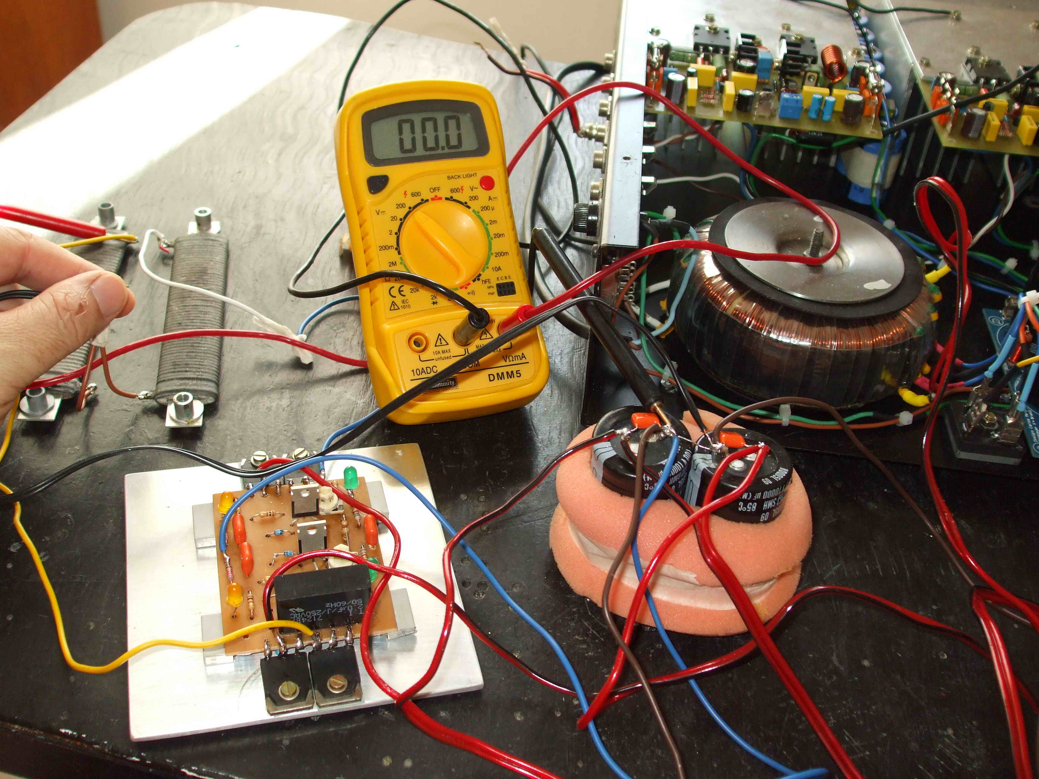

Thank you Wahab and Quator.... well boys... i continue working
rigth now i am uploading a video to youtube showing you the supply performance.
I am using a simple bridge rectifier, 10 thousand plus 10 thousand microfarads filter (only) and a 48 plus 48 volts DC from the toroidal transformer.
This 48 plus 48 volts are entering the symetrical Dx Voltage Regulator (really it is Ampex voltage regulator, made for Professional Video Tape machines, open reel ones).... the voltage regulator had the output adjusted to 36.2 volts (more or less this)... two 7 ohms / 70 watts resistances were place to load both rails same time...and this was 5 amperes each rail, because voltage dropped down to 35 plus 35 volts.
The power drained was 175 watts each rail...total of 350 watts, the voltage drop was around 1.2 volts, and this is less than 5 percent...and observe the input voltage, how much dropped.... good transformer this one.
Regulator heatsink got hot (around 50 degrees celsius), but this is continuous drain..audio use to be average..so, this will work fine.
Output resistances, of course, started to overheat,as they are undersized to this work.
This current, corresponds to two Dx Blame ST amplifiers, working full power, over 4 ohms loads, continuous sinusoidal signal, undistorted and unclipped....producing 100 watts rms each channel.
I am suggesting this supply, IF you have a bad transformer, and IF you need to reduce voltage in order to match your power amplifeir needs..the supply output is adjustable and stabilized in 5 percent...also you can use capacitance multiplier adding an electrolitic condenser in the position suggested some posts before this one....i have suggested to use 25000uf each rail as filters in the rectifier side...and more 10 to 15000 thousand each rail at the regulator output, to provide electrons reserve to be send to the amplifier when needed...if the regulator is not so fast..electrons going out from the electrolitic are fast.
images attached, and soon i will post the youtube video link.

I will take a look on that when building the "crowbar" circuit.
It is working in the simulator.
I misunderstood the purpose of the circuit, sorry. However it's not good crowbar as the transistors will fail before the fuses do, due to SOA limitation - the circuit shown (in your latest schematic) like a shunt regulator limiting voltage, so a lot of current will flow while there is a high voltage over the transistor. Based on the datasheet, it clearly violates the second breakdown of the power transistor, and it will fail short. Why not use SCR's and a zener, the classic crowbar?
Good Ilimzn.... post the crowbar circuit you suggest
Then i will suggest people to use your crowbar....please, post one tested..something guaranteed.
Really, when we produce shorts in the output, the current is enormous and may kill transistors...SCR is a better idea.

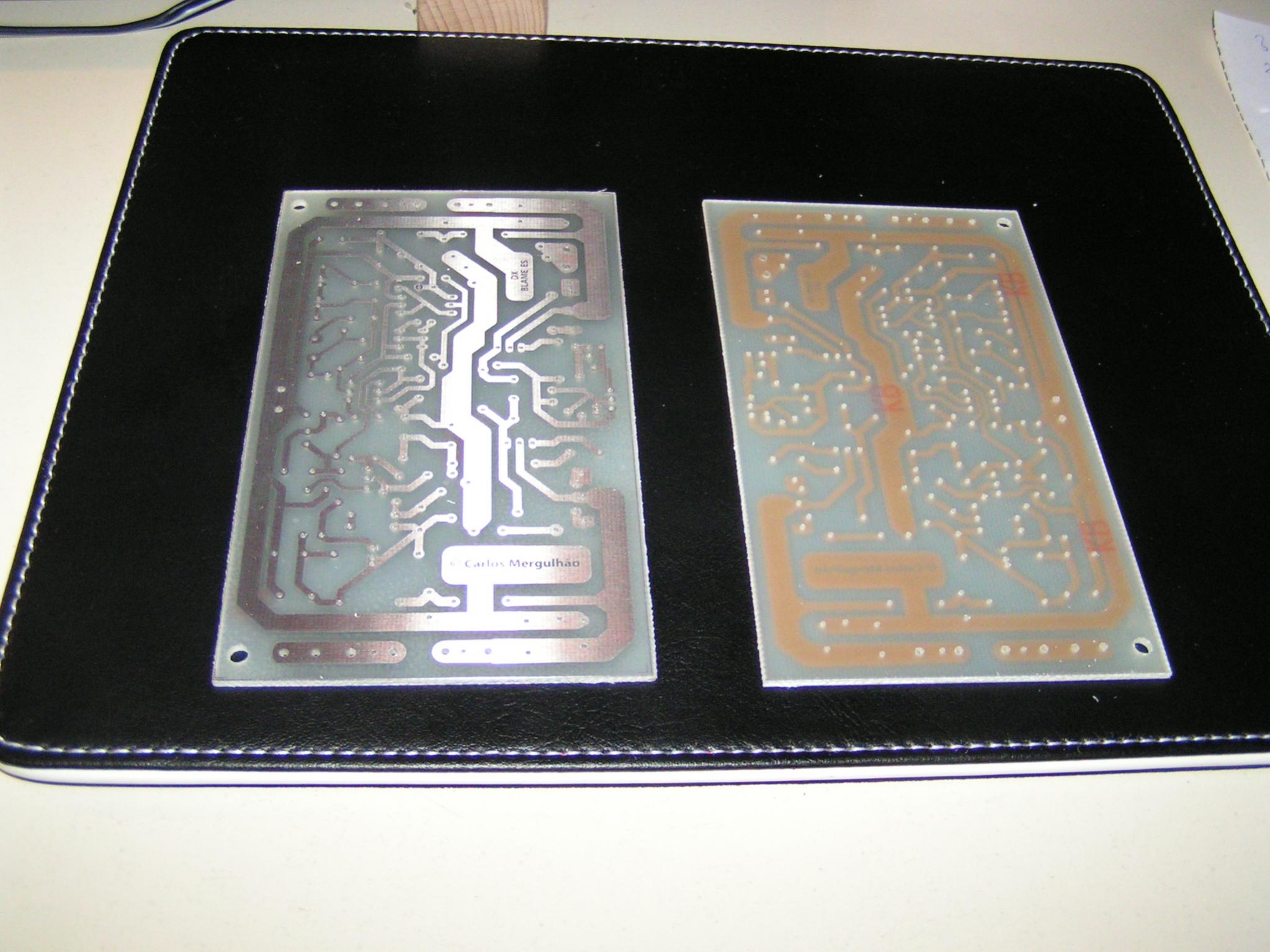

Some news from Germany...
Rudi´s PCB-layout now is playing stable like the Rocky Mountains, the rollercoster is gone away 🙂
I dónt know why, nothing was changed, this amp is playing daily, and become better and better ???!
Must be something about the condensors or soldering....i have tested 9,6V bias...you will not hear this, not good, but stable 🙂) Now i have 7,6V and want to go to 6,9, this may be good for sanken 2SA1216/2SC2922, or something between this...
and what is about shy bass?? sorry, this amp is playing this at the point, without any problems ;-)
I have new PCBs, i will build them as blame st, but this may take some time.
