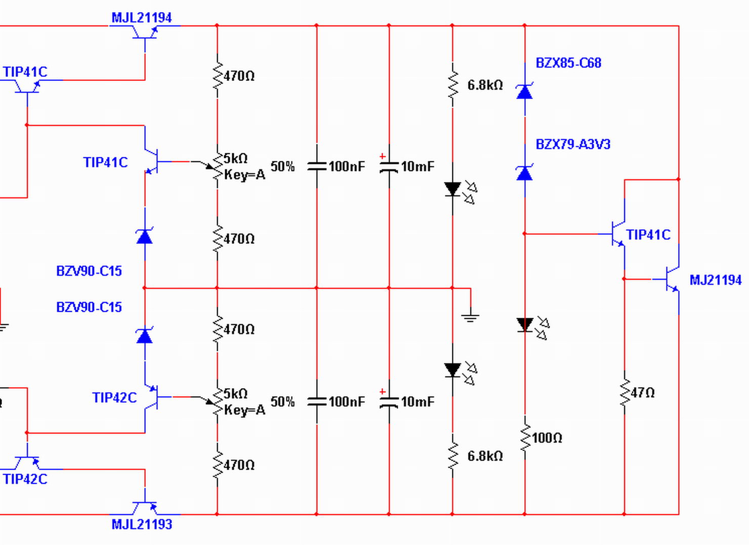

I will take a look on that when building the "crowbar" circuit.
It is working in the simulator.
The way it is all current crosses the first darlington base to emitter, goes directly, without losses, without share current, into the MJL21194 power transistor base to emitter junction... the absent resistance would steal some precious current...i am reducing the maximum i can to reduce zener current.
I want to reduce the zener current to avoid to use a big 5 watt zener..so...all current i can save will be good.... you know, not wasting some current to cross this first transistor emitter resistance.
The two diodes, the two transistors base to emitter junctions, will develop the needed potential i need to drive them on.... and i need to saturate them, at same time trying not to provide too much current to the first darlington base.
I hope you understood what i mean.
regards,
Carlos
This gonna be adjusted while building and testing
Zener is 200mW unit..this is reasonable....i have installed the emitter resistance and a red Led that will show when crowbar will be on, means fuses are already opened...maybe i will install resistances in parallel with the fuses...and leds...so..when fuses are burned, opened circuit, then leds will ligth "on".
