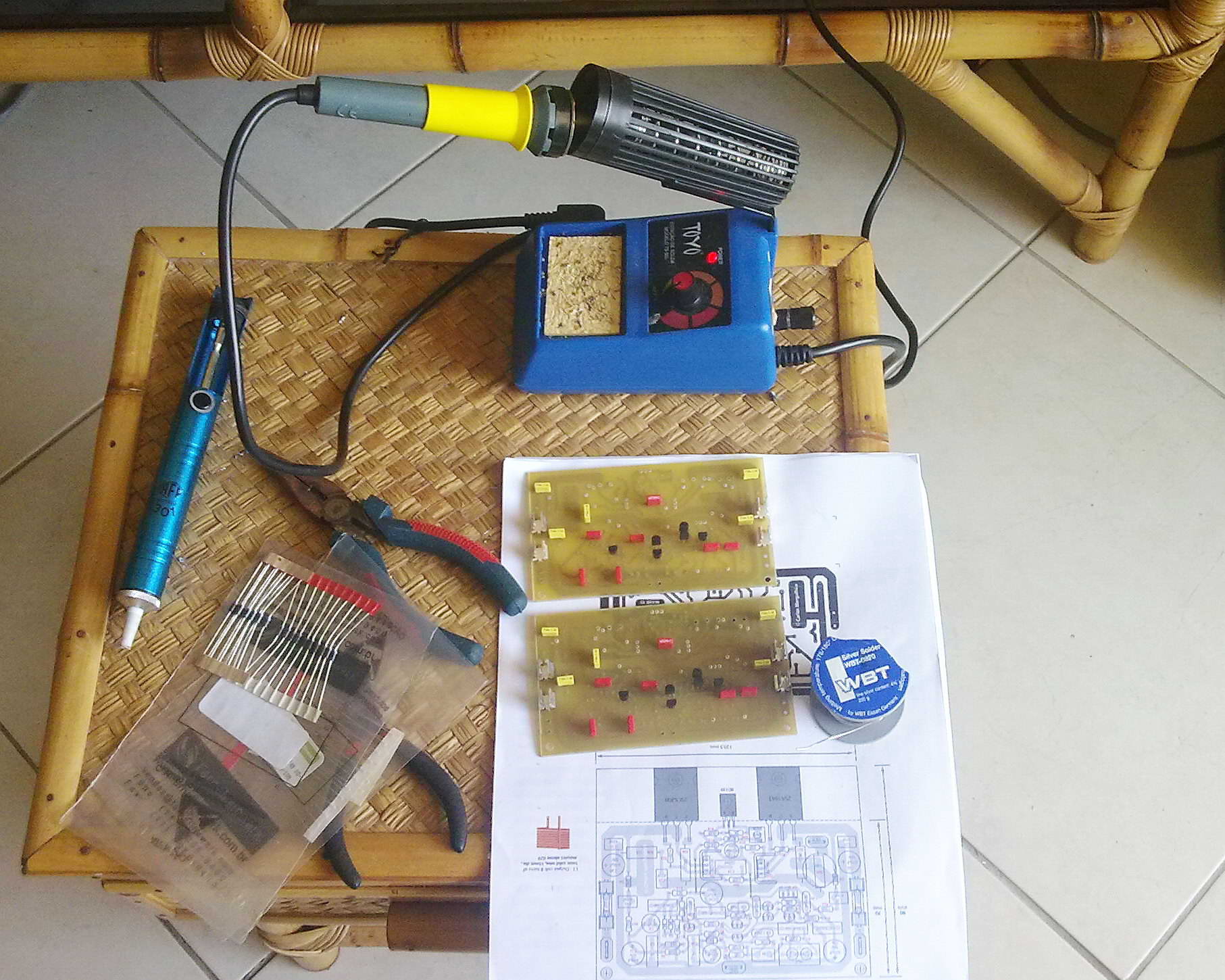

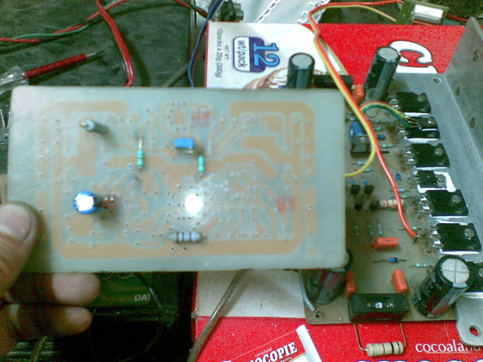

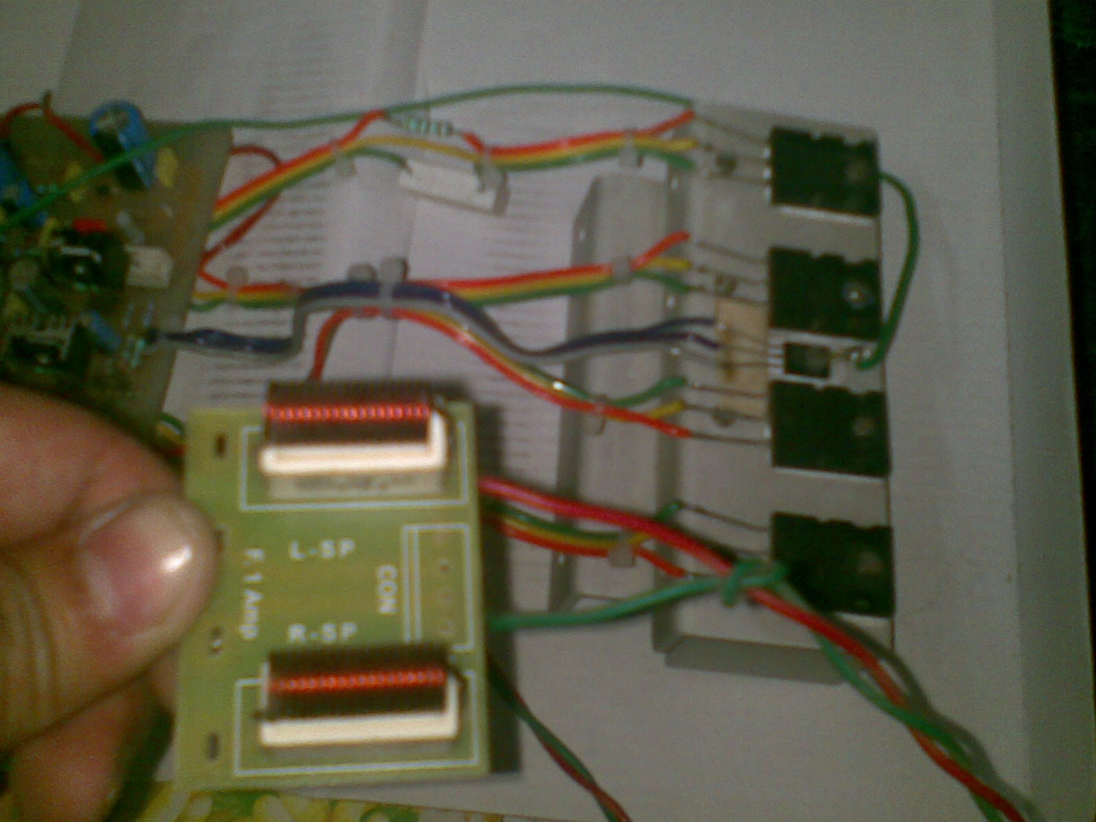

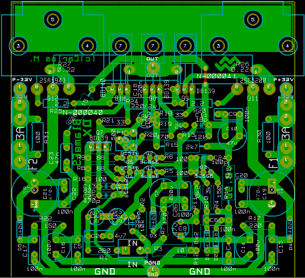

Good news Takku..... sounds lovely.... i cannot stand for the Dx Amplifier anymore.
The standard...i feel it unprecise in the bass, despite strong, not precise, also needs more treble.
You told speaker output.... is this from your computer?...... take the output at line out jack, less than 1 volt there and impedance is higher than speaker output jack.
Maybe they are the same in your computer....i had some mother boards written speakers and was not low impedance (8 ohms) high level output (5 to 6 volts out).
Nice board colour... interesting....brazilian ones are green, and ours detach copper lines if you apply too much heat..... not good ones..... we have several brands, some of them are no good.
And you are using wires to the output transistor...this use to unstabilize amplifiers...i see that Dx Blame ST passed the test...if survived without oscilations using wires to power transistors, then the unit is really super stable..the way i wanted.
I see you have used the correct turns to the output coil....looks nice and are separated from the main board...good!
Well, there is a picture using long wires to the output transistors...i suppose you have fixed that, because another board has not wires anymore.
Interesting, the amplifier started the way it is now a days...and oscilated!.... maybe other problems i think...i have found my VBE multiplier transistor having intermitent base contact (internal defect).... maybe this and another constrution error made the mess first time.... i had to introduce the now a days removed capacitors to make it stable... and today without the same capacitors it is stable.
This use not to be mistery, this means "errors".... i have made other errors i think.

Thank you Carlos, i live in Maceió, and i pretend to finish my DX BLAME
soon. I will send more pictures at the end.

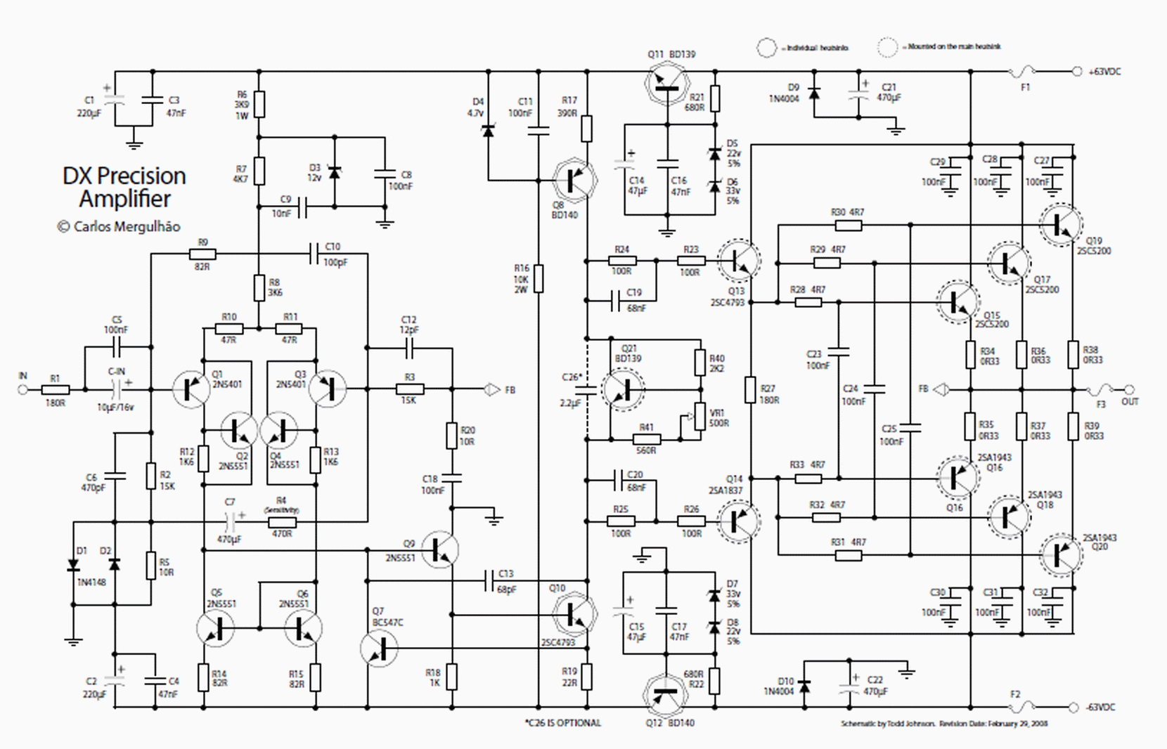

Im not sure, but from your evaluation of how your amps sound, Dx standard might still be the one I would give a closer look
Maybe we only need to "destabilise" it a bit 🙄 may not even be a joke 😀
Might be interesting to look at what causes what you descibe as less precise bass, or a change in perceived level of higher frequency
Amps are linear, so we know it must something different
Yes....yesterday i was listening and comparing... the standard
sounds very nice.... flat power from 1 hertz to 60 kilohertz.... sinusoidal wave does not turns a triangle even in frequencies higher than 100 Megahertz.
But the square wave is not very good.... the rise time is not fine... 10 times slower than the Dx Blame ES...and i could see this can sound different, at least in these amplifiers.
I have found perfect square waves in other amplifiers, and sound was not fine... say... perfect specifications and perfect square waves is not a guarantee of nice sound reproduction...but for sure shows the amplifier is good and may sound good too.
Doing comparison you see how things are different..both are flat, but the Dx Amplifier has huge bass, an earthquake, thunderstorm...bass is longer than normal, not perfect, not controlled but very nice.
The Dx Blame ES has a very controled bass, present but shy when compared to the Dx Amplifier...more precise, more natural, more perfect, also nice...but sounds alike we have decreased bass control to 9 hours (flat is 12)....also treble is much more precise, detailed, focused..dinamics is superior too.
I cannot be listening the Dx Amplifier anymore...i could stand for that before i have listened this one( the Blame)....also i could be listening the Dx Standard even after have assembled and listend several thousand amplifiers..but now a days i cannot stand anymore... a friend sent me a Dx Amplifier board, and i have to assemble, because was a gift, and i am searching energy and motivation to do that...in the reality, it does not interests me anymore....but a gift, i cannot trow away, i cannot give it for others and i cannot sell... and the worse, i cannot let it the way it is..dismounted inside plastic bags...that friend not only made the board, made the whole kit of selected parts and included heatsinks and power transistors.
Dx amplifier is not something that may feel you ashamed when comparing with others, but really, the Blame brings sound to another level.
The ones have the Dx amplifier will be happy till the day they experience to listen this one..then they will not want to listen the standard anymore.

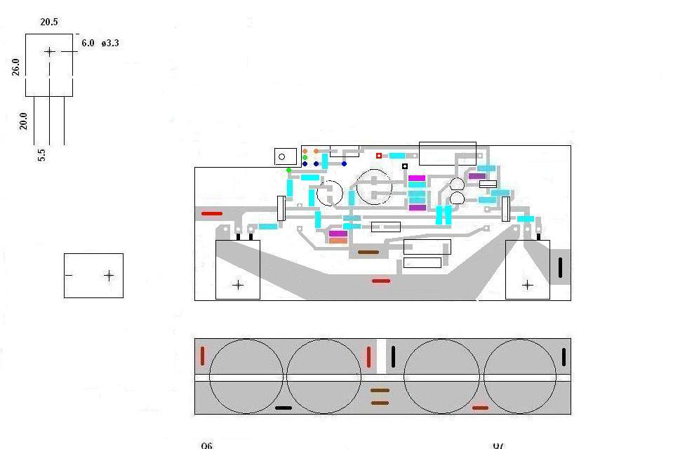

Ok, I wont send you any boards then 😉
But I still will, if you gain interest to see if its different
btw, I have changed back to original output devices(Toshiba😀)
No modifications, other than no onboard supply caps/decouling
I believe this is the desired "star ground", no ?

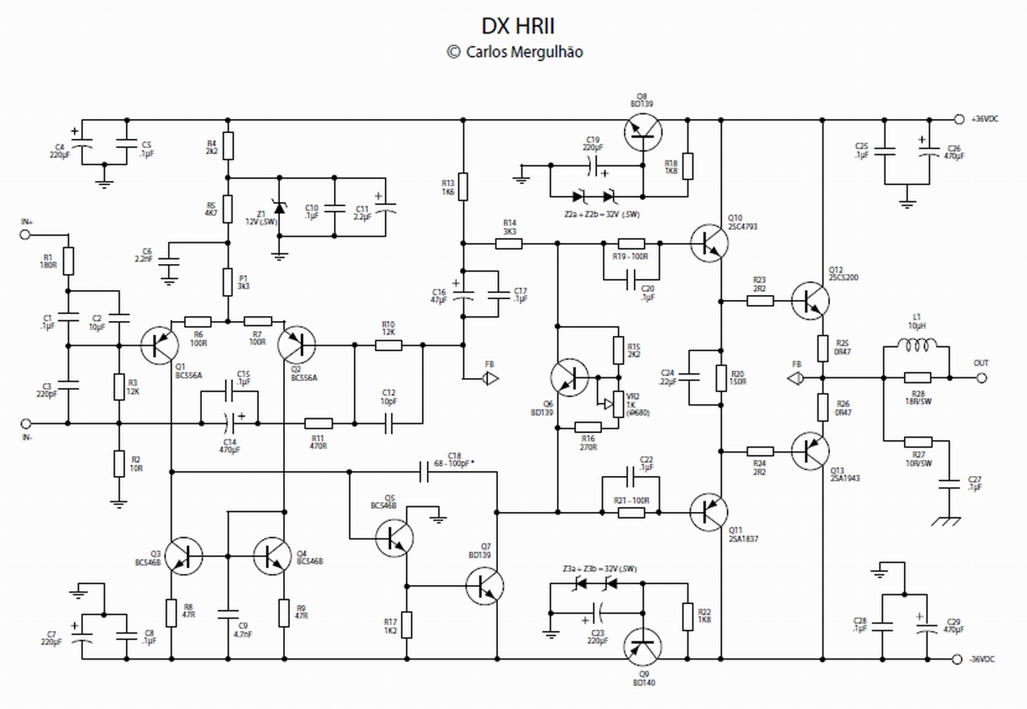

I am not sure...i use frame ground in my personal circuits
It seems star has a central point and several "arms"...alike a star.
I do not like to talk about theories, not only i have not good knowledge, but also i think it is not good for DIY... as we have too much people that just talk and do nothing, they pervert the forum direction in my point of view...as DIY, i suppose, means to build things, to design things, to test things....not only to talk about theories about these things.
We have too much lazy folks, doing nothing and just giving opinions, even when their opinions were not asked.... and i do not respect them, they do not evaluate using ears, listening..so..in my point of view, they have nothing to add to my life...just possibilities.... you see, their amplifiers are terrible!..so...i cannot listen them..exception is Hugh Dean products...Aspen Amplifiers products...Aksa amplifiers.

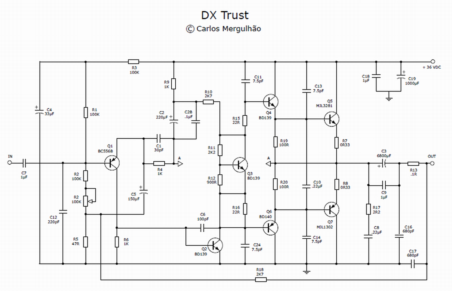

But will talk a little bit about differences between these amplifiers.... the obvious differences..
The Differencial is using CCS, this is one difference, my other amplifiers does not use CCS...also i have build, as you may know...was published..two Dx amplifiers, one using CCS and other using the zener voltage regulator...SAME SOUND, SAME MEASUREMENTS.
The differential, using current sink, was used in the Precision 1 and was used in the HRII....but they do not sound alike the Dx Blame ES.
Maybe the difference is the huge current ... 4 times bigger current in the differential and input impedance is 3 times smaller when compared to some other amplifier...but impedance is almost the same i have used in the Precision 1 and HRII...and these ones have not sounded so good as the Dx Blame ES or ST (the stable one).
I am using double VAS...two transistors, Doctor Self book style...copied!.... and i have used this same one in the HRII and also in the Precision 1.... precision 1 was wrong use..had a VI limiter to kill dinamics...used in the VAS... because pressure the theorists made with me, with their theorical terrorism, saying the amplifier will explode..when they cannot influence our decisions...then, they try to destroy your amplifier credibility.... but was not because this VAS.... HRII and Precision 1, even using this same VAS style, have not sounded so good as the Blame.
But i have made a needed modifications in this VAS..the blame has 100 ohms as first transistor colector load... was needed to share VBEs almost equal between these two VAS transistors, so, even the smaller one has a huge current (within limits, as it is able to manage 200mA, and it is working with 5 or 6 or something around that)... the original design keeps the first transistor with a very small colector current.... very low VBE ....not good...this modification changed sonics and A LOT!
Well.... the output is the same output used in Dx Standard, HRII, Precision 1, DHR Turbo..... the same EF...same current to drivers... even transistors are the same to 35 volts version.
So...if you want to know what makes the difference...the "synergy" of these things.... because they are all bootstrapped (exception is the Precision 1), an all them use the same kind of circuit... the standard, the generic amplifier from the seventies.... and beginning of eigthies.
If you want me to say exactly the component made the difference..i really do not know.... i really think there's no magic component there or magic solution is one stage..but something good happens globaly there...all those things, together, made the difference.
I have listened several amplifier with the same circuit..CCS to differential, current sinks...the same output and some interesting VAS too..but they do have a chance to compete...they sound awfull, terrible, when compared to the Dx Blame ES/ST..... even beeing almost the same.
Now theorical folks will come to explain.... i cannot stand for them, so i will not answer them..you read them and have fun..i do not have fun with them....how can they intend to explain when their own products, made using all clever theories.... their amplifiers... sound so bad..how they can come to teach us?.. and why to follow them when does not result good?... they do not know the secrets.... as secrets does not exists in this amplifier...if they knew these things they should have applied in their amplifiers, and they are still building leach style amplifiers!
Of course..if Hugh Dean land here, and say..change this..i will do immediatelly to check the sonic consequences of his suggestions....despite he is turning a theoricall guy too (seems to me)..exception is the emitter resistance of 0.47 ohms, or 0.33 ohms...i think this is too much for my taste..this test, substituting these emitter resistances, and even removing them... i have already made.

And for the boards you received, just drill a few holes to add
the missing tranny and resistor , and you ll get one more pair of blame es !!..
Yes Wahab, to transform a Dx amplifier into a Blame ST
we have only to install a CCS, a current sink, and another transistor to the CCS.
And ready to go.
You can see folks, all my amplifiers were evolution from the Dx amplifier, the standard one... a generic amplifier... a very good one!
You see that CCS the way Blame (Blameless) use, and other solutions where previously applied...listened, tested and hundreds have built..... these ones can understand my message clearly..the ones have assembled.
Dx Blame ST eat all these ones in the breakfast...easy, LOL, and rolling in the floor laughing.
The HRII, goes close in sonics...but only close.. have lost when compared.
Precision1 is good in the midrange and bass...huge power...but treble cannot be compared to.
DHR Turbo was not made to reproduce quality...was to produce power only.... sounded good, but this result was an accident..was not the priority.
Carlos

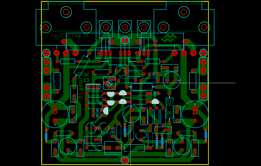

Optional pcb
My version pcb of DX Blame ES amp. I have builded... not yet measurement or deep tested how its stable or not... but its working until now, sounds very nice.
This my pcb on Kicad files... just for another optional pcb of DX Blame ES amp... everybody can free editing if you like.
- Dx Blame ES .... based into the Blameless, i am trying a new amplifier
