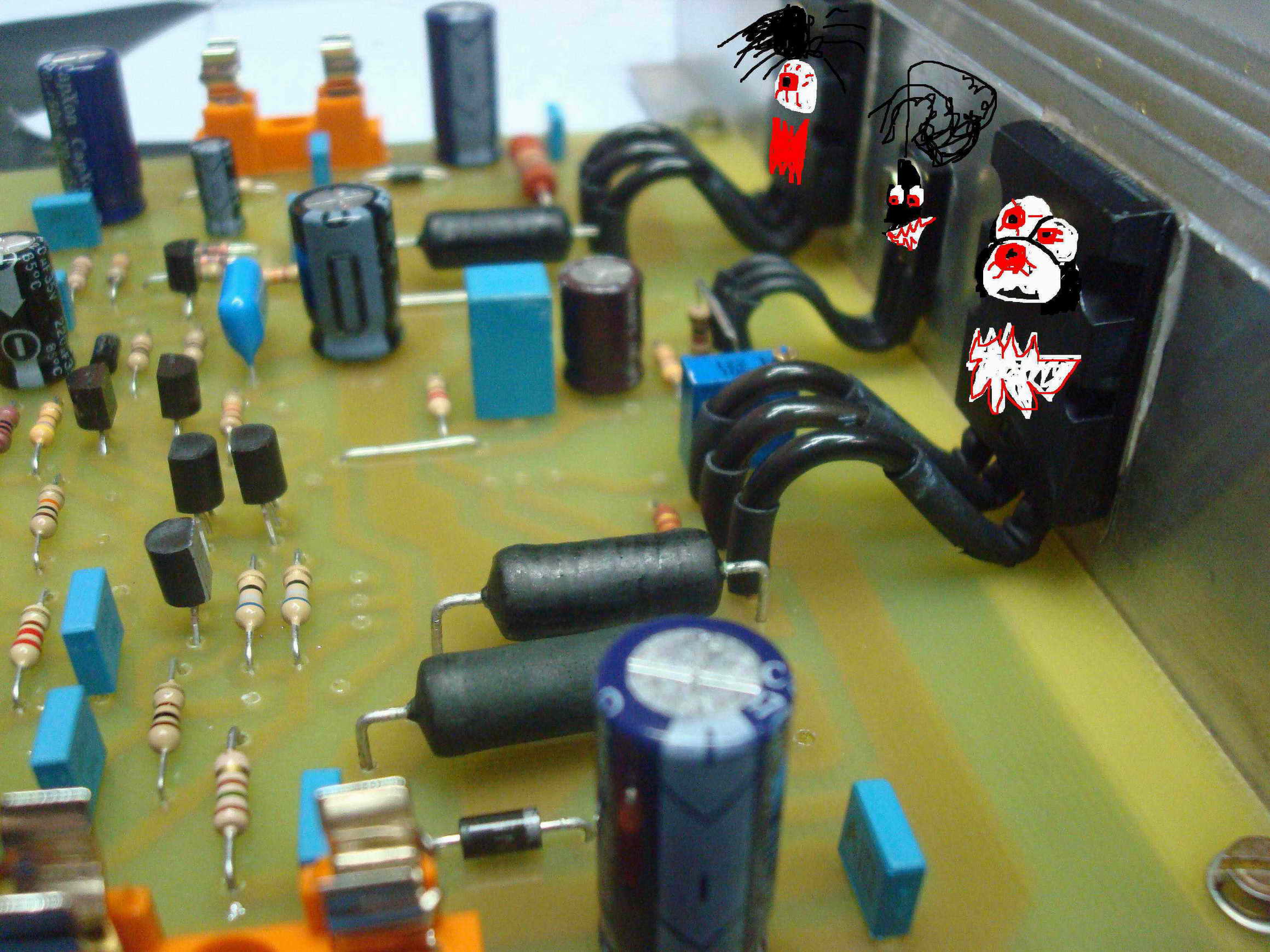

Dx Blame ES .... based into the Blameless, i am trying a new amplifier
Poison is for me, never mind my dear
She looks that is criticising the schematic diagram, latine root languages can be this way...electric layout not good can be understood and designer made ship....you know, the way the circuit was arranged, how was connected, the technicall decisions..not the board, not how it looks...layout for latine root people can be understood, also, as a draw, a sketch, the topologie....things alike this...not sure about her intentions, but looks criticism, a clever one, no one can judge, as can be several things.
hehehehe... she looks likes me, but i have not made what she want me to do..this is the main trouble.
I have not followed all her instructions... so, may not be too much happy with me.
Your work, your board, your layout is BEAUTIFULL, very professional and no one is crazy to criticise, as this will look super stupid to the one try to do that.
But a poor simple guy, that have learned burning fingers, well, this one can receive some shots.
No problem, i have a shield (big belly holds punches)
regards,
Carlos
Ha ha. Yeah, it's a breathtaking work of art. The Mona Lisa of PCB layouts. :crazy: I'll call it "Frameless".
Seriously, I want to know how to improve these type of layouts. Is anything too far away from anything else, too close to anything else, tracks too long, tracks too parallel, too narrow, too wide, more ground, less ground, etc.
..Todd

The problem, dear Taj, is we can turn ourselves obsessive doing that
and this finishes beeing a "never ending story"
I really think that some basic things must be used, and i suppose they are enougth.
Avoid too much long lines, copper lines
Avoid lines too much close one related the other when they run in parallel, as this produces a capacitor, the two lines are the two poles, the capacitor electrodes
We need thick copper lines where we have high current, a large one to the drivers and a even larger one to the power output colectors.
IF we have to decide to go surrounding the board to connect two parts, better use a jumper than to run long run of copper track.
Lines in parallel must be avoided, in special if too much close, 1 milimeter width track and 2 milimeters with free space in between..yes, this enlarges the board.
Copper lines in parallel are capacitors...long copper lines are inductor...when we have inductor and capacitors, we have tuned circuits, if this value is big, then the frequency is low and can reach 100 Megahertz.... transistors can oscilate, or operate, in this frequency, so, if we offer these ressonant parts, and the transistor can work, for sure they will work and oscilate... in a ressonant circuit, when you reduce the capacitance or the inductance, the frequency goes up, this means goes to 300 megahertz..... transistors (normal ones) cannot work in 300 megahertz, and because of this they do not oscilate..because they cannot..board will offer ressonance, but they will not oscilate..the cannot!
Ground place is nice, but seems a small capacitor in all connections (0,1pf), depending the connection, you must put the amplifier to oscilate in the place to stop it.
Lines crossing is much better than parallel, despite ugly they are better, so, jumpers we hate are the best solution.
Input must be very distant from output, to avoid coupling.
Some parts, as electrolitic condensers or other coiled capacitors, generates electro magnetic fiel surrounding them...if you install a condenser too much close to another, you may pick and this means trouble... and this was the reason why Japanese stopped to make things too much small, when small you reduce length, but increase coupling.... they were clever, they used transistors that could not operate in Very High Frequencies (VHF), this way they have avoided oscilations and they have increase board length...in the past (sixties) parts are so nearby one each other that seems was glued..and some really used some glue to make easier to invert the board to solder without having parts falling down.
These basic rules are enougth to be rid (free) of troubles.
Nothing is perfect, so the board you feel perfect today you will find errors tomorrow..i Michelangelo was obsessive this way, doing and doing again, and making it better..maybe no frame was ready his entire life..we must be carefull about that..time matters too...life goes fast to be wasting too much time with a single board, better to make several.
regards,
Carlos

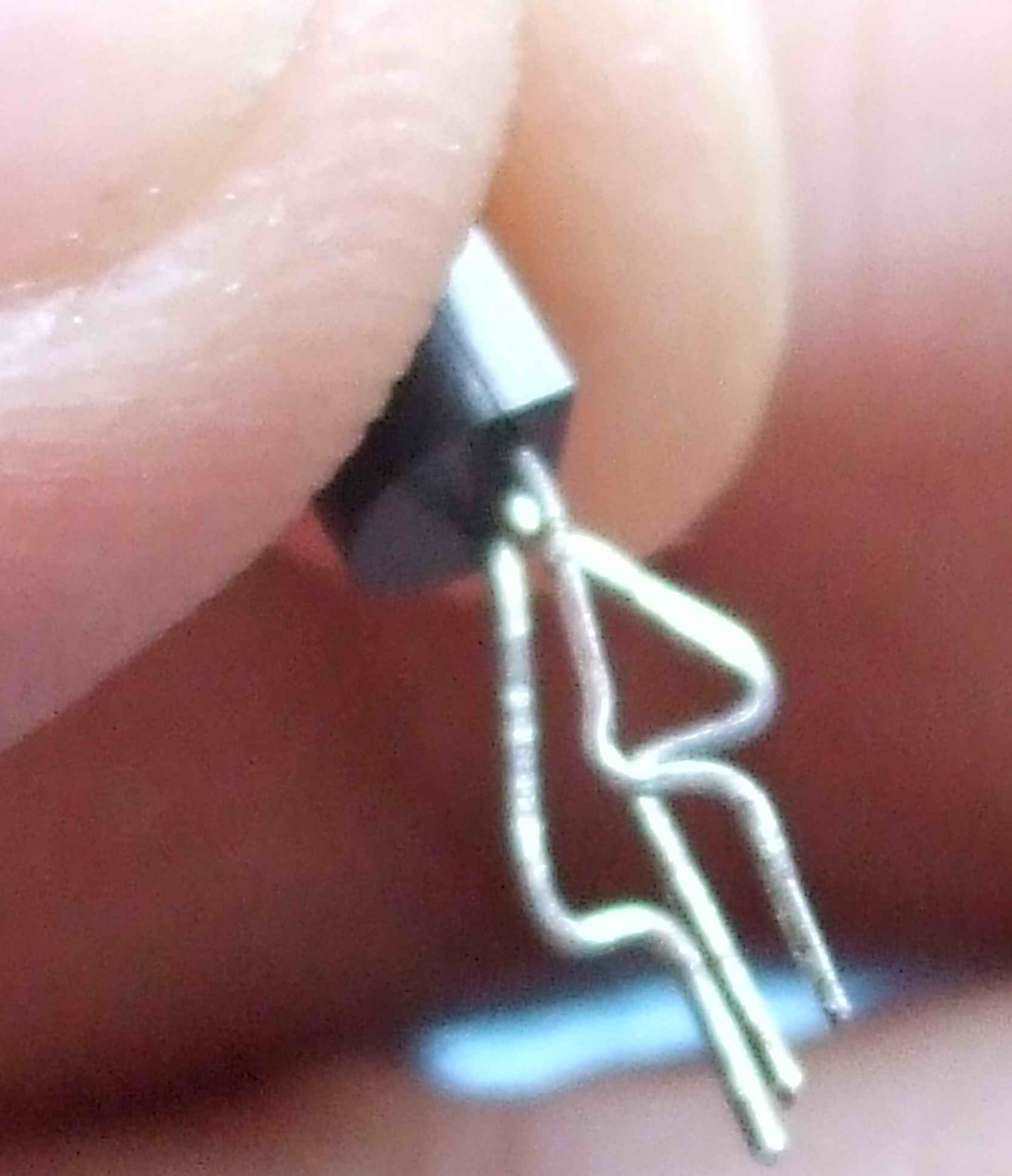

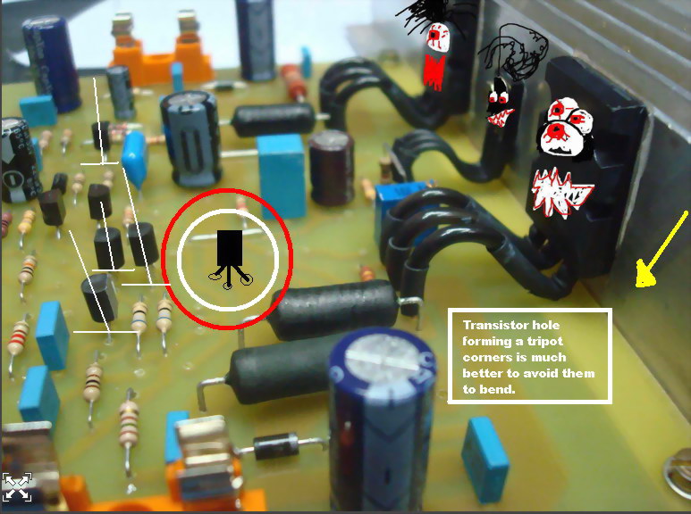

There's always something we can do to make a good thing becomes even better
You see, transistor holes when triangle shape, not aligned, not in a line (strip) form, is much better, you solder and the transistor remains in the position,... tripod is a better support.
So, we can go producing modifications to make things better, but is good not to exagerate, or we will never finish things.

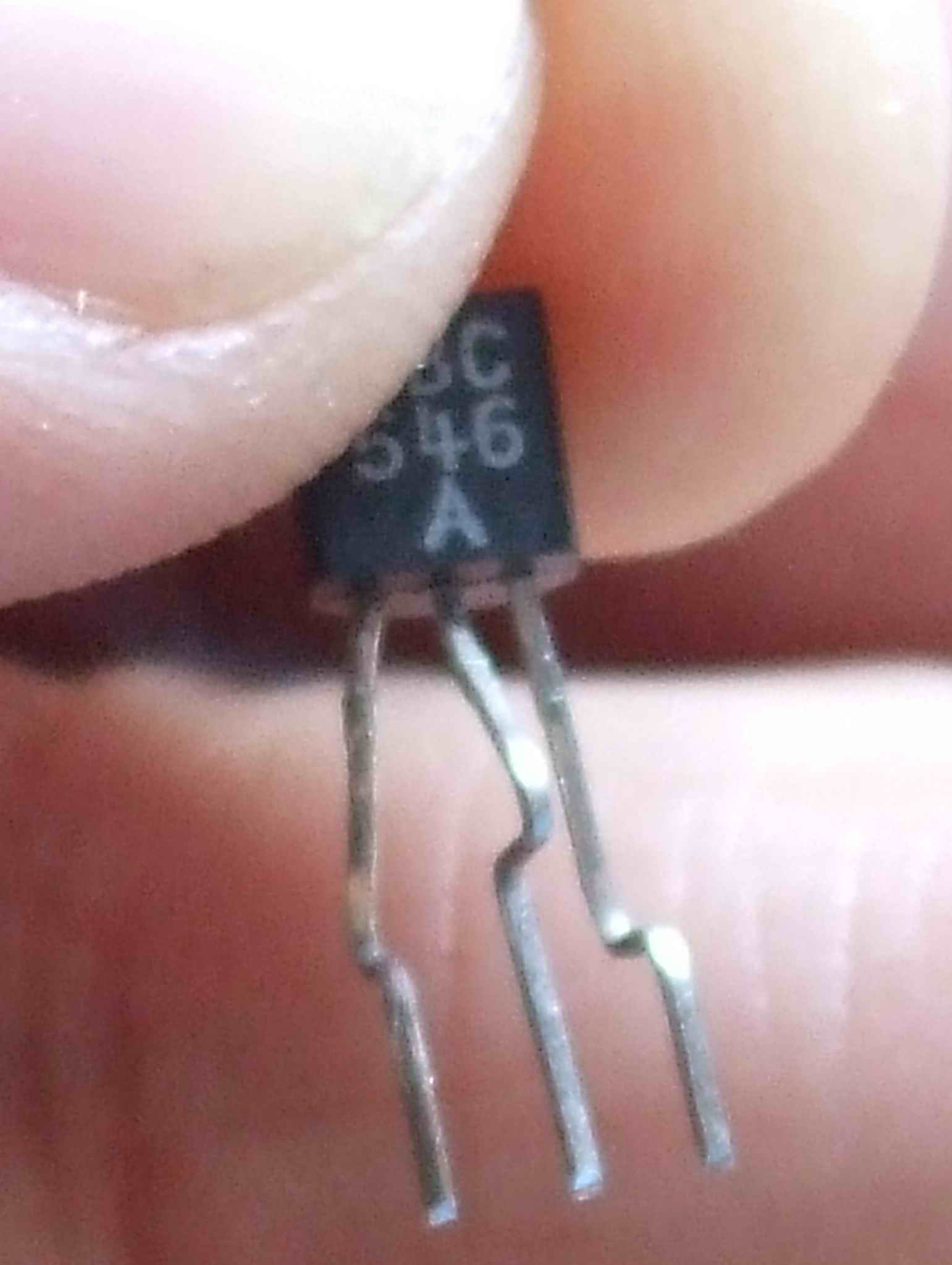

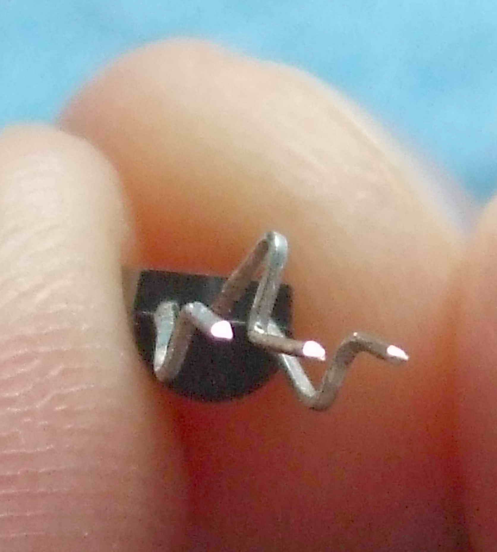

Bending the leads of a transistor too close to the body may result in early failure, particularly in an unbranded part like this.
btw: I have used these transistors that are labeled "CBC" in pink noise generators with quite a lot of success, parts from On-Semiconductor and other known brands didn't produce enough noise 😀
Be aware that this is not usually manufactured to BC546 specs, it's just a generic die labeled BC546, it could be BC547, 548, 549, 550, or even 639 and 337... Capacitances, Ft, noise, and beta are uncontrolled.
I prefer SMD transistors because the TO-92 and TO-126 market is flooded with generic dies with unpredictable performance labeled as whatever you are expecting to get, because the original parts are usually discontinued by almost all the reputable brands that were making them 10 or 20 years ago.
Our lovely BC546/556, BC547/557, BC550/560, BD139/140 almost no longer exist.
I still keep some dozens from On-Semi and Philips that sometimes I use for breadboarding things before they become SMD (and also many dozens of generic/fakes).
