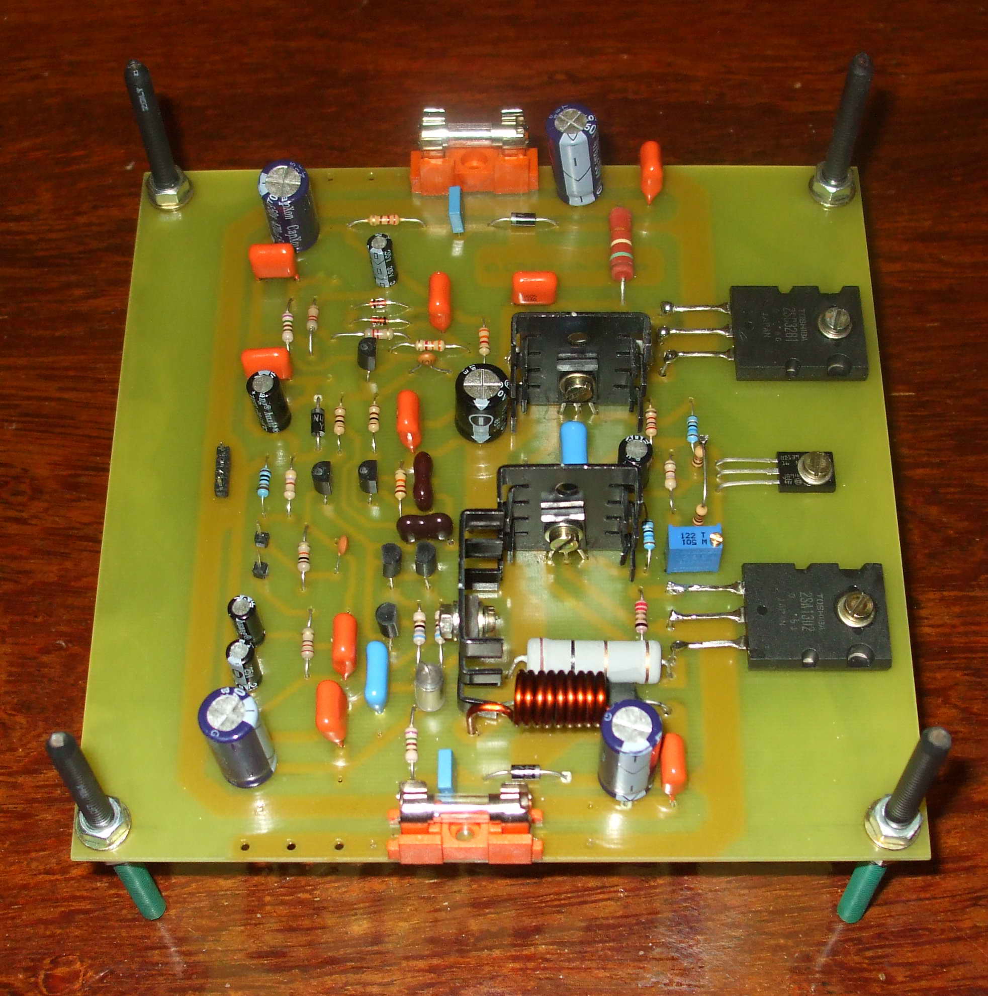

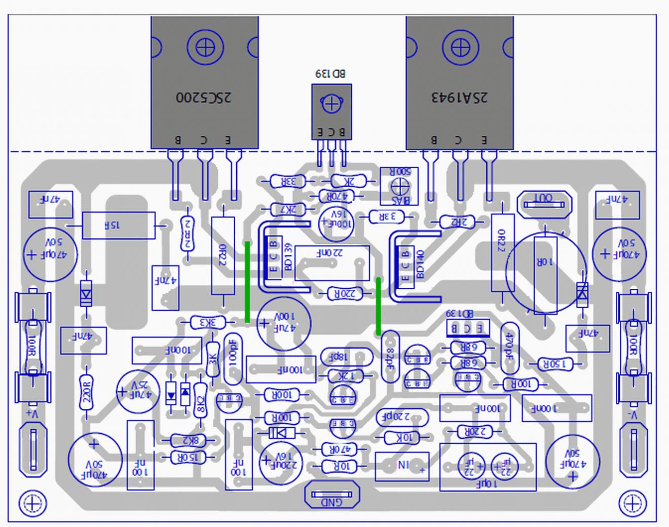

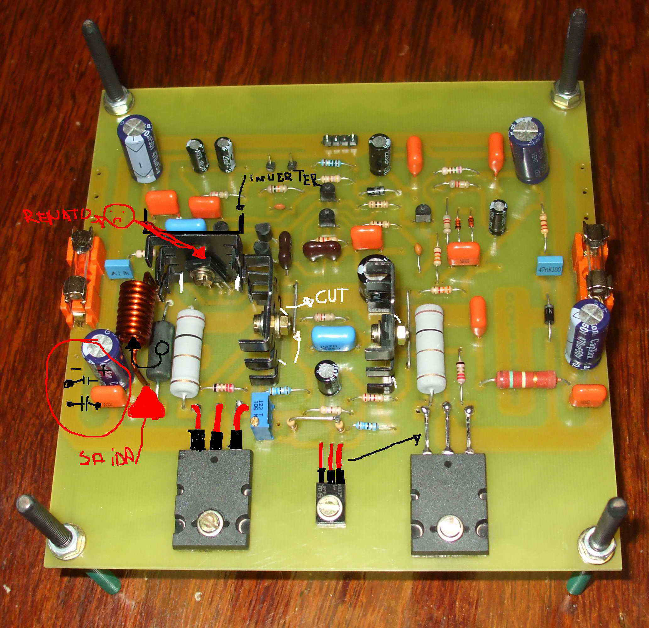

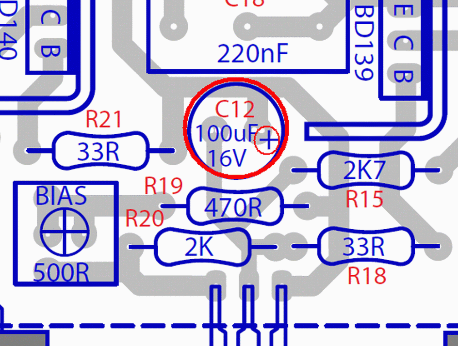

Another error was found,and i have several brazilians observing this, also Taj and me
And we watch without see...this is a terrible human characteristic, we do a lot of mistakes.
This electrolitic condenser have the wrong polarity indicated, the positive goes to the VBE multiplier transistor colector.
regards,
Carlos
regards,
Carlos
Thank you dear Taj
It was a non polarized capacitor, then i have changed to electrolitic, this creates the whole confusion.
regards,
Carlos
regards,
Carlos

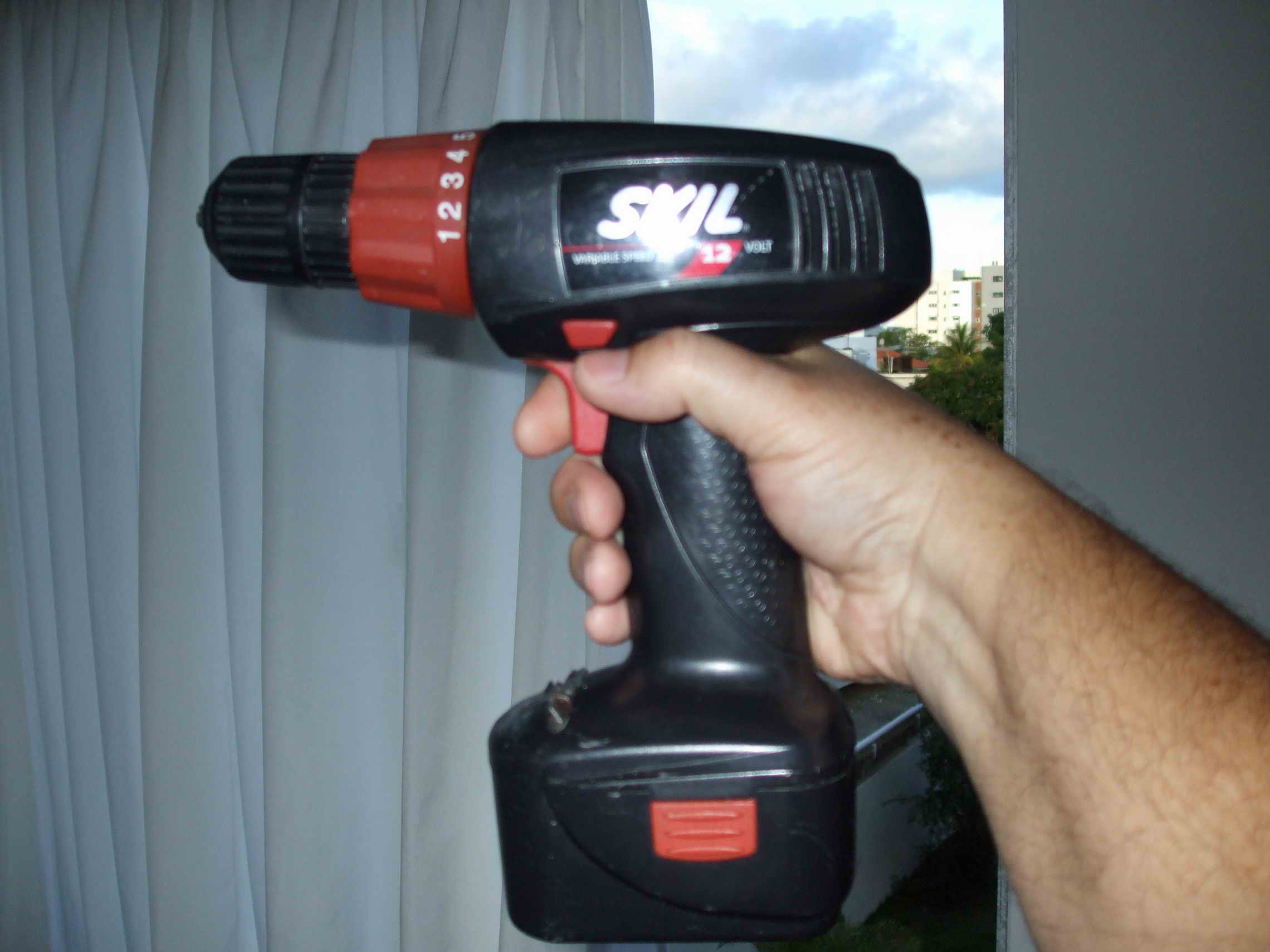

Hello Carlos,
this one:
has been my Christmas-gift this year.
Better than all the Dremel stuff!

Nice picture, snow here only inside my refrigerator freezer.
I have something alike, have a clutch, have several tools for screws, bolts and nuts, you can control the speed and can work reverse too.
Nice machines, very helpfull for our electronic job, works in slow speed, good to use with metals.
Send to Volker my best regards!

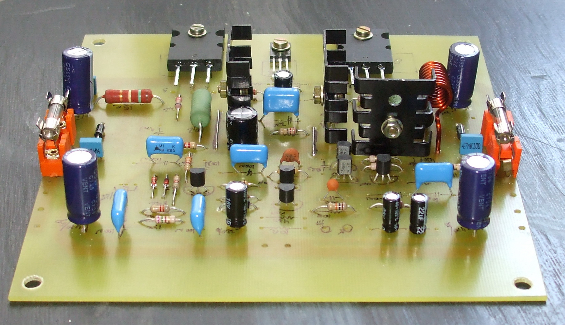

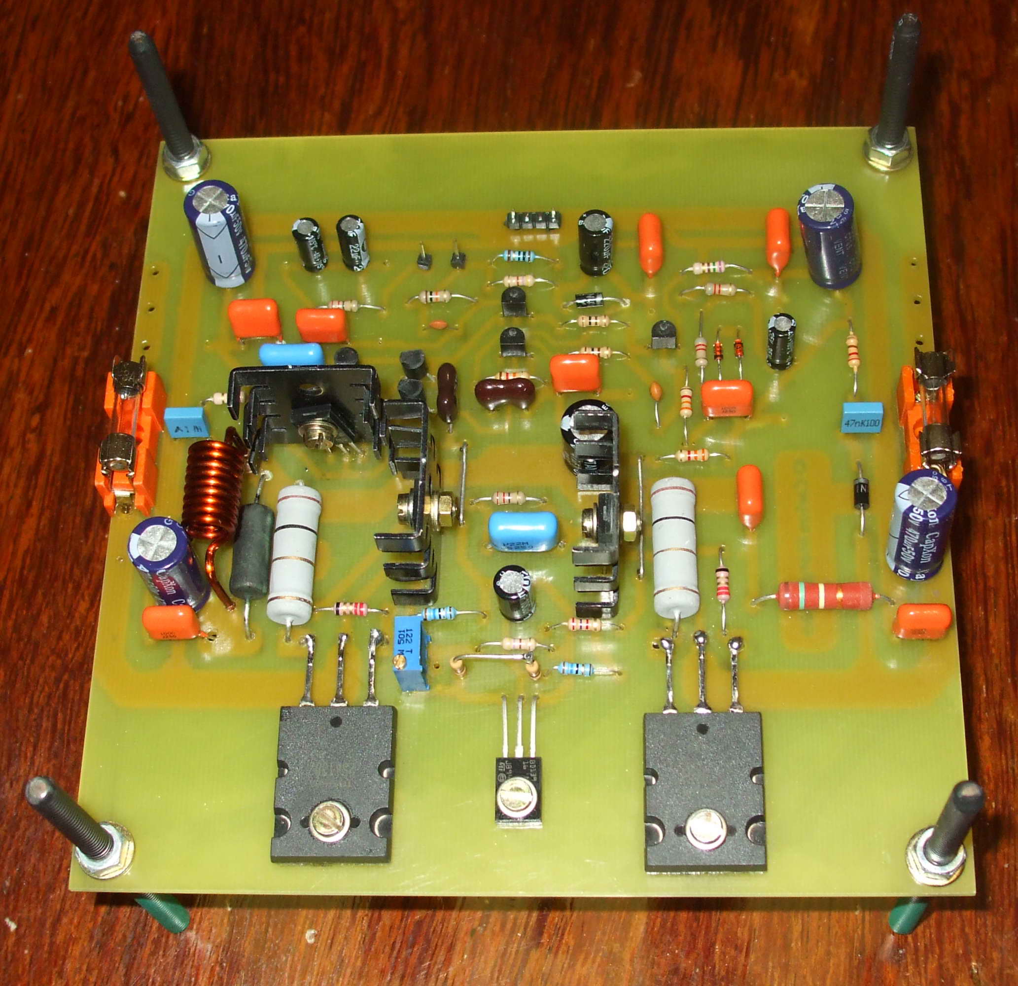

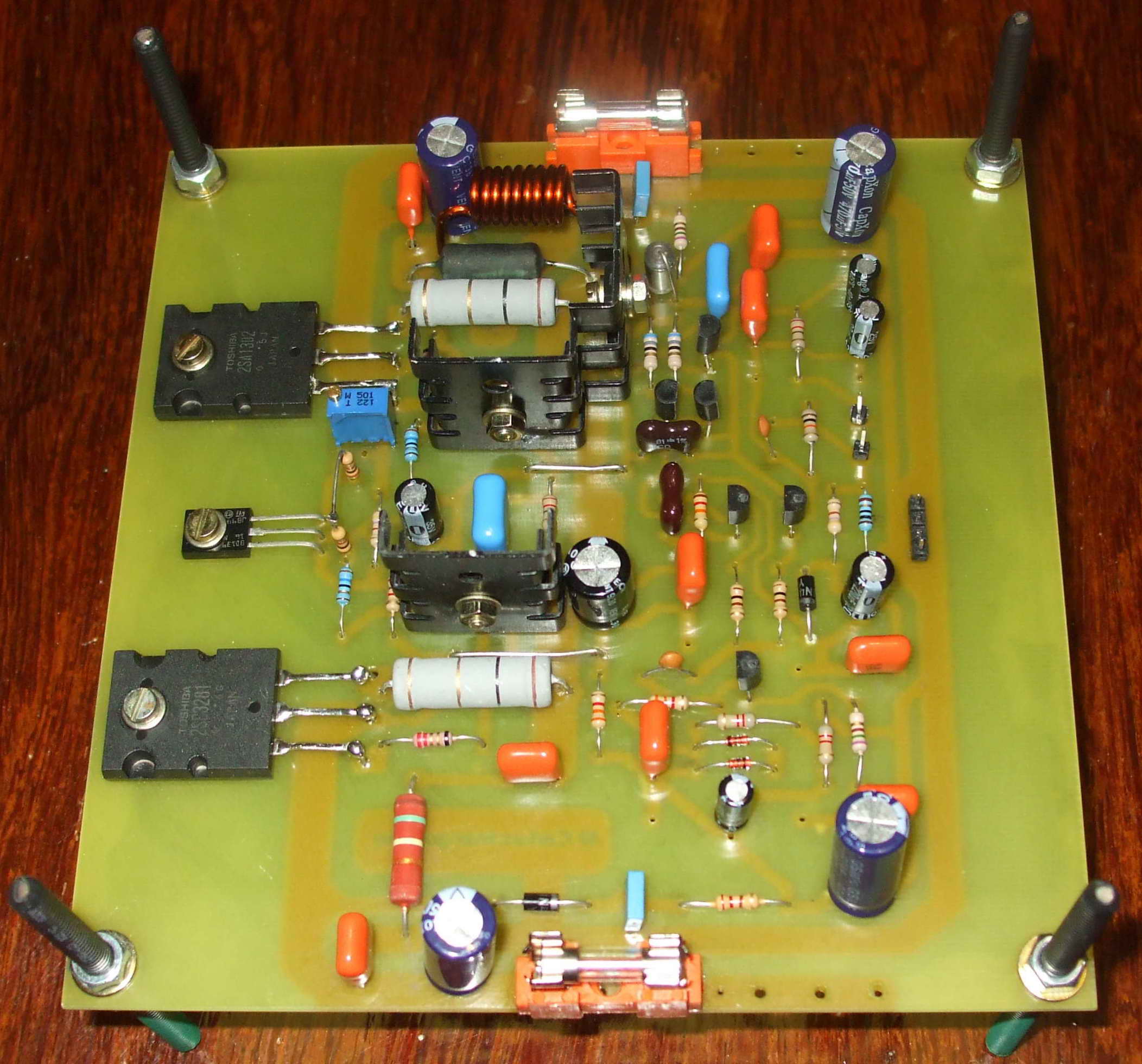

Tomorrow morning, having daylight, them will receive a triple check
Already found the second differential input transistor inverted..and will find more, as usual.
I will not use these power transistors as output, i have just installed because they are rarities, tomorrow will be replaced by 2SC5200 and complementary, the ones i trust the most.
Also you see 1 ohm power emitter resistance, it is just to show you nice colour at the board face, under the board i have 0.33 ohms resistances.
Well, i will search for errors tomorrow, for sure i will find several mistakes, this is normal and natural, lier is the one say that do not make mistake, this affirmative is already a very big mistake because of arrogance.
regards,
Carlos

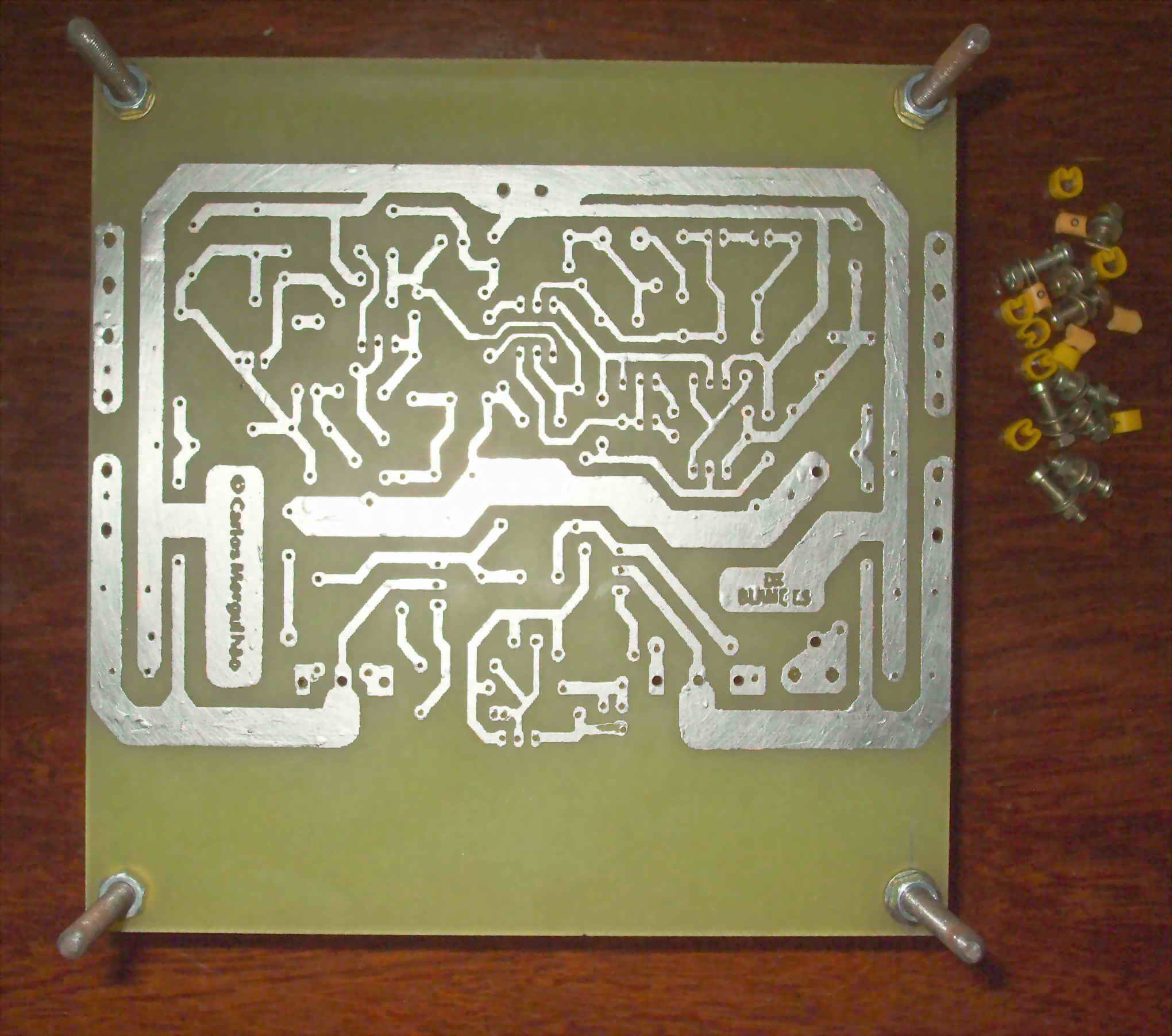

Renato asked me to move some parts and to fix some details
I will do that tomorrow morning.
Renato was the one made the board to me.... he has etched and sent by maild, the board design was Todd Johnson, General Diretor of graphic Arts, PCB Layout, Panels and logos...also President (CEO) from Dx Corporation Canadá.... also Vice President from the entire Corporation.
regards,
Carlos
regards,
Carlos
