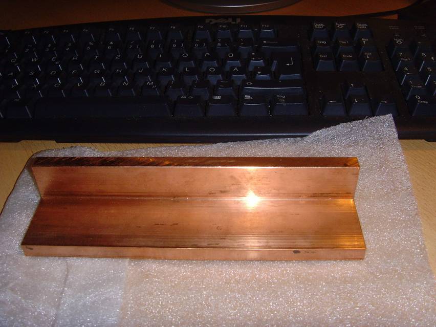

He and his friend Volker, Corporation director of metalworks, enclosure, chassis and wooden cabinet are preparing this beauty.
Watch the " L " profile, will be made using pure copper.
I think the amplifier deserves that.

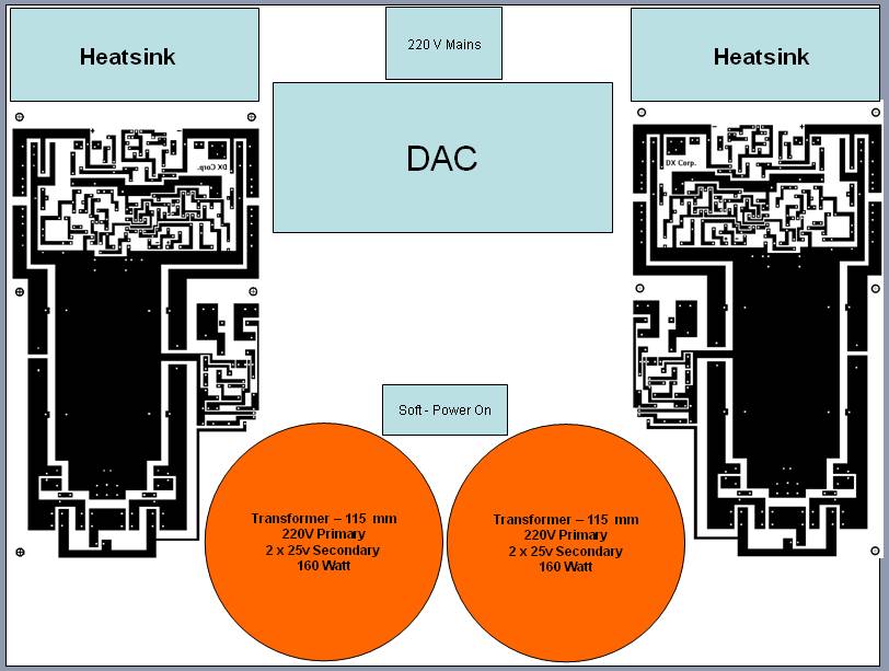

Good evening, Carlos,
since Volker's and my vision of the Blame ES' PCB is rather large, I asked a professional to etch it for us.
The PCB incorporates:
- Your (Todd's) design Version 1.4 of the DX Blame ES
- Greg's PSU for the DX Standard AMP
- My own LS - Protection Circuit
The PCB has a size of 122 x 222 mm.
The AMP will consist of 2 PCBs: one of them is vertically mirrowed.
I hope that I will get them running - but it will take some time.
And I hope: they will sound as you promised!
I will keep you up to date.

Thank you, Todd, very, very much for the time you invested to keep the BlameES' design up-to-date (Version 1.4).
I "optimized" your EAGLE design so I can "seize it with my 58 years old eyes" like this:
I wonder if the electrons will know whether they will have to go a rectangular way or not.
Best regards - Rudi_Ratlos

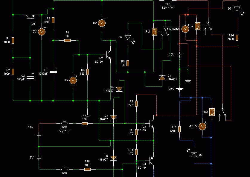

I am studiyng and simulating the DID, Destroyer Insertion Delay
It is in the very first stages, theres a lot to be made, in special when building and testing....so, correctors go away, this is a sketch and a scratch.
No suggestions needed, i want to do by myself to be a genuine Corporation product.
Will use relays, also leds because they are pretty while blimking....no chips, only transistors,
Also if off set bigger than 2V, or rail voltage present in the output will diconnect speaker too.
Will make a clipping indicator, and over current will be protected using normal fuses....i am having fun.
Movie is beeing uploaded to youtube, soon you will see it working.
regards,
Carlos
regards,
Carlos

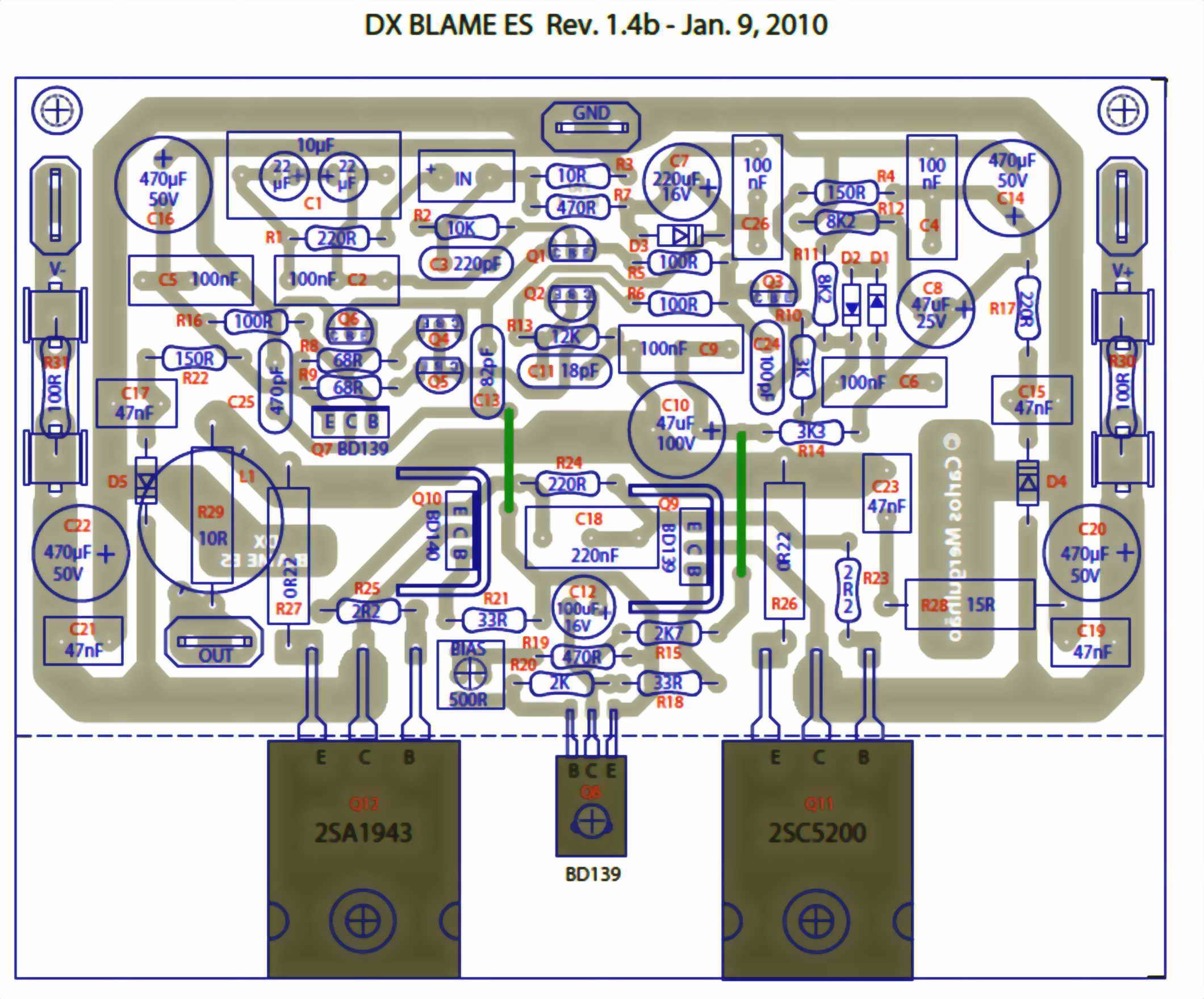

Sorry, my mistake
C24 é o de 100pF, à direita
C25 é o de 470pF, à esquerda
C24 is the 100pf at your rigth
C25 is the 470pf ar your left.
regards,
Carlos

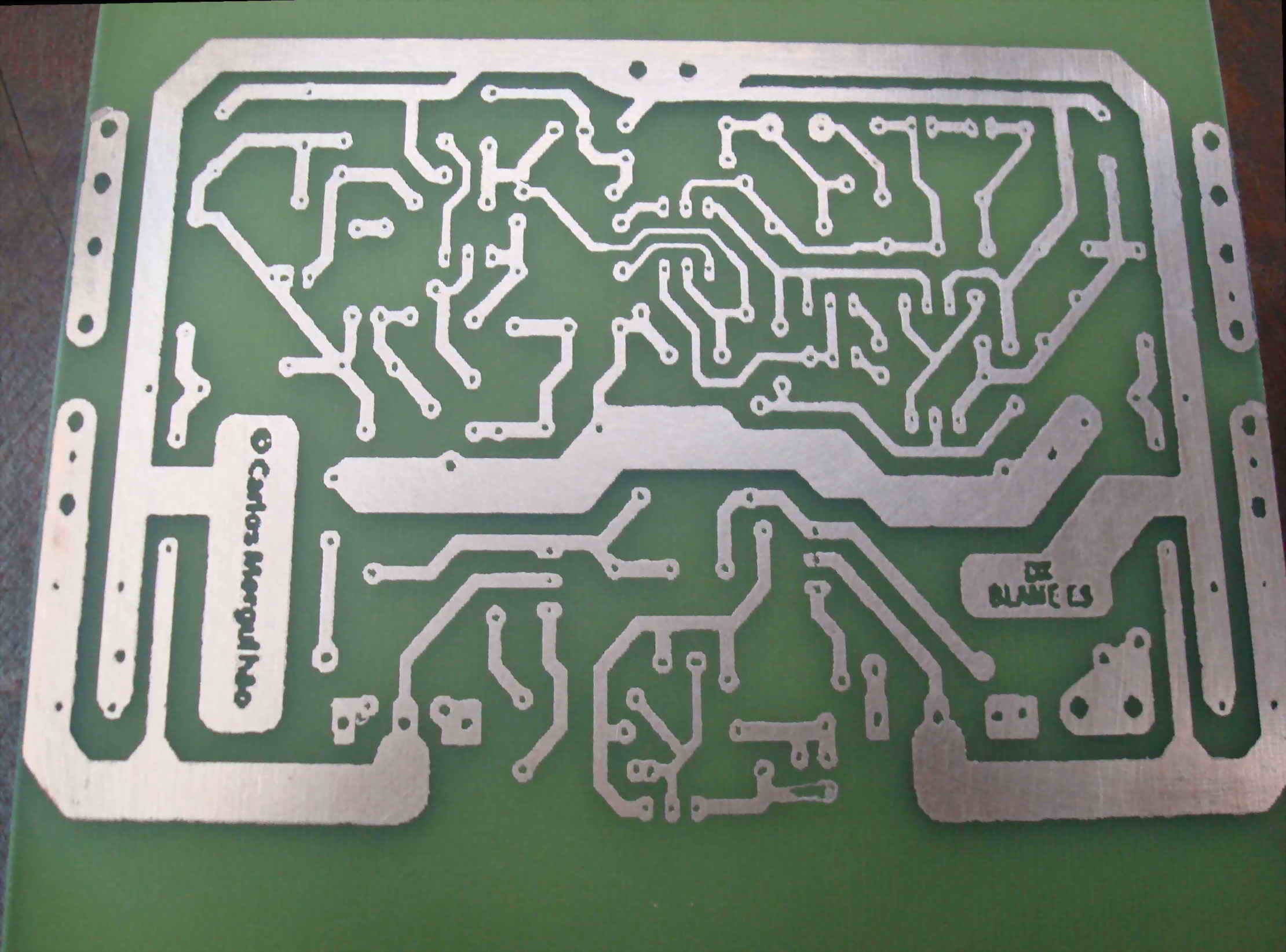

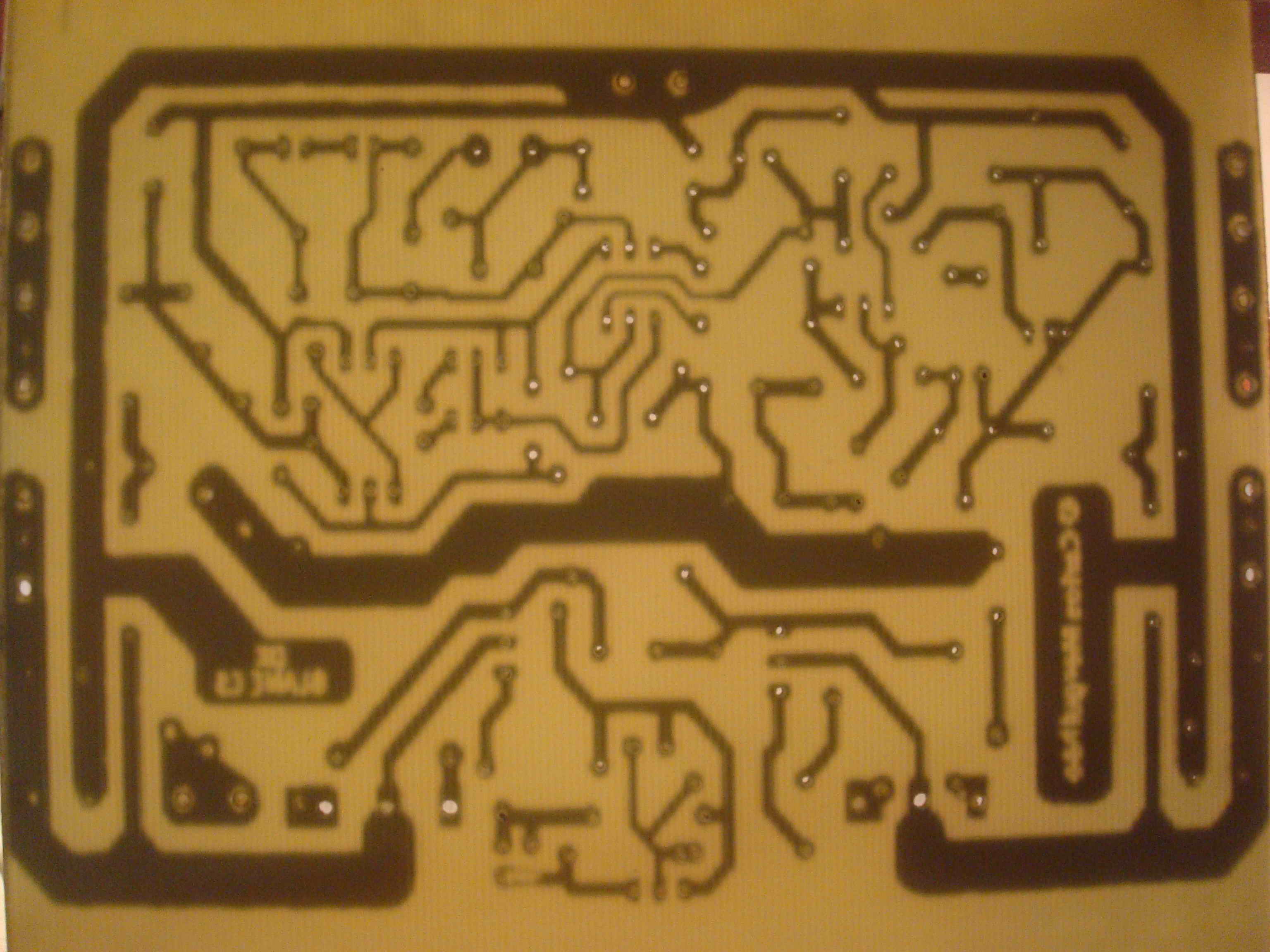

Here it is, the first board made using revision 1.4
attached,
Renato said will make harakiri if i dislike this board, was made using laser copies and hot iron image transference to copper.
This method is not so good compared to optical and chemical transference, but it is reasonable if you do not inspect using enlarging lenses.
regards,
Carlos
attached,
regards,
Carlos

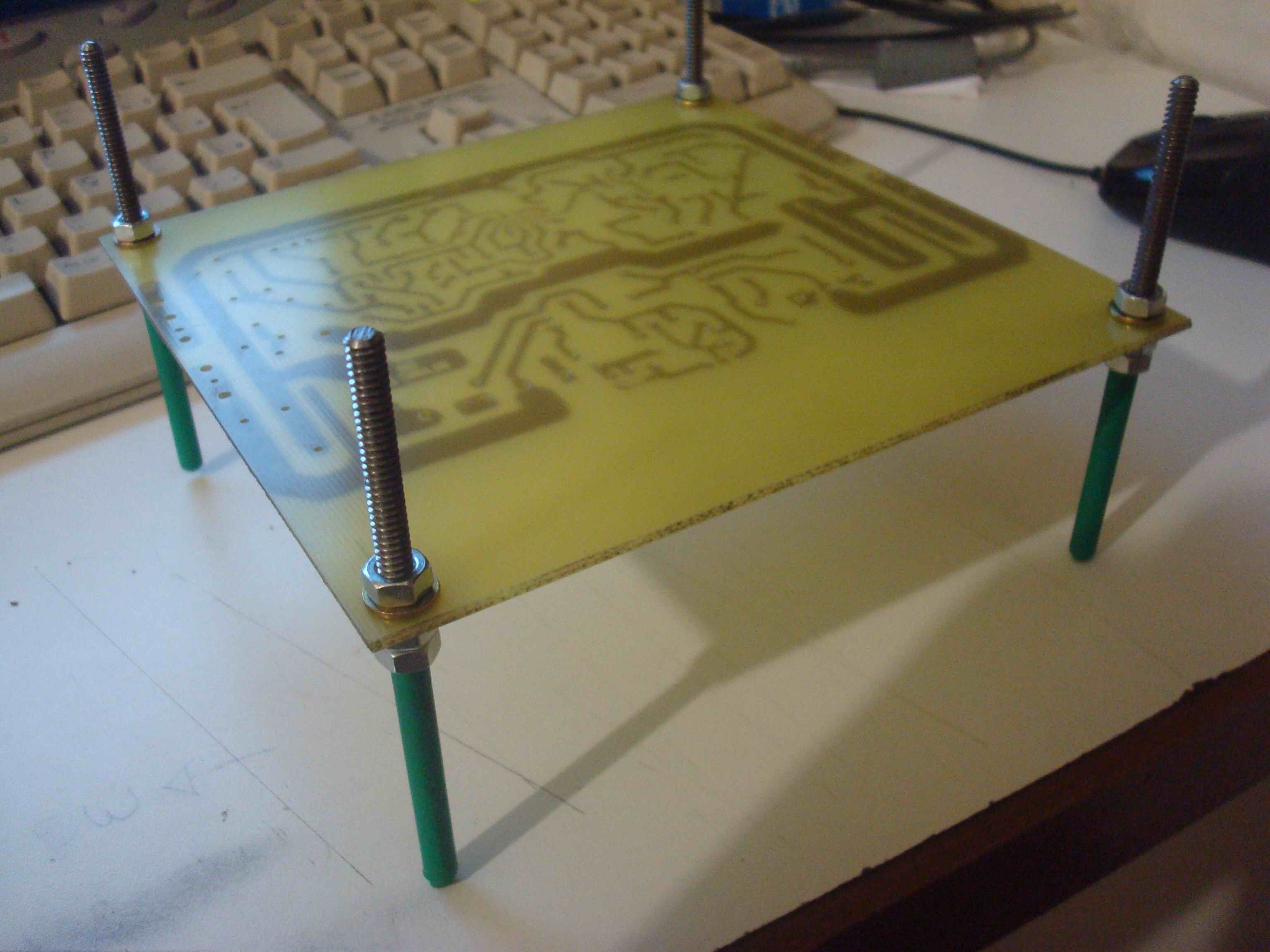

Brazilians are moving, we have already 5 boards working and the sixth one is starting
Also people has made just one to check if they like the sonics, now they will make the second one for a stereo..this is clever, why to make two and them be twice frustrated?
We gonna be a super power in a matter of 50 years i think, because of that, we are hard workers, and use to simplify, to make more simple everything, not really complicators we are.
See, the board stand, heheheheh, very interesting, cheap and clever, you can turn upside down to solder.
also you can use to put a lamp and to watch the board in the transparency mode.
This Italian ( we call carcamano our Italians descendents), Renato Comerlatte is very clever.
regards,
Carlos
