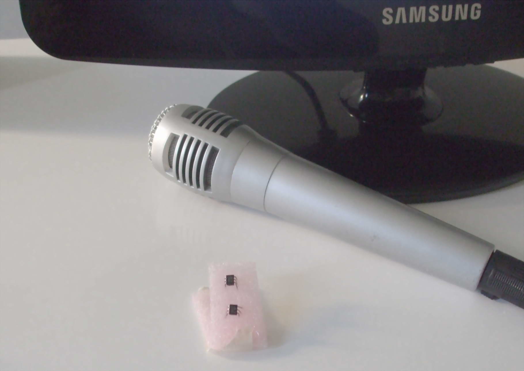

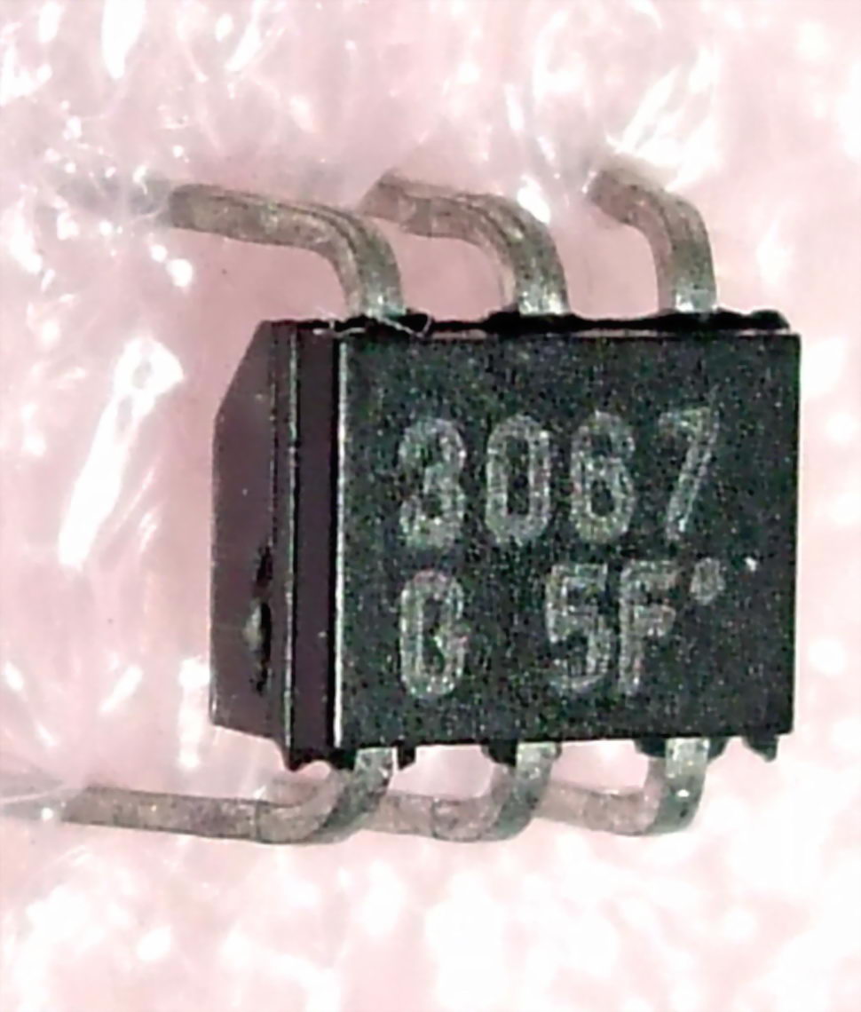

You see Eva, i have some small bugs, these ones are not surface mount devices
in the reality they are micro transistors, duas transistors only, but they are NPN, so, to use them i have to change my design.
Also, i use to create amplifiers not only to my own use, my pleasure is to share, and these are, let's say, custom parts, special and hard to find (maybe) parts..so, i will complicate in the place to simplify my people life.
Reason why, despite lovely gift from Taj, became also a problem, how to use them..where to use them ad why to use them.
It is hard to hold, hard to see..very small bugs, see the picture, the comparison with the microphone..i know Eva, for you may be giant, but you seem to have 25 years old..i am an old bear.

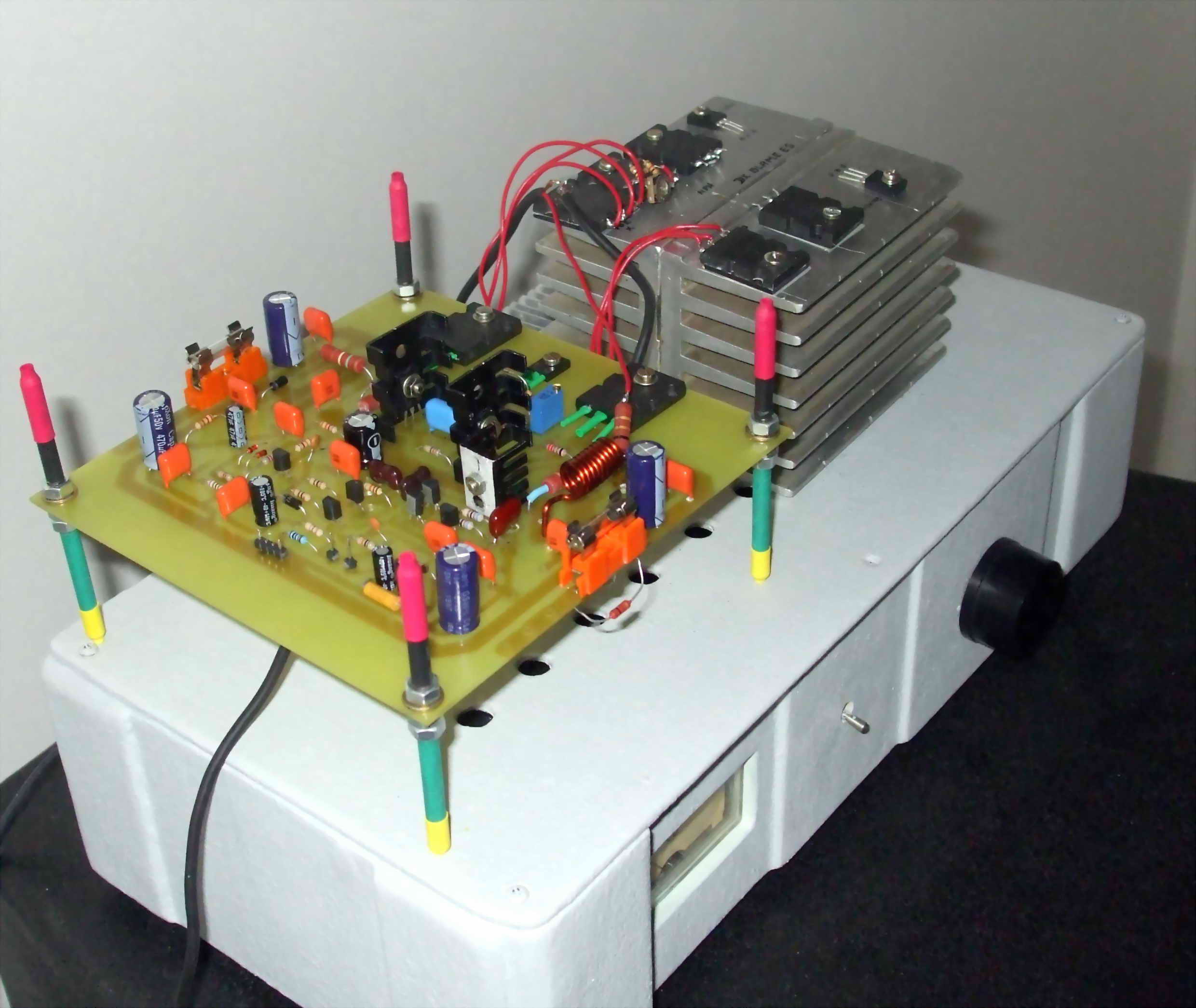

You see, no reviser could find that bug, also i could not, several guys could not
watching the picture is a hell clear a 150K resistance, a big one, left upper side, and this is a rarity in transistorized circuits, normal to tubes, but super strange to transistors, we do not use this value, not common, and never so big that way!
You see, the revisers, those folks loves to help (or give one on you) have not observed that.
My friend that made the board, was a gift!, he sent me this way, i have not bothered, i felt the resistance pretty, and i have installed in the place, bellow the board there's the 15 ohms resistance, they are in parallel, so the value will be slightly reduced, and this is not a problem there.
I have keept that to see the revisers, no one could see.
This shows, this proves, without any doubts, that we all, humans, make mistakes, and also that we can "watch without see things"...this is very good to think about and to reduce the pride and Ego, because we are just humans,nothing more than humans, in less than 70 years we will be sand...observe this to be more friendly and kind during your small stay in this world (if exists other)
the zobel filter, using 150K means it was deactivated, so, a killing thing to an amplifier that HAD, in the early moments of life, troubles with oscilation, you see, if someone between the devil's crew could see that, anyone of them have helped maybe they let me huck myself , so, you see we have some sweet devils in the forum too.... but they taste alike salt and pepper

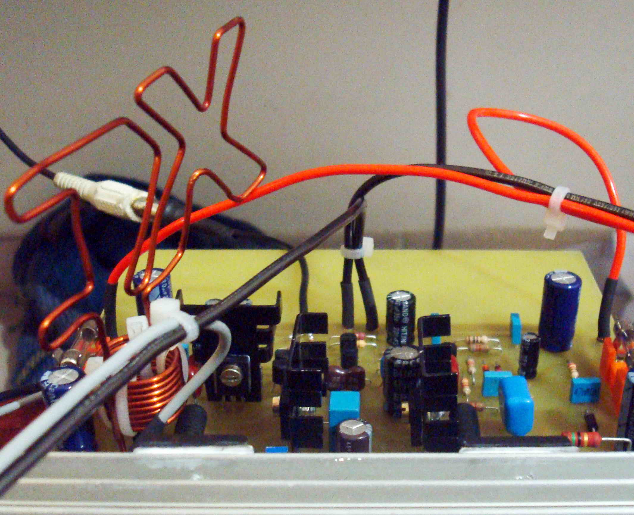

Boys!, i have checked my amplifier, i was curious if using long transistor wires (12 cm) i would have oscilation, no way, it is stable, even using wires to connect transistors.
I have not " L " adaptor for a while, reason why i am not in a hurry about this one, i have already two units operating that i can listen.
But was checked.... attention!, bias trimpot, my home, with 42 volts supply, was adjusted to 280 ohms...your home may be the same, because i have more voltage but i have compensated the current, bootstrapp was adjusted to have same current, so, VBE multiplier is working with the same current too.
regards,

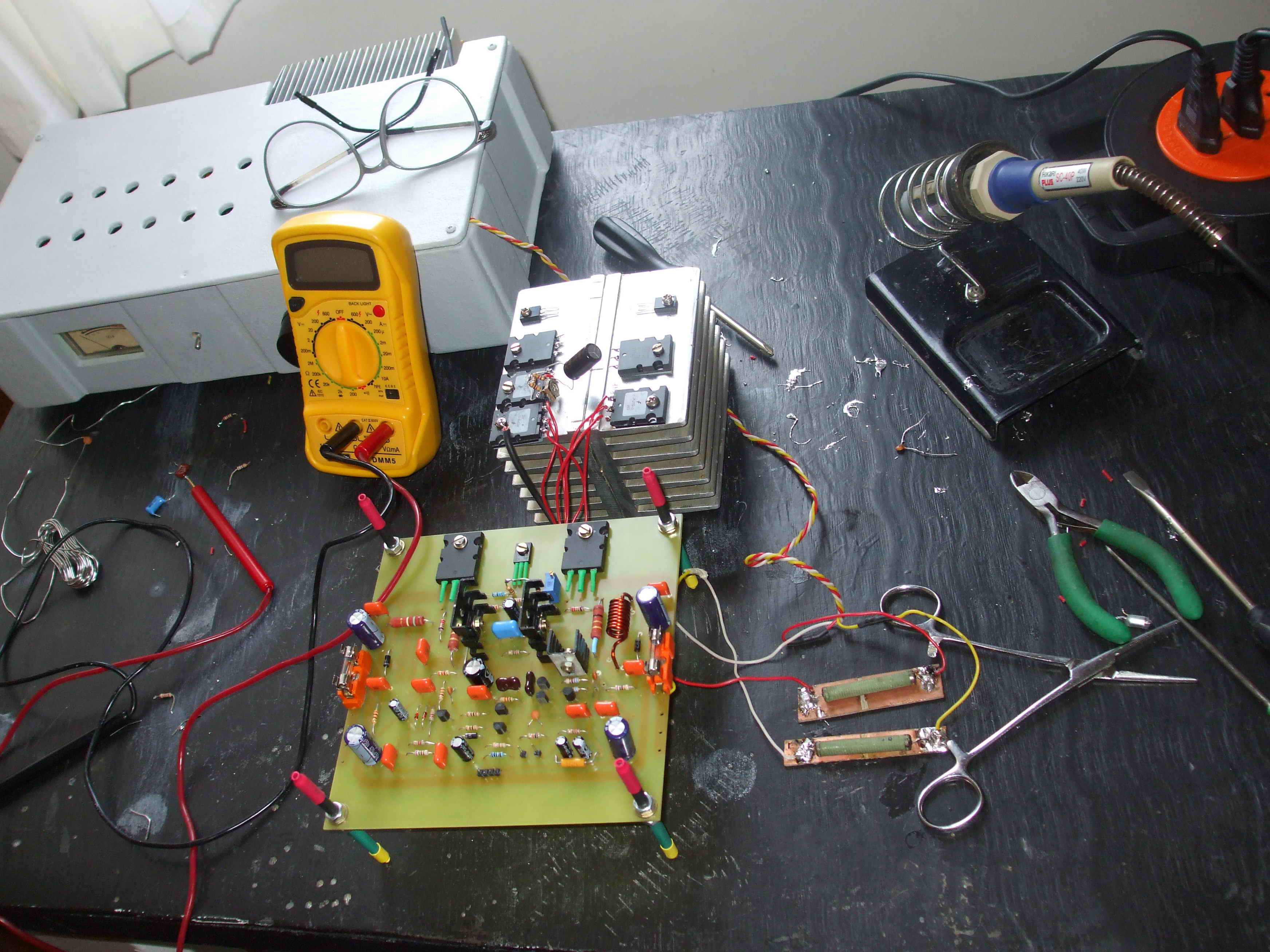

This one is playing since yesterday..during the nigth was connected to a resistive
load.
Now playing low volume, and will be increase to maximum undistorted as soon as time goes passing... 8 AM we can start to make noises in my country, no one can complain about that.
Bias was adjusted to 4.4 volts over 100 ohms protective resistance, off set is 10 to 11 milivolts if i remember (I have three, and they use to have 13 milivolts without tweeking to reduce.... 13 is fine, till 25 it is OK!)
So, bias is 44 miliamperes to each rail, everybody there cool, no signs of oscilation, you can put your finger in the input and pure mains frequency is heard, clean, without noises or high frequency tones..amplifier super stable, i have installed 2.2uf and worked fine, nothing changed in the sound, no oscilations measured, felt or perceived monitoring consumption and heat.
I could make this one have more bass, because input condensers and capacitors resulted in 14 uF.... bass is better, more present than before, so this is the most simple bass increasing we can have..also i have reduced my power emitter resistances to 0,1 ohm... all other values standard as the schematic, the enlarge board was aproved too..everything fine, everything all rigth, sound is the best possible, treble is the world best treble i could listen, no power on thump, just the pulse because you flip a switch and this cause disturbances.
The board, using the official dimensions, or, not enlarged, worked fine yesterday too, the last board version with the last updated schematic worked fine and had only to tweek the bias trimpot to 330 ohms (his case) and he had 30ma each channel and 10 milivolts of set too.
Be happy, build one for you.
