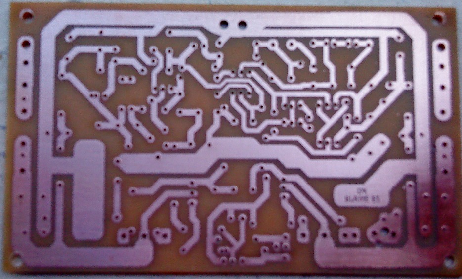

the PCB ( low quality ) .

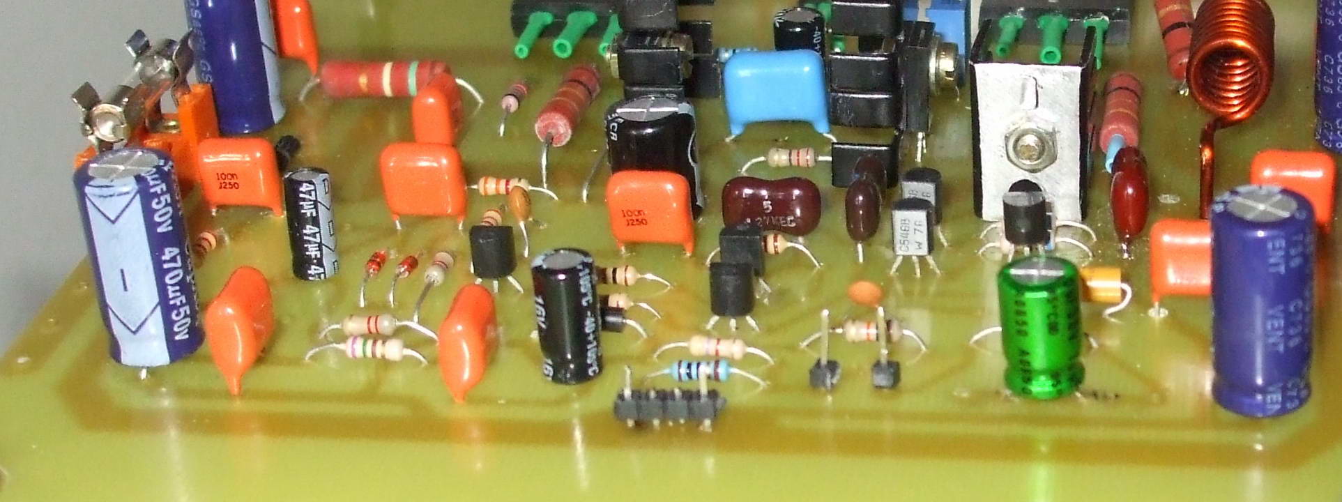

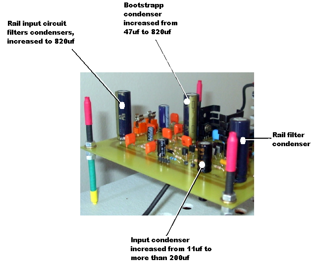

A local audiomaniac friend insisted to me to make some modifications
I said this would not result fine...but he insisted so much that i decide to satisfy his needs.
He said i should increase the bootstrapp condenser, i said 47uf is more than excelent there, i told if i increase result would be sound less precise, less defined.... and this happened exaclty this way.
He asked me to increase a lot the input condenser...ahahahha, almost 10 times...i said this would filter the treble, as this condenser, the input, is in a series patch to ground... input resistance, then the condenser, then the input base to ground resistance...this is a hell filter..... he insisted...i have made.... awfull!... treble high end gone, lost all brigth.
Increase your input condenser maximum to 20uf, better to use bipolar... or some MKP or good quality unit (Big...very big!)
I will revert that.... with these modifications the amplifier lost a lot of audio quality...the unit was assassinated....hehehehe...of course the bass increased a little, but this way we are paying very much having so bad precision in sonics and this shy treble.
Will return to the way it was.... respecting the schematic.
regards,
Carlos

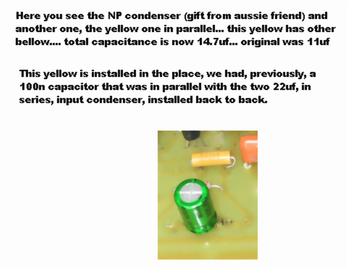

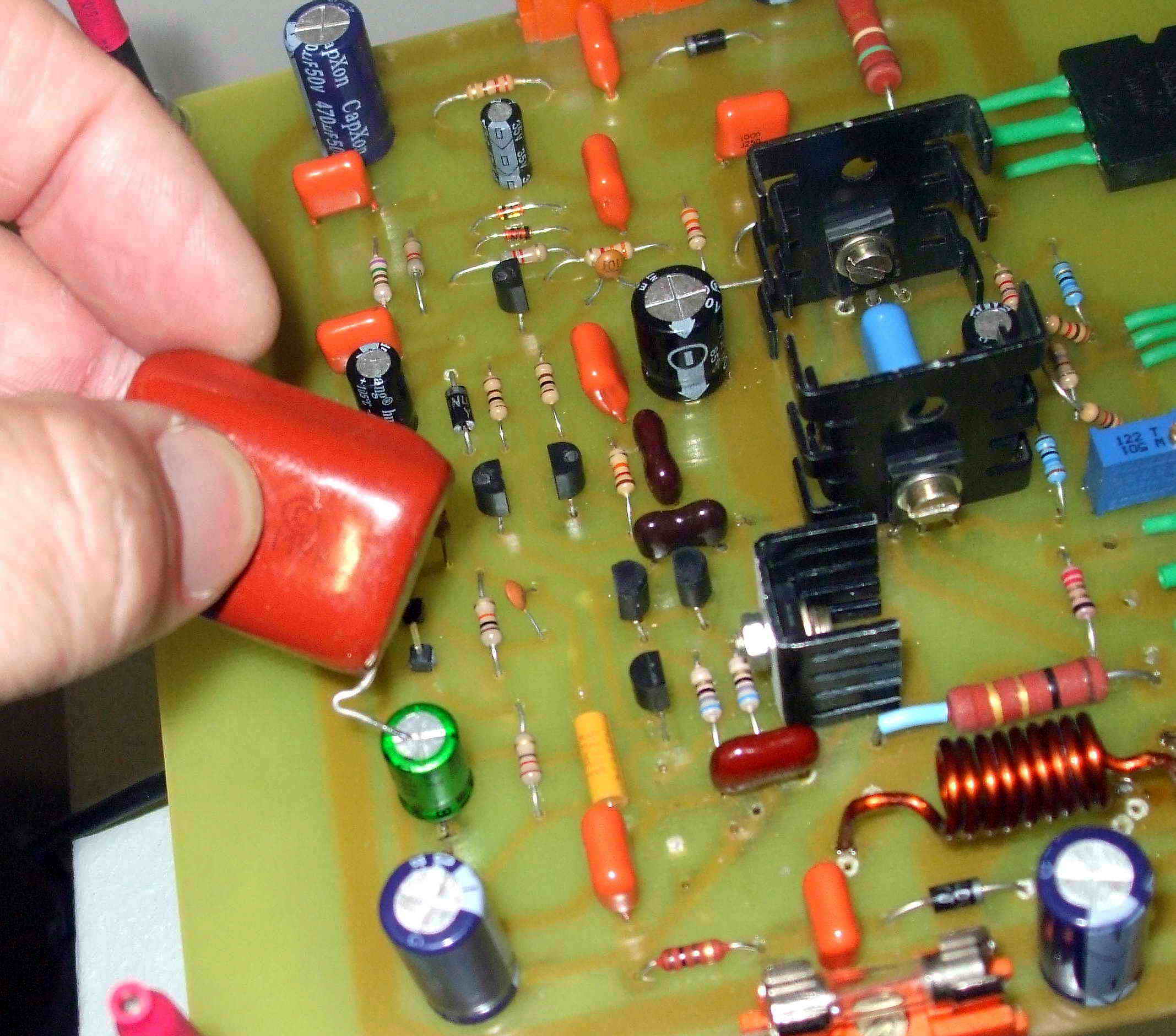

Well, almost back to normal, i have installed a 10uf NP condenser
And this one is not so good as the ones i had before.
Will substitute the one tomorrow..but sonics is now almost the same.
This NP, when you touch it you send mains frequency that is in your body (body is an antenna to mains home cable) is beeing picked...not a good idea this way.
It is sensitive metal case exposed...hummmm, no good.
regards,
Carlos
