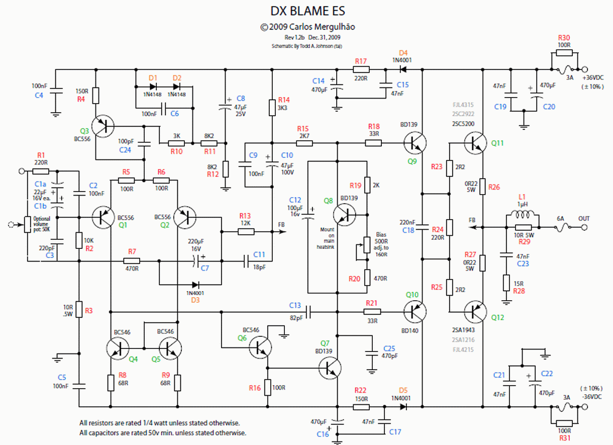

Hi Greg and Alex,
Good eyes! Yes, I see I accidentally deleted C18. Here's the fixed schematic.

Carlos,
I will provide one more PCB layout in a couple days (v1.3) and that will be the last. So make sure you have everything firmly decided by then.
The 2uF capacitor for C18 will need to be an electrolytic to fit on the PCB without too much change. A film cap will be too large.

10uF and 12k at the input forces all the other electrolytics to be much larger than you presently have them.AndrewT... what you think about to use 10uf, would be easier to find electrolytic capacitor having this value ,but better there would be a non electrolytic,
At the moment the input filter does not determine the passband of the amplifier.
I believe this needs to be fine tuned to achieve that passive filtered passband.

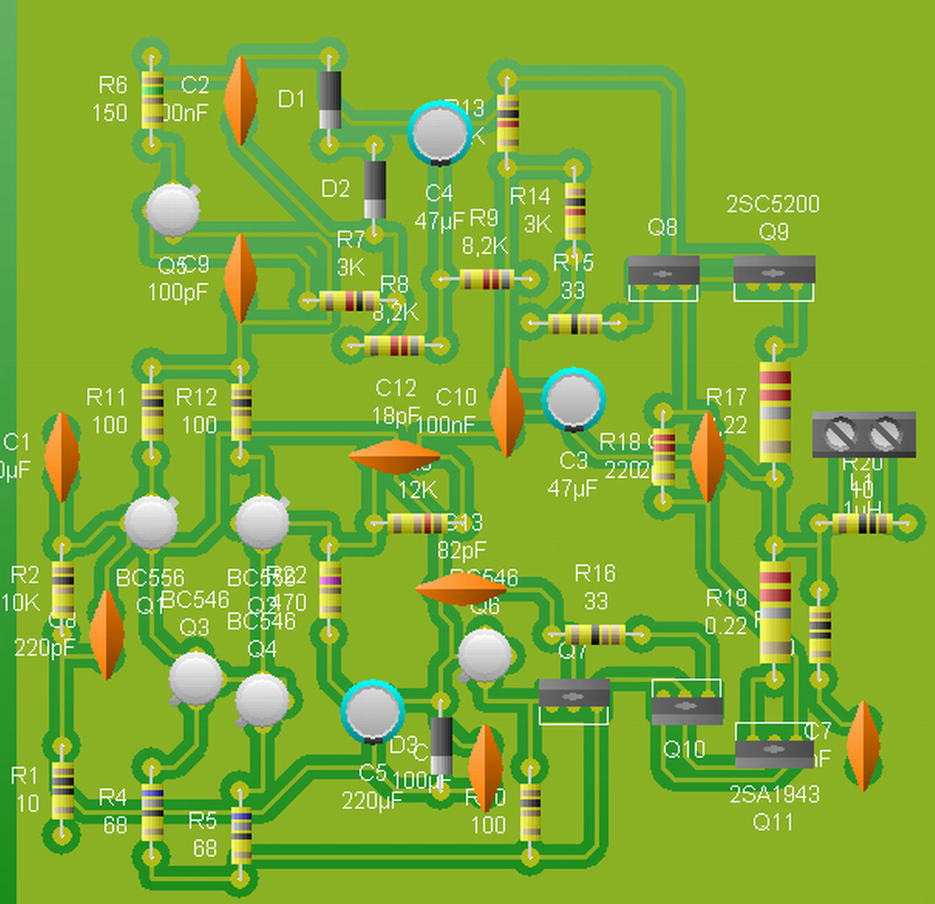

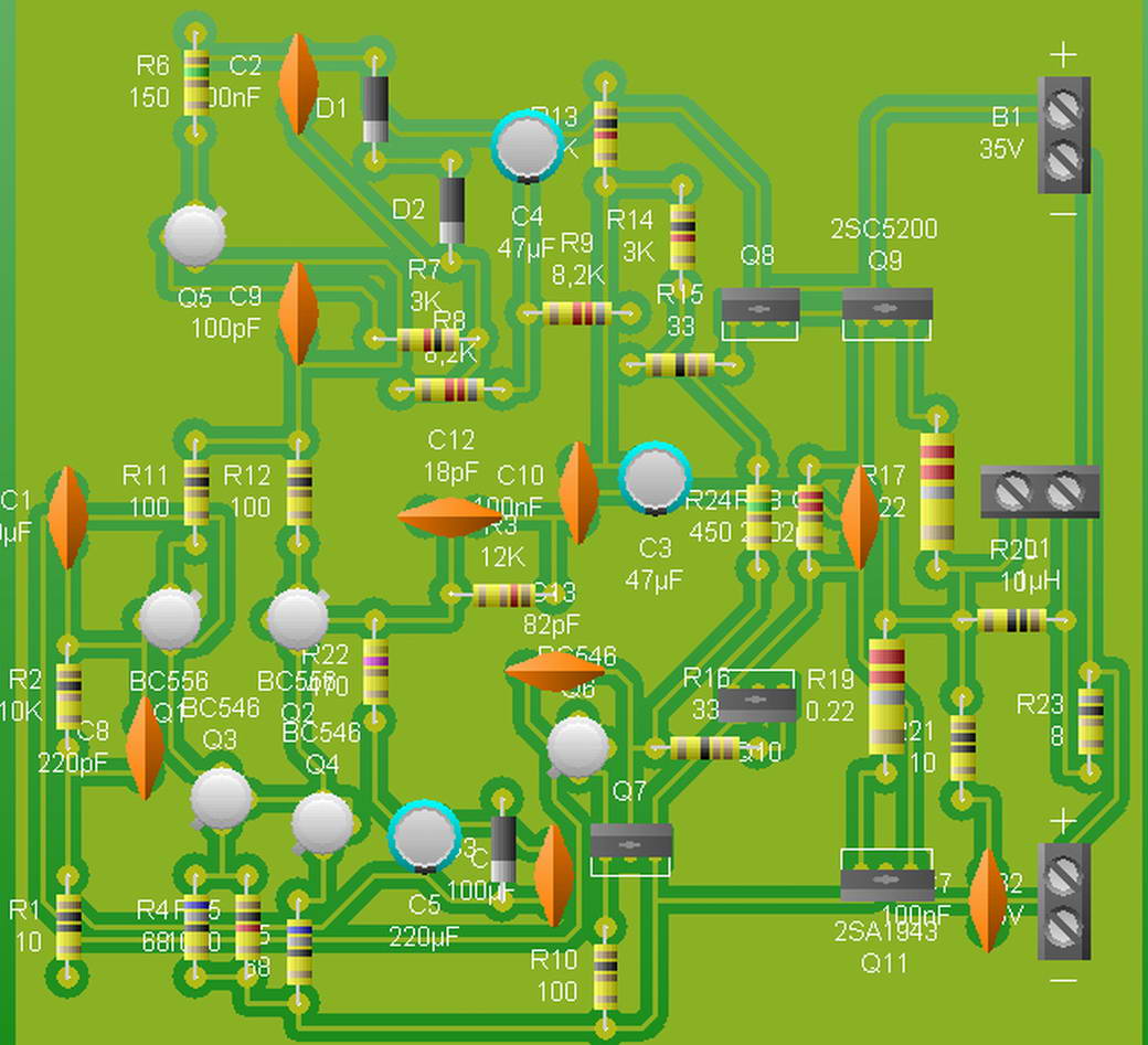

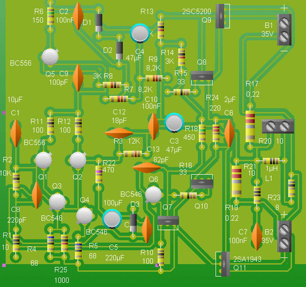

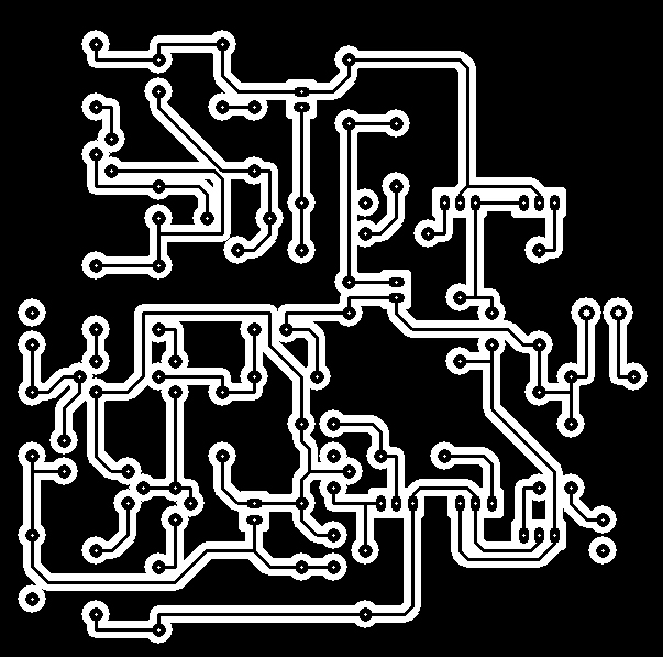

Now i can produce schematic and temporary boards
using LiveWire and Pcb Wizzard,
Not sophisticated, but something people can use while we wait the professional work from Taj.... these boards can help my group in the Orkut too.
VBE multiplier board not included, this is only an exercise, but for sure will work if etched.
The software trace the board automatically, something clever.
Official Art Director, for Boards and layouts is Taj.... a Dx Corporation Member that has a picture into the hall of fame in the headquarters.
I know the 2SC5200 size is not good...this is an exercise, but with wires we can build and will work, Dx amplifier can use wires to speaker, they use to be tested this way, if work in my home tests, under such crazy sittuation, will work also with this board.

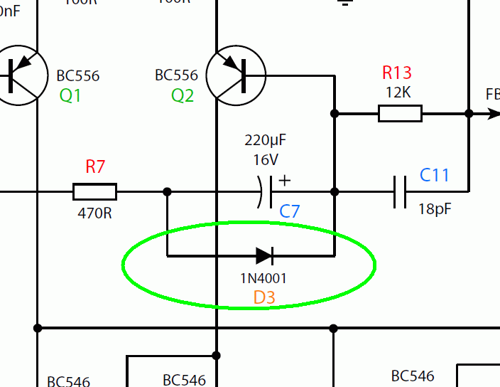

This protects but limits the electrolitic condenser job
This avoids the voltage to exceed the electrolitic condenser maximum insulation voltage, and this may happens in several cases... so, you can use 16 volts small condenser in the place to use the normal (better ) rail to rail electrolitic condenser.
Distortions, clipping may produce DC at the output line, and this will cross R13 that will limit the current in something around 2 miliamps i think.
If your NPN or PNP driver result damaged, then you gonna have rail voltage at the output line, also happens if NPN and PNP output damaged...what happens?
The rail voltage (35V) cross R13 and charge electrolitic condenser C7... well, 35 volts will destroy the electrolitic condenser that will explode, the diode will be there, in the schematic case, to protect, draining the voltage and resulting in 0.6 volts because diode zener properties and junction voltage drop ..will work if negative rail appear in the output line...if positive appear nothing will happens, the diode will not protect.
We need two diodes, in the reality, i think better is to use a rail to rail electrolitic condenser there in the place to use this diode, or these diodes in the case you install two, back to back.
Audio swing will also be present there, and the diodes will clip in 0.6 volts.
I do not like the idea, i think better without them, diodes use to generate noises and to detect radio frequency, use to create unstabilities too.
Just to talk a little, i was observing that, how i could do that mistake?..and nobody has perceived that, the revisers have not observed too.
Interesting, we use to make mistakes, and they can be watching us, or in front of our eyes for a very long time and we look at them without see them.
regards,
Carlos
Good to play with this software
I will change the power transistor position at the schematic, maybe this way i will have them in better position when the automatic routing finishes once again.
regards,
Carlos
regards,
Carlos
This satisfies me, i am a simple man, i do not need perfection
This software is enougth, do the job for us, we do not need to be studying how to use for weeks, 10 minutes is enought, it does automatically almost all we need, you have only to draw the schematic the same way (easier) you do with Multisim, Workbench and others.
You click in "produce boards" and ready...this is clever, this way we do not turn slaves from the software, the hell thing works for us to simplify our lives, instead of complicate our lives.
regards,
Carlos
regards,
Carlos
- Dx Blame ES .... based into the Blameless, i am trying a new amplifier
