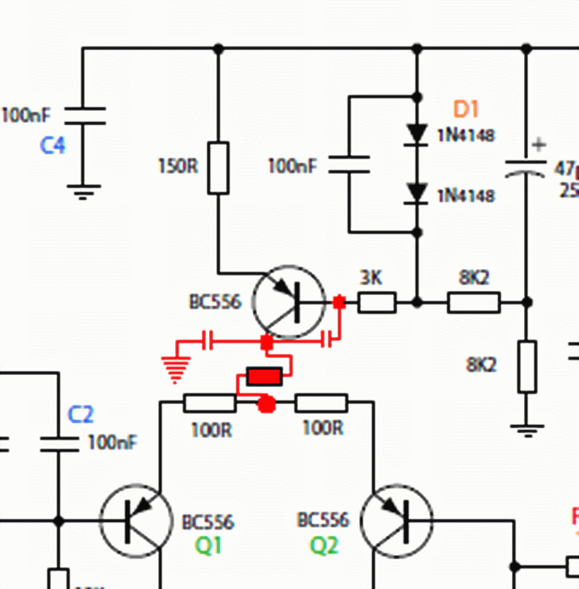

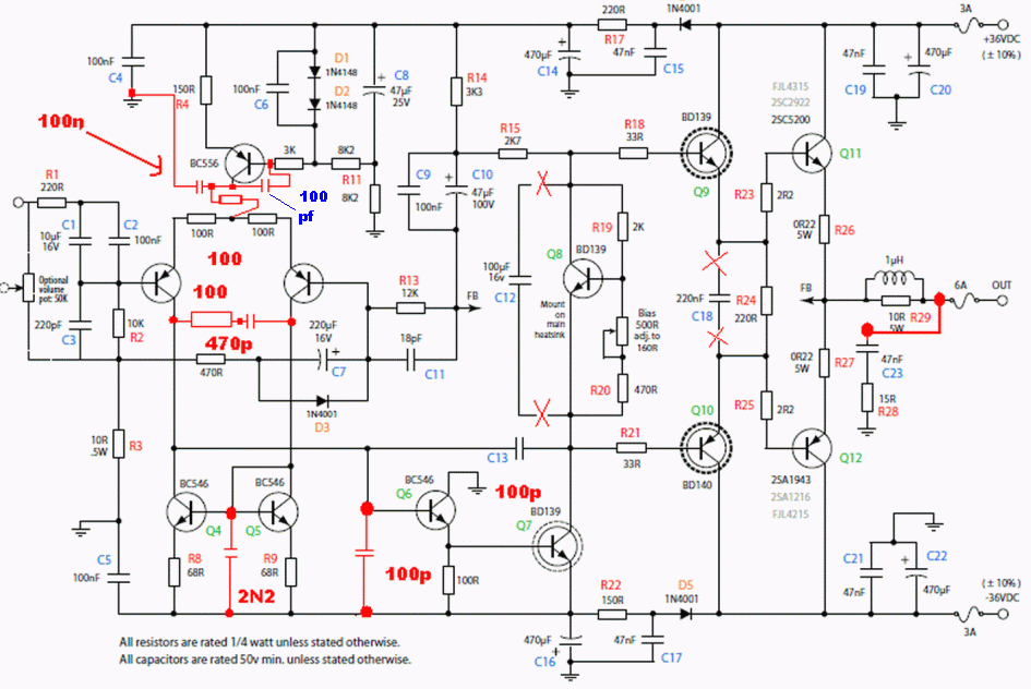

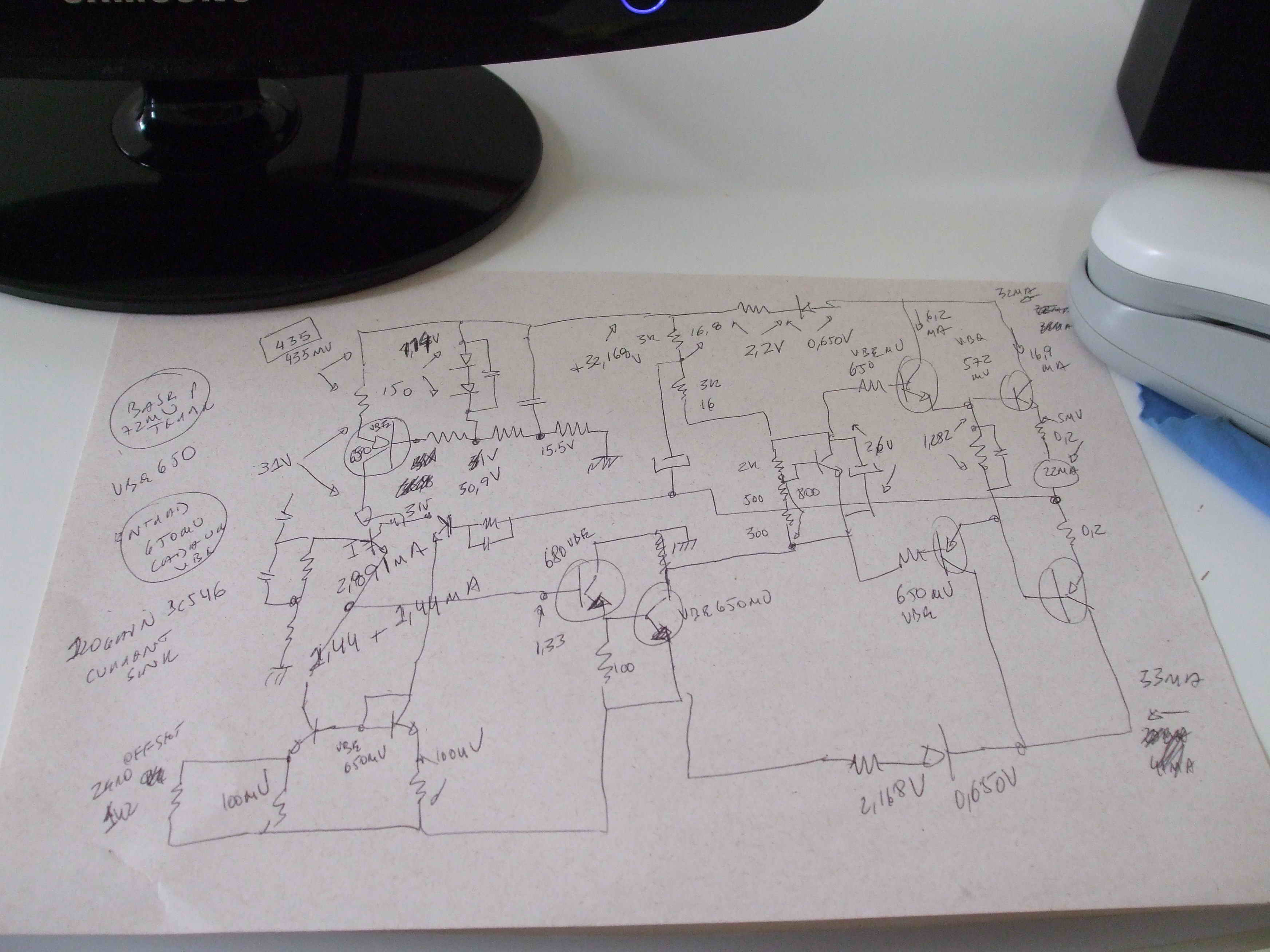

I have two units operating, one playing rigth now
But a friend is facing troubles, maybe his own errors, but more probable, the circuit may be unstable.
This is not oficial final schematic, it is just something to my friend to try to see if his unit works stable.
regards,
Carlos
regards,
Carlos
Worked fine with Sergio Vaz, now i will know what modifications he did
as soon he send mail with details, themi will post to keep you informed.
He said the amplifier sounded great!...he said Bingo!!!
regards,
Carlos
regards,
Carlos

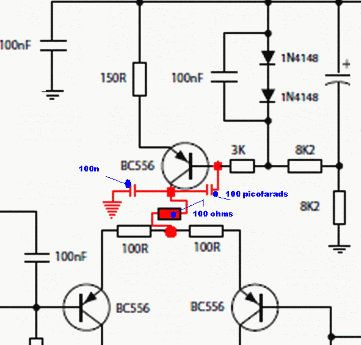

This fixed the unstability.
100n from CCS colector to ground and 100pf from CCS colector to the base.
A resistance in series, 100 ohms unit.
This will be confirmed soon, he is happy, dancing, and listening the amplifier.
regards,
Carlos
regards,
Carlos
Thanks Carlos and AndrewT,
That's what I suspected...may I ask a question? ...and I hope I do not divert the interest of the conversation...
Being that cap critical it seems, and being an electrolytic, would it be useful soundwise to parallel it with a bigger film cap? (bigger than 100nF; and shall I say "audiophile"?)
I have been tempted to do it myself on my DX HR II but that requires disassembling the amps to reach the bottom of the PCB and I have not had the time, occupied with DACs, as I am...
What do you think?
(C7 is also an electrolytic and "in the signal path" so to say...)
Humbly yours,
M

Oh!... what a pain!, Sergio told me he made ALL modifications suggested
was wrong this way, those things we do one by one and we check, to be sure what modification have stabilized the amplifier.
You know folks, step by step.
The way he did, we do not know what fixed!
This means i have not teached him correctly and not explained him the stuff, if he did not understood, was because the teacher was not good to explain, teacher is always the guilty when this happens...obviously.
I think i will have to obtain that board and to do this by myself.
I could never suppose he would change all parts i suggest, i just sent him the possibilities, the multiple things we can do to stabilize.
regards,
Carlos

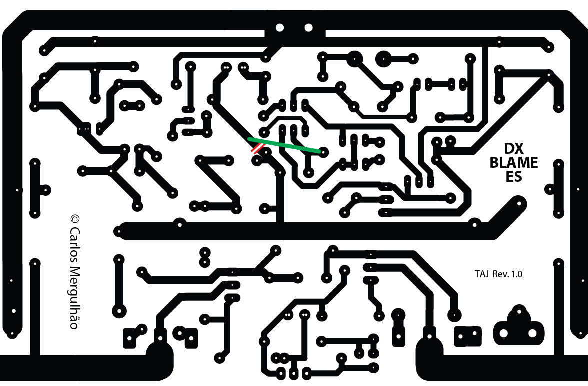

Okay, here is v1.1 of the PCB with the routing fault fixed. This does not yet fix the instability concern. Carlos will decide the necessary circuit mods for that first, then I'll modify the PCB again if needed.
..Todd

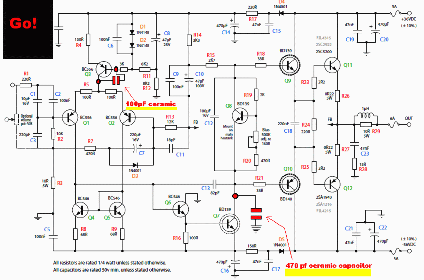

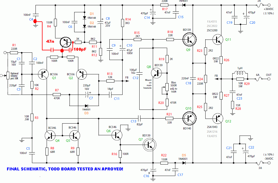

Fine dear Taj, i have worked all nigth long, and the amplifier is now ready to go!
Your board was tested twice, i have built two amplifiers in the most strange and crazy way possible, and now it is rock stable.
Here is the modifications that made it stable, only two capacitors and finished!
Happy new year folks, was not Christmas gift, but for the next year, listen the BEST WIDE WORLD EVER MADE AUDIO AMPLIFIER.
regards,
Carlos

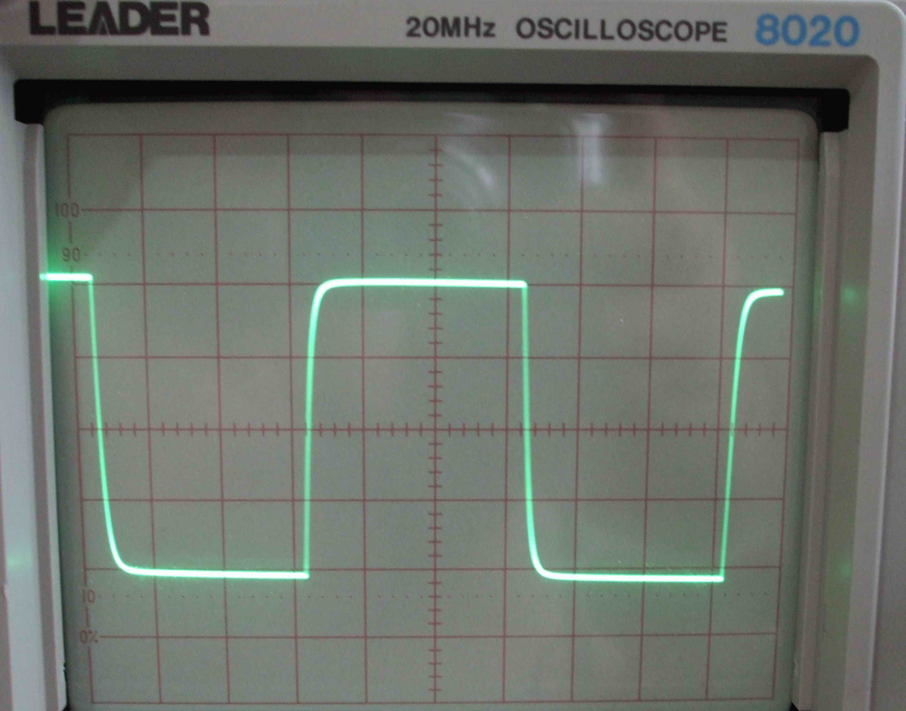

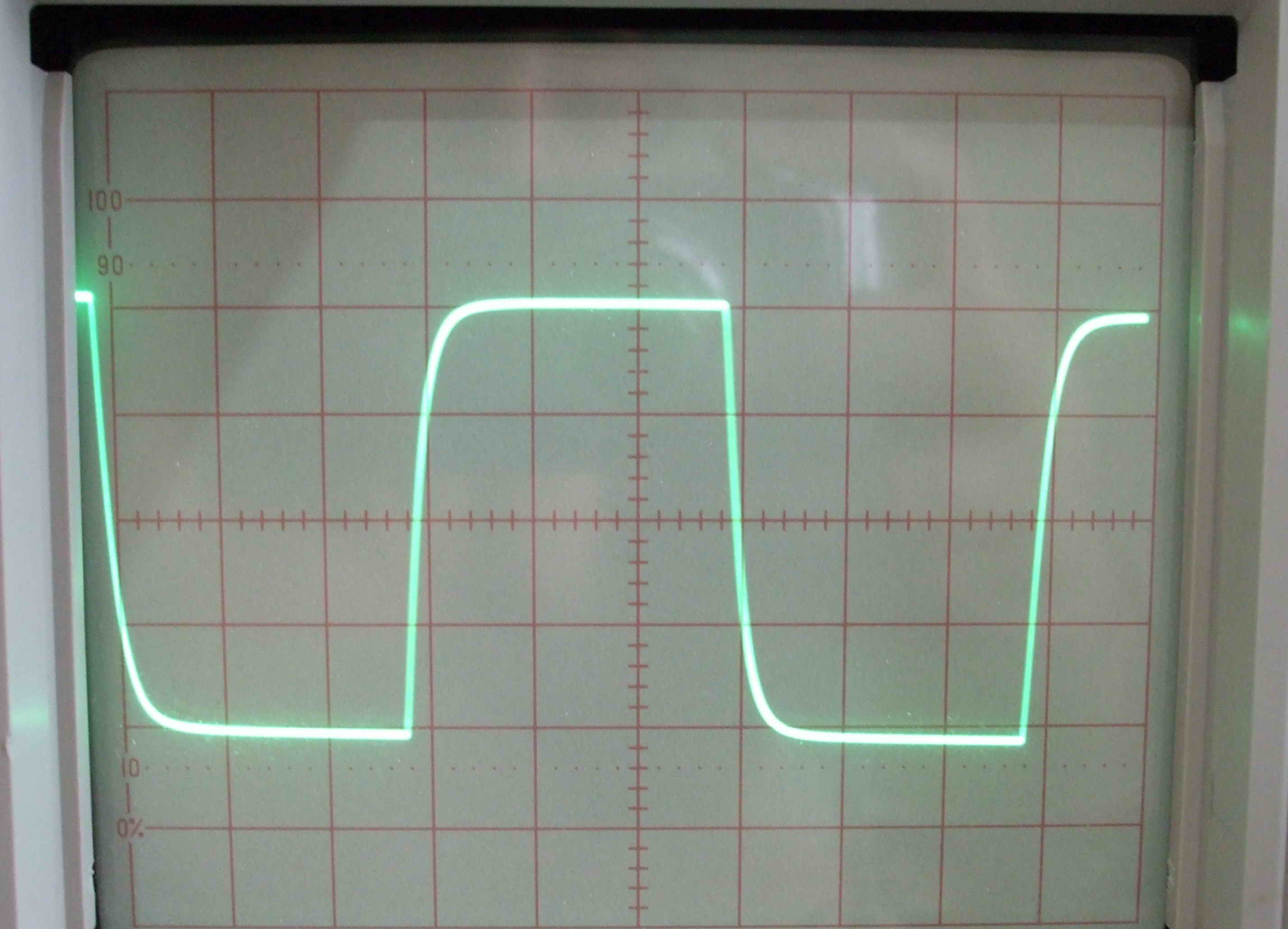

Here you have 10 Khz and 20 Khz square wave pictures

YES!, the TAJ board is almost ready, a track to cut, a wire to solder as jumper, read the thread with calm, the last two pages, you have the schematic i have posted, the last one with two capacitors in red.
Doing those things, soldering these capacitor under the board, then you gonna visit heaven, and will be there till the last of your days, listen Paradisiac music from an awsome amplifier, a gift from Douglas Self and my gift too, i have worked hard to make it even better than the original.
Many multiple congratulations to uncle Charlie, yeah!, i deserve that!

Yes Carlos I will build it.Is Taj his PCB layout ready to etch?
Hi meanman1964,
I think you should wait a couple more days for a new PCB layout that includes the 2 new capacitors.
..Todd
