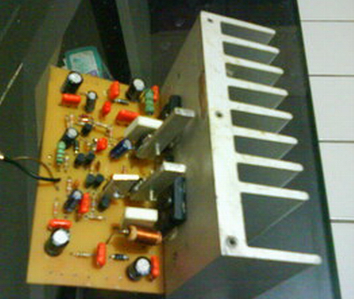

First board made, taj board, the guy said
"since the first second you power the unit on, you feel it is in another level of quality, really have beated all other Dx amplifiers, you should assemble to feel what i am feeling"
Sorry, he used Cell phone camera, but the image is will belong to the Corporation history.
I will repeat... this is the best, i have never listened so detailed reproduction, beated others by great advantage, Dx amplifier is 75, this one goes 96!
Sorry competition, i guarantee to you a second place..do not even dream to beat this one...just impossible!

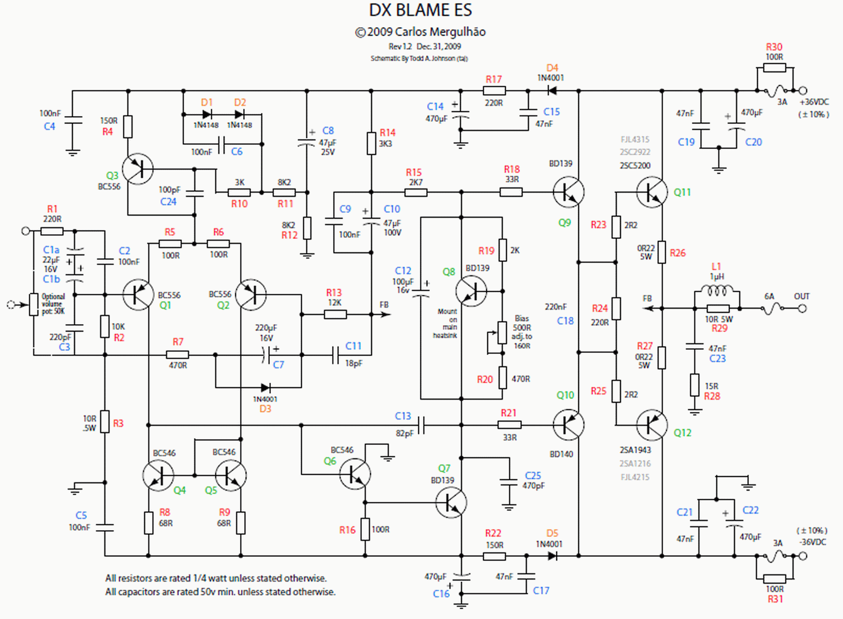

I noticed when you tried to tweak th DX Blame ES stability, I see in every schematic the feedback capacitor 18 pF is almost never touched, I wonder if you would have increased it, instead of dumping the VAS output signal, could also have bettered the amplifier stability?
The dumping of VAS output could also instead be used for increased local feedback by larger "Miller" capacitor, and at the same time increase the feedback capacitor equally as much, these are the 2 capacitors one would perhaps look at first before anything else, any thoughts here?
One could think like this, if there's "too much" gain which could cause instability one could instead use local degeneration which both linearise and lower the gain, the VAS dumping cap is doing nothing in comparison.
Anyway, congratulations, you made it before the turn of the year and made many happy!

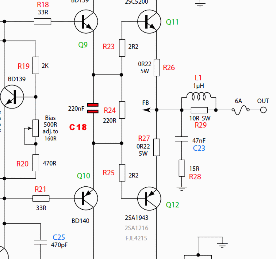

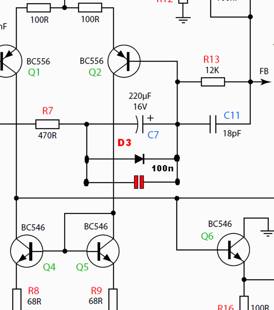

Cheers Michael

I have tried today, i have removed, also increased, and the unstability was fixed using the 100 pf from base to colector in the CCS transistor and the 470 pf in the VAS BD139, from colector to emitter.
I was supposing something bad could result,but i could not see problems in the waveform, yeah, the slew rate changed, the square wave rise time was increased, you see in the picture posted we do not have vertical, we have angle.
I tried the simulator, to see the distortion and i resulted increase from 0.00095% to 0.001%.... i tried the 100 Khz sinus to see if changed to a triangle and i found good.
Listening, i have not perceived losses...well Ultima, i think maybe some degrées of unobtanium and inexistiun distortions was increased, but i could not perceive.
A warm hug for you dear Ultima..do not forget, we have a beer around the swiming pool to have together.

Interesting the zobel was fixing the stuff Ultima..when removed the amplifier
became more stable or less unstable, before i have made the other modifications... the amplifier could not even sniff capacitances kilometers away that started to oscilate.
Now i can install 2.2uf, of course the square wave shows some damping...but.... i hope no one will install 2.2uf in the output.
Works very cold, all transistors cold, i can feel something in the second VAS, maybe 7 degrees above my environment temperature, here i am having 30 degrées célsius, and the transistor case seems 37 or 38 degrees.... light human fever temperature.
Well, oscilations are now past.
Carlos
Carlos

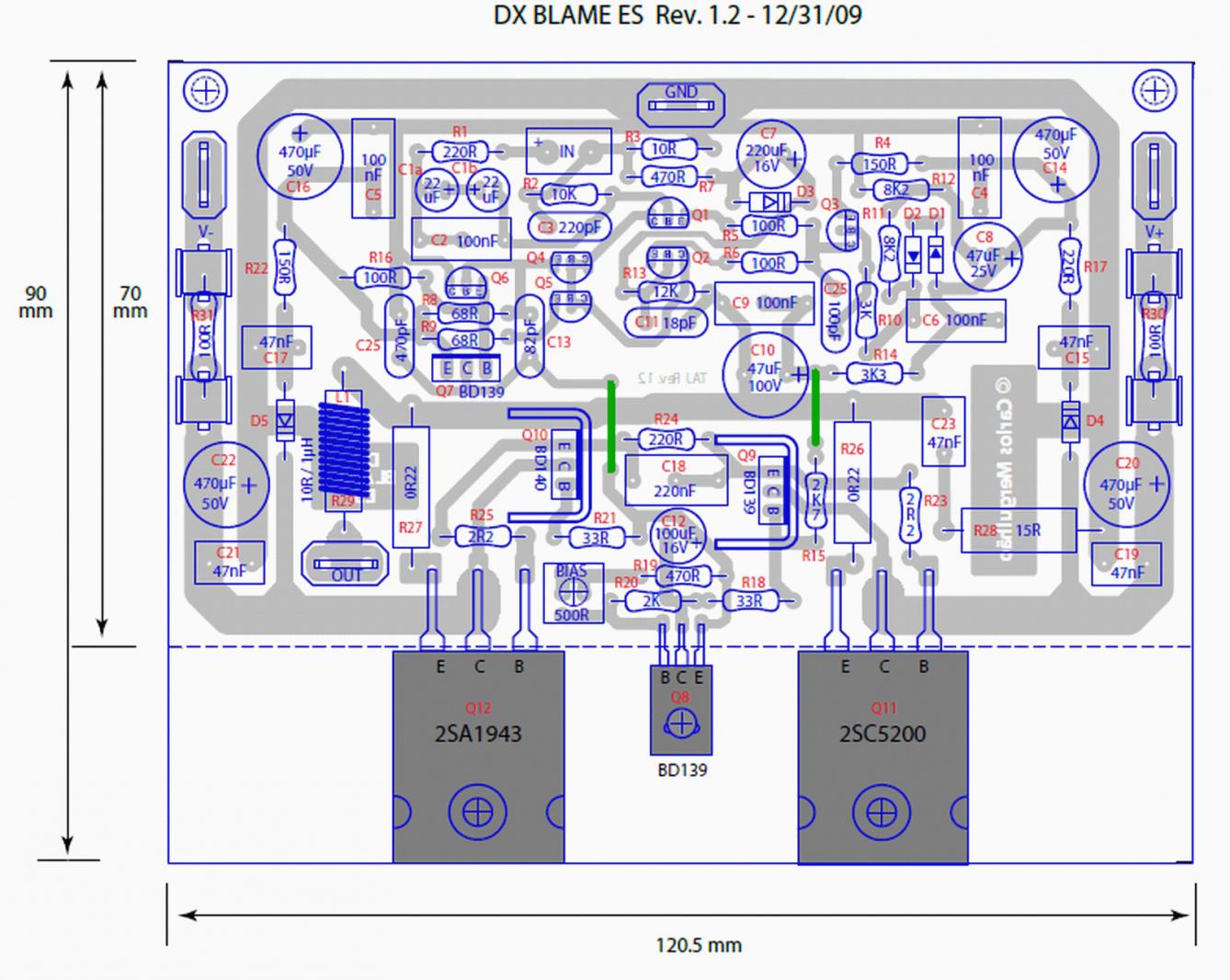

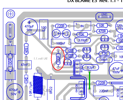

Updated PCB, Schematic, BoM v1.2
Updated PCB, Schematic and BoM v1.2 attached.
I hope this solves everything. Peace on earth should be do-able, not sure about socially-functional electrical engineers.
..Todd (by the way, happy new year)

To all members a happy New Year, congratulations Taj for scheme, PCB and BOM in record time .In the scheme should be removed short circuit on resistor R 24 value 220 ohms.🙂
Regards Alex .
C18 missing.😱
Yes, there's a short there
Also a brazilian friend told me i forgot the bypass capacitor in parallel with C7, a 47n or 100n.... this i do not know if there's room in the pcboard to include.
The amplifier can work without this bypass capacitor, but having it will be even better.
regards,
Carlos
regards,
Carlos
Suckout capacitor will return to the previous value
I have two amplifiers, the one is using 2uf performs better during the peaks when i have some clipping.
I was scared, and Eva told me this is something that means i was calling for trouble... then i have reduced, but now the amplifier is stable, 220n goes to 2uF
